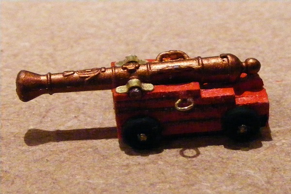

Started to put the finishing touches to the cannons and found it a little fiddly in places, especially with fixing the eyelets. So much so one of the eyelets went pinging across the dining room floor never to be seen again... didn't want to see that happen again so my solution was to thread bright red thread through the eyelet, tie it off and pin the other end of the thread to the board, that way if it went ping then it couldn't fly off too far.... it worked, saving me from crawling around the floor some more.
Also noticed, on Mr T's official build he shows the cannon with only 2 eyelets yet the magazine shows 3. Not being a naval historian am not sure which is correct. Have decided to go with Mr T and if necessary can add the 3rd eyelet at a later date.

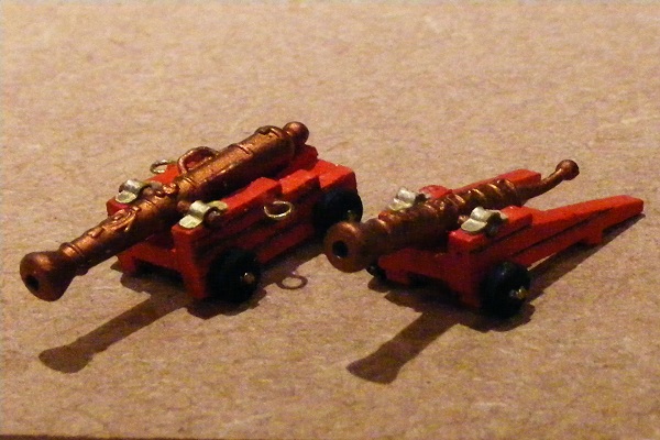

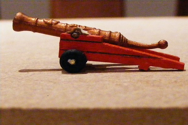

So here are the first attempts at my cannons..... close up photo's do show up the flaws.... gives me areas I need to improve on.... All in all I am not too disappointed with how they turned out... As for the anchor, that is disappointing and have gone back to doing some work on it.... the binding I applied looks a little untidy for my liking....

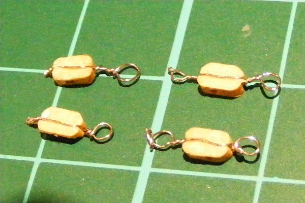

Thought I would have a go at wiring up the cannnon blocks and must admit I found this particular task pretty difficult... not because the task itself was hard but more because of the size of the parts we have to work with... took a while but perservered with it and am quite happy with the results.... Am sure there must be many different ways of tackling these... Biggest thing I learned was patience....Laugh Here is the final product....

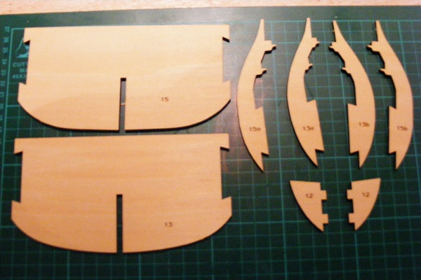

Well, picked up issue 4 from the newsagents today and am ready to tackle the next few tasks.... Was a little concerned to see the parts board broken in 2 Mad but close inspection of the parts themselves showed there was no damage... phew!!!! Flapper Here are the parts in this issue.... Happy building friends....BigGrin

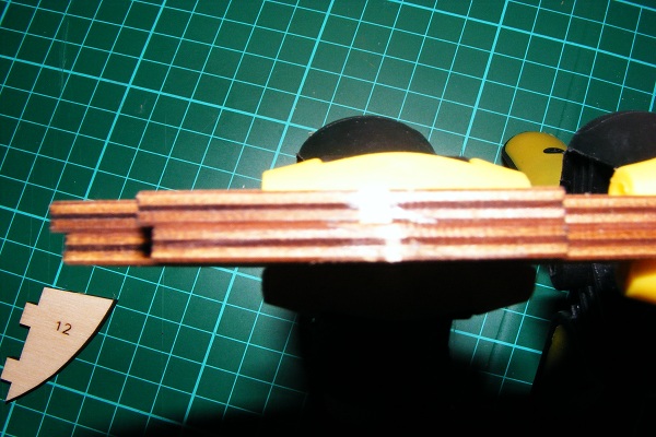

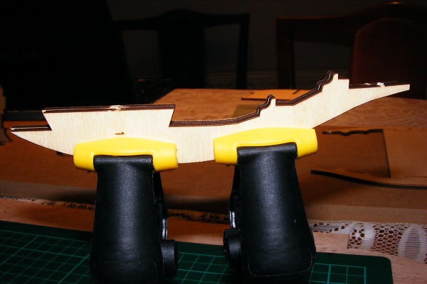

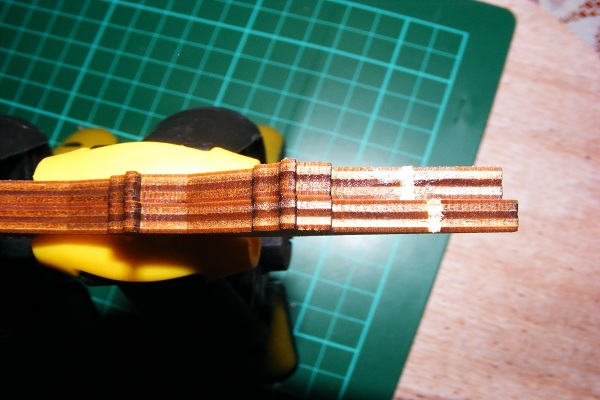

Folks, there is a problem with rib 13a, placed both 13a and 13b together and the pics below clearly show where the problems are..... don't believe the problem is too severe but not sure what affect it will have later in the build if any.... this is where I look for advice from the more experienced builders.....

Nice work so far Gandale, just read your post on issue 4, excellent photos which illustrate the problem perfectly. I was hoping issues 4&5 would turn up tomorrow, now I'm not so sureConfused
Thanks Andy, posted the problem to make everyone aware they should check the parts carefully and also in the hope the more experienced modellers can give us assurance and recommendations as to the best way to continue...... Do wish I had done the same check on the other ribs..
#38 Posted : 27 September 2012 20:41:52
gandale,you have Identified the prob.now fix itHuh yes we were lucky,reduce the rib so it is the same as (b)prob solved,when I said lucky it meant that if the part rib was smaller then we would have added by filling in,I know some you will say send it back,and it should not have been like that in the first place,but we are all human,machines don't make mistakes,only the humans who operate them.this is not a problem,I have checked for alignment all is ok.this is what the forum is for,solving problems and fixing them.good luck.what i did was to file off the top edge of the joint on 13a. and when I fitted 13b. I pushed it into the top of the joint as my flange on 13 b was was slightly too small for the joint,and pushed a piece of scrap into the joint.
#39 Posted : 27 September 2012 20:56:08
Thanks for the comments Karl and I agree with you, everything is in alignment and therefore believe it is easily fixed.. now going to file the lower part of the lug on 13a until it fits.. filing the top edge of the lug would throw everything out of alignment. ok so the top of the rib may in fact be 1mm shorter but this can be taken care of later in the build..... Do think however it is good to highlight issues such as this just in case something gets missed or overlooked..... Thanks again....

OK, that doesn't sound too much of a problem, although I don't have the actual bits yet. Thanks Karl & Gandale, I shall sleep easy now Mellow
