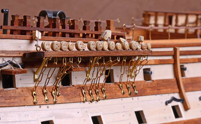

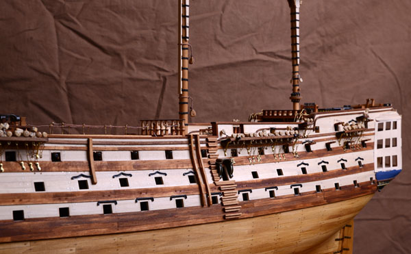

#25 Posted : 18 June 2013 13:02:48
Chainwales installed.

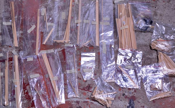

Around issue 30, I decided to sort the larger pieces of off-cuts into old part bags. This has proved to be an excellent source of material, especially with Victory Section and SOTS on the shelf!!!
Hope this helps.

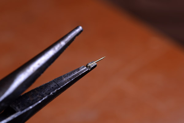

#27 Posted : 18 June 2013 13:21:27
...and more useless information (Hope not)

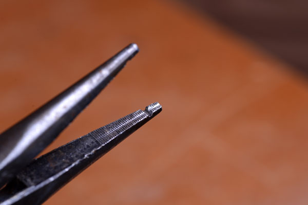

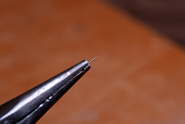

Having pinned the entire hull using a pair of long nose pliers, and bending countless pins in the process, I was concerned that while pinning the chainwales the pins will rotate in the pliers jaws and mark the finished hull.
I finally thought of doing this modification to my long nose.
I cut a slot into both jaws of an "old" long nose pliers to accommodate the pin head, and filed a grove down the middle. No more twisting/rotating pins - wish I had thought of this earlier!!!
A little late I know, but hope it helps.

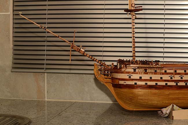

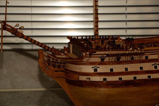

#30 Posted : 27 September 2013 07:17:31

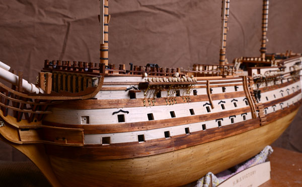

Bowsprit complete!!!

Although I'm painting mine (fear mostly) I do love seeing these. Well done.

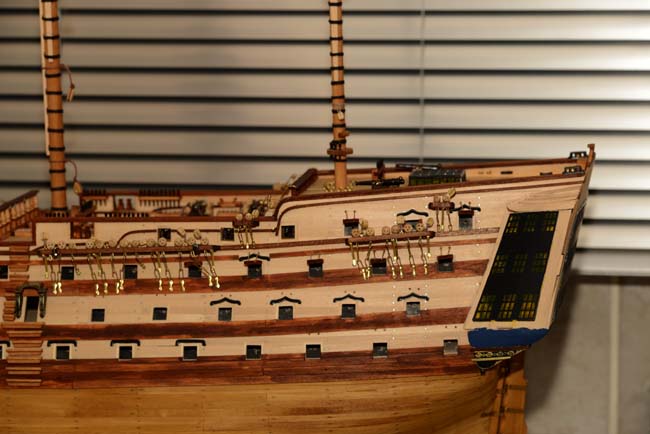

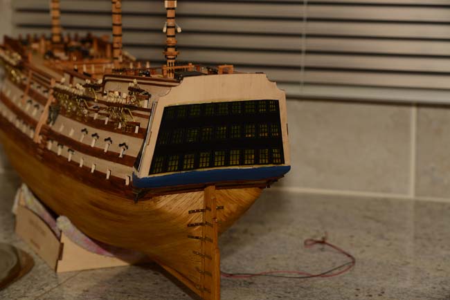

#32 Posted : 27 September 2013 07:29:42
Starting to assemble the Gallery. I decided to go the contact glue rout. (I just hate cyno)It seems to have adhered to both the timber and acetate. (And in my case, the acetate sandwiched between the timber and the styrene mullions)
I actually completed this job around two months ago - and all is remains stuck!!! I was concerned that the various materials would de-laminate.
