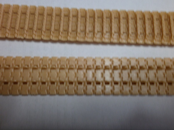

this is the 1st time iv used these tracks,1st impresions are there well cast with good detail showing theres a small burr on some but its easily removed and its in a place where u cant see it after there assembled.il post more when i later when i fix them to the model

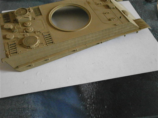

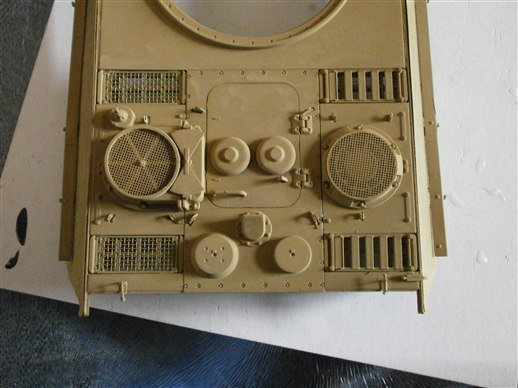

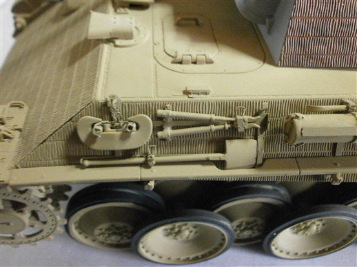

#23 Posted : 09 June 2012 17:06:53

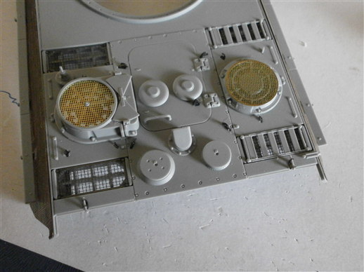

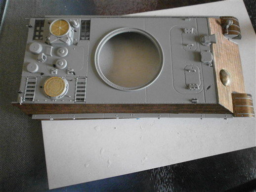

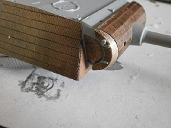

BigGrin Hi All

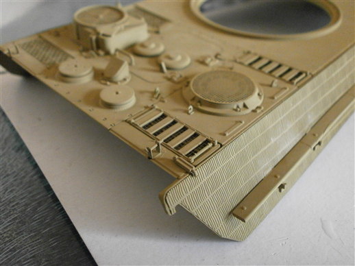

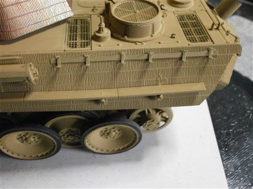

heres a progress update on the build,added all the etch to the upper hull just a couple of small pieces to add now, the driver and gunners sights and cover plus the mg.The following pik's are before and after the 1st coats of paint,as ussual all comments and questions are welcome
Monty's Double
#24 Posted : 09 June 2012 17:17:25
Hello Andy,
A very nice job indeed there my friend, well done! Looks like the etched Zimmerrit was a bit tricky to fold around the domed cover on the machine gun! The thing I love about all this etch stuff, which is quite new to me, is the finesse that it brings to a model and the way it turns a plastic model into something that looks very realistic. A prime example is things like the etched grille panels and covers on your model which when painted, just look fantastic and so real! All that Zimmerrit and stuff inspires me to maybe try a Tiger tank next!
Great stuff and well done again.
Bernie.
#25 Posted : 09 June 2012 17:33:47
BigGrin Thanks for the kind words Bernie
there was a small amount of etch included with the kit [the brass coloured bits] i used these instead of the eduard parts but the oblong covers are the eduard parts as i liked the contrast of the two.The gun portal was a bit of a chalenge as the instructions say to roll the part in between a soft base and a steal ball bearing to obtain the profile needed but as im lacking the ball bearing im quite happy with the result i managed to get

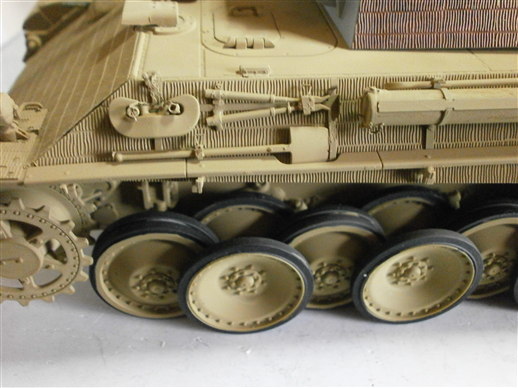

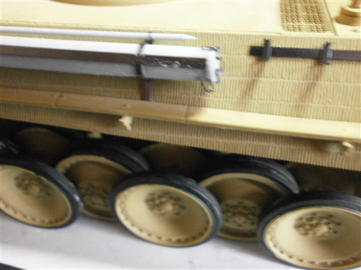

#28 Posted : 10 June 2012 15:19:57

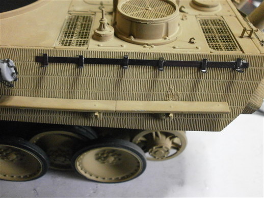

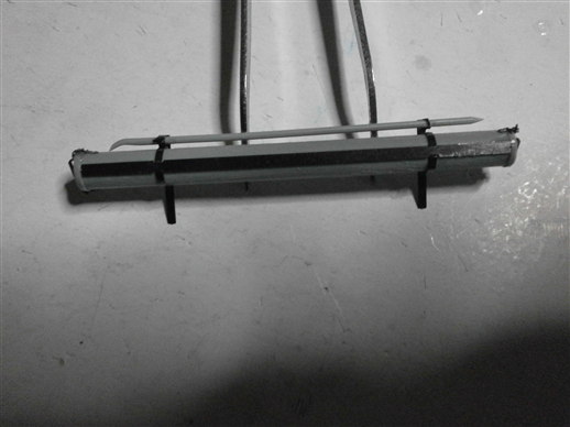

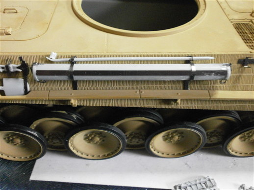

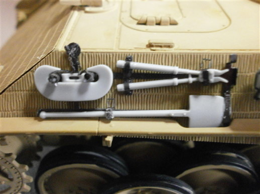

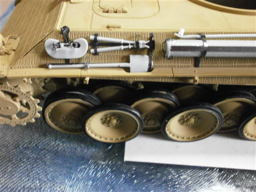

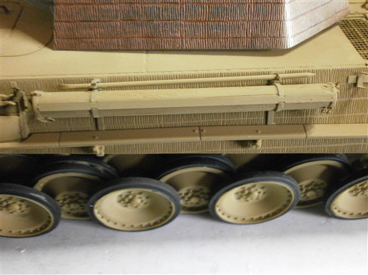

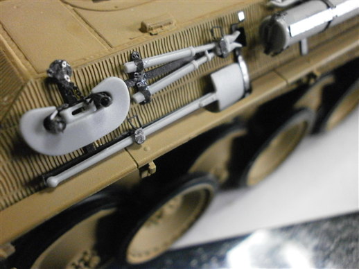

BigGrin More progress
finished all the etch brakets on one side and added the track spares mount still have the pins and chains to add here plus the spare tracks.And jack i have already got the friuls for the kit go to page 1 LOL .As ussual all questions and comments are welcome
#29 Posted : 10 June 2012 20:54:09

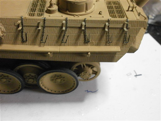

BigGrin Chains and pins added to track holders

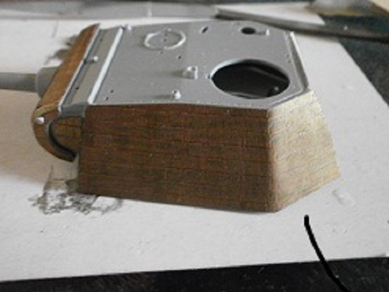

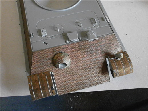

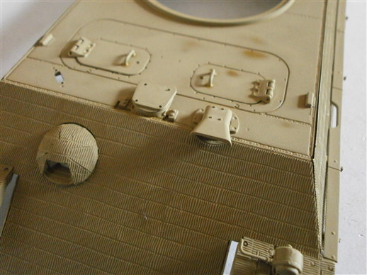

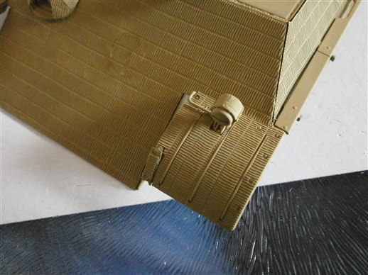

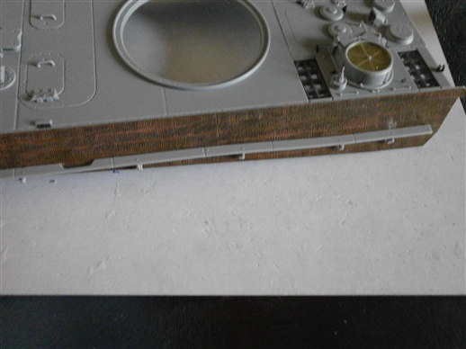

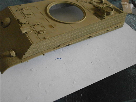

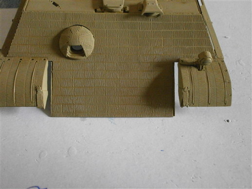

#32 Posted : 13 June 2012 00:29:53

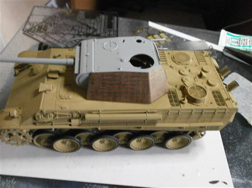

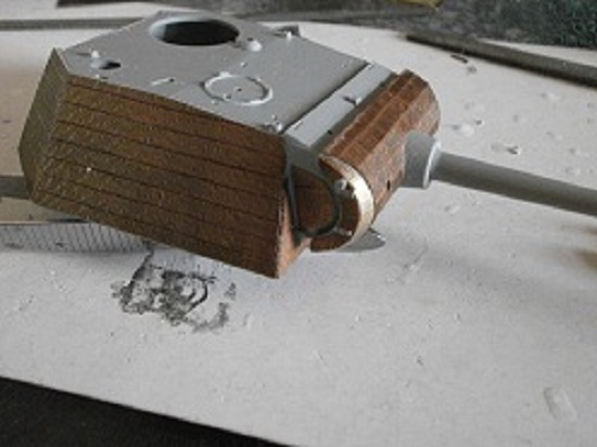

BigGrin Hi All a few more pics of the compleated Zimmermit etch just the other etch to fit on the turret now

Hi Andy nice work againBigGrin could you please resize your photos, they are not shoeing upBigGrin Regards Mike
#34 Posted : 13 June 2012 17:48:03
BigGrin Thanks Mike having problems with my photo software at the minute trying to get it fixed will post as soon as i have a resolution to the problem,the replacment pics are using another lot of software i have but it just takes ages to resize the pics

#35 Posted : 23 June 2012 19:50:25
Hello Andy,
Nice work there my friend, looking very busy now and the etch adds so much more detail to the look of the model, very nice. I will be following carefully in your footsteps with the task of attaching 'Zimmerit' now that I have a 'King Tiger' diary up and running on ModelSpace.
Can I ask what glue you used for attaching the Zimmerit? I would presume it was superglue, but if it was did you use thin and runny or the thicker 'gel' type and did you find any problems with using either type of superglue, if indeed that is what you used? Which would be best?
All the best
Bernie.
#36 Posted : 23 June 2012 21:23:27
BigGrin Hi Bernie
i generaly use thin super glue but remember you need to line it up corectly as you only get one chance using this,PVA can also be used or Evo-sticks Serious glue as you have around 3 mins lining up time with the evo longer of course with Pva. Another tip for attaching very small pieces of etch is not to use glue but paint of the colour you intend to paint the model in.Hope this helps

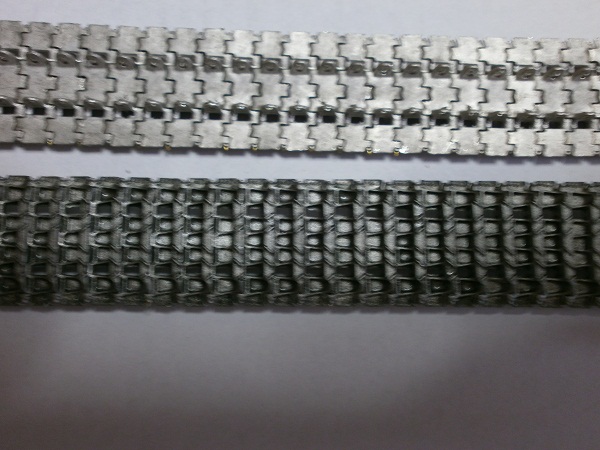

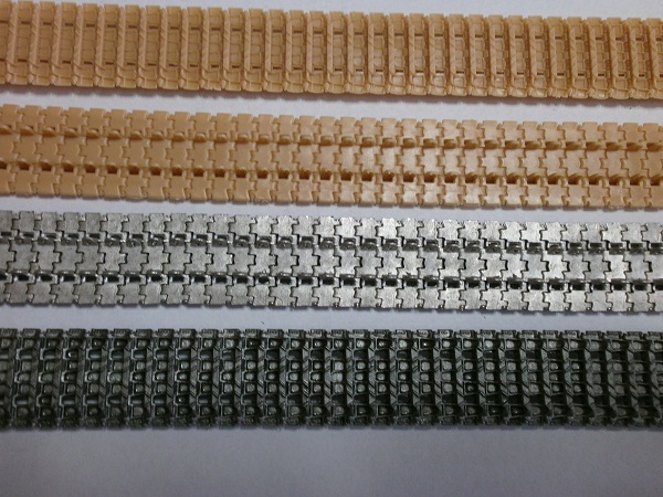

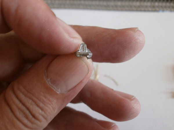

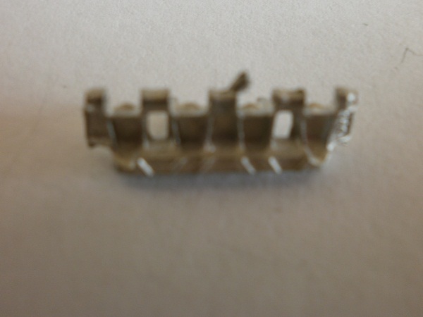

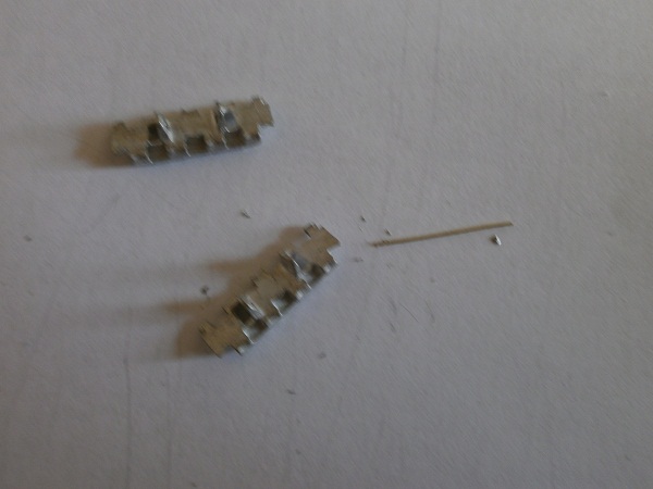

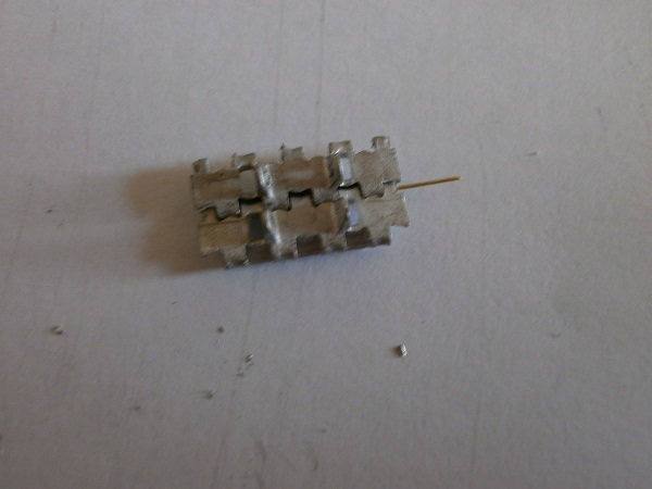

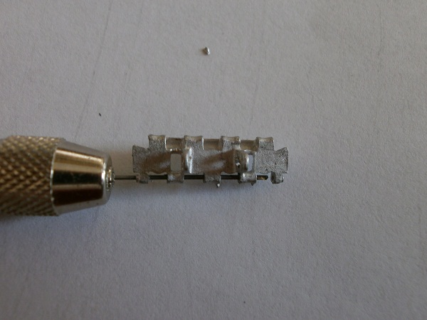

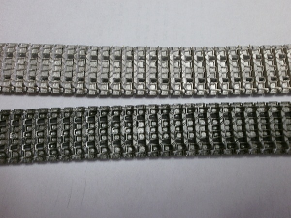

BigGrin Hi All
havent posted for a while due to work comitments so thanks to any posts i might have missed/ not answered.Right just a few pics of the friul tracks made up against the dragon tracks from the kit,although the dragon tracks are very detailed i have to say the friuls give more weight,literaly and in detail to the model.The bottom friul track in the 1st pic is painted in Tamiya's XF-56 metalic grey ,as ussual all comments/ questions are welcome

#39 Posted : 01 July 2012 19:07:35
Hello Andy,
Some nice work there in assembling the Friul tracks and very useful to have the comparison photos between the Friul and the kit tracks, so thanks for that. I have just ordered some Friul tracks for my King Tiger build, which should arrive by the end of the coming week, then I have the prospect of assembling some 120 links - hooray! How did you find it, tedious or enjoyable? Whichever, it must be worth it just for the extra realism?

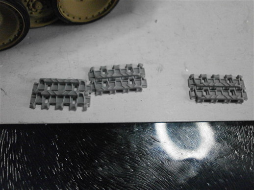

#40 Posted : 01 July 2012 20:01:01

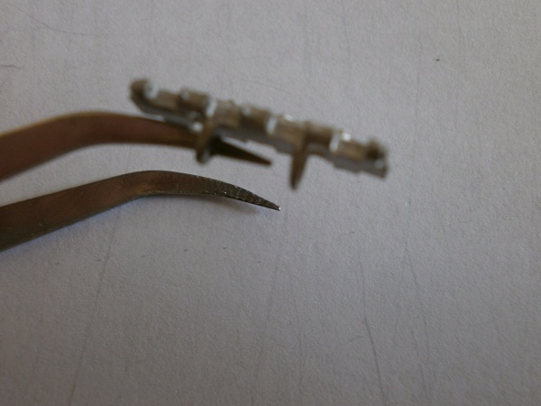

BigGrin Hi Bernie
the tracks are quite easy to put together takes time but its not tedious as long as you do a little preparation before hand.The horns on the inside of the tracks can have some flash on them i used one side of a pair of tweezers to unblock and trimed with a blade[push through from the outside edge and trim on the inside so no marks show] and the front edge where the mould nipple is,this is easliy removed with a razor blade/knife as the metal is quite soft.I also found the tracks went together easyer if a 0.5 mm drill is run through each individual piece, it mentions this in the instructions aswell.Cut the wire slightly oversize slide fully home then withdraw a little and trim off the excess push home and add a spot of super glue to the wire. in the instructions it says to glue the oversize wire in place and trim after its dry but i found its hard to get into the area to trim once the tracks are glued together.Also dont glue the last 4 links on either end untill you have fitted them to the model to allow for adjustment[add or remove links],hope this helps
PS
When you drill the links remember they are suplied a left and right side format, the side facing outwards has not got a hole for the wire so dont drill this out so only the inside links will show the wire holes
