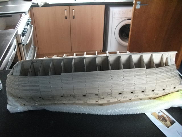

#27 Posted : 18 March 2012 23:56:09
Joined: 20/12/2011
Posts: 236
Points: 686
Location: shetland
Hi Guys,latest pics of my build, does it look ok so far as I have filled the frames with balsa wood which has helped to get the line right.
Bow and stern has three (one to go)bow looks the same,the two stern planks have not been glued yet just needed some advice if they look ok or not.I have been a very long time trying the bend,Crying Crying still does not look right but will it be ok??Huh
sandnesspeats attached the following image(s):
z8000783
#28 Posted : 18 March 2012 23:57:41
Groups: Unapproved
Joined: 24/05/2010
Posts: 1,761
Points: 5,351
Location: London & Greece
... and the pics?
John
#29 Posted : 19 March 2012 00:37:30
Hi Rob, I completed 11 rows of planking before I needed to taper planks looks like you are in the same situationBigGrin so now when you fit a plank let it follow the path it wants to, then you taper it to fit that track. If you have triangular spaces (you should get these)then fit a piece of timber cut to fit that space (called stealers)please continue to soak the plank, fit it without adhesive with pins, let it dry overnight,then you will find the shape will be fixed.then fit it with adhesive.BigGrin also put a bevel on the plank as it says in the instructions so it fits tight upto the next plankBigGrin
Your stern planks look fineBigGrin Regards Mike
StefanDV
#30 Posted : 19 March 2012 07:54:08
Joined: 07/01/2011
Posts: 399
Points: 1,212
The planking's looking fine Rob. Well done - you're making great progress. Re the bending of the planks - what Mike (MWG) said.
Hans
#31 Posted : 19 March 2012 08:18:50
Joined: 30/03/2011
Posts: 1,344
Points: 4,079
Nice clean lines. You are doing fine. Take your time and enjoy.

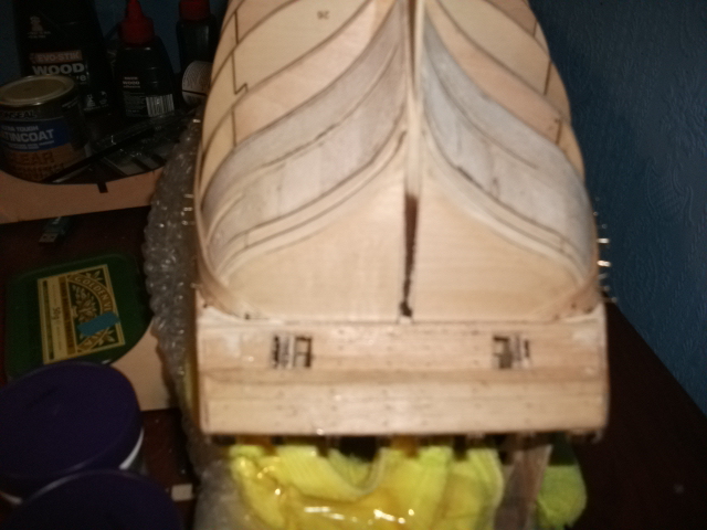

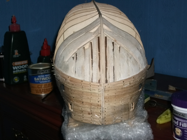

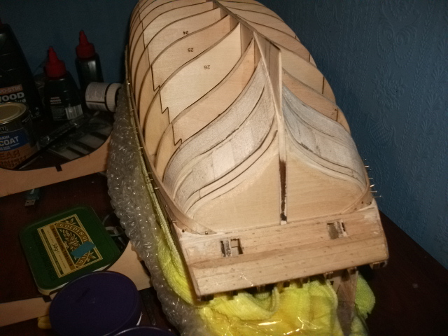

#36 Posted : 24 May 2012 22:55:27
Joined: 20/12/2011
Posts: 236
Points: 686
Location: shetland

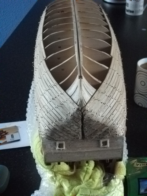

hi All,
I am on issue 37 at the mo and i think everything is going ok!BigGrin BigGrin
Please look at the photos and tell me if this looks ok so far,thanks.
Do I need to take out all the pins yet.
Confused
StefanDV
#37 Posted : 25 May 2012 09:19:25
Joined: 07/01/2011
Posts: 399
Points: 1,212
Nice Hedgehog LOL!
You can take the pins out as soon as the glue has set. I started every planing session by removing the pins from the previous session. (The little side-cutters in the free toolkit works very well for this)

#38 Posted : 25 May 2012 09:41:20
Joined: 20/12/2011
Posts: 236
Points: 686
Location: shetland
LOL LOLBigGrin .
should have taken them out after it dried,DOH!!!!
thanks stefanDV

#40 Posted : 25 May 2012 14:59:06
Hi you have a really nice build, if it was me I would be inclined to pull the pins out once the glue is setBigGrin Regards Mike
