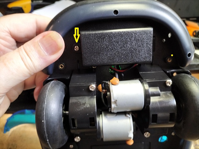

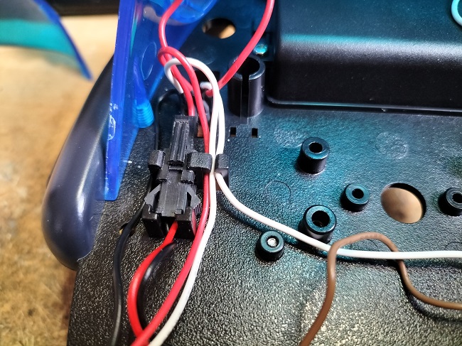

Pic 3: The connector of the PP3 wiring is then locked in place and connected to the main switch. Cables put into some tidying clips.

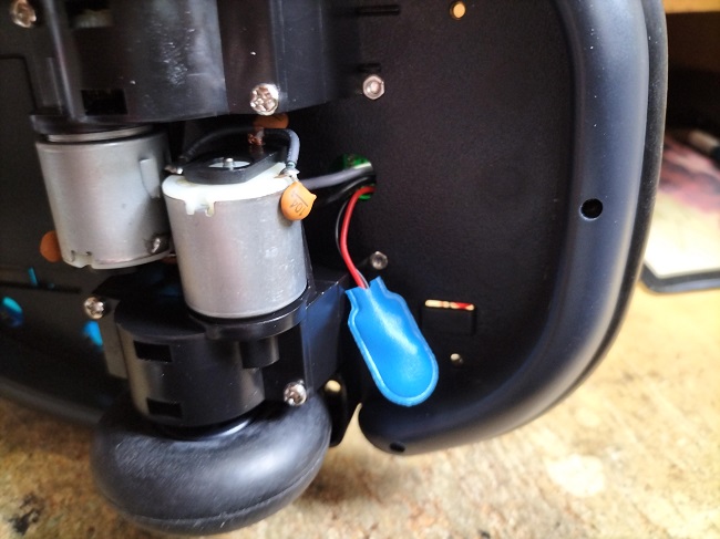

Pic 4: Connected a brand new (Pink Bunny) PP3 9v battery and enclosed it with the battery case. One tab of which fits through the floor and then the other end secured with a screw. (Arrowed)
Pic 5: Cybot gets its tail end secured by two screws.

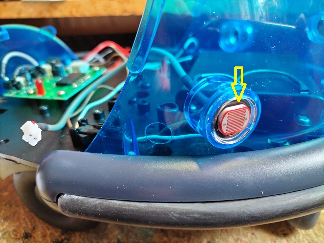

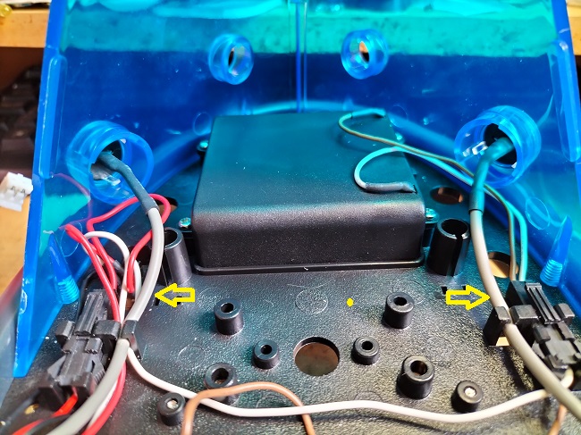

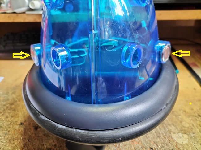

Hi All, BigGrin

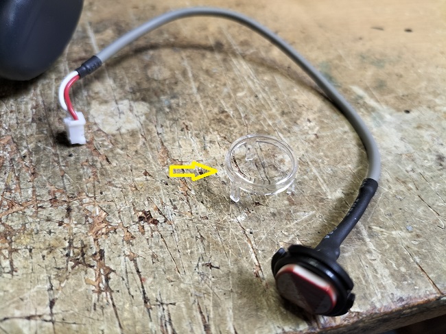

On with issue 7, where Cybot gets its first sensors.
These are the light sensors that enable Cybot to follow a torch light or find its way from a dark room to a light room. (Just not yet)

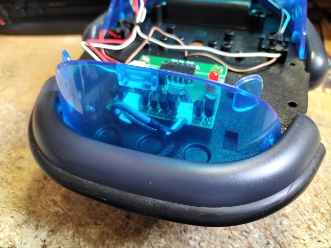

The sensors come pre-wired with a clear protective lens cover. (Pic 1)
Each sensors has the wires fed through the relevant holes in the cover and the lenses click into place and hold the sensors firmly in place. (Pics 2 and 3)
On the inside of Cybot the sensor wires are kept tidy in the cable clips moulded into the base. (Pic 4)
Issue 8 in progress.Blink

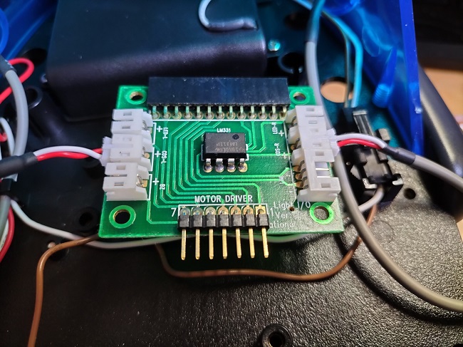

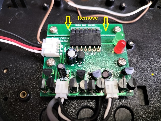

First thing to do was remove the screws holding the motor test board and remove the test board itself. (Indicated in pic 1)
To make life a little easier I plugged the light sensor cables into the new board before fixing it to the base with four screws. (Pic 2)
Finally plug in the new board and fix to the base with four screws. (Pic 3)

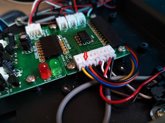

First I had to insert the next board to get the light sensing circuits working.
The board connects into the previous one, its a bit limited for space so eased it in gentlyas not to damage the pins/sockets.(Pic 1)
The board is then secured with two nuts placed in captive holes under the base and two screws through the board. (Pic 2)

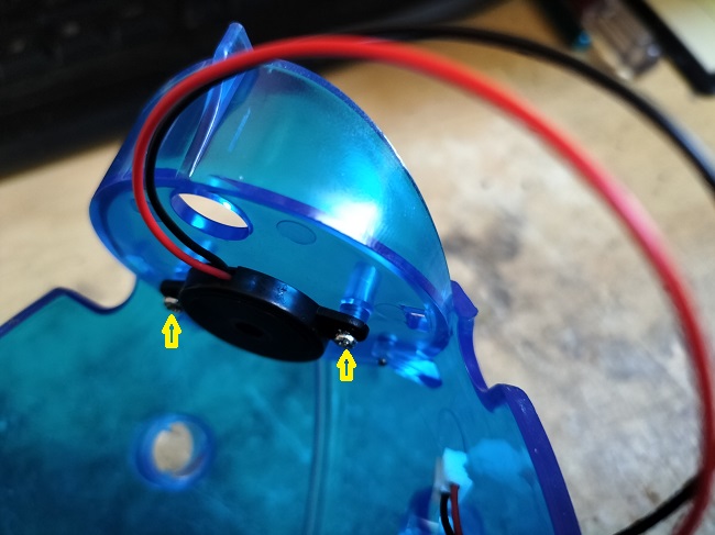

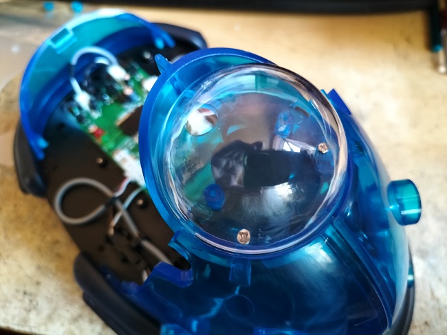

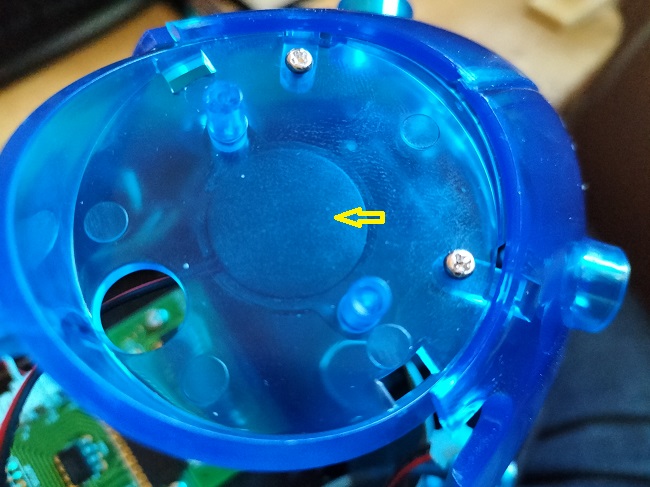

In this issue Cybot gets his voice (well bleeps) with a Piezo speaker and some nice body panels.
Cybots circular top piece is removed, the speaker attached and then the top part is replaced. Nothing amazing so Pics 1 and 2 show underneath and atop when finished.
The cable from the speaker is plugged into the circuit board (Pic 3)

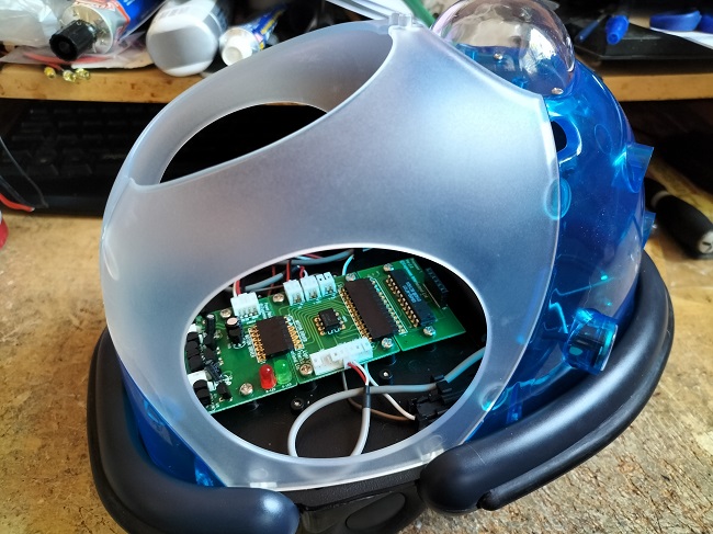

Next Cybot gets a fancy dome that just clicks into place at the top. (Pic 4)

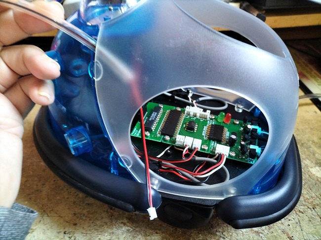

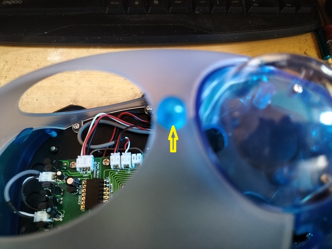

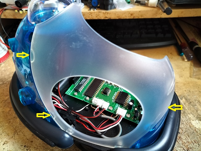

Cybot now gets its main body panels. These slot into place at three points and are finally fixed in place by two screws each. (Pics 5, 6 and 7)
Finally for this Issue the top of the two body panels are held at the top by a decorative little blue pip thing. (Pic 8, apologies for the bad focus Blushing )

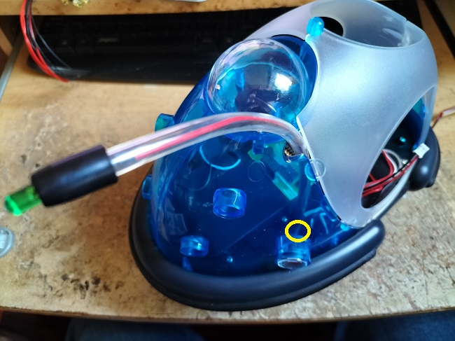

#38 Posted : 08 May 2022 21:26:59
Issue 11: This is really zipping along now.BigGrin
The parts in this issue cover two areas of the build. The first I will show now, the second parts are put together , attached and then in the next issue are all removed / taken apart then have more parts added and round it goes. So I`ll save that for now and do the whole thing within Issue 12.

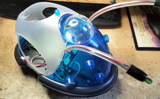

So Cybot gets his ant/beetle like antennae (Pic 1).
These are pre made and are placed through the outer casing (Pic 2 and 3) into support points in the base. Each support has a slot to allow the wires to exit without getting trapped and holds the outer tube firmly so they don`t wobble all over the place.
The cable is then plugged into its point on the circuit board. (Pic 4)
The other side is repeated exactly the same as shown. (Pics 5 and 6)
(Parts that I have retained until the Issue 12 update are shown in Pic 7).

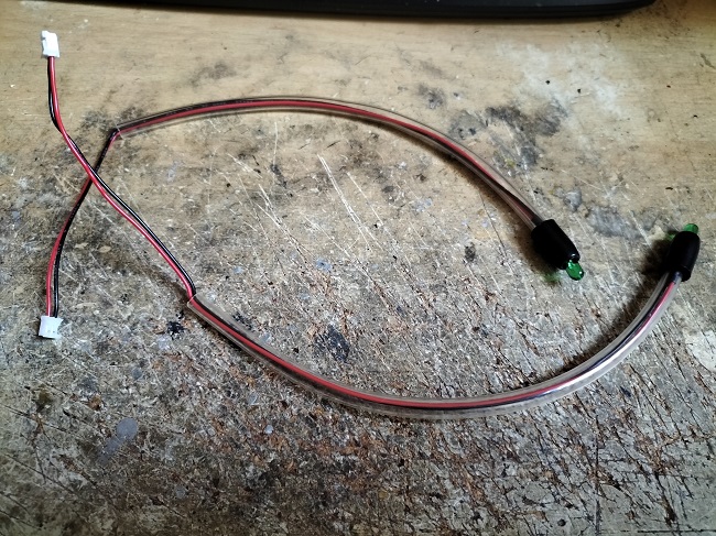

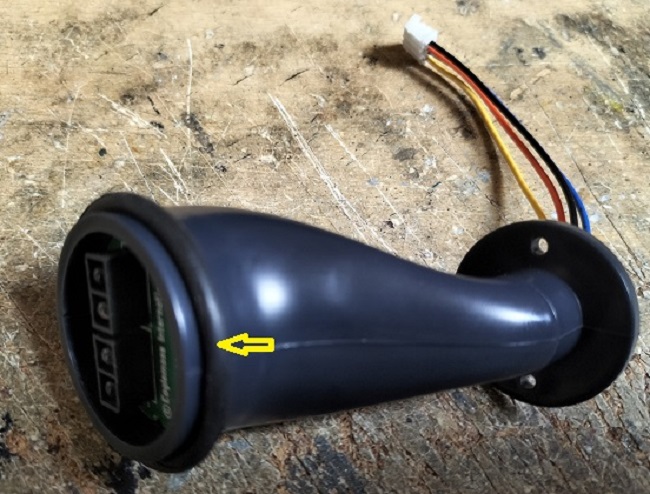

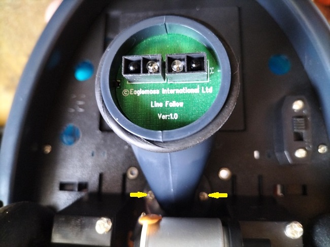

Issue 12: Cybot gets his line follow attachment under the base prior to getting the required electronics.
#39 Posted : 09 May 2022 17:31:18
Hi Again, BigGrin

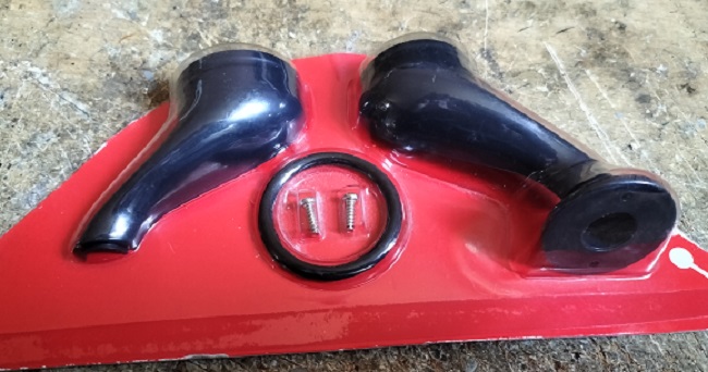

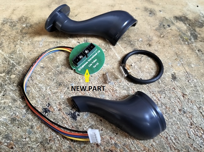

Now in the previous post for Issue 11 I left some parts that were really not required for that issue untouched.
If I`d followed the instructions to the letter, then the two parts that look like a trumpet, would have been held together with the rubber loop and the resulting piece would have been fixed to the Cybots base with two screws. So lets pretend I done that LOL .
Now at the start of issue 12 I`d have had to remove the same two screws, remove the rubber ring and separate the two halves of the trumpet shaped thing.
Confused Blink Confused Blink Confused
So here we are with all that done and undone and got nowhere. LOL LOL LOL

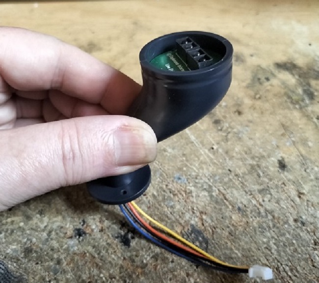

You will see in pic 1 that I`m showing the parts from stage 11 and the "NEW" part as in the line detector.

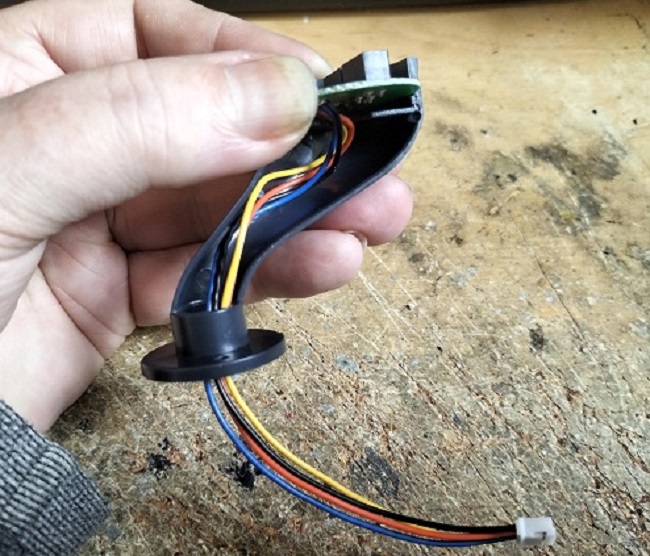

Pic 2: The plug of the line detector is fed through the trumpet thingy and the circuit board held in place, making sure that the locating lug is in the correct place.
Pic 3: The second side of the trumpet thing is put in place.
Pic 4: The rubber loop is placed over the wide end of the trumpet.

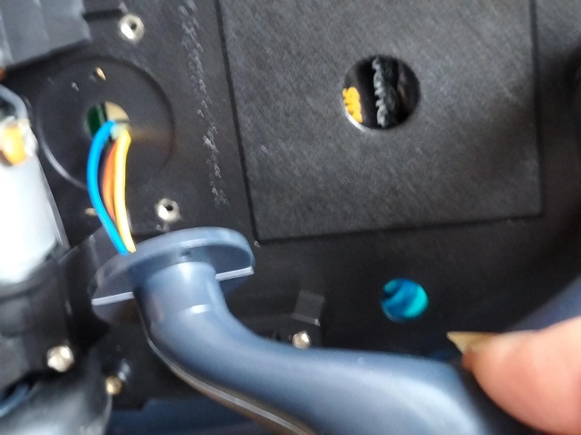

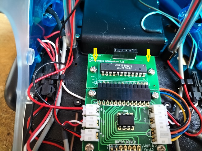

Pic 5: You now have to unscrew and remove the forward most circuit board, to be able to feed the line detector cable through the base of Cybot.
Pic 6:Feed the plug through the base.
Pic 7: Affix the trumpet thing to the base of Cybot with the two screws supplied in stage 11.

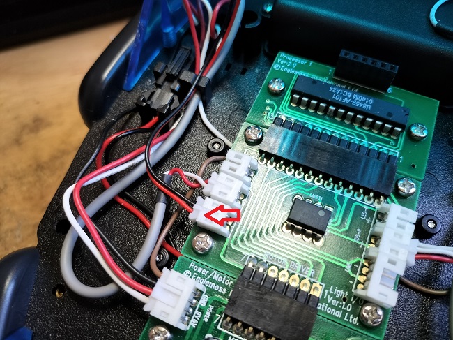

Pic 8: Carefully route the cable from the line detector and press the plug into its circuit board as shown.
Pic 9: Replace and fix the board removed earlier in its place.

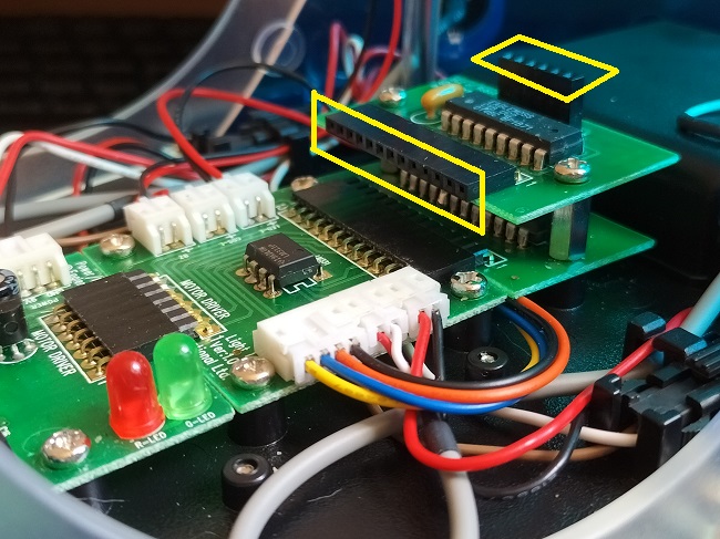

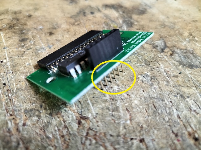

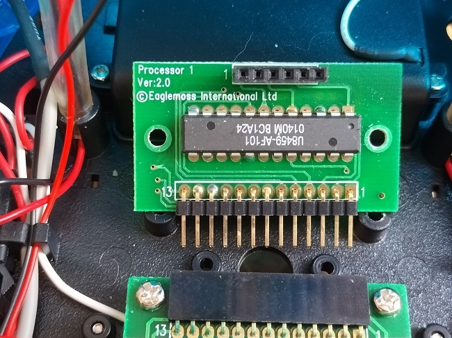

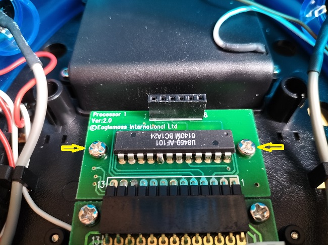

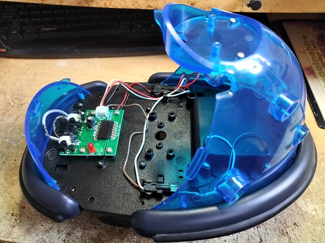

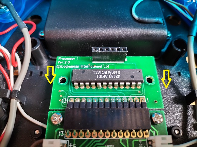

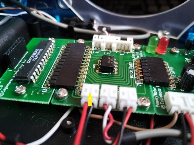

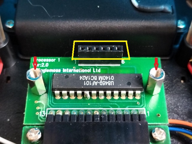

Issue 13 sees an additional circuit board added. On its own this board doesn`t do anything, but is part of the line following mode of Cybot that is completed in the next issue.

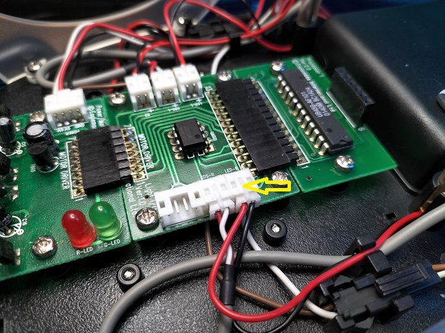

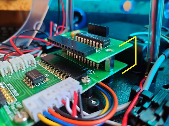

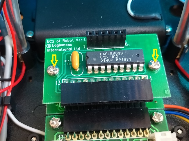

Firstly, (shown in Pic 1) remove the two screws that secure the forward most board and replace them with the support pillars. In this pic you will also see the high lighted expansion socket that the new board plugs into.
Pic 2: shows the six connection pins in the underside of the next board.
Pic 3: the new board is plugged into the lower expansion socket and starts the second level of boards.
Pic 4: the two shorter screws supplied in this issue secure the new board in place.

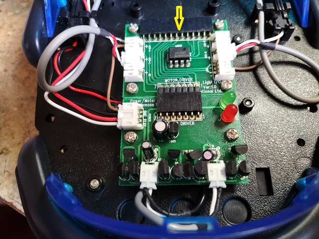

Pic 5: shows how the second level of boards can be expanded and a third level started by the use of more expansion sockets.
That`s it for now, until issue 14 where Cybot gets another circuit board and takes on the "line following" test. (Second video coming as well).
