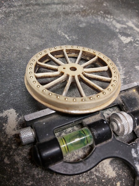

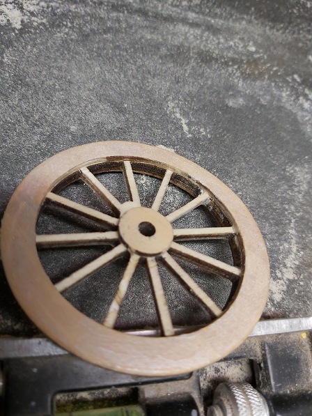

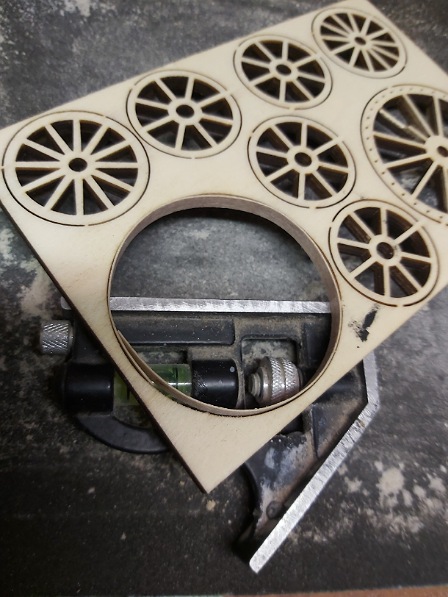

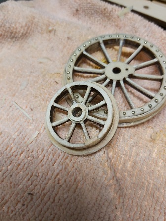

Mean while, I decided to start the wheels, namely the big ones. Made a few mods, I think my modelling skills didn't match up to the task, but with my dodgy eyesight, everything looks good.
I tried to reduce the depth of the spokes, I removed top outer layer of ply, approx 1.5mm. This was working well with a small chisel until I started to remove material across the grain. Bits fell off on 4 or 5 occasions, repairable with puty but not sure I would do this again. Committed now so will continue.
Also removed the 4 spokes on the flanged back piece. Removed 2 opposite spokes before asm, then snipped off the other 2 when glued up. This change looks pretty good, would do this again.
Blighty attached the following image(s):

I forgot to mention, decided to not use the aluminum strip on circumference of the wheels, instead I wrapped them with very pliable 1/64" strips, 2 layers. Not sure how this will look when painted up but too late to change now.
The blank where the wheel was removed made a great former for the rim clad.

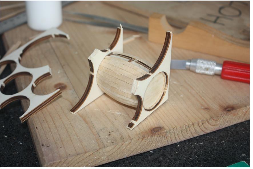

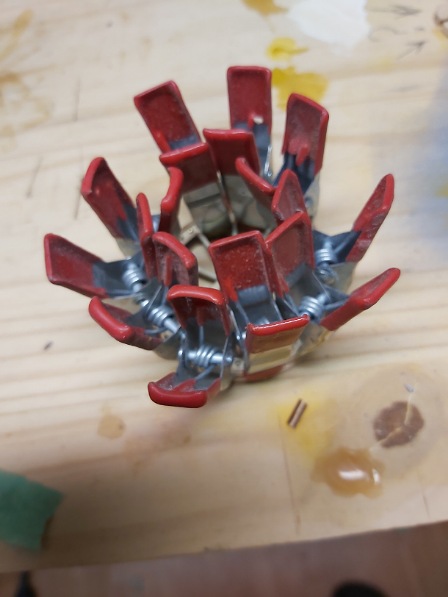

I found the water barrel a bit tricky, trying to keep all staves in place. Came up with the idea of using the cutouts from the wheels as a "clamp" which seemed to work fine. Also the only real change I made was to replace the provided "imitation" coal, which was white chips in my kit with some black one I got from EBay (other auction sites are available)
Pictures attached :-

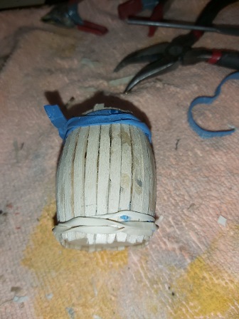

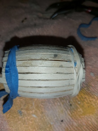

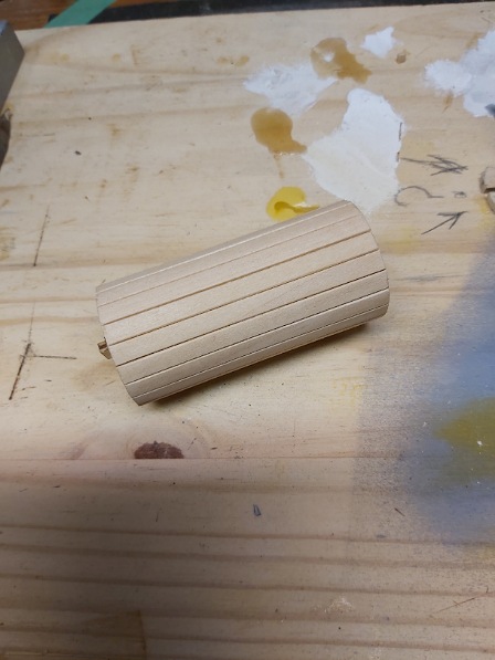

Last night my wife went out to baby sit the grandkids, left me at home with a half bottle of wine and a model itching to be got at. The result! a barrel full of holes. More later.
First thing first, got up this morning, hit the Kurig and checked the emails. Saw your responses to my build log, thx so much for showing interest and providing assurance and tips.
So, back to last night. I had built the skeleton of the barrel and already had a portion of the first layer of stays in place.
As Gil pointed out, this is not an easy process having to taper the stays to keep the barrel surface even. I failed!!! I got a feeling this model will end up with a barrel full of body filler. I have to do better on the top finishing layer, plan B.
Note, for anyone who is about to build this kit, check the forms on the barrel, the radii do not match longitudinally, mismatch is not a lot but is obvious if you lay one on top of the other in hand.
I was not going to put up pics of the barrel at this time, but you should get a smile out of them.
My tip to you all, don't crank up Led Zepplin, Stones and a good red wine when doing the barrel on this kit.
Len

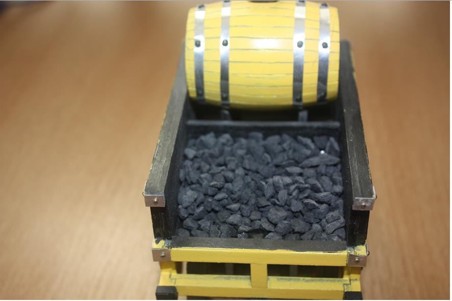

Hi Gil, that is a very tight build on the barrel, not easy at all. Well done.
I actually took a look at your build log while waiting for my kit to arrive, I wish I had recalled your fixture idea to clamp up the stays, worked very well for you.
As for the coal, I totally agree, I have had boat kits with gravel coal, I think I will take your route, thx for the tips, enjoy the log.

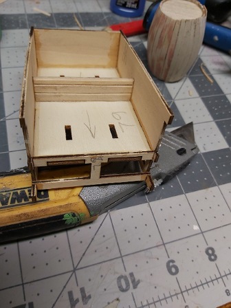

Hi, getting the barrel surfaced with the second layer. This is an easier process being as there is a solid foundation under it but still having difficulty getting it to looking like the ones in build logs I've looked at. I thought about adding another layer on top of the second, this would be plan C, however, by the time I got it looking pretty good, plan M or N the diameter would have increased by 12mm. Think I'll stop at plan B.

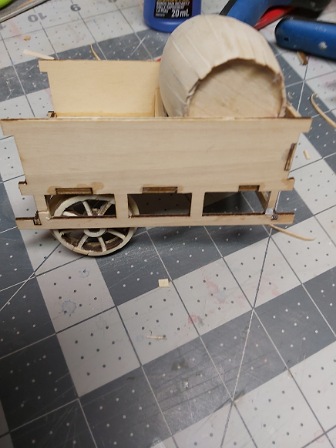

Moving on, I built the tender foundation, this was another nice sub assembly to do. A couple of minor mods to this so far.

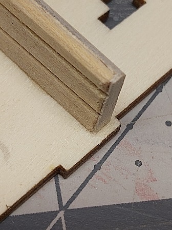

Added a layer of planks along the bulkhead separating he coal bunker from the water barrel. I did this primarily to add a couple of features that will soak paint up when I get to aging it. pics attached.
Also when dry assembling the tender, I noticed the partition I'd just planked was about 1/64 to narrow on both sides so I shimmed the ends to match up with vertical sides, this made assembly easier and allowed glue to be added in this area, I think this was a useful opp up and I like the look..
Final pic shows tender all but finished!! ( A few tweeks required.

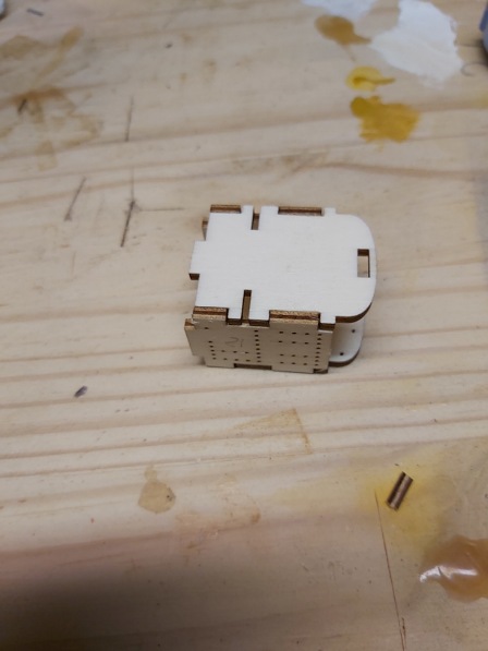

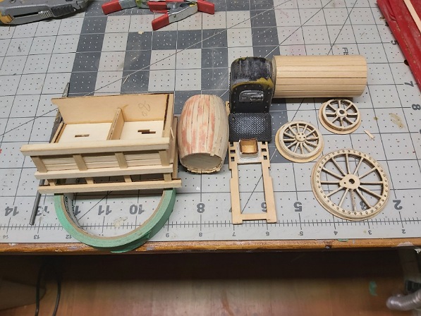

First week of building the Rocket is over. Attached is a pic of all completed bits. Just about everything is half finished, I like to get a few things going on at the same time. A change up now and again keeps things interesting and allows glue to dry of course. A most enjoyable model.
Len

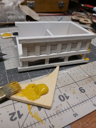

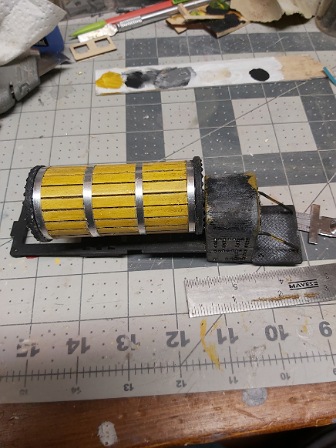

A few more updates, got some colour defined now, went with Yellow Oxide acrylic as main colour, there are several choice to be made according to other buid logs I've looked at. (They all look good)!
Tender only hasone coat so far.
I used a white spray can undercoat and brush painted the top coats. Still lots to do.
