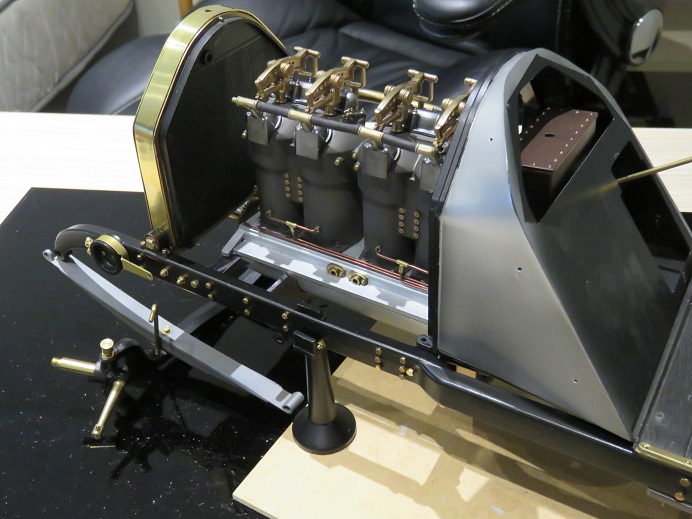

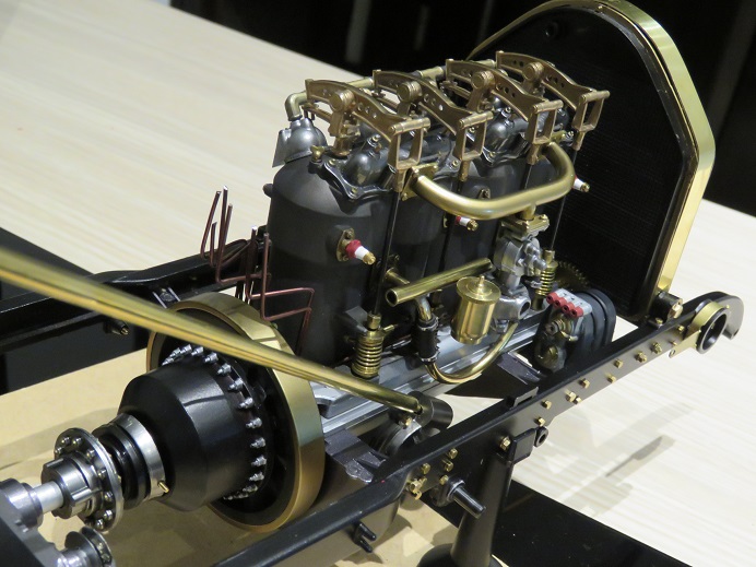

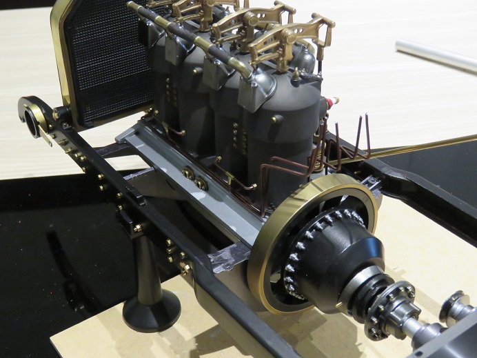

Thanks for looking in Guys, and all the encouraging comments.BigGrin

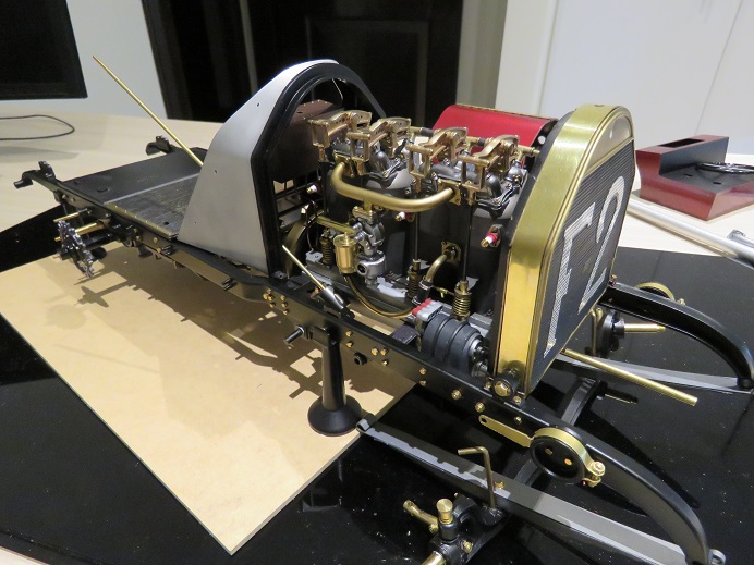

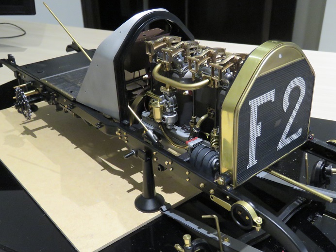

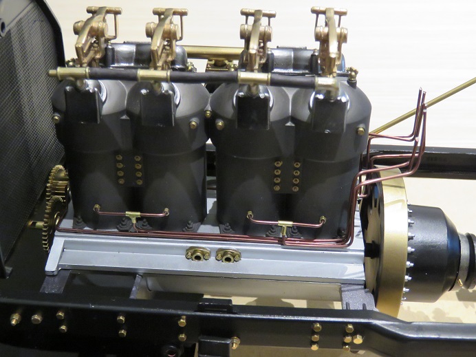

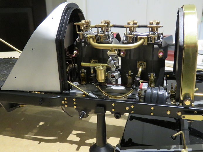

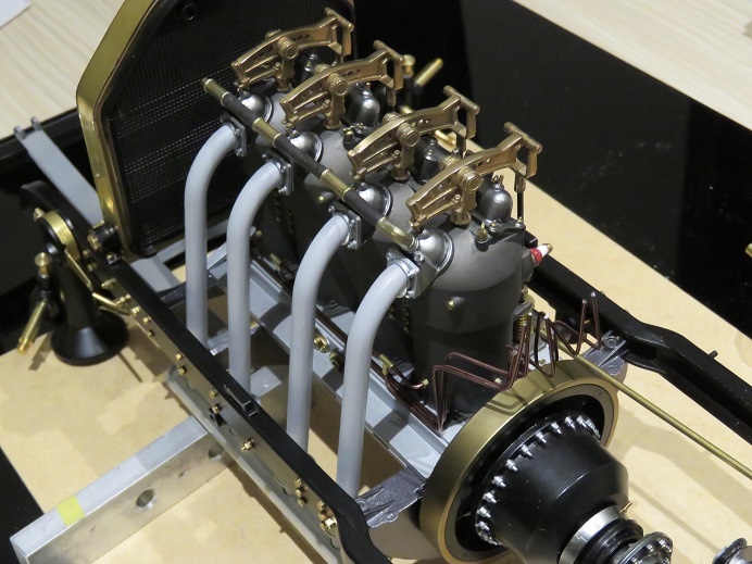

I've finished a lot of the engine parts and been doing some trial fitting. The oil piping runs up into the tank attached behind the "dashboard".
#27 Posted : 26 April 2022 15:20:36

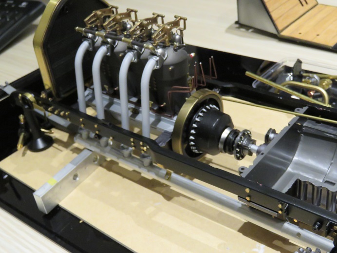

The original hosing for the water cooling had perished so I used heat shrink over a wooden dowel to make the parts. There's still the "S" piece to the radiator to form and I'm putting copper pipes from the lower cylinder inlet flanges to the radiator.
#28 Posted : 26 April 2022 15:25:53

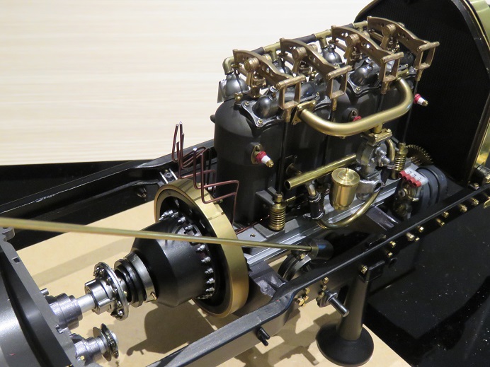

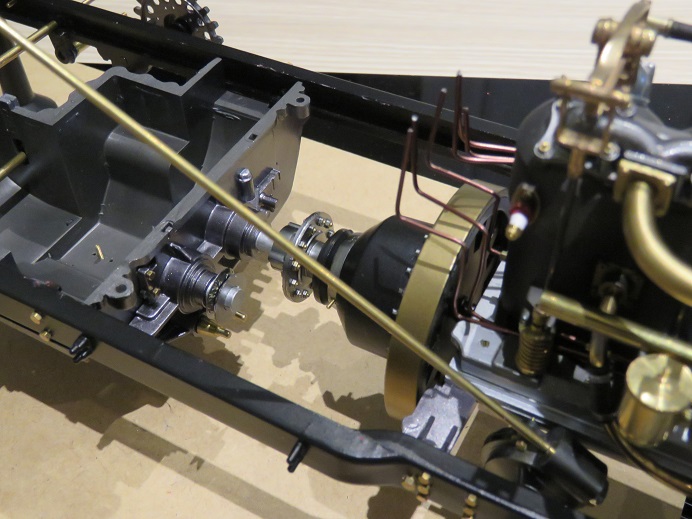

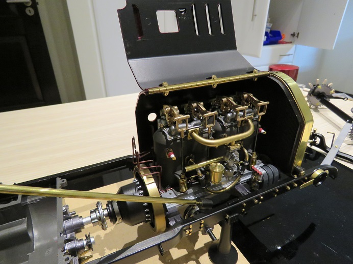

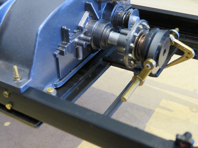

The clutch is exposed to the elements ! and seems to be a spring loaded piece that is retracted off the back of the Flywheel assembly by the conical clutch ring. There's no spring shown in the kit so I'll wind a wire for some extra detail.
#29 Posted : 26 April 2022 15:28:13

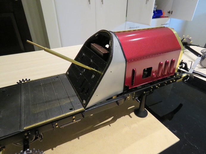

The bonnet in place BigGrin

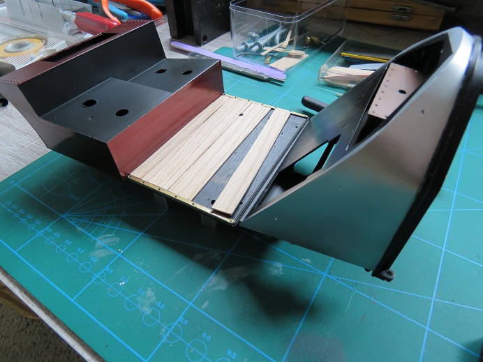

#34 Posted : 13 June 2022 15:41:57
Thanks for all the comments guys. BigGrin

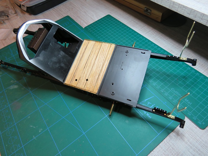

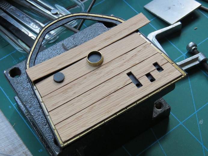

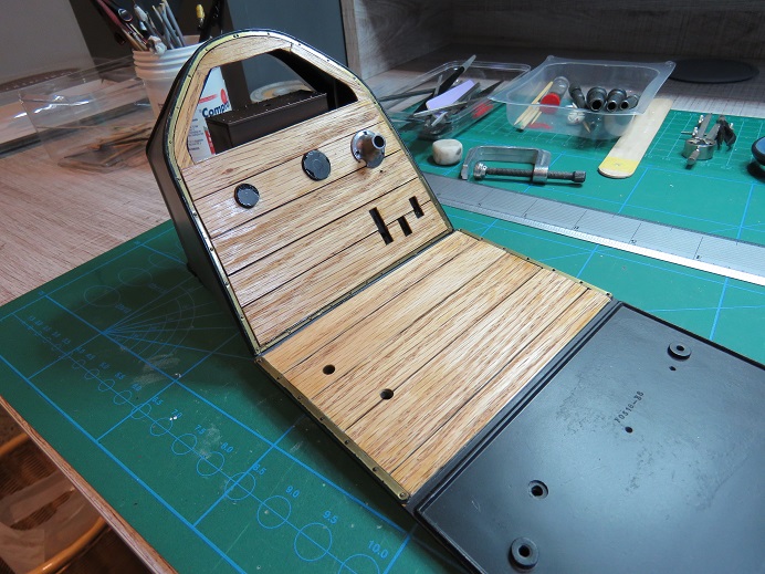

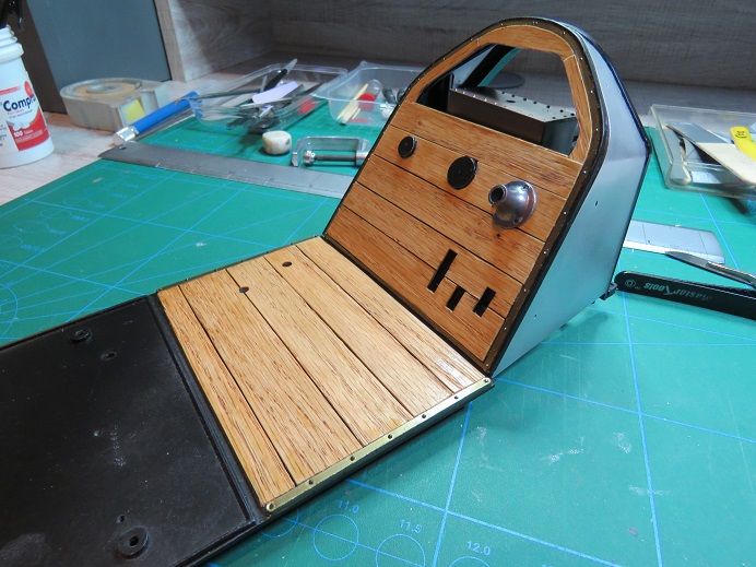

I've been a bit slack on this build but managed to get some work done on the floorboards. I've used a self adhesive sheet of wood veneer and cut strips for the planks following the various widths of the wood effect on the plastic floor and dashboard. There are a couple of Brass ferules that will fit around the bosses to replicate the instruments. I finished it with a light coat of a dark oak varnish but not enough for a gloss finish.

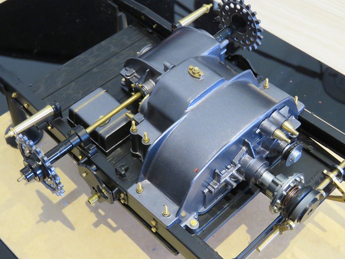

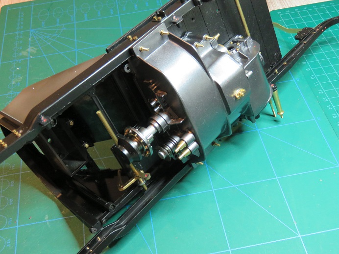

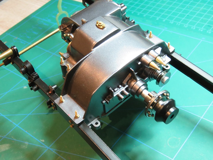

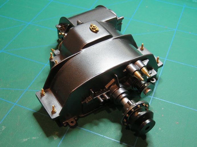

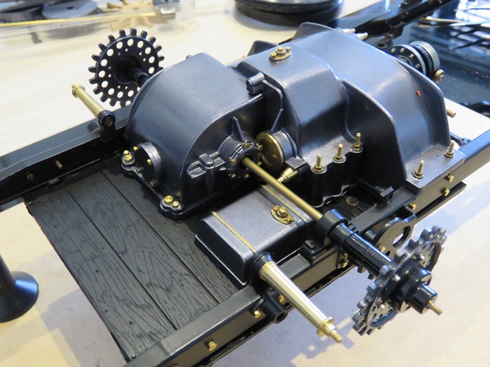

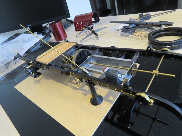

Got the gearbox/transmission section completed and can now start on the final assembly of the chassis. BigGrin
#40 Posted : 03 August 2022 12:36:56
The exposed clutch seems to be a block pushed up against the end of the flywheel and retracted by a conical slip ring. The linkage to retract the clutch ring has been added and I've made a simple spring by winding copper coated wire.
