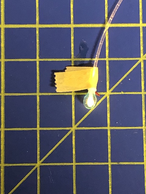

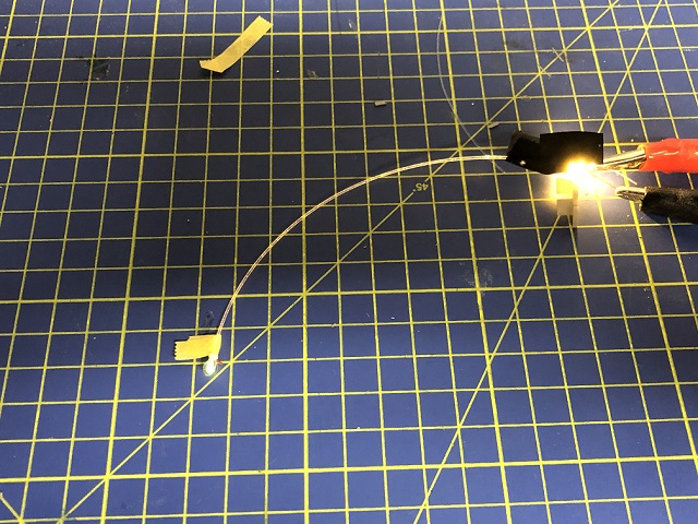

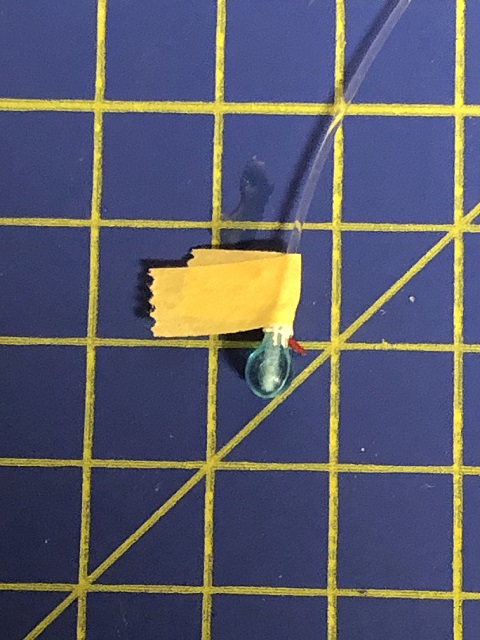

So we are discussing what light to use for the roof. One possibility would be to use LEDs and fiber optics. So here is a mock up of using a warm white LED and a 0.75mm fiber optic installed into one of the kit bulbs by drilling out a 1 mm hole into to bulb.
#40 Posted : 03 May 2021 10:33:28
