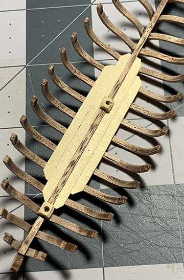

NOTE: This is a very small mod. I wanted to go with a lighter wood for the mast mounts. The ones provided in the kit are perfectly fine.
Mentioned earlier that I jumped ahead to the skiff whilst I await the next issue. I noticed in the instructions for Month 9 there was a photo of the completed skiff and I didn't really like how dark and monotone everything was. This is why I decided to lighten things up a bit - I also like contrasting colors of wood on a build and want to incorporate some of that into this.
First up were the mounts for the masts. Nothing wrong with the ones provided with the kit, I just wanted to make them lighter so they were actually visible to someone viewing the model. Items this teeny are nearly impossible to handle and shape individually, so I decided to take a piece of 4x4mm and carve them out. I made three of which two were acceptable. Once I had them worked to my liking I cut them free and glued them in place. I also drilled the 2mm hole prior to cutting them free. Note: a clean, sharp blade is needed for this. I tend to be very frugal and stretch a blade as long as I can. However, the smaller the bit, the more important it becomes to have a new blade.

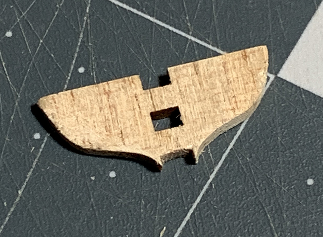

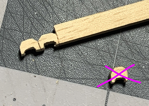

The transom was another instance of "need clean sharp blade". The laser cut piece needs to be modified per the instructions. However, get a bit too happy with the knife and it could go south really quick. Took my time here - "measure twice, cut once". However, this time was a bit more like "measure twice, cut, measure twice again, but a little more...repeat". End result was a near perfect fit. Kept a towel nearby to wipe the sweat from my brow as I surgically removed the needed bit without accidentally hacking off the little pointy parts.
tenderfoot attached the following image(s):

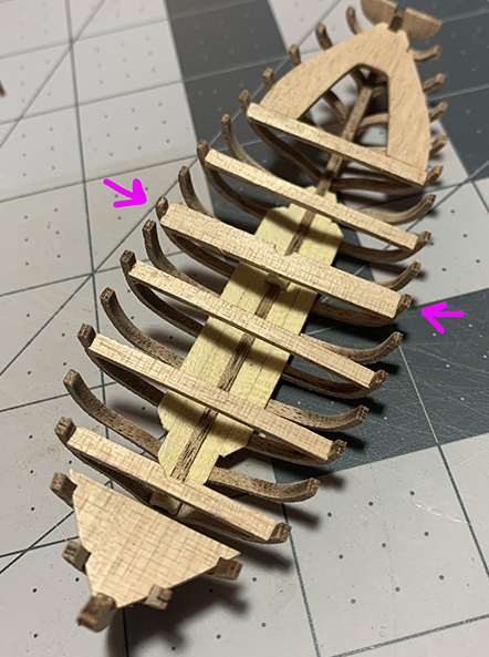

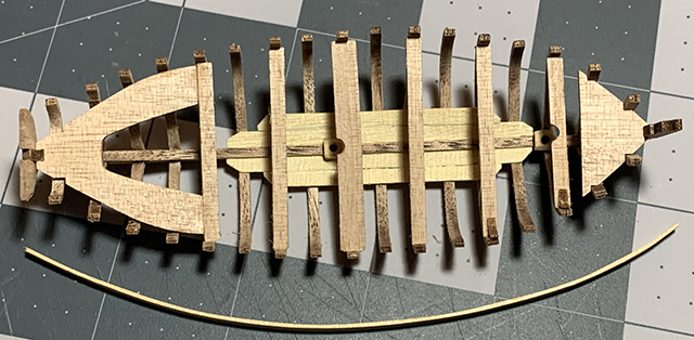

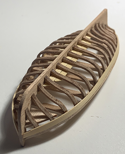

Per the instructions, the next step was to add the top rails. However, after looking at it for a while, and based on some previous experience with the launch aboard the USS Constitution, I thought it would be rather difficult to do this. When you look closely, we are trying to attach a top rail to some very, very, very tiny rib tips. While doing this, the top rail needs a convex bend. Additionally, the ribs need to be manipulated slightly to ensure they all stay in position. Finally, trying to do and this and how was I to keep things in perfect position? No where to effectively clamp, tape, etc. At least, not in a way that would allow fine-tuning.
So I decided to do things a bit out of order and went first to adding the sheer strake. Again, I even decided to change this up a bit partly for looks, but mostly for structural integrity.
It is my understanding and limited experience that the sheer strake is typically wider than the rest of the strakes. The instructions call for a .5mm strake across the board. Because I thought the skiff needed some additional strengthening, plus I wanted to provide some additional surface area for the top rail to adhere, I chose to go with 1mm for the sheer strake. Also, like the decking, I chose to go with a lighter wood for some contrast.
Because of the additional thickness it was necessary to pull out the trusty travel iron and put a bend to the board. Also, because the ribs are soooooo tiny I didn't want to have any real pressure applied, so I took my time and got the bend as accurate as possible.

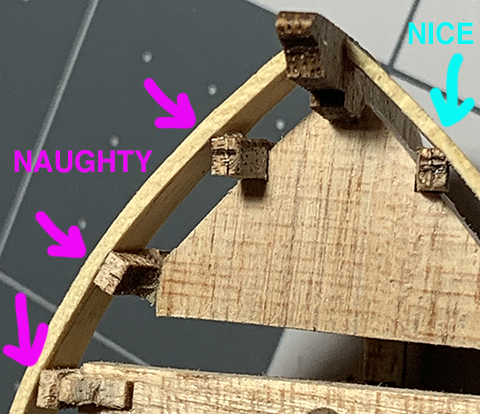

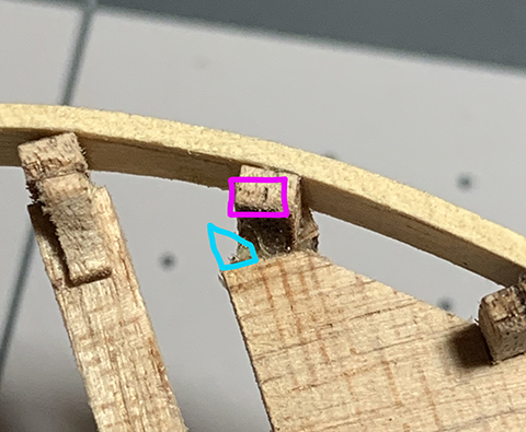

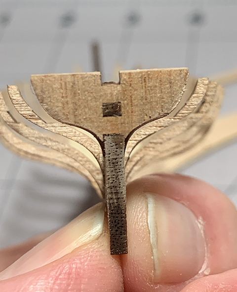

Then it came time to adhere the sheer strake to the ribs...this was scary! Any time I touch those itsy bitsy ribs I get nervous...but in a good way...I love building these things.
I started with the port side strake and first glued it to the transom and rearmost three ribs. After this dried I worked my way to the bow. However, once I hit the last 3 ribs I encountered a problem. Although I had bent the strake to fit nicely, it still added some pressure to these three ribs as it made the tight turn toward the stem. All was good for a few moment and then I heard the dreaded crack of wood...I am sure we are all familiar with this sound...it is awful. I swear I awake at night sometimes thinking I hear a board crack...gets to me that much.
The images below show where the strake actually pulled the rib against that thingy at the bow (one day I will figure out what that is called). The torque of the rib twisting also snapped off the tiny bit. The magenta outline shows the original/proper position of the rib and the cyan outline shows where the piece used to be on that thingy at the bow.
Lesson learned...always fair your frame no matte how small. Sadly, the instructions don't call for this and maybe since they use .5mm planks it wouldn't be necessary. But still, I will never make this mistake again. In fact, I went ahead and faired the starboard side just slightly. Couldn't do too much as the ribs are small enough as is. However, what I could do helped tremendously and I avoided the problem on the starboard side. The magenta arrows show the bad, not-faired ribs on the port side and the cyan shows a nice, faired rib on the starboard side. I strongly suggest folks fair these just a bit to avoid the issue I encountered. Again, only needed to do this to the foremost three ribs. And even there, only needed to do it near the top of the ribs where the two strakes will be applied.
Final note on this, I chose not to repair the tiny bit on that thingy at the bow. I don't think it will be visible and because it is soooo small I thought any repair would be more unsightly then the problem I was trying to solve. If anyone visits the house when this is complete, and points that out to me, I will show them the front door Blink

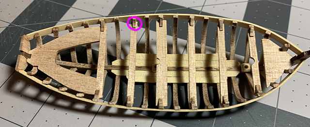

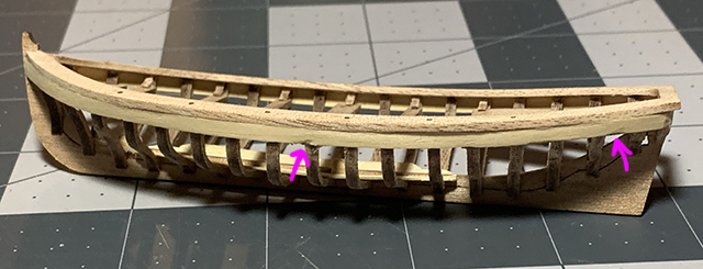

Here it is with the sheer strake applied to both the port and starboard sides. Again, took my time and applied a couple ribs at a time to allow me to adjust things ever so slightly as I went along. Don't try to adjust too much...these tings are ever so fragile.
At this point I also added all the little bits. Don't yet know what these are called (anyone?) but I highlighted one in magenta so clarify what I am talking about.
I then lightly sanded across the top of the strake and ribs to ensure a smooth surface from bow to stern.

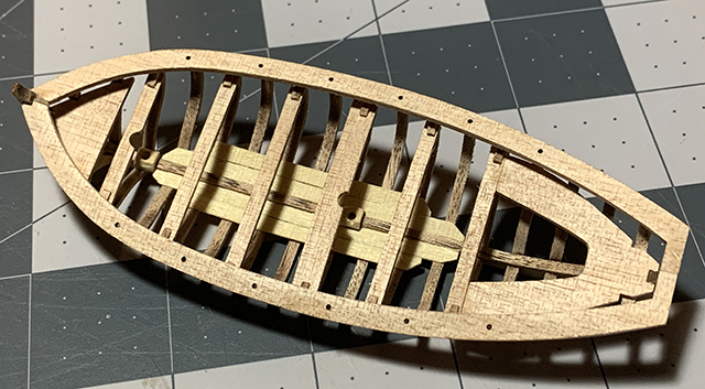

Finally, the skiff was ready for the top rails. I didn't pre-bend these in any way as the laser cut part was pliable enough to attach without issue. This was straight forward and simple...really happy I added the sheer strakes before I did this step.
However, I was a bit too brutal when clamping things in place and caused two small mars in the port sheer strake (see image below). Thankfully, a bit of water dabbed onto these spots and the wood sprang back into place. Next time I will prebend the rail to prevent this.
With both rails applied, the end product looks really good. Now I think I will set this aside for a while as I continue to contemplate if I want to plank one entire side or not. Still need to add another strake to both sides at a minimum, but this can wait as well.

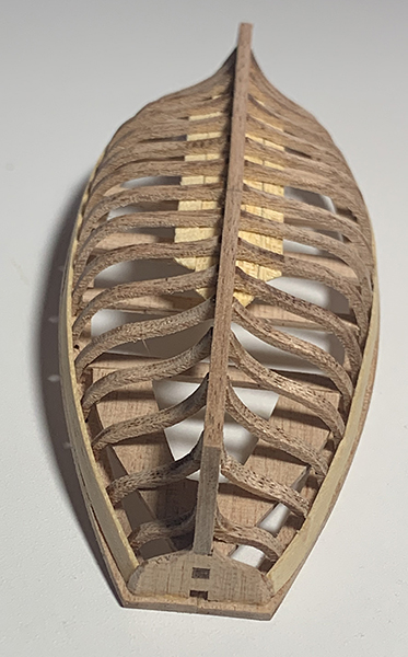

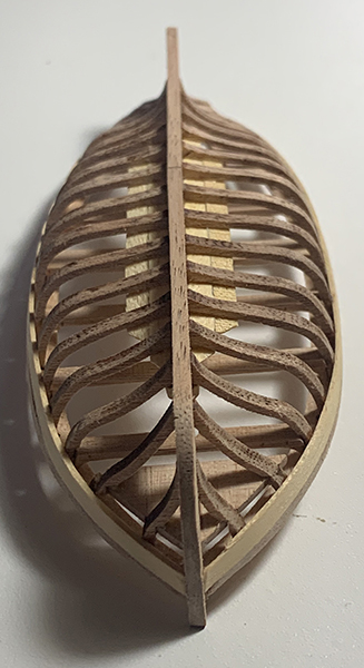

Below are a few images showing the skiff from underneath. Just thought these really highlighted the details and also I just like seeing the pattern all those ribs create.
That's going to be it for a couple weeks. Have a big project I need to focus on for work. In the meantime, I will be skulking around the logs...just won't be building anything.
Cheers!
