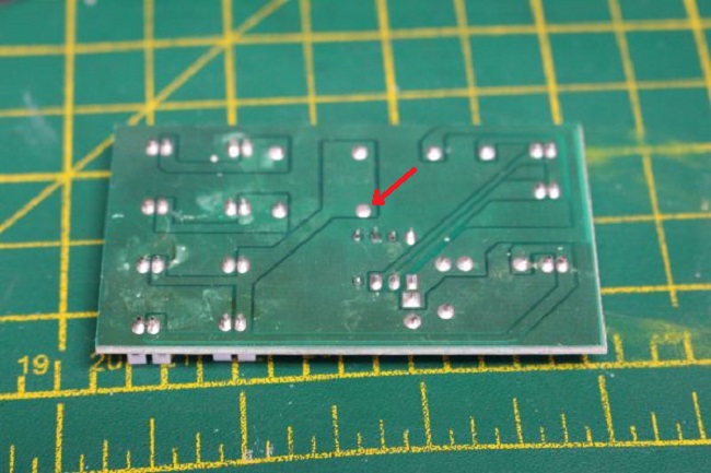

#28 Posted : 23 February 2021 16:20:56
Hi Gary
Looking at your pictures, I think you may have some dry solder joints on the chip. They look like they need a little more solder.

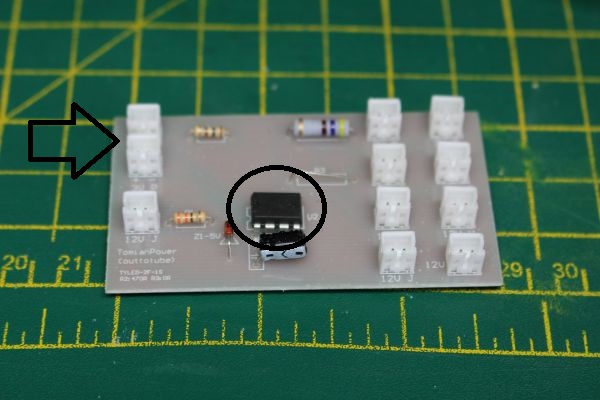

#29 Posted : 23 February 2021 17:13:56
Are there any markings on the chip.The two sockets that the arrow is pointing to .Do those light flash? The chip looks like either a 555 timer chip or maybe an atttiny85, but you would only need those chips if the lights flash.
have you tried plugging all of the lights in.I cant tell from the pictures, but it is possible you may need to plug everything in for the board to work.I assume the motors are on a separate board?
If you have a multimeter you can see if there is power going to those sockets too.

There are no markings on the chip, and unfortunately I don't seem to be able to open your picture. As I previously stated, the motors plug into the board in the nacelles with the lights on. This board is connected through the pylon, down to the engineering board through the only soldered connection I have made so far. I do not have a multimeter, so cannot check voltages and such.
Going by the diagram I posted, the two sockets marked 'P' are for the two lights, one on each side, back near the hangar bay. I presume they are supposed to be steady.
Underneath them is the main power input marked 'J'.
The two marked 'J' on the bottom right side are the two connectors that take the power up the pylons and connect to the boards in the front of the nacelles. If it was only these lights that didn't work, I would have assumed that it was the boards there that was causing the problem, and just moved on. I do believe the lights in the nacelles flash to create the effect, but at this stage I may be wrong.
The socket marked 'G' goes to the LED sections in the neck, which should not flash.
The socket marked 'H' is the connector to the board to be installed in the saucer section.
The sockets marked 'E' are for the three LED sections that are installed down each side of the engineering hull.
Sockets 'Q' and 'R' are for sets of wired lights that illuminate the hangar bay. These lights should be solid.
There are certainly flashing lights in the set. The port and starboard navigation lights are ones that flash. There are not individual resistors that I can see on the different sized individual LEDs, but according to the instructions, there are resistors built in to the LED strips.

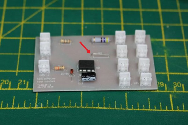

#31 Posted : 23 February 2021 19:06:56
Hi Gary, BigGrin
I`ve taken a close look at the PCB pics you posted and here`s my thoughts.
The wire referred to earlier is a link from one track to another as tracks cannot cross each other.
I think that wire is not connected properly at one end. Link wires normally lay flat to the PCB and yours doesn`t appear to do so. Also on the flip side of the PCB I don`t see any wire poking through the solder. It may be that the wire at that end is being held in place by the solder flux and not the solder itself. May be worth a try to melt the solder on that connection and push the wire through the PCB a bit more.
Just my thoughts. I`ve added two pics to point out what I mean.
