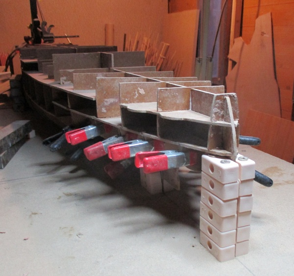

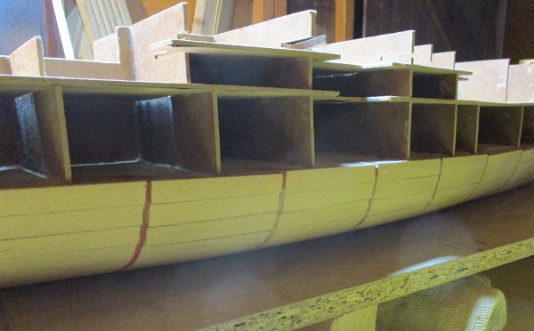

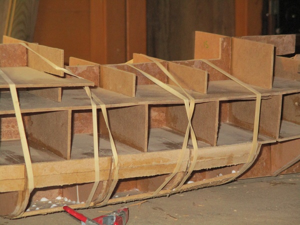

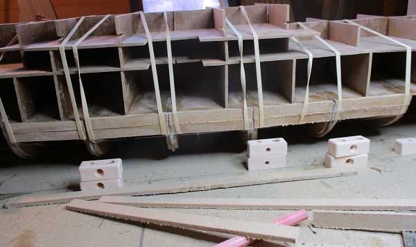

Starting to glue the frames to the keel
As the frames go into the keel from the bottom.....
I applied the glue liberally and brushed into the joins
Too lazy to remove from jig apply glue to keel and frame then try and get everything back Bored into the jig again
Made a start on the lower frame supports ...following as per CARD build
These were made out of 3mm mdf instead of 2mm
This should offer more area to glue the "planking" or "inner skin" between the frames then sand flush with the frames
Well thats the planCrying
Also 3mm mdf is cheaper than 2mmLOL Flapper LOL
Thanks for lookin'

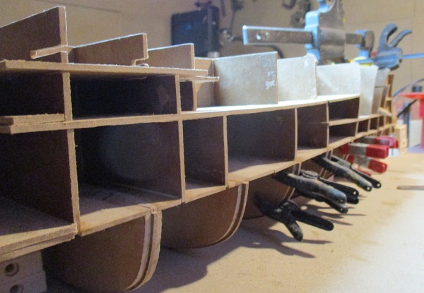

#27 Posted : 27 November 2020 16:54:47
Joined: 20/03/2010
Posts: 1,199
Points: 3,473
Location: Glenrothes

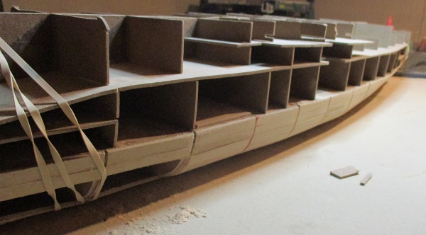

BigGrin Hi Folks

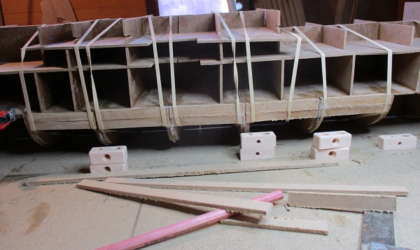

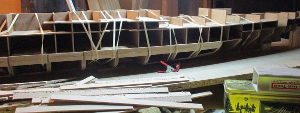

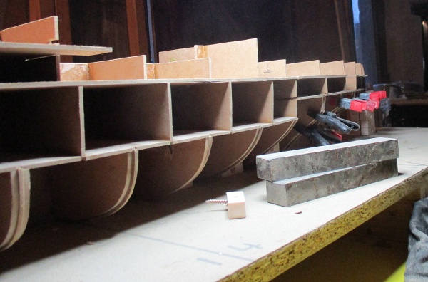

Just a wee update of progress so far
Still doing the supports for the bottom frames, and to help break the monotony glueing the upper frames in place
The decks are not glued as still to remove the card templates, they were slid into place to keep the frames squarish
Talking off breaks ..Crying I broke the pointy bit of one of the decks at the bow but not concerned as will be filling that area
Thanks for lookin'

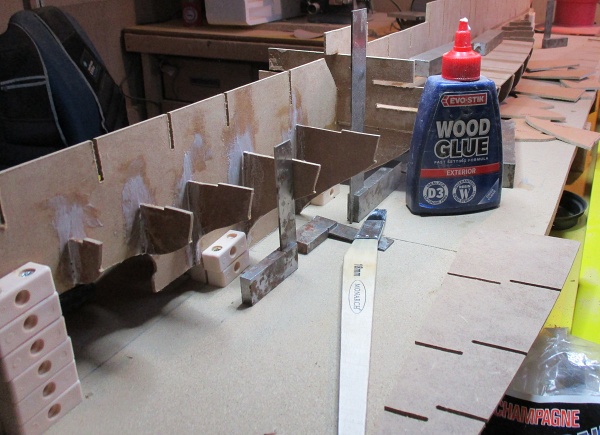

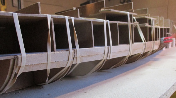

#29 Posted : 28 November 2020 15:02:09
Joined: 20/03/2010
Posts: 1,199
Points: 3,473

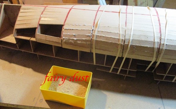

BigGrin Afternoon Folks

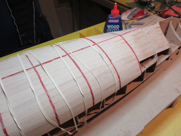

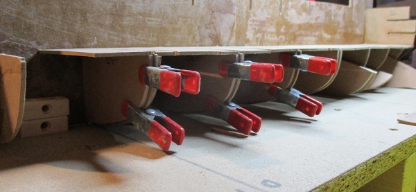

Started planking in between the lower frames using 3mm thick strips
As these will be covered with an outer skin or planking I just cut strips from the A3 size mdf sheet
These planks will eventually be sanded flush with the frames
The decks are still not glued in place they are to help keep everything tidily boo especially when out of the jig
She was removed from the jig to add the planks then put back in the jig when taking a break

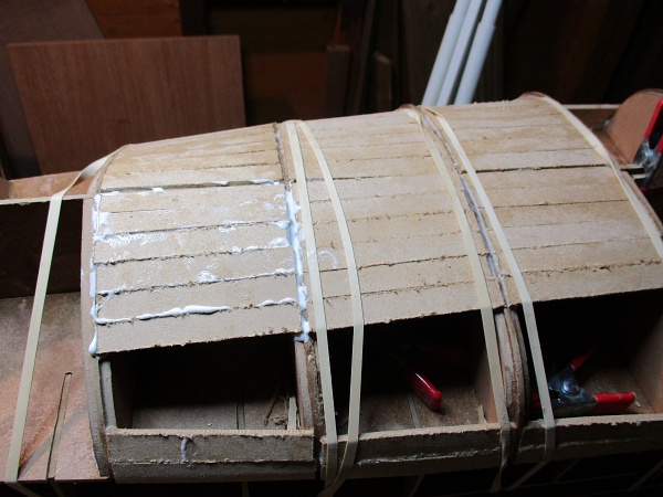

I was Blink thinking Bored about using the templates as per a card build for the outer skin...
by using styrene
I think it is a good idea IF I can get the styrene to stick to the hull
Has anybody tried this and if so what glue would you recommend
Thanks for lookin'
budgie attached the following image(s):

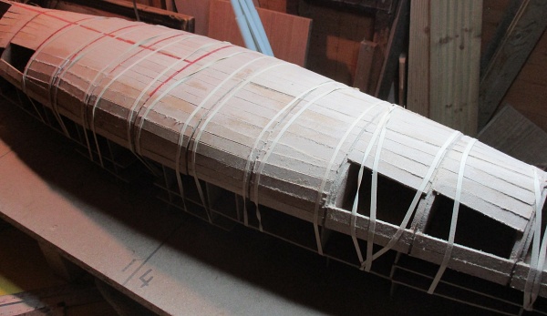

BigGrin Evenin' Folks
progressing slowly Cursing but quicker than trying to see pics of other build diariesCursing
Very frustrating
Anyhoos pics of progress if u can see em

Eventually, one day in the future sometime (timing is non-committal as yet)Blink I will be using styrene sheet on my own card model ship conversions but as I'll be using plasticard for the ribs and structure as well, it'll just be the normal 'welding' type liquid poly glues for mine. I don't think there's any way to weld the plastic sheet to MDF, it would have to be one of the contact adhesives I think, probably one of the 'Evostick' family. The only problem then of course is that its an instant grab application so you'll have to be dead on target first time with no 'wiggle room'!
The hull sides and superstructure should be fairly straightforward but you might need to heat or warm up the styrene to pre-form it to the bow and stern curves (unless the sheet is really thin and flexible).
The best of luck with your solutions anyway, (and yes, I will be pinching them for mine in the future!)Flapper

Not sure if the following “WikiHow” might be of interest as it gives some suggestions on gluing plastic to wood.
https://www.wikihow.com/Adhere-Plastic-to-Wood

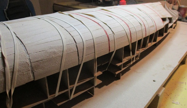

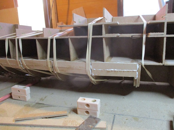

#34 Posted : 29 November 2020 16:38:46
Joined: 20/03/2010
Posts: 1,199
Points: 3,473

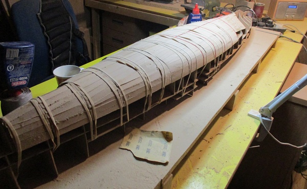

BigGrin Hi Folks
Thanks for replying Robin and Tony appreciated

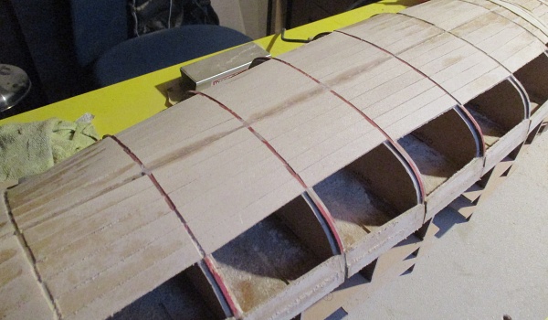

Sounds like I will have to experiment Crying with contact glue which I have not used before if I decide to use styrene for the outer skin

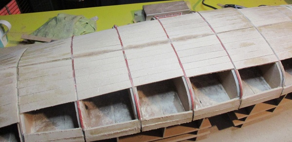

Anyhoos got some more of the hull "planks" done but after a couple of hours started to get fed up
Tried to fight the urge to see what she will look like after a bit of sanding and lostLOL
Sanded the "planks" that I did yesterday as the glue will have set on those
The dark patchy line is glue mixed with sawdust still a bit damp
Have not sanded down to the actual frames just yet (red marker pen) that will get done once the lower hull has been fully planked and sanded
Thanks for lookin'

Just had a thought, whilst you are experimenting, I wonder what a few coats of the epoxy resin used in fibre-glassing would be like if that was brushed over the mdf and sanded smooth once cured? That should bond to the mdf ok and if thick enough could also have panel lines inscribed too.

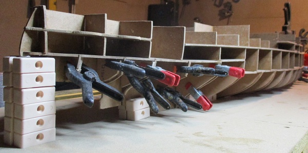

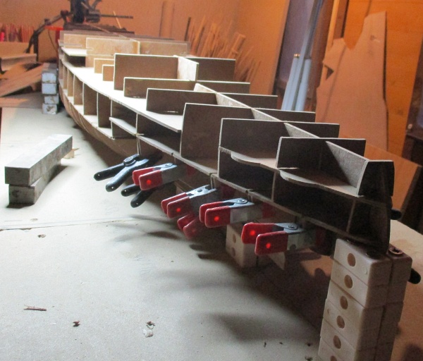

#36 Posted : 04 December 2020 16:52:29
Joined: 20/03/2010
Posts: 1,199
Points: 3,473
tigerace wrote:
huge scaleBlink this is going to be something to followBigGrin great startBigGrin
Regards philCool

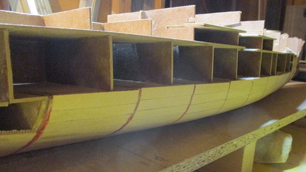

Cool Hi Phil

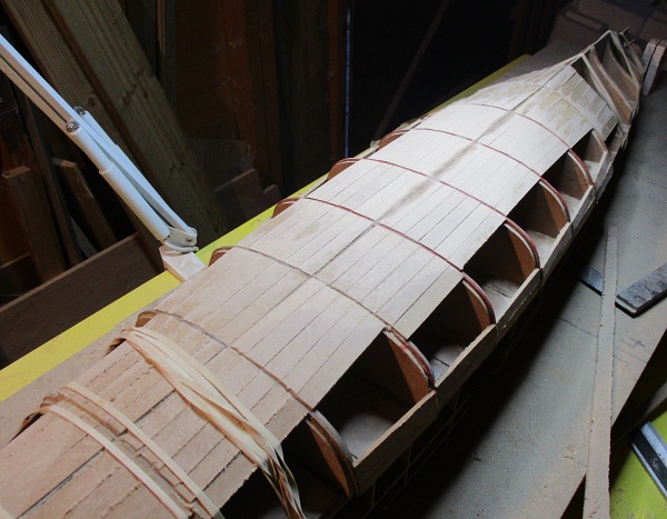

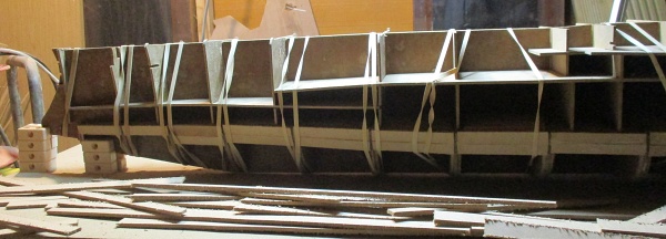

believe the 1/200 scale Bismark is 1250mm
I have doubled the scale on this model to 1/100 giving length of @ 1440mm so not too badLOL
Anyhoos getting there slowly with filling in the gaps between the lower frames leaving theCrying pointy end and stern till lastCrying
