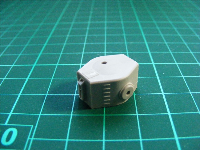

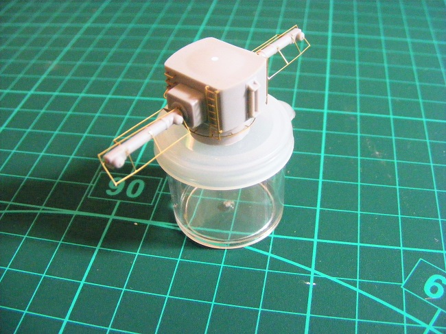

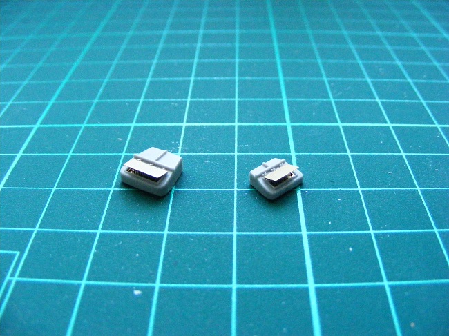

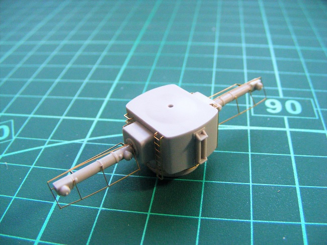

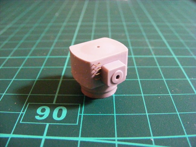

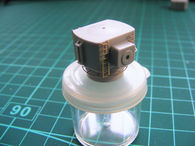

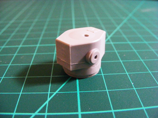

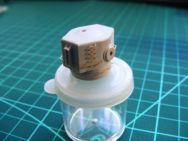

Bit more done, managed to finish the last 2 small vents and from there moved onto something a little more challenging, the first of the Artillery Range Finders. First I noticed there was a very noticeable gouge on the hatch at the top, this I filled with a little putty and sanded down. Next task was to carefully remove the ladder rungs and sand the unit smooth then attach the circular base.

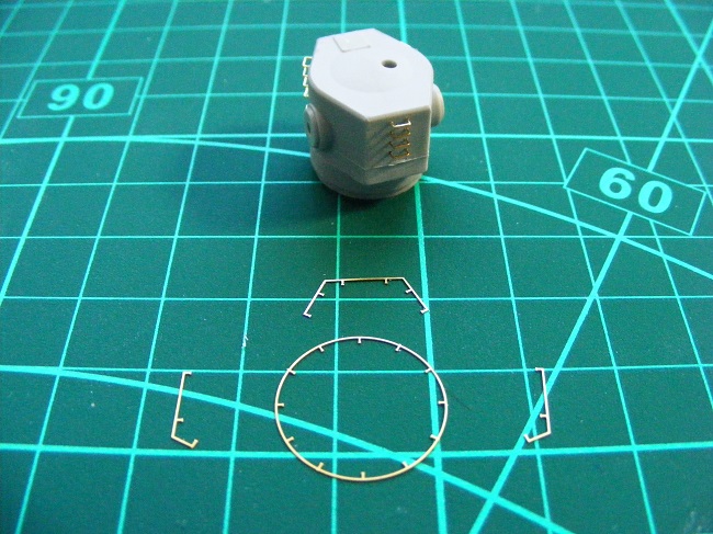

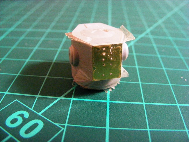

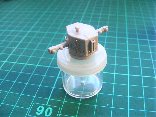

For the fitting of the new ladders to the rear and sides the etch set provides templates for drilling the holes. These were simply taped into position using clear tape then the holes were drilled with a 0.3mm bit. The rungs were carefully removed from the fret and glued into position. Noticed here that the template for the rear of the unit contains 5 pairs of holes to be drilled but all reference material I've seen shows there are only 4 rungs so left the last one off for now. Also, the two side sets of rungs is missing a rung which is fitted on the circular base section. Have left these off for now as I don't know as yet whether there are any extra rungs provided with the etch set, may have to fabricate and fit these later.

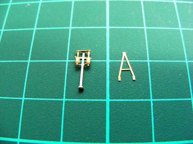

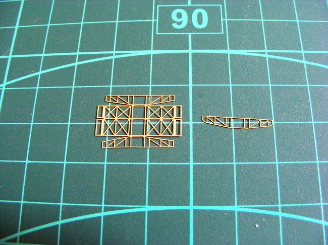

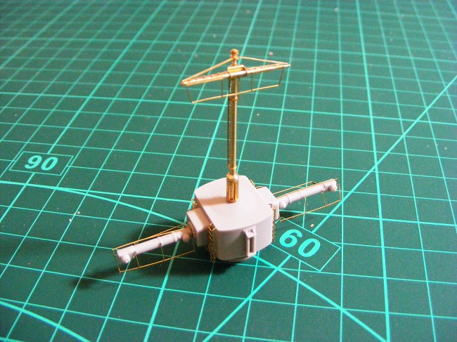

Cut the 4 rail pieces and glued these into position. Have to say this proved to be a little fiddly but found it was good experience gained. Finally added the two arms and dome unit on top.
Have left the radar units for now for two reasons. Firstly, I haven't come to a landing on which version of the Bismarch I'm going to build, earliest versions didn't have the radar units fitted. Secondly, not sure whether to prime and paint the parts of the radar units prior to assembly so will come back to these a little later....
Time to start a second unit, they are all different... Cool Cool

That is going to look so good with all that additional detail.
You sort of accept on kits the solid moulded grap handles but when you see them replaced by proper rungs it really stands out the difference it makes.

You're spot on Tony and with this kit the vast majority of moulded detailing has to be removed and replaced with etch, some of which is truly tiny.... Am sure all the effort will be worth it in the end....Cool Cool

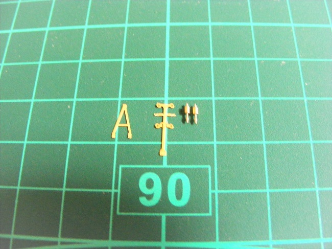

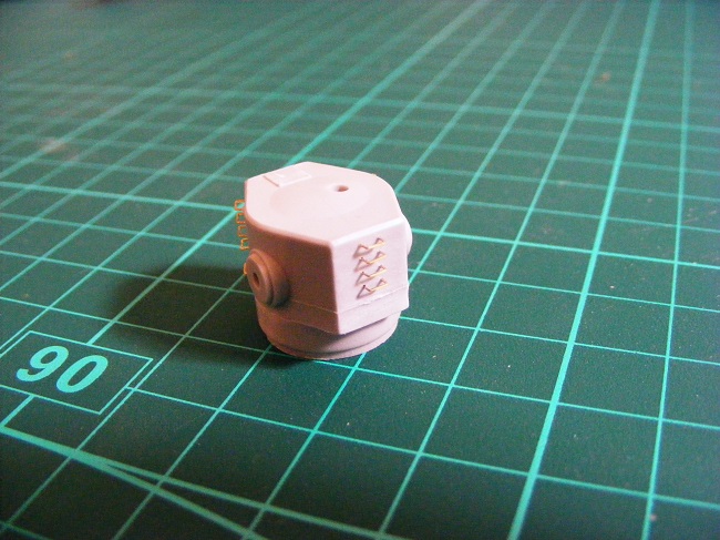

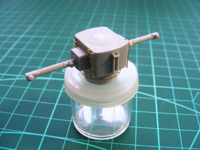

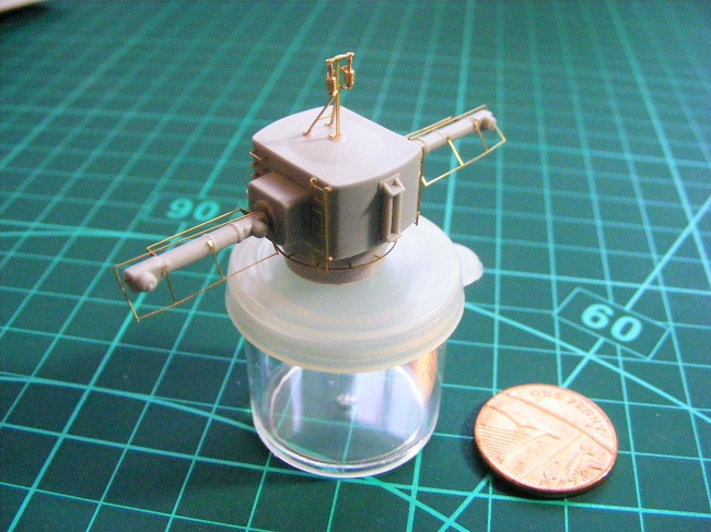

Thanks for all the comments guys, always appreciated....Cool Cool .. Second of the range finders now assembled. Done in much the same way as the first one, use of templates, drilling holes and the fitting of some etch parts etc. Little bit of a mishap here. One of the footrails (rail that is attached to the side arms) was dropped and unfortunately is somewhere in my workshop. Wouldn't mind if it pinged off somewhere but it was just dropped and is nowhere to be seen. Crying Crying .. Will leave it off the last rangefinder for now, in the hope it will turn up one day. If not then I'll have to fabricate a new one which shouldn't be too much of a problem as it can be done from some of the spare railings I have...Cool Cool .. Filled the locating hole at the top of the unit with putty and sanded it smooth.

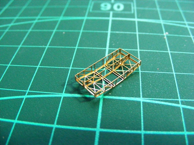

Assembled the mooring manoeuvring lighting unit, certainly a fiddly part to get done with some real tiny parts... mounted the unit on top of the range finder. This assembly is now ready for priming.... More again soon....Cool Cool

That all looks incredibly neat Alan.
And thats something else you have great skills in - getting all that etch neatly aligned.
Its so east without locating holes to get things slightly off centre and boy does that stand out, but yours is all going into place perfectly.
Also so impressed on such small parts that your gluing is invisible.

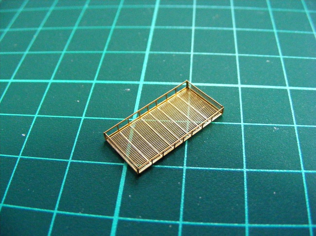

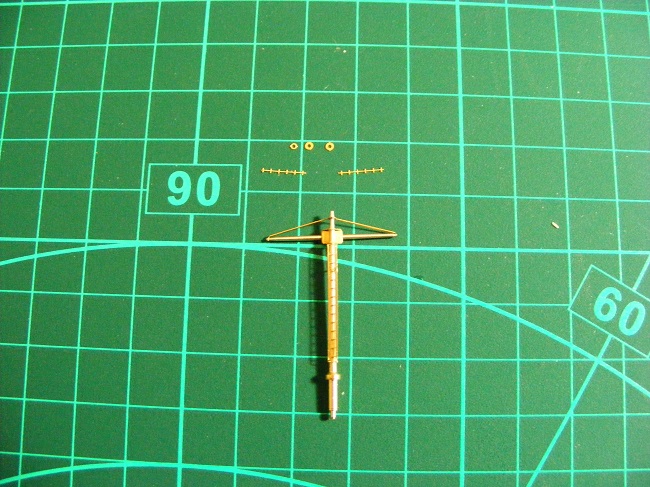

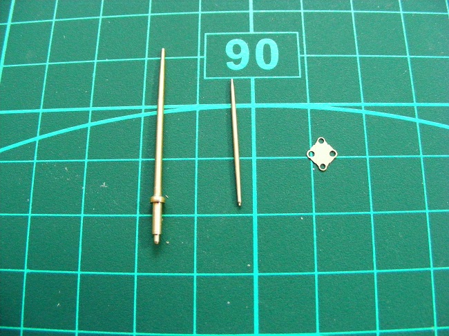

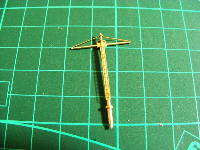

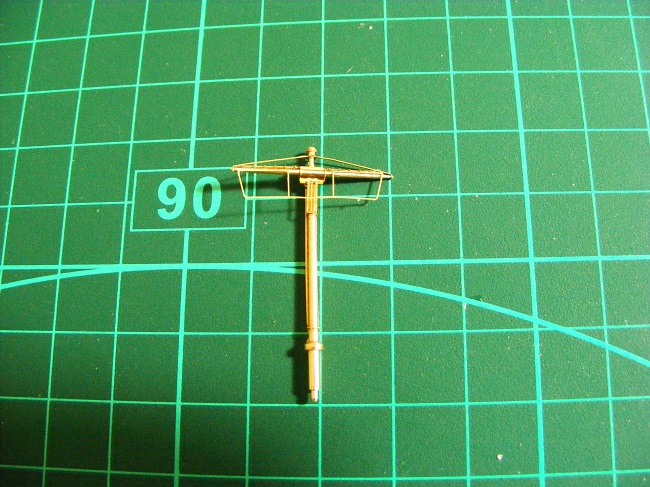

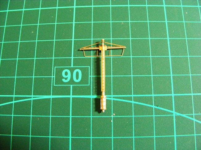

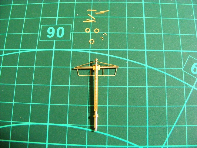

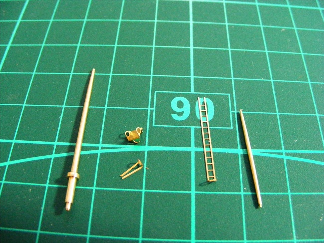

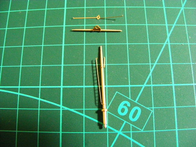

Got some more done, assembled the third of the range finders and this one was the same as the second one. Decided to have a go at assembling the After Mast which sits on top of this range finder. It is here I found my first moan about the Pontos instructions. The mast contains some 30 etch and brass parts and some of them are absolutely tiny. The instructions show you three small photos but does not give an order of assembly nor do they say which way the parts should be bent. Had to study the pics very carefully, magnified too. This with lots of dry fits enabled me to work out an order of assembly and I think I got there. Definitely the most complex and fiddly thing I've worked on....Cool Cool .. Now to decide what to do next....BigGrin BigGrin

That does look small and tricky but also looks very professional, looking forward to the next post.

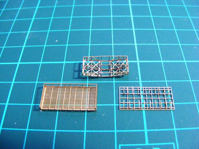

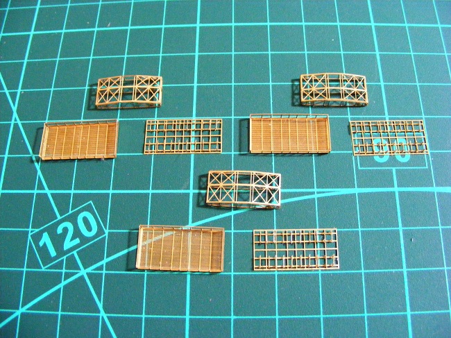

Had a closer look at the radar dishes that sit at the front of the range finder units, with a view on how to construct and paint. It was here I realised there is much more to the construction of these than I first thought. Each radar dish contains a total of 24 separate parts so with 3 to do that's 72 parts in total. Assembled the 3 separate units for each dish and it is here I will pause with the final assembly being done when the units are primed and painted. Think they will be easier to paint this way....Cool Cool .. Until next time....
