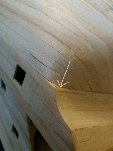

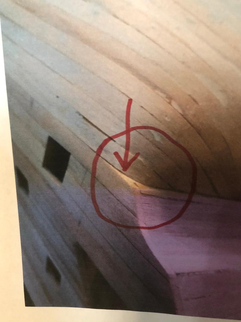

I took the liberty of borrowing the first photo you sent me and cycled and
pointed the the area of interest it looks like you started the angle before the
edge of the support gallery in fact the plank look like it comes to a point LOL
if you don't mind me saying if you look at the photo I sent you will see
Ronnie

Ron I started the cut about here I think .reg Tom

ok I see but doesn't it give you the impression it looks like it comes to a point
