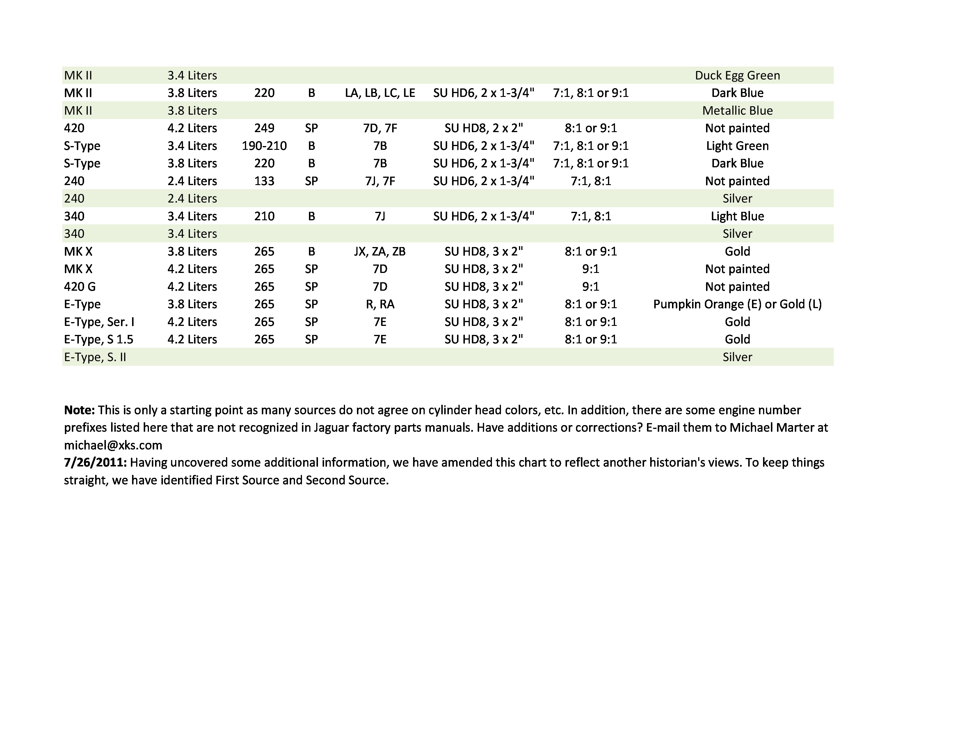

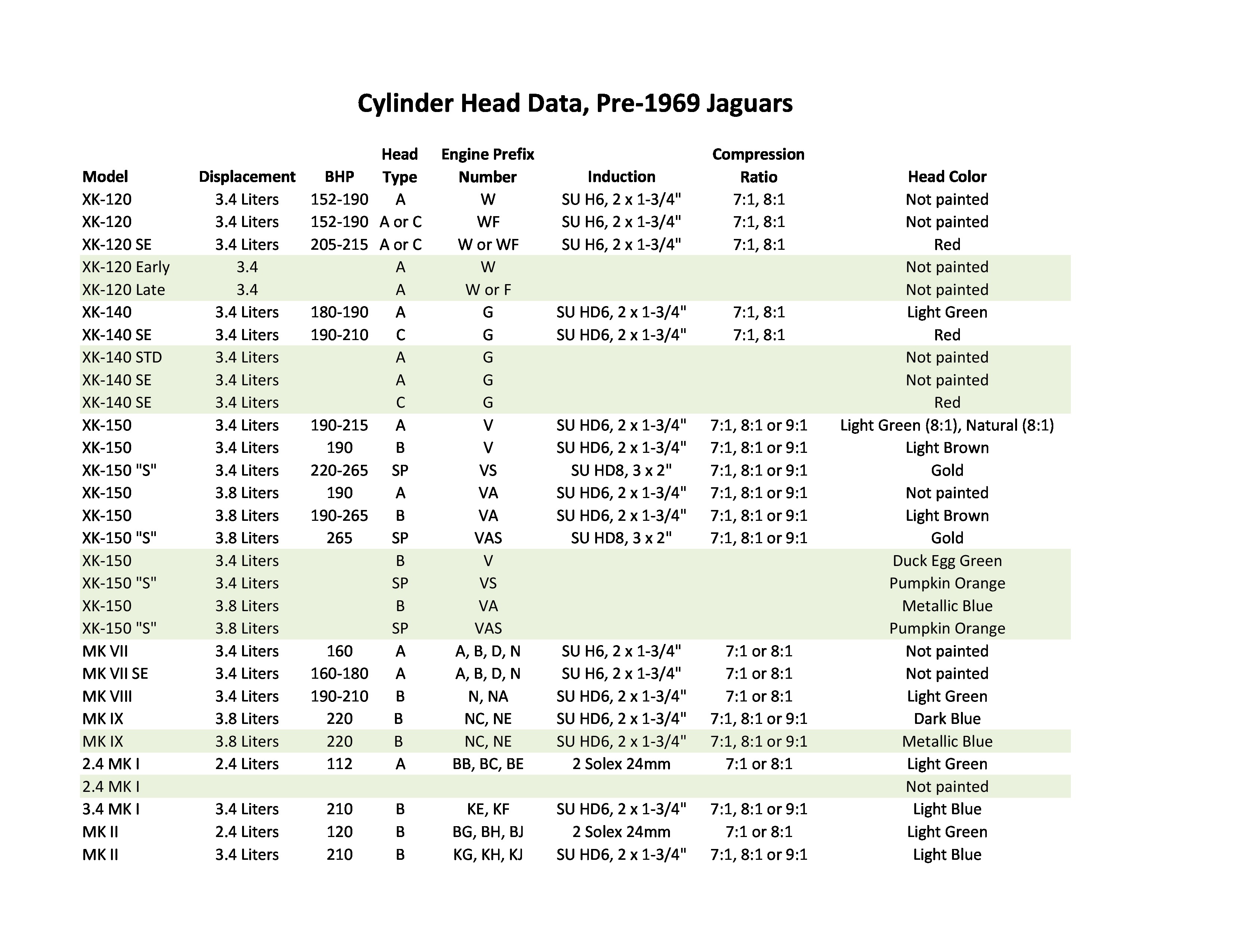

As a follow up to Roys comments about Jaguar head colours.
I thought you and other Jaguar builders might find this interesting.
If any would like the pdf please send a PM

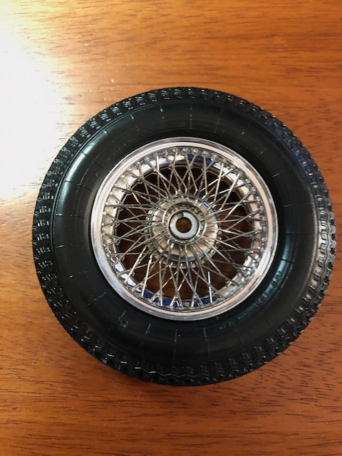

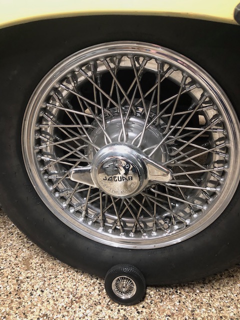

Some progress photos. First are a couple of the finished wheel and tire...by itself and then I sat it next to the real one, as I did for my prior posts. I lightly sanded the "tread" part of the tire so that it is not as shiny as it is out of the box. I think that helped the realism a little.

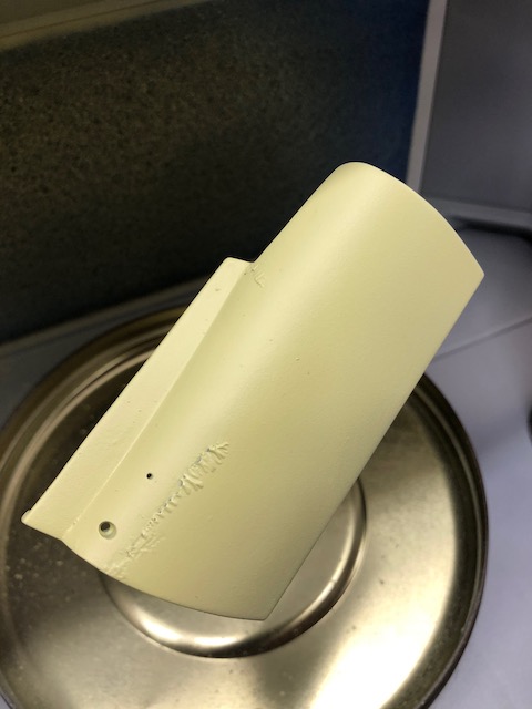

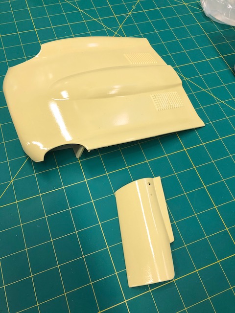

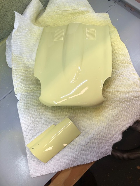

Next are a couple of photos of the re-painting process that I am using for the "pale primrose" color to match my car.
I am using the same paint as I am using the on real car, including the clear coat. Here are some photos with the clear coat on. Note on the last photo you can see an early problem that I had on the doors. I found out that if I sand through to the original primer that comes on the parts, my paint will react with it and bubble. I see to need to sand off "all" original paint to bare metal...or just lightly sand the paint not through to the original primer. I am now choosing the 2nd option for ease.

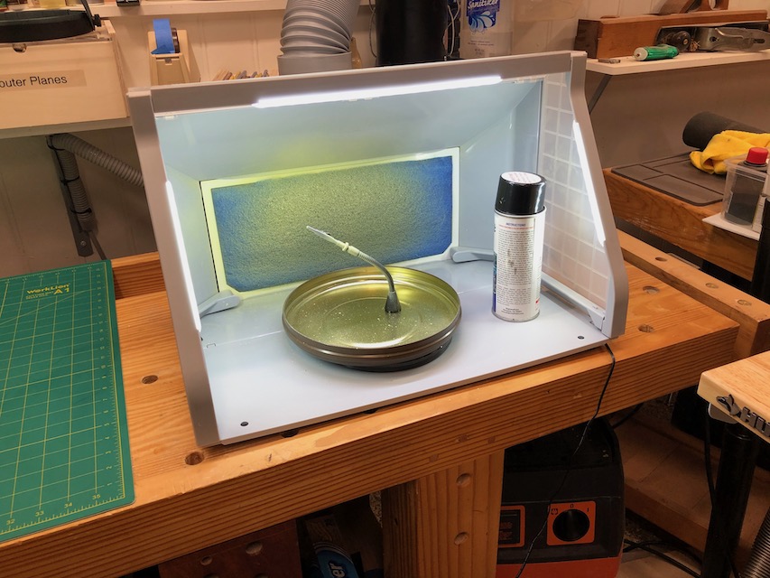

Final post for this time. I bought this spray booth on amazon now that it is cold out so that i can still spray paint these rattle-can automotive paint parts during the winter. It is potent stuff.
I am thrilled that this spray booth vented by hose out the window actually works! I was skeptical. Really happy with it.

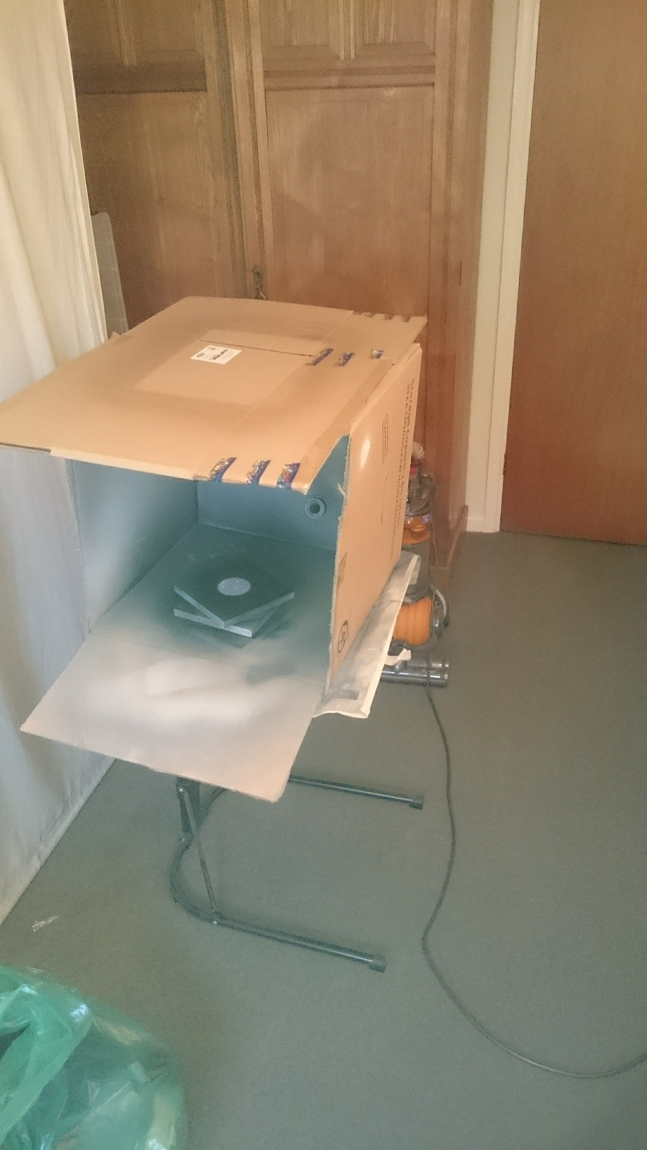

Hi there,

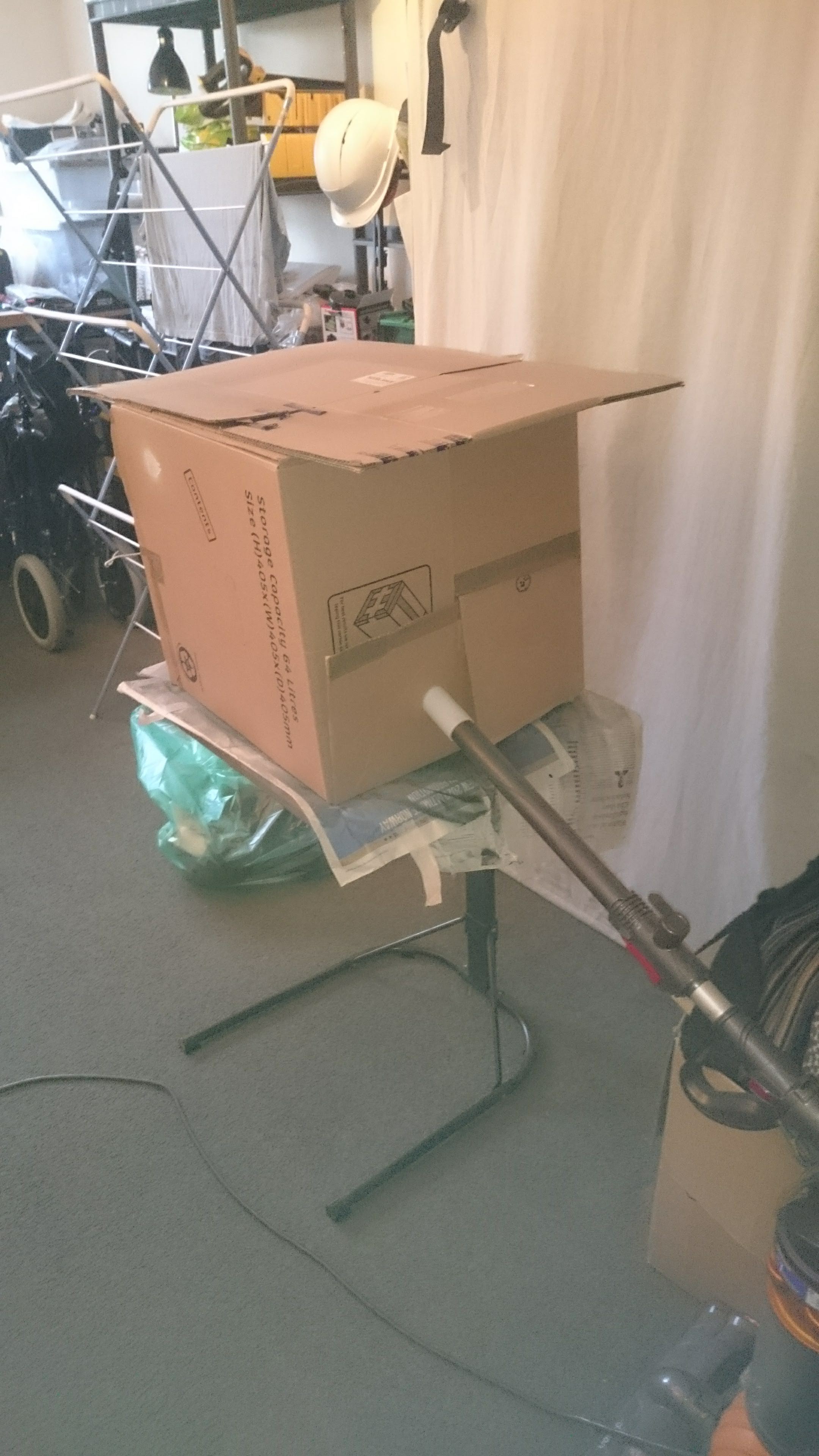

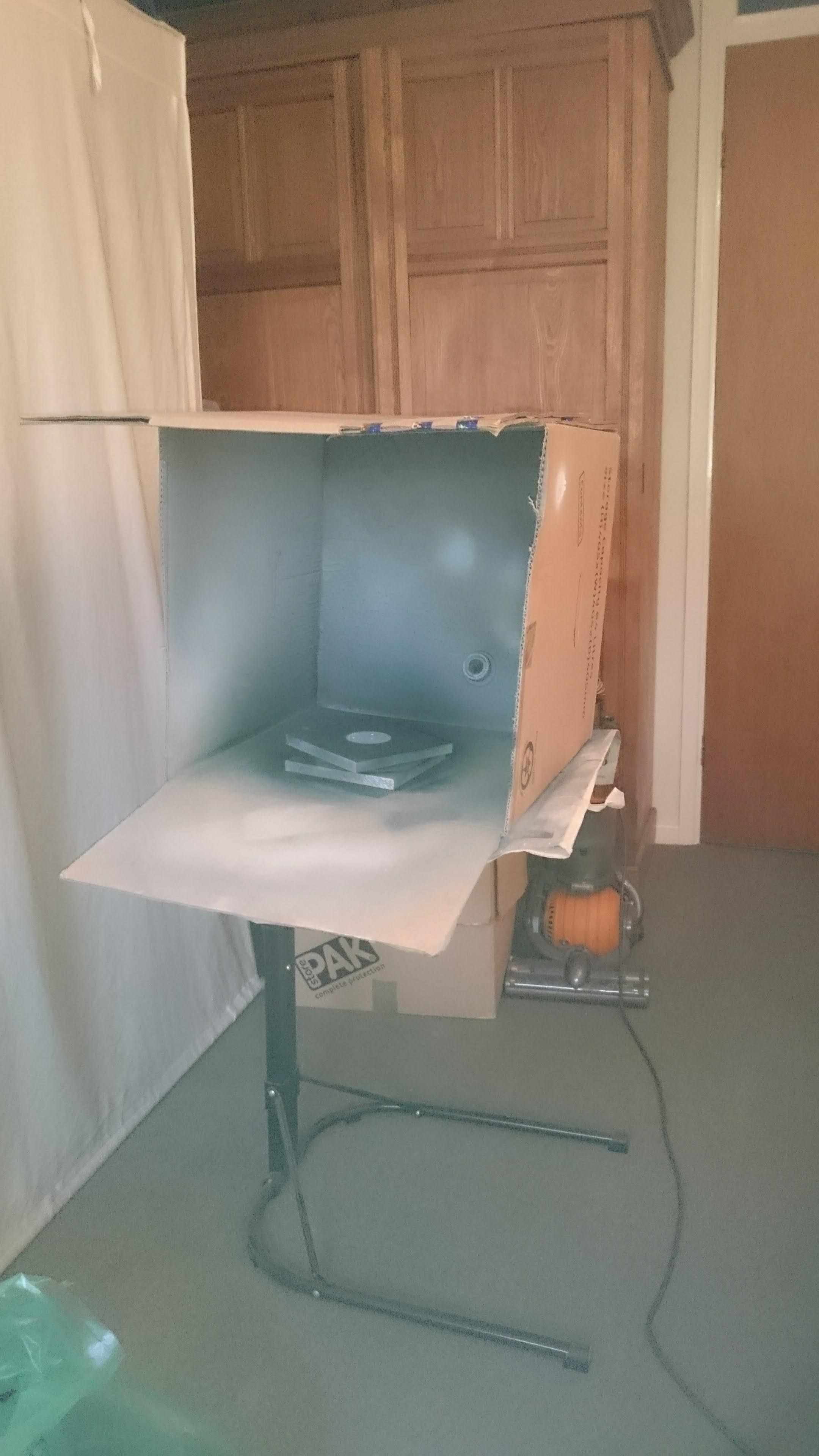

I made a spray booth out of a packing box, an old dyson vacuum cleaner and a cake decorating turntable.
Obviously not as good as a purpose built off the shelf unit but it does work.

Nice home-grown spray booth, Chris! I made one of those first (minus the Dyson) and did not have enough suction. The Dyson likely did it for you.
The Amazon one that I bought is a "dual-fan" version since I was concerned that the rattle can spray stench would overwhelm the single fan version. Not sure...
This is the one that I bought; Double Fans Airbrush Spray Booth by Ophir. It looks like there is one Chinese company that makes all of these under different generic names as far as I can tell.

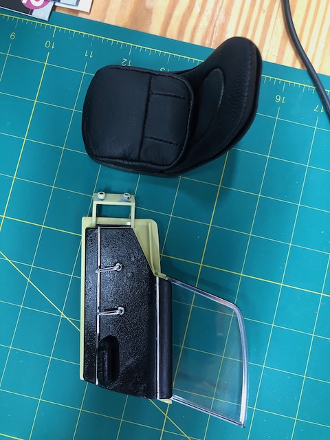

Below are photos of the finished door and driver seat. Both have been re-painted from green and tan to my car's pale primrose and black.

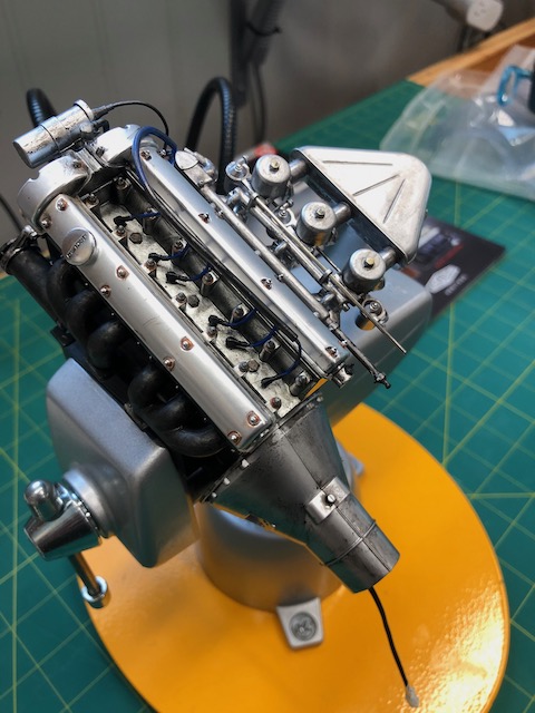

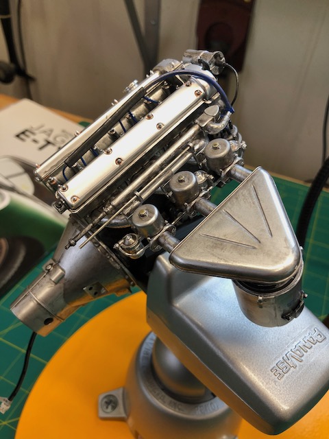

The engine is now more or less complete, with light weathering and wear to match my actual car. Also has blue plug wires (hard to see in the photos) to match those on my car. I also sprayed and clear coated the second door pale primrose, but it appears that my new can (from same source) is not the same shade as the old can. So I have ordered another can with hopes of a better match.
