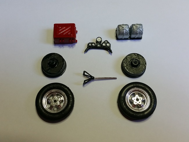

#23 Posted : 12 August 2020 18:33:30
Hi All, BigGrin
Small update:

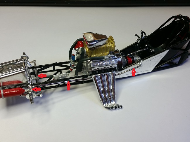

Pic 1
Have added the tie bar for the front steering, along with the longest steering rod I have ever seen from the side of the drivers cockpit all the way to the left front steering point(red arrows)
Pic 2
Some of the parts prepped for the next stages to follow. (Top to Bottom and Left to right)
Electrics Box - Drivers Dash - Parachute packs.
Rear drum - steering handles - Rear drum
Front wheels and tyres (waiting white lettering).
Rear drums just blacked up so not to show behind the rear wheels.
More to come soon. BigGrin

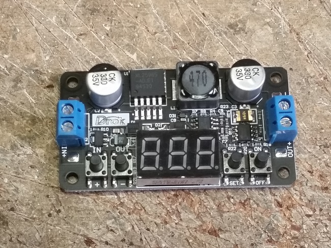

Well here`s the first update on how I hope to get this display working.
There are numerous power supply units that supply a choice of dc voltage outputs but they are set outputs. For this project I need to be able to test the electric motor at a choice of speeds to ascertain which speed is best.
One of our forum support team, Mark Warren, who has some experience in these matters suggested I try this item, (link below). It allows you to put an input voltage of between 5v and 32v and gives an adjustable output of anything you want from 0v to 30v all at the press of a couple of buttons. This means that I will be able to control the motor speed very accurately to get the best effect.
At £15.99 its not cheap, but if I had to buy several motors and drive gears to get the effect I`m looking for it could cost me a lot more.
Here`s the link to the suppliers web site: http://www.Droking.com
Also available via the likes of Amazon.
There are fours buttons to control this unit.
An output on/off
Output Set
and two buttons that display input/output and adjust the output voltage.
Its small and measures 6.5 x 3.5 cms and is 1.5 cms high so doesn`t take up much space.
One picture attached below.
More updates soon.

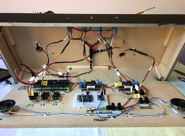

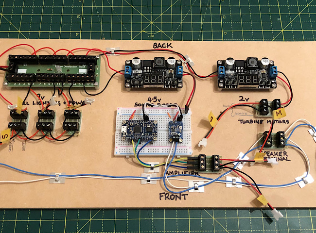

Glad you’ve got it Derek. BigGrin The beauty about these boards is there simplicity to use, very controllable. Great as you will need a higher input voltage to run the smoke machine, and once they have been set to the selected voltage they keep their settings even when power off.
I’ve put a couple of picture of the electronics I placed in my Podracer diorama. You will see I had 9v input running all the lighting throughout the model plus switches and then used these Drok converters to reduce the voltage to the sound board and the motor. BTW, you will see I have written 2v for the motors on the board, this nearly caused me disaster as it shook the model to bits. Cursing The voltage was then reduced to 0.2v. BigGrin
Can’t wait to see your smoke machine.Cool

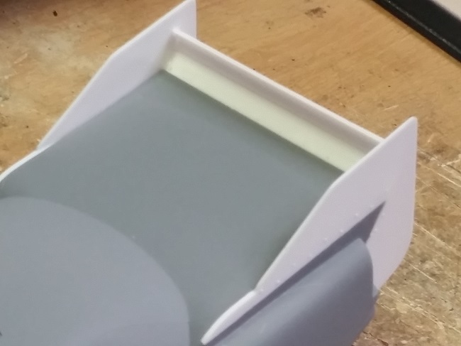

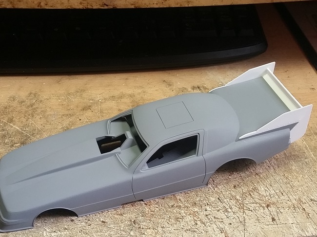

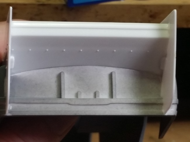

Pic 1:

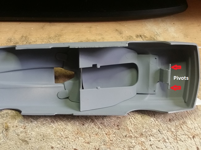

I primed the main body shell and the inner panel then fixed them together, with the body pivot marked with arrows.
Pics 2 - 4:

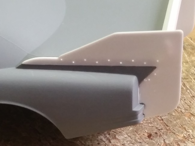

I fixed the non-primed rear fins and spoiler. I fixed them non-primed so I could see better how good/bad the fit was. Answer = Perfect no filler required.Blink
Amazing for a kit of this age.
Pic 5:
A pic of the body prior to the second priming.
That`s it for now.

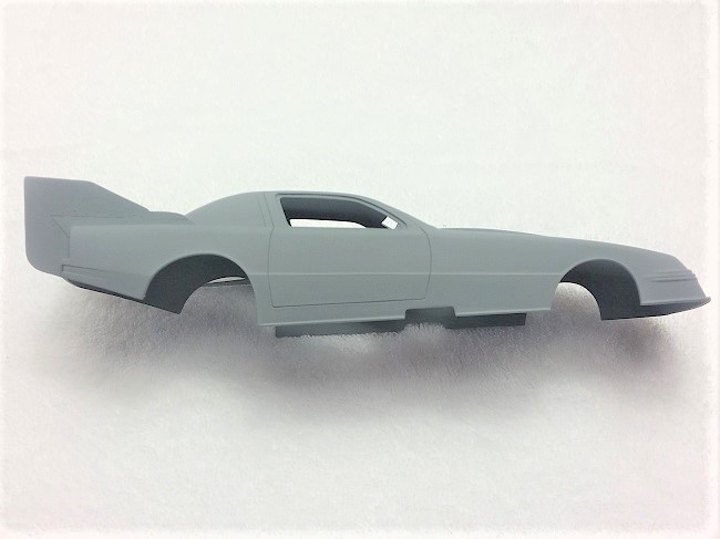

With the rear fins and spoiler fixed and not a scrap of filler needed, I have primed the whole body shell. (Pic 1 below)

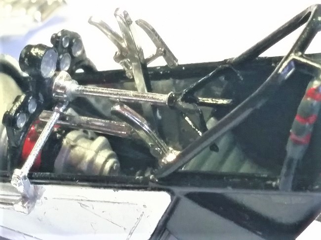

I have also now finished the steering gear from the outer link to the dashboard steering box and then to the drivers handles. (Pic 2 below)
