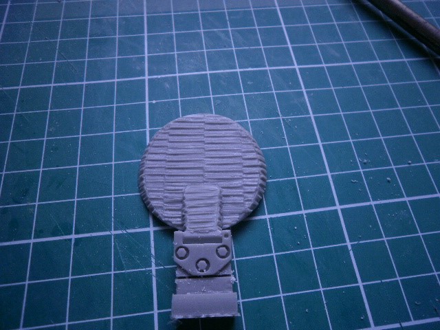

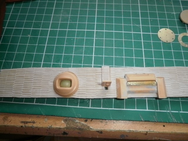

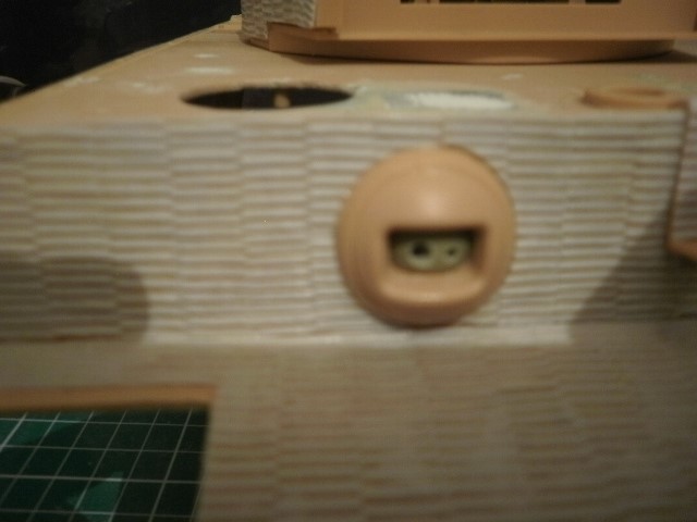

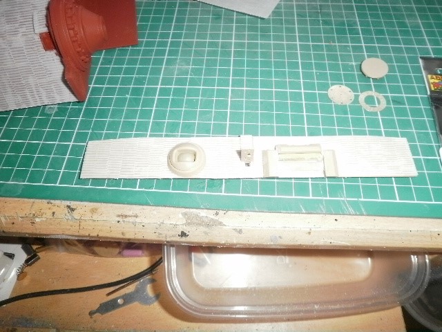

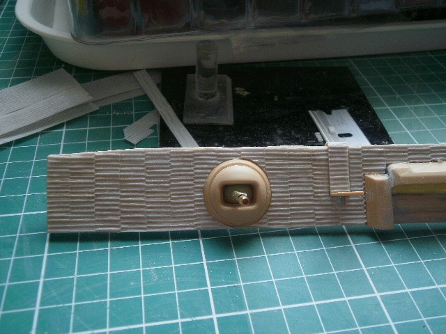

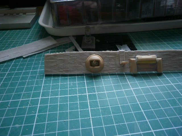

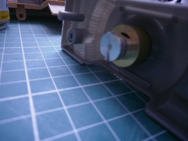

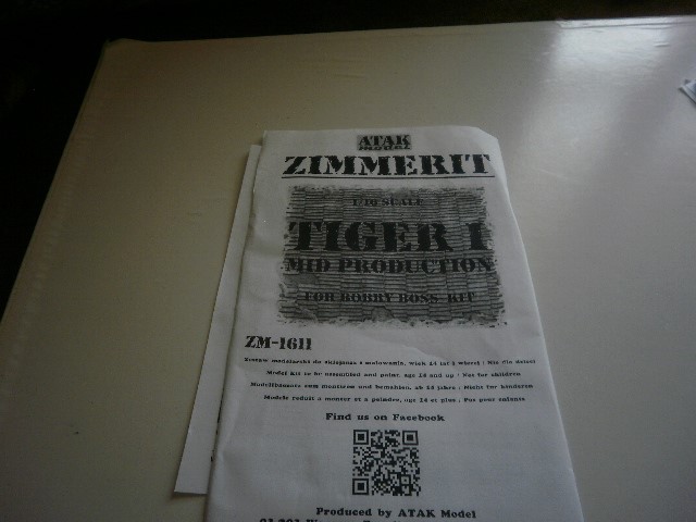

So happy with the front plate on the drivers side but the mg 34 is not good the ball mount is awfull so i made one from milliput, just a simple ball pushed into the opening then once cured drilled to the right size and the barrel will be replaced with a Abber one , i Also started with the Zimmerit which is from Atak in Poland it is resin and comes on 3 sheets which you simply cut each pre moulded piece from the sheet sand off the backing and apply to the model i used uhu glue here as its cure time gives you enough time to manover the piece in place , and it`s a very easy process and really a time saverCool
link = https://atakmodel.istore.pl/

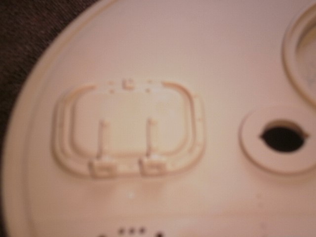

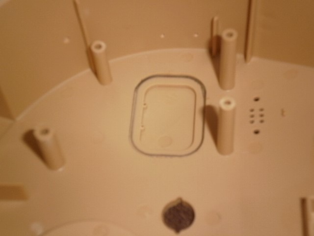

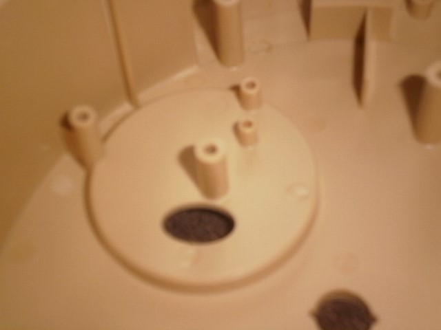

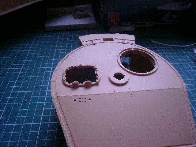

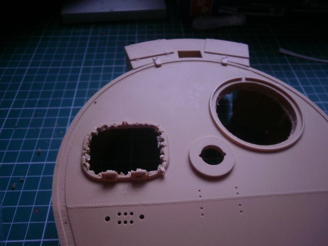

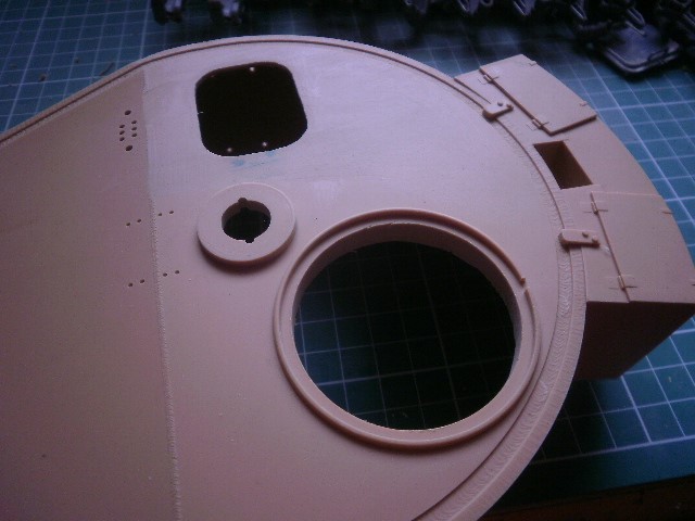

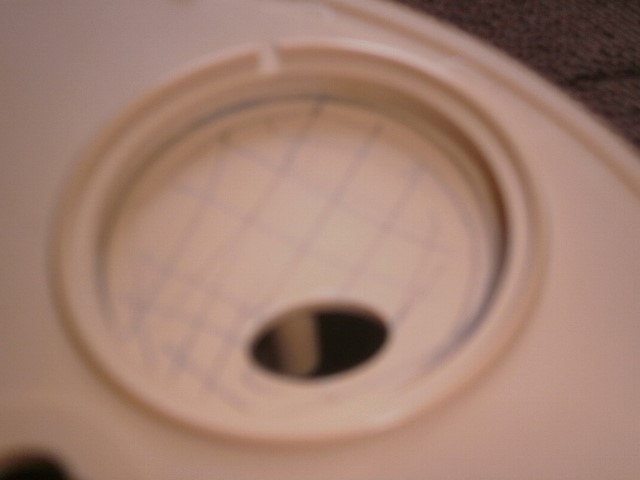

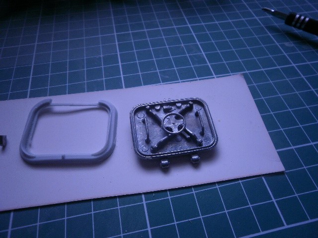

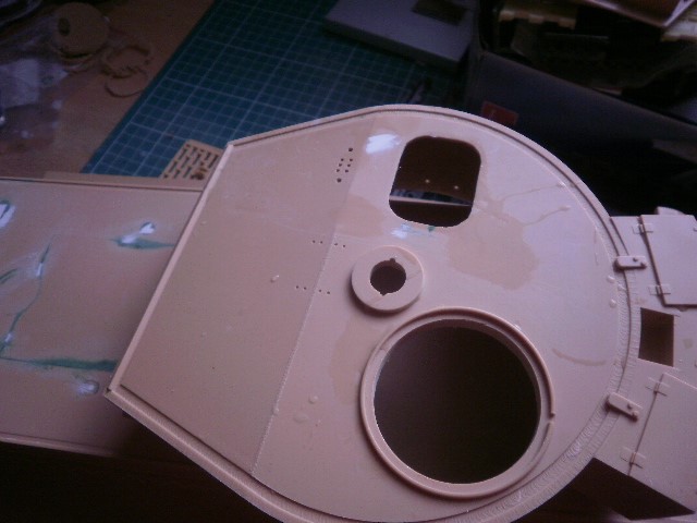

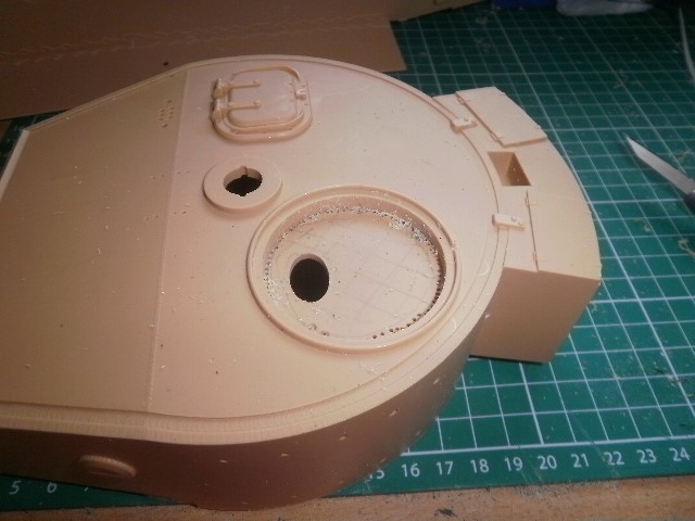

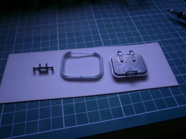

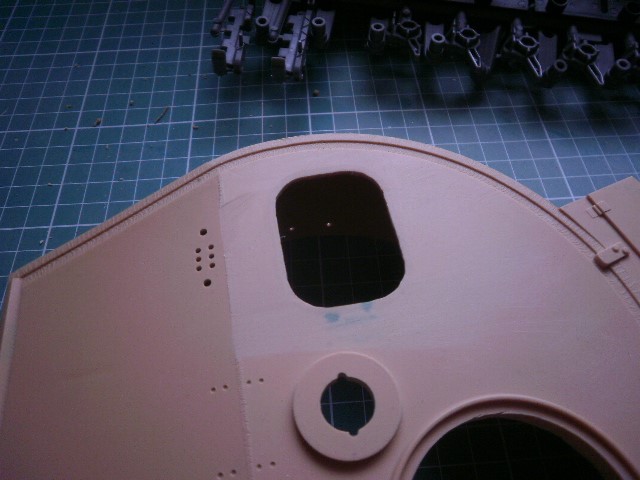

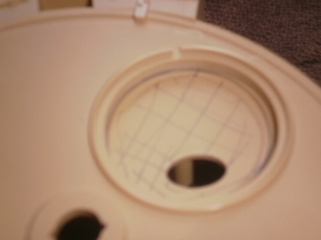

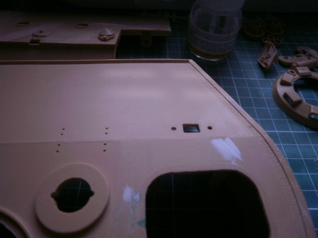

Next i moved onto the Turret , and like the hull the hatch for the loader is moulded on and the commanders postion is also closed off with the cuppola a separate part ,so needed to open these up the commanders position was simple enough but looking at the loaders hatch was daunting as the hatch and its surround was all one piece ,so i scoured the internet trying to find not only a hatch but the surround aswellBlink the hatch was pretty easy to find, as you can get all these in white metal but not the surround , i almost had to rethink this until when i was looking at 120mm figures, i found a commander and loader diorama figure set and the loader came with the hatch and surroundCool SavedBigGrin i chose to use the surround but i bought a white metal hatch ,so on with the surgery Crying below are picture off before and after , chain drilling filing and filling Cool

BigGrin You are having fun with this kit, Phil aren’t you!
Great idea with the zimmerit and a real result with the hatches ThumpUp ThumpUp

Thanks Gray ye the zimmerit is quite good and you can get it for most scales all pre-cutBigGrin cheer`s PhilCool

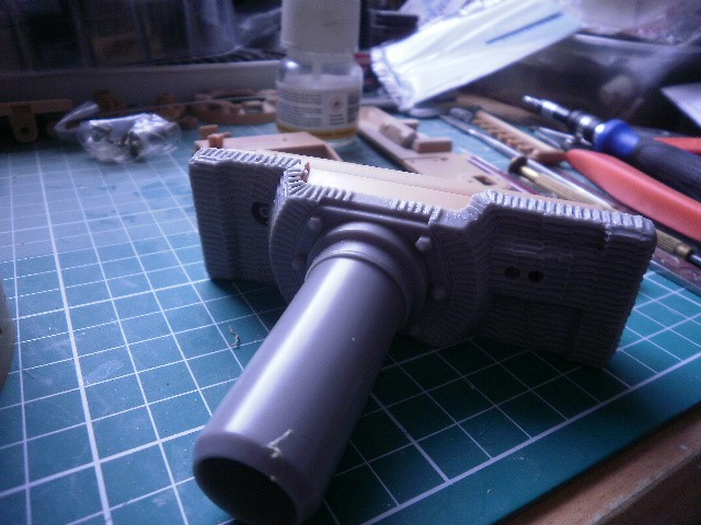

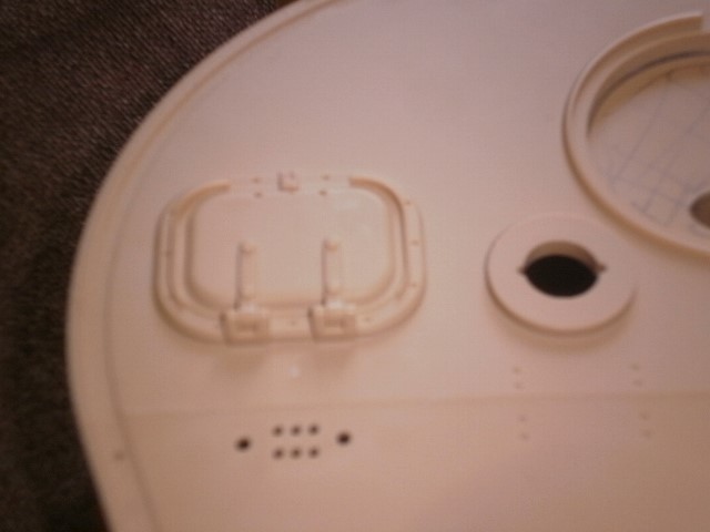

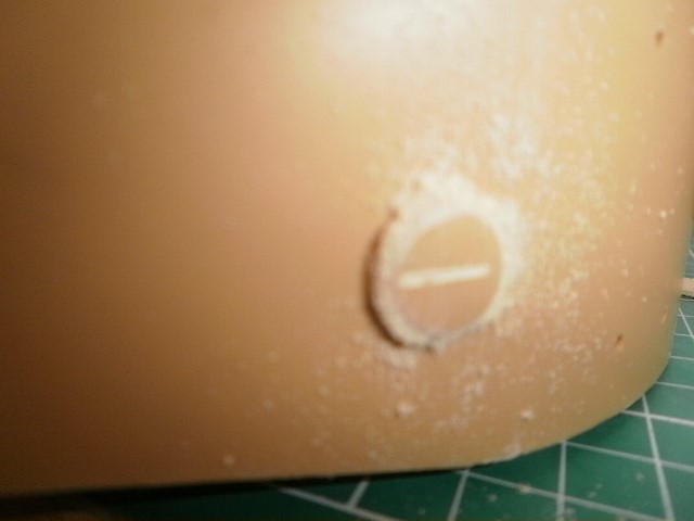

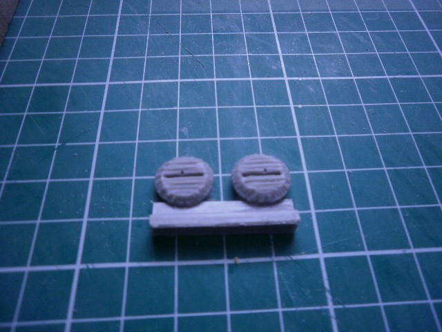

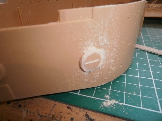

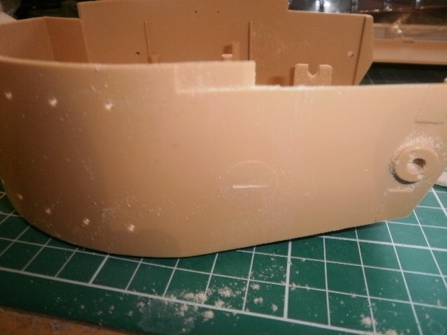

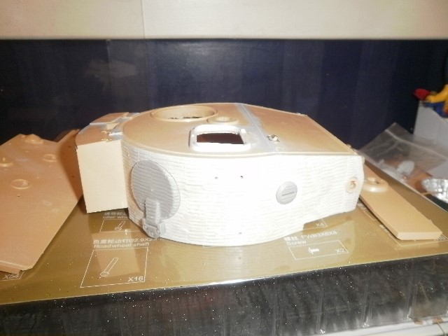

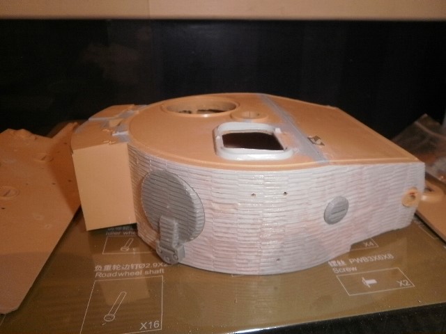

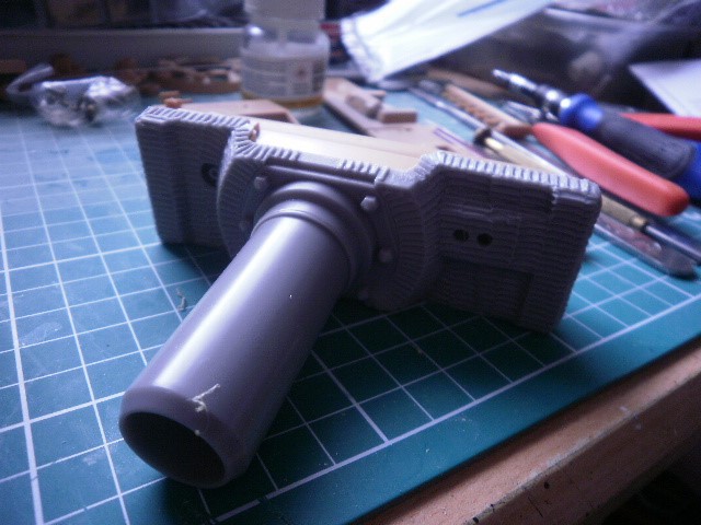

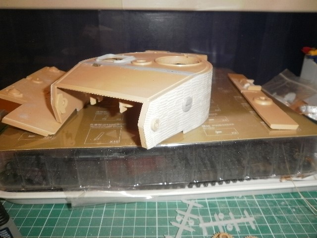

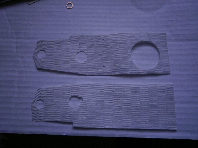

Continuing on with the turret i opened the vision port for the loader on the roof and filed off the loaders and gunners side vision ports cause you get these in the zimmerit set along with the escape hatch and gun mantlet ,i then applied the zimmerit to the turret

#30 Posted : 03 July 2020 11:45:30

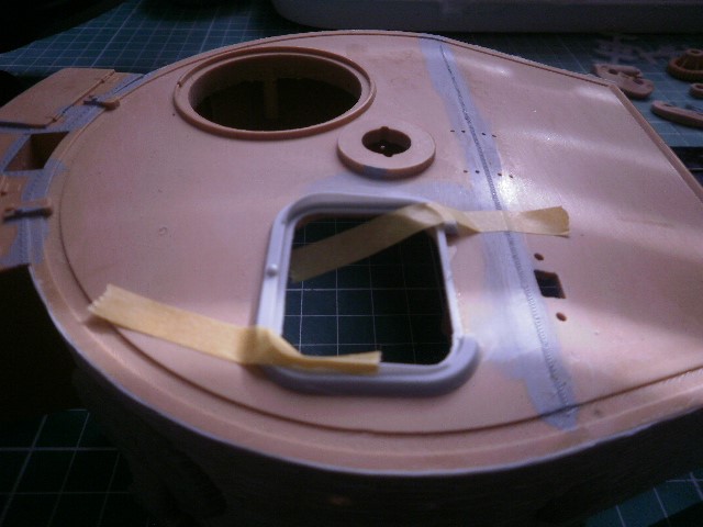

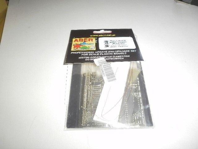

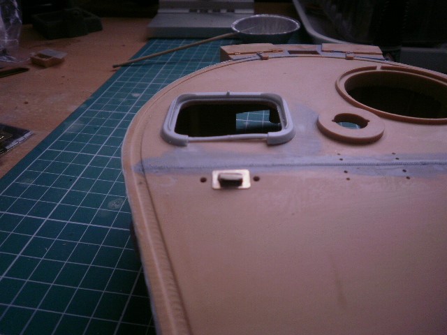

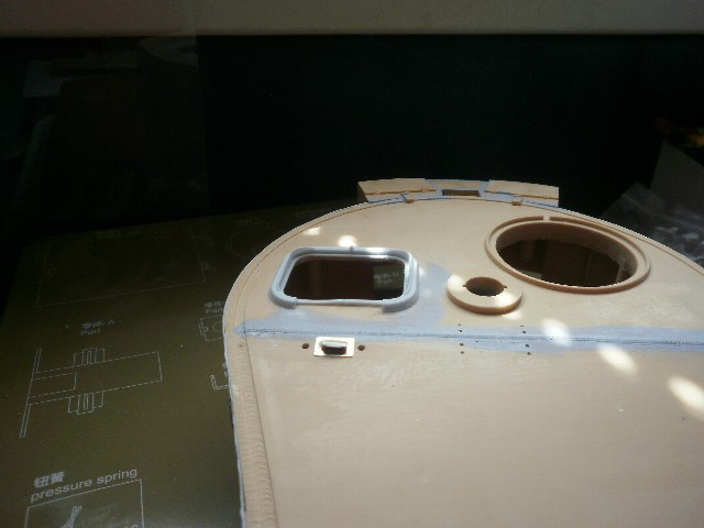

I then test fitted the surround for the loaders hatch and all though it fitted perfectly was warped but i got it to sit nicely,i then started on the abber etch which is three sheets of etch various brass wire and covers the whole tank where some parts are missing form the kitCool

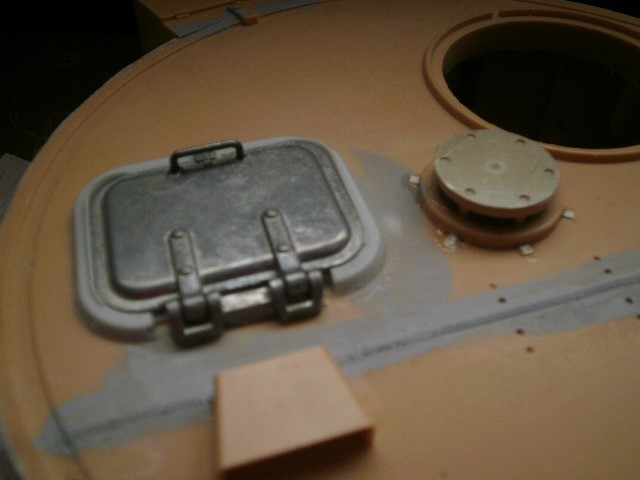

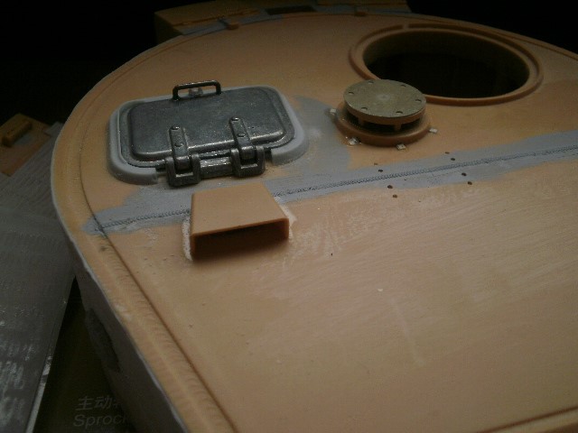

the hatch was then added along with the vision port in the roof along with the roof ventilator which i added the missing parts from stryne Cool

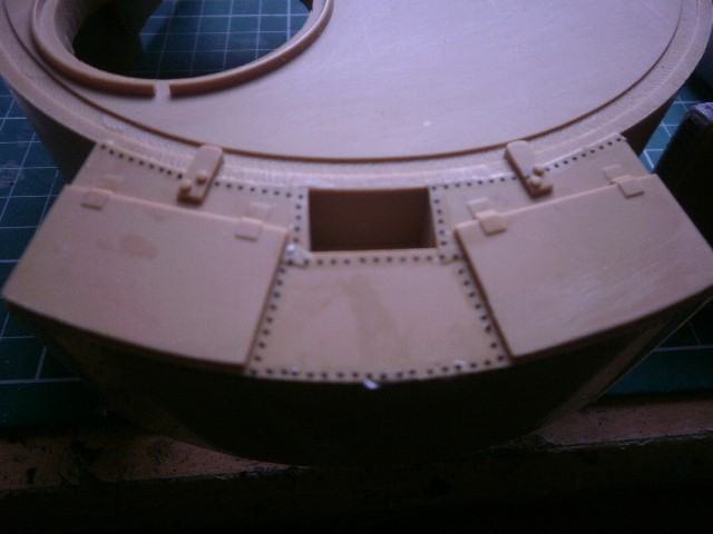

The rivets which are the archer ones were added on the stowage binCool

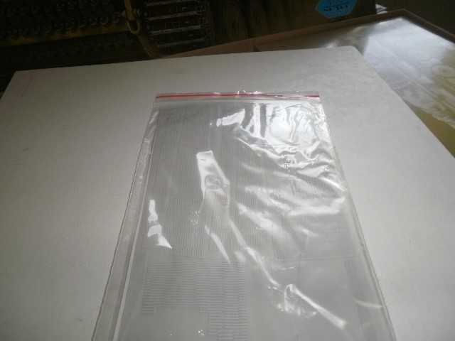

The Abber Etch Cool

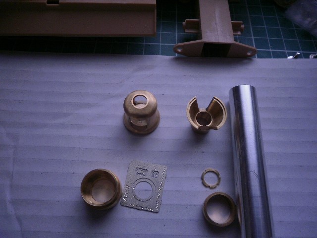

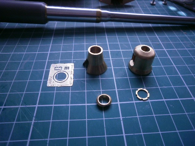

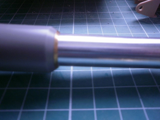

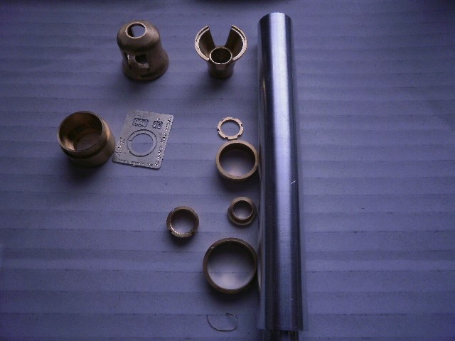

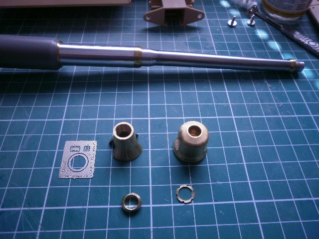

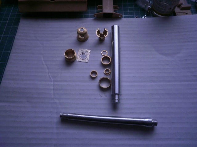

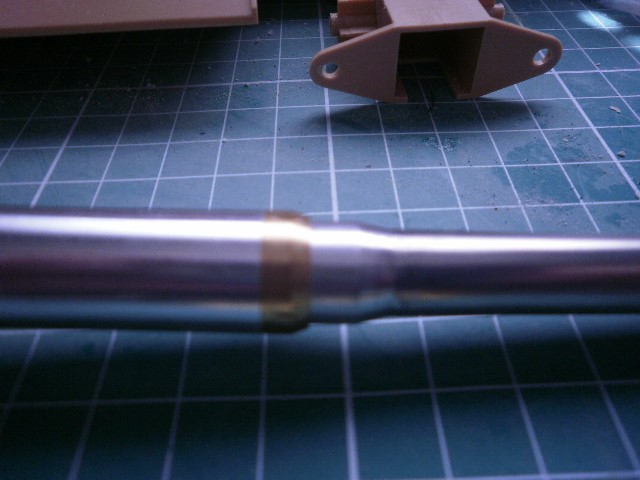

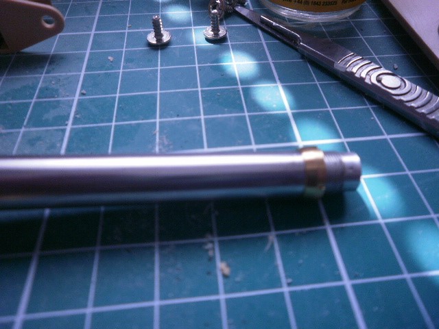

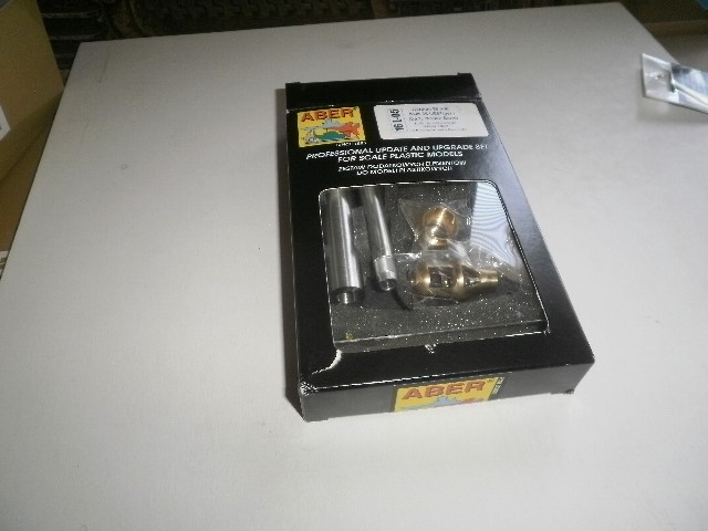

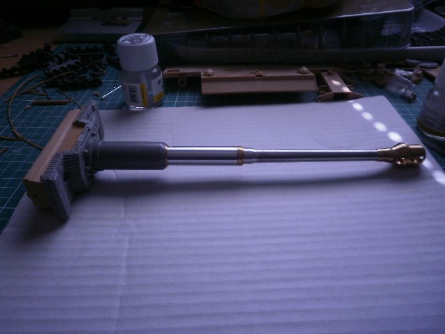

The Abber gun barrel is a work of ArtDrool Drool

Some impressive work being shown here Phil and the gun barrel looks awesome. Can see this is going to be something special when finished..... Very well done...Drool Drool Drool
#37 Posted : 04 July 2020 10:12:51
BigGrin The mods are making all the difference to this kit, and the gun barrel is a million times better than the one supplied ThumpUp . You’ve made a good job of scratch-building the ventilator, and I do like those hatches as well. Keep it up Phil
