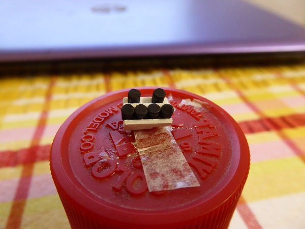

Gauges fitted to the rack.
#22 Posted : 18 June 2020 21:25:15

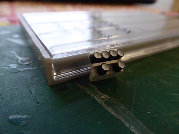

I then drilled out the face of each gauge with a 2.0mm diameter drill to form a recess.
#23 Posted : 18 June 2020 21:30:35

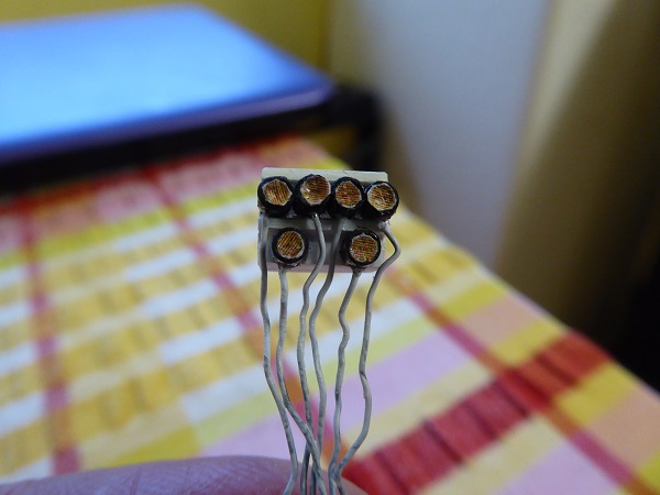

I spent an evening cropping one of the gauge faces from a photo taken on U995. I then resized it in Power Point so it was 2.0mm in diameter to match the recess I drilled in the gauge body and printed more than I needed to have a few spare.
I then carefully cut out six of these bezels and glued them to each gauge. I then attached 0.4mm diameter solder to each gauge to represent an air pressure pipe. The pipes were then painted white.
The whole thing looks a bit scruffy in this photo, but then again the photo is in macro and in reality this rack of gauges is only 10mm x 7mm.

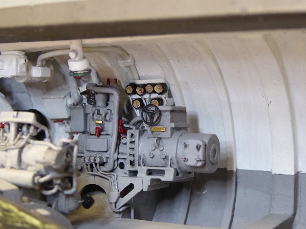

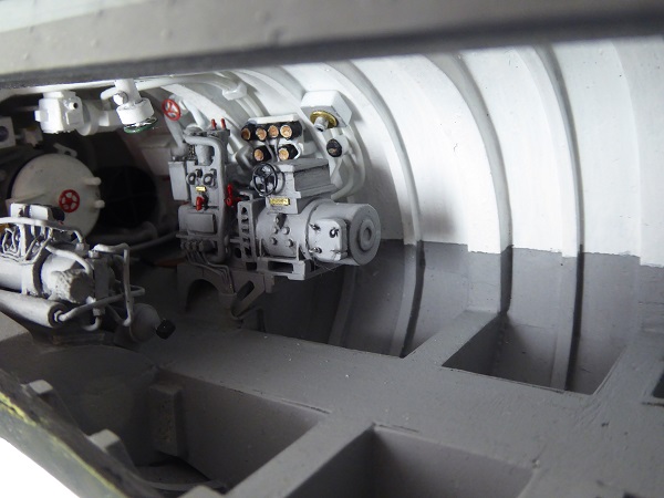

#24 Posted : 18 June 2020 21:32:11
Fitted, behind the compressor on the hull. Positioned so that the compressor operator has a good line of sight to the gauges.

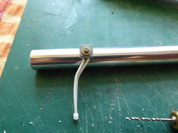

This week has seen further detail added around the gauges i made last week.
The first item is the electrical isolator for the air compressor motor. Made from styrene sheet and rod, cut to size and topped with a hand filed brass ring.

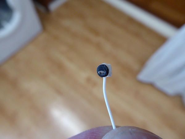

I then made an ammeter. This will be located next to the isolator.
#36 Posted : 26 June 2020 12:34:25
This photo shows both the isolator and ammeter fitted in place.
#37 Posted : 26 June 2020 12:35:26
A couple of small electrical junction boxes were made.

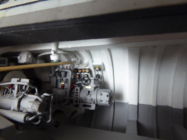

#38 Posted : 26 June 2020 12:36:19
Fitted above the pressure gauges. The tooth pick points them out.

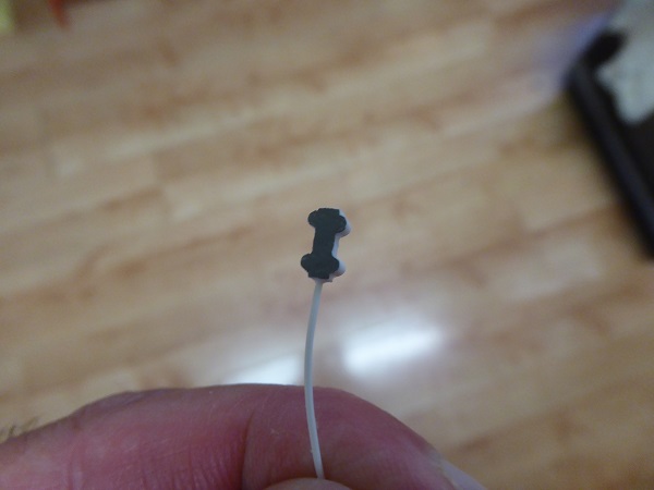

#40 Posted : 26 June 2020 12:38:20
Another different type of junction box.
