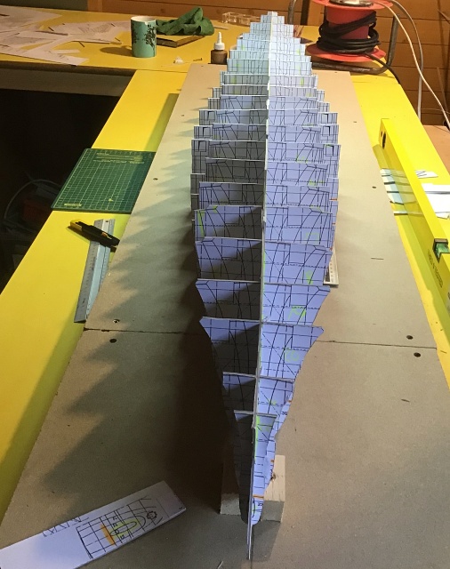

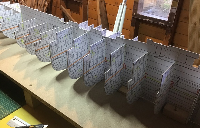

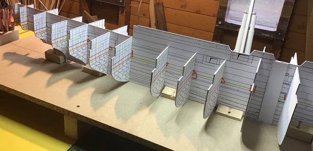

Progress so far
Cut vertical slits in the frames and keel, they have a smooth to slack fit which I think is better than a tight fit as that may bend the keel
The frames have been inserted in their corresponding slots so I can start to see a clearer way forward
Double the thickness of all or just a few frames in order to give the "planking" something to stick to
Cut horizontal slits in the frames at 2 or 3 levels in which to insert false decks which in turn will help square everything up before gluing
False deck sizes can be taken from the half breadth plan
Aerial view looking down at the full hull, the lines showing the width of the hull at various depths

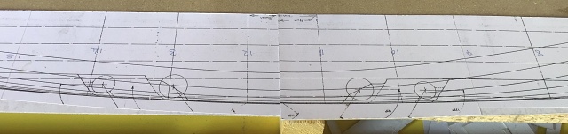

BigGrin Morning Folks
Checking out the 1/2 breadth plan for making false decks for helping squaring off the frames etc
Hopefully by doing this it will save the monotonous task of putting spacers in between the frames to prevent the card from sagging
The plan shows the waterline and decks from an aerial view
If I want to put a deck in at point iv I cut that shape out and cut slits at the frame positions on the 1/2 breadth and "bulkheads" and just slide them in Cool
The plan also shows the shape around the "gunports" which is good as I was a bit concerned realising it was not a square hole
Thanks for lookin'

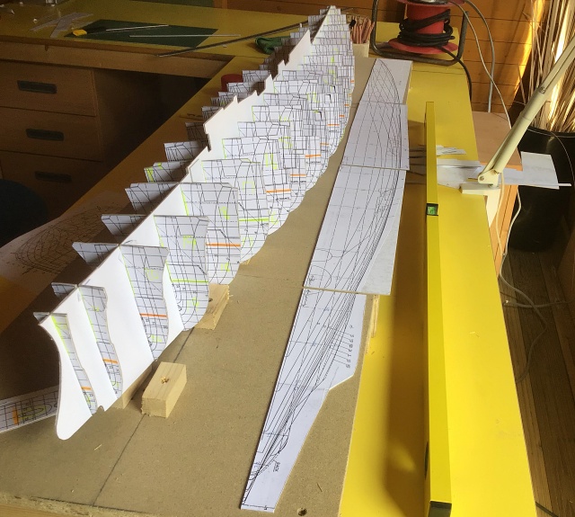

BigGrin Hi Folks
Not posted for a while but just to let u know I haven't given up AGAINFlapper Flapper
I dived straight in to cutting out the false decks to act as support for the frames and "planking"
7 1/2 decks each side
I cut out the slots where the frames were marked on the 1/2 breadth plan and tried to slide them in to the frames
Cursing Didn't fit Cursing
I had stupidly assumed that as the sheer plan and 1/2 breadth plan came on the same sheet that the distance between each frame would be the same
Comparing the plans there is a 4mm difference between frames 2 and 3 which have thrown the rest of my slots out
Which one to follow the sheer or 1/2 breadth planConfused
Cool After spitting my dummy out I am restarting the false decks taking measurements this timeLOL LOL

You're doing a brilliant job Budgie despite the 'setbacks'!Cool I know what its like with things not lining up, when I was building my card Sopwith Pups I found that copies I scanned were not lining up exactly with the originals. I then discovered that the scanner for some obscure reason had a default copy setting of 97%! Once I realised that I had to set the thing manually to 100% on each separate scan it was fine.Blink( I've now upgraded to an Epson all in one scanner/printer and the copy function on that one is 100% as standard - much easier!)
I think with your decks, as long as the actual length of the deck fits with your bulkheads and keel I would ignore the frame slots and mark the decks to your own framework for the slots - seems like less work that way!Cool
