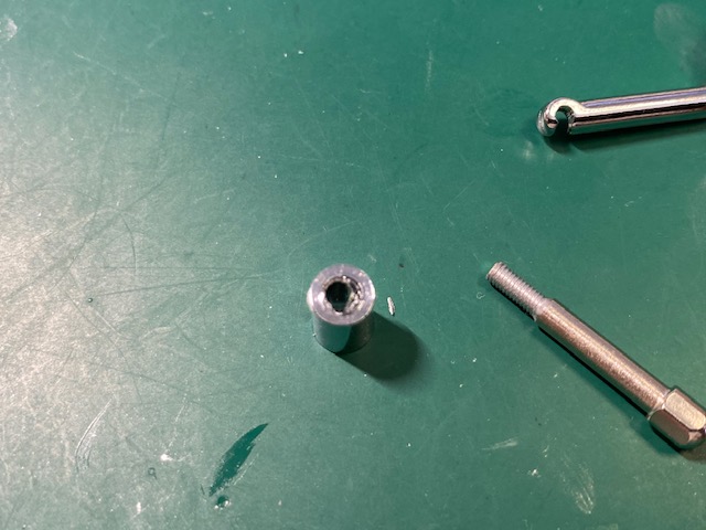

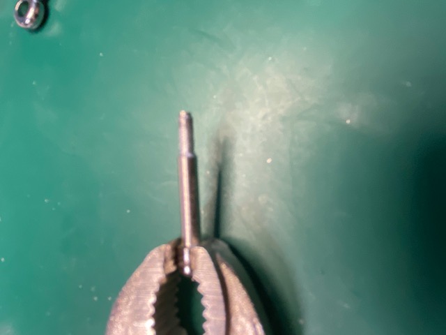

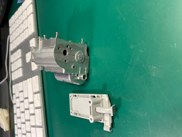

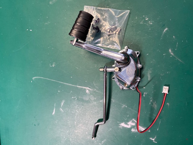

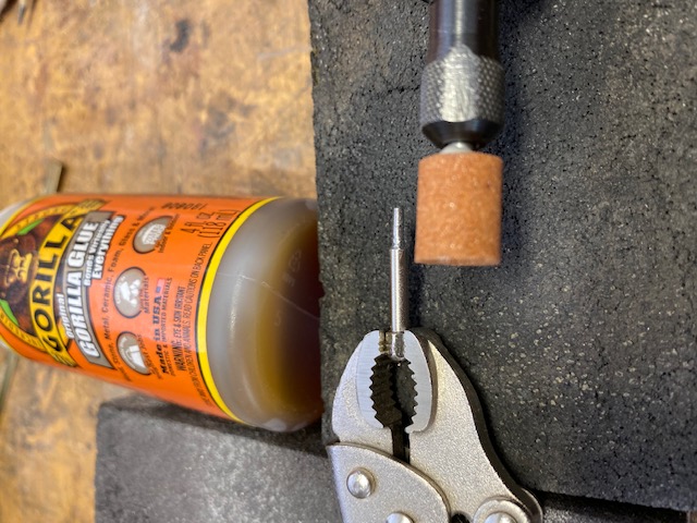

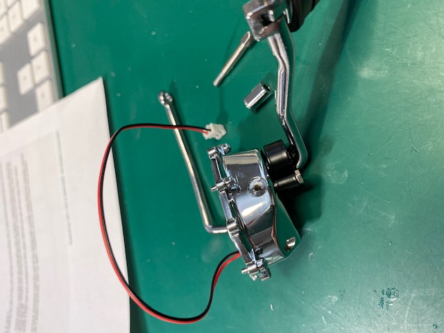

Today I decided to look at the Pack 10, Part 53 problem. Thanks to both of you I had an idea of what to look for. After opening the magic envelope to survey the parts, the post in question fell off the transmission. So now we will call it a spacer. It was glued to the case as you can see and the glue residue partially blocked the hole for the pin. Cleaned it out. My part did not have the spring post protruding but it was not screwed in. Just enough space for the pin, Yes? NO! This thing was not threaded correctly. The pin stripped. Also that pin is too long by a 1/16" ( 2or 3mm) for it to seat correctly and still allow the linkage to flop a bit.
My remedy was simple. I used a Dremel tool with a grinding stone to remove the threads from the pin and then filed the pin down so the the pin's shoulder seated correctly. All in all I made a post which fit and used a drop of Gorilla Glue to secure.
I would humbly state that this is a big problem with this kit and without help from the forum, it would have been worse than it turned out. On the other hand, aren't problems with expensive toys make our hobby as fun as it is?

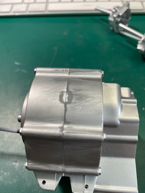

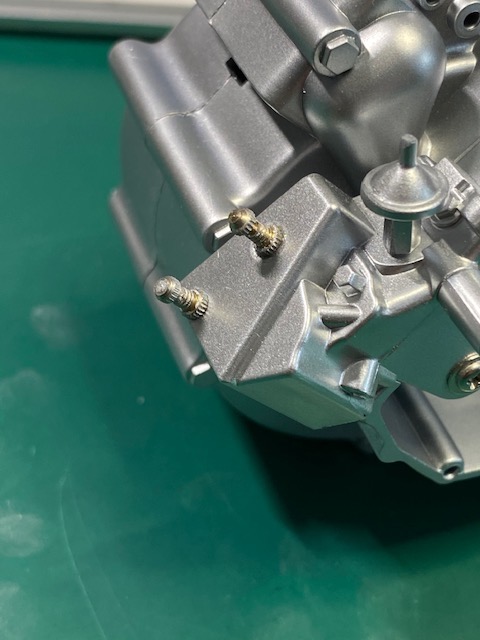

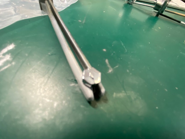

Ended up with a little time for modeling. Here is my Tappet fix.
tnequette attached the following image(s):
#28 Posted : 25 May 2020 09:30:44
That is a great job Tom.Drool Love If only I had noticed.Crying
#29 Posted : 26 May 2020 08:07:18
Nicely done Tom and thanks for the images posting info using a MAC. Have moved your post as requested.....Cool Cool

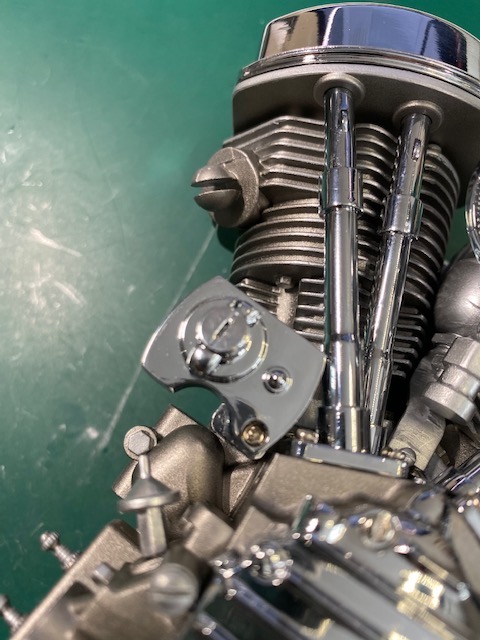

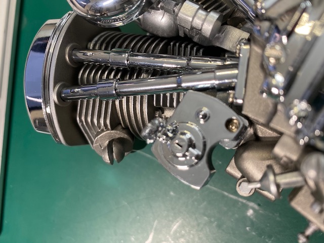

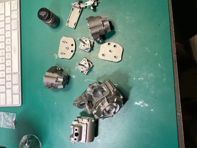

The engine: The museum here is still closed and I decided to move after visiting the local H-D dealer. I wanted to replicate a cast iron color and was convinced that Testor's Model Master "Steel" was best. Luckily I had a old bottle in perfect shape. Testors, I discovered after visiting two hobby shops, was now out of business and we could not find an alternative. The air brush had to be cleaned off and recalled to duty. All was good.
Once you decide to actually model something versus assembling the parts given, you enter into a different world. Now you can attempt to repair defects and improve fit and finish. The metal parts in the ER are really good but the plastic has problems. You have open seams, sprue cut off marks, ejector pin marks, etc. These actually surprised me for a model of this cost but this also the fun.Cursing The most interesting guffaw found was the ignition switch assembly. The switch body has a slot for the neat little key, which sorta fit. It also had a neat little chromed weather cover. BUT the cover also has a slot cut in it for the key!Confused. So, fix the cover and use Rub n Buff. Funny when you think of it.
The instructions covered the actual assembly well. No problems except for those I brought on myself.Blushing
The pictures show the crankcase, a chrome filler cap (there goes the chrome), the transmission case, ignition key and some fixes after priming. One shot shows a painted piston cylinder with the original silver painted carburetor lying in a piece of cleaned cast iron.
Am very pleased with the outcome. It will be weathered for oil, etc,Cool

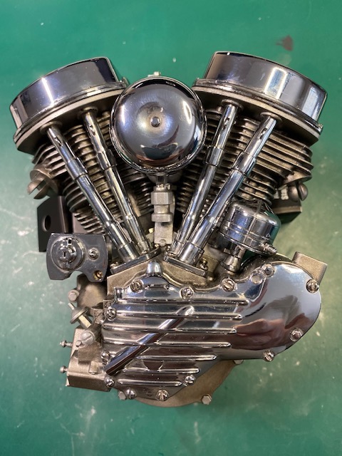

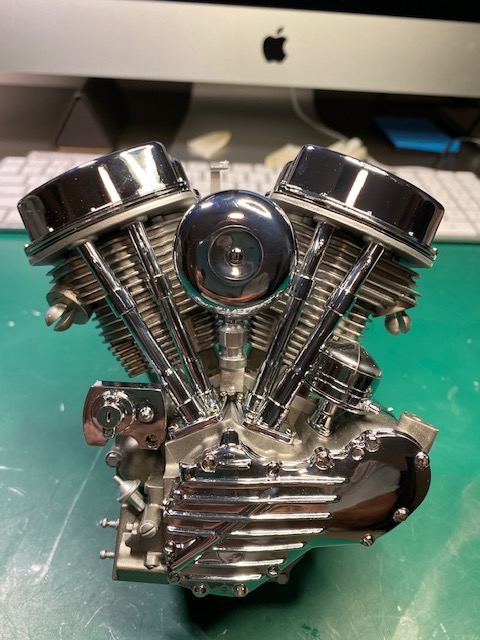

Last engine shot, all filthied up and ready to move on.BigGrin
If there any more "Watch Out"s out there, now is the time. Isn't there a hassle with the linkage springs?
Thanks Wyatt and mark for all your help.
Tom
