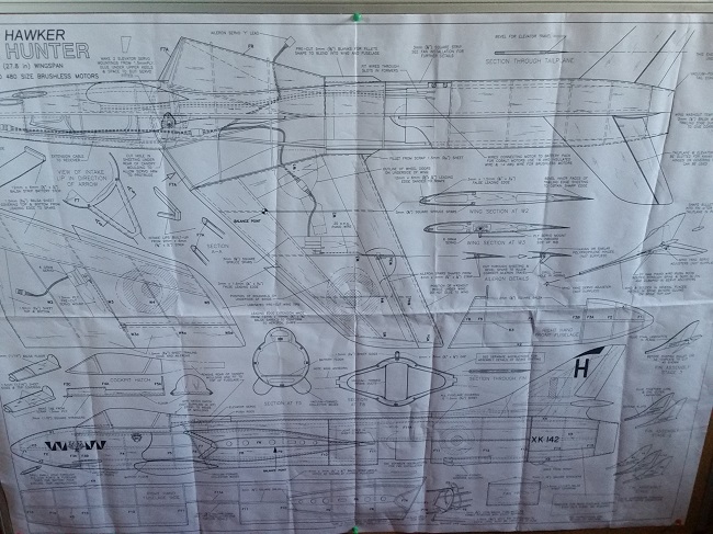

Hi All, BigGrin BigGrin
Doing some prep work for the start of this build.Blink Blink
I`m using the same build board I used for the "HAWK".
https://forum.model-spac...spx?g=posts&t=33526
It`s a cork notice board that is 47.5" wide x 35.5" high, or in new terms 1.2mtrs x 0.9mtrs. It takes and holds the small map pins very well, so is ideal for the job.Cool
First issue is that the kit is some years old and the plans have been folded for some time and therefore don`t want to lay flat. I have therefore pinned the plan to the board with as much tension as I dare and will let the air get to it for a day and then re-pin it a bit tighter. (See attached pic)
I have purchased the cover for the plans that even at double thickness you can still see the plan and it works out at approx 3gms per sq mtr and only £3 for 12 sq mtrs.
https://forum.model-spac...px?g=posts&t=35082.
As soon as I get the plans as flat as poss, I`ll cover them and get started.
So more soon.BigGrin

Thanks for the offer of assistance. Cool Cool
Looks like things should be ok as I`ve had the plans pinned out for a couple of days in a warm room and I`ve just re-pinned it to take up the slack as the creases gradually flatten out.
Hope to make a start on this early part of next week.BigGrin

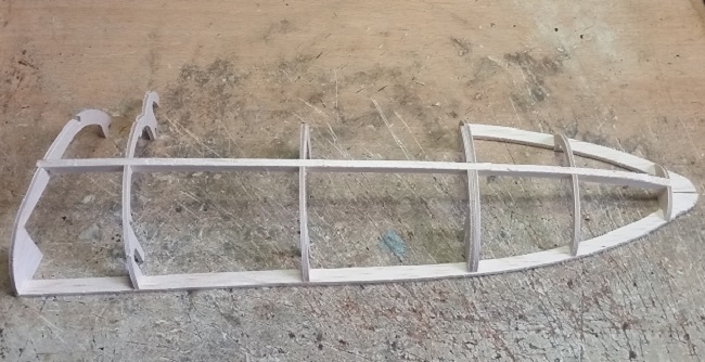

I have today removed the right side parts of the front fuselage from their frets and made up a dry fit. Some adjustments may be needed when pinned to the plans, but it all looks close enough for a starting point.
So just the one pic for now, with more to come soon.Blink Blink

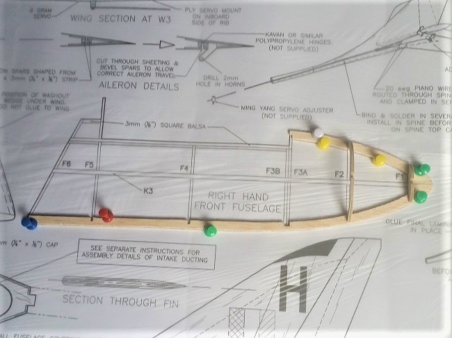

Hi All, BigGrin
Well second covid jab done and dusted and now got a small update on the Hawker Hunter.
I took an iron (carefully) on a low heat to the plans and I`m pleased to report that they no longer look like a relief map of the Himalayas.Blink Blink
I then put on a double layer of the super thin dust sheet reported on earlier:
https://forum.model-spac...spx?g=posts&t=35082
With the plan protected from glue etc, It was down to laying the first parts and pinning them in place having applied balsa cement on the joining faces. I also placed the first two formers (F1/F2) shown in the pic to hold things stable. These are not glued yet.
Leaving that to set solidly and then I can get some more done and post the next update.Cool
