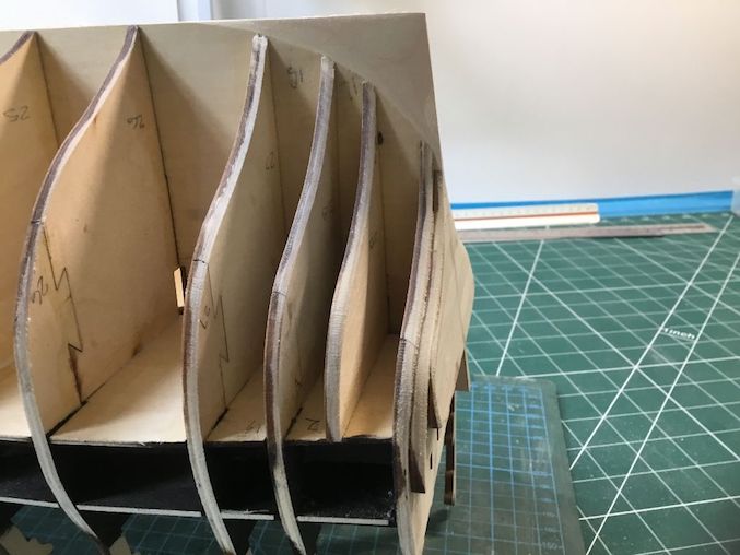

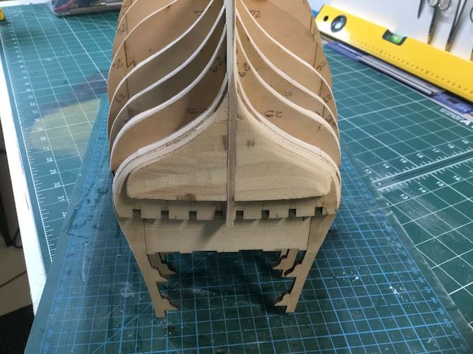

I spent quite a lot of time fairing the bulkheads and sanding down the stern plates at the gallery.
Tapered the rear of the false keel section down to approx 2mm thick
I found that not permanently fitting the gallery support pieces has helped me to sand more easily, but will be glueing those into position now.
Also found that the bottom sections of bulkhead 24 had become loose so glued those back in securely.
Although not fully completed yet, any comments on improving the fairing would be appreciated. Thanks.
Next step will be adding the balsa wood infills at bow and stern.

#25 Posted : 03 August 2019 20:47:09
Well done.
Sanding down that stern end is "frightening" as you have to take off so much wood.
You have done a sterling job. 1 to tick off your "next stage list".
Hope it all continues well.

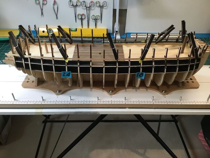

I have just picked up on something that is a bit worrying.

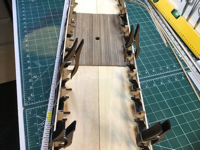

I clamped a thin strip of timber along the outside of the bulkheads legs (at the deck support level above the upper gun deck) and noticed that there are dips in the "profile" at frames 18 and 24 on both sides, but more pronounced on the port side.
If I lay a plank along the deck support brackets (on the inside) in the same area there is a distinct difference between port and starboard, with relation of the plank and the bulkhead legs.
This probably all sounds very badly described and it's very difficult to take pictures.
Is this dip correct and I'm being paranoid? I have looked through the build sheets and watched the videos but can see no mention of this.

#28 Posted : 04 August 2019 10:19:02
Groups: Unapproved
Joined: 24/05/2010
Posts: 1,761
Points: 5,351
Location: London & Greece
It's hard to say without seeing where the problem is but as a rule of thumb, there should be NO dips or bumps at all otherwise the planks will not sit correctly.
I remember when I was fairing, I needed to build up frames about half as much as I rubbed them back. I used varying thicknesses of wood to do that but one one occasion, I had to bend a 2mm plank and glue it on.

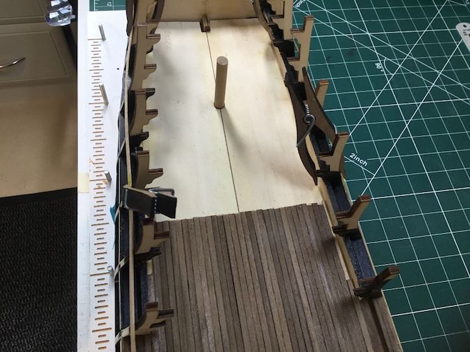

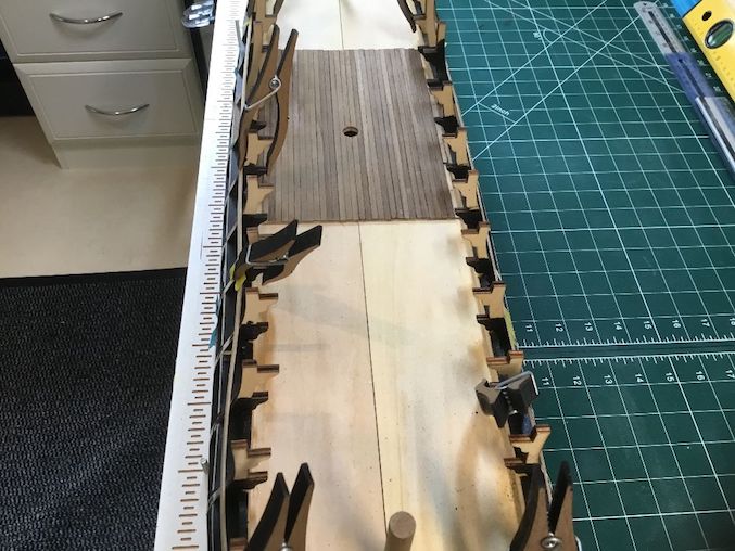

I have attached some pics to try and show where these "dips" are. As I said before, it's quite hard to show you what I am referring to but perhaps these will help. The blue label notes the frame number and the yellow tape indicates where the "dips" are worst. The only other comment is that it is the same for both sides of the ship but more noticeable on the port side.
If it's necessary, I could build up the external profile to remove the discrepancy but I then have the problem on the inside of the legs and the profile that the next deck level will take.
Sorry this all sounds so confusing.

z8000783
#30 Posted : 04 August 2019 12:41:57
Groups: Unapproved
Joined: 24/05/2010
Posts: 1,761
Points: 5,351
Yes, I see now. You definitely have to do something about those.
The internal profile isn't important as in just about all cases, it will be built up and then covered.
OK John, thanks for taking a look.
I'll get on with building them up.Crying Cursing Crying

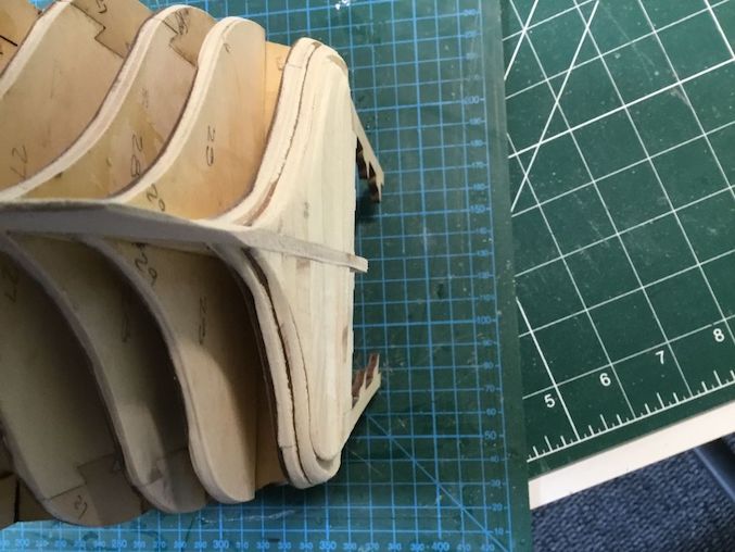

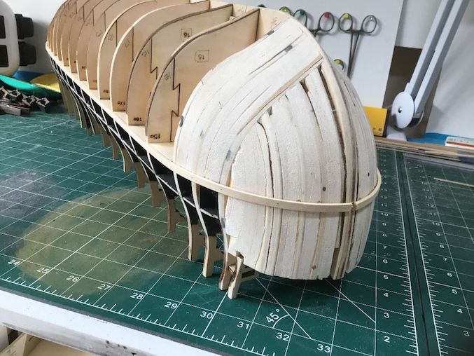

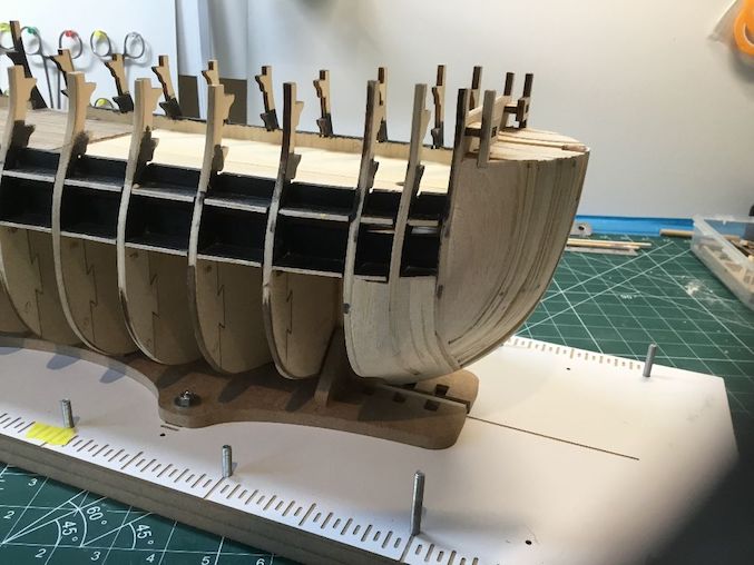

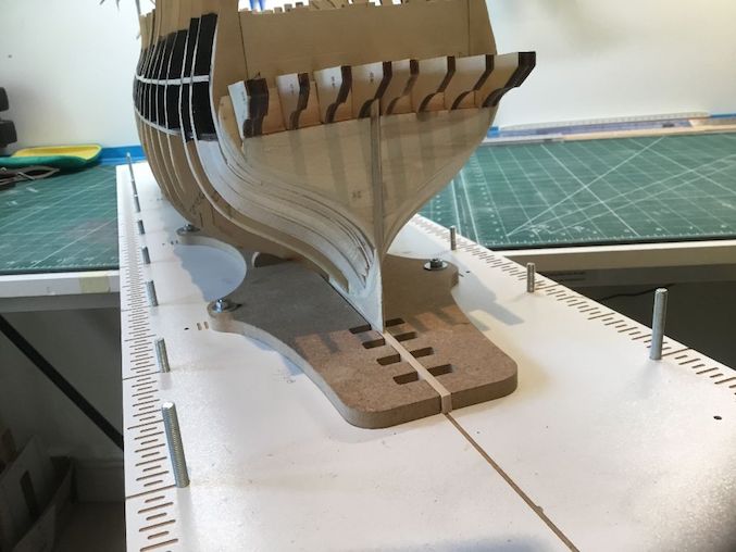

After A LOT of packing and sanding, I have finally got the external profiles of the bulkheads to line up.
I am amazed at the discrepancies in the bulkheads seeing as they are computerised, laser cut pieces.
Still, job now done.
The fairing of all the bulkheads is complete, I think, and balsa packing pieces added bow and stern.
About to start on the planking and I was wondering if there is any benefit in leaving the gallery planking until the hull is completed so that the gallery planks would cover any discrepancies in the ends of the hull planks....if you see what I mean?
Any advice or comments would be appreciated. Thanks.

Very nicely done, you've done a great job on the profiling.... With these kind of wooden ship kits its not unusual to find bulges and dips in the profile of the hull. You'd think it would be very accurate but alas, very seldom the case.... Cool Cool
As for planking the gallery, I would recommend you plank as per the instructions, by far the safest method.

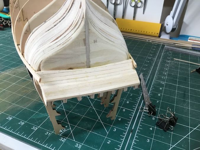

I got started on the planking last night and the results are below.

#38 Posted : 09 August 2019 10:19:49
Nice work you can see you are enjoying this Chris.
