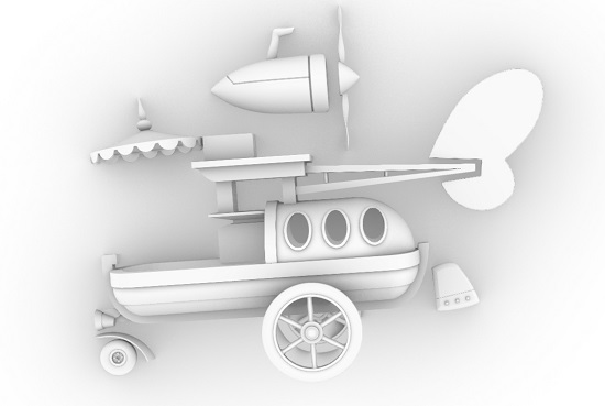

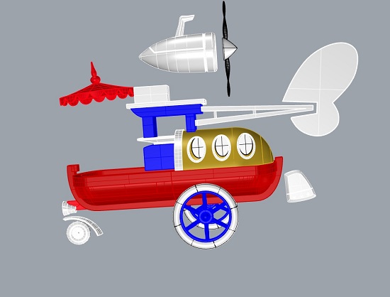

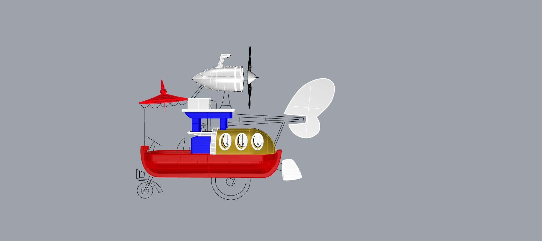

More work on the parts of the convert a car.
I need to do the wheels next.Do you guys want to see the step by step process of making a wheel?

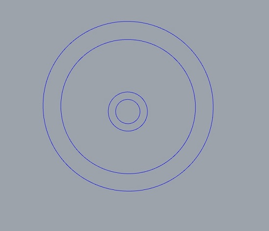

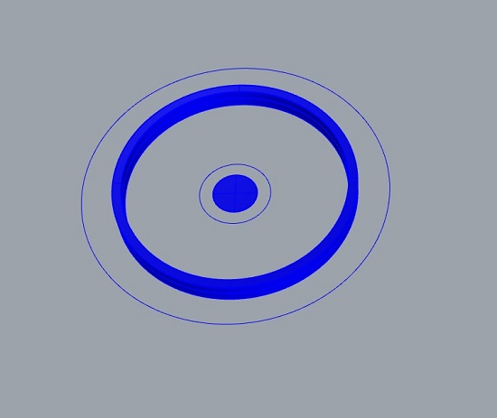

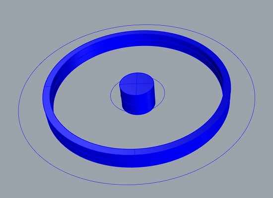

OK wheel 3d tutorial
here we go;

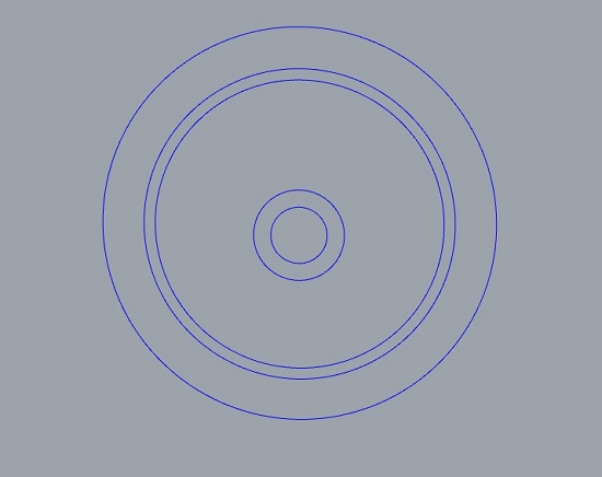

Step one is I traced around the picture to get the outline of the wheel
Step 2 Starting with the rim I made a second circle inside the first.
Step 3 I made a surface between the 2 circles and then extruded the surface to make a solid rim.
#30 Posted : 23 July 2019 01:54:21

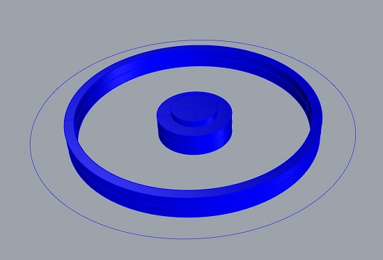

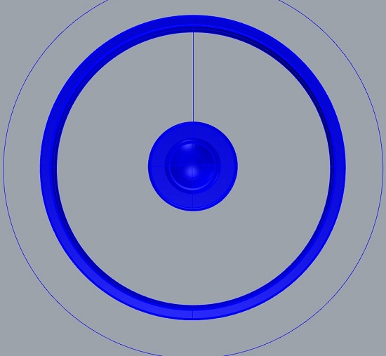

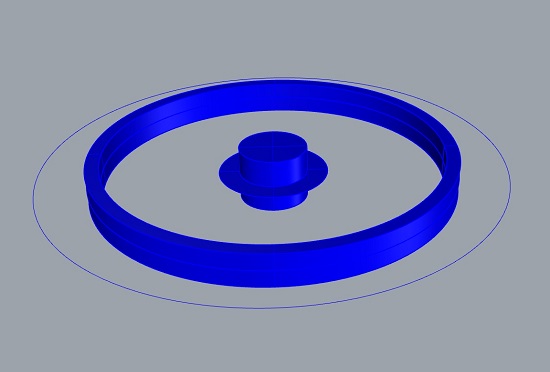

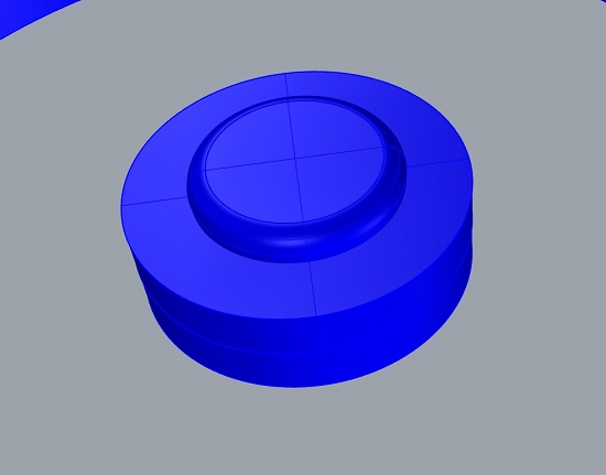

Step 4 starting on the hub.Made a surface from the smaller circle
Step 5 extruded the surface to make a solid cylinder
Step 6 made a surface from the out circle of the wheel hub
Step 7 extruded the outer circle surface to make another cylinder
Step 8 I rounded off the edge of the inner cylinder to mimic the axle

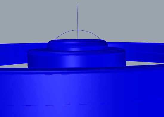

#31 Posted : 23 July 2019 02:02:01

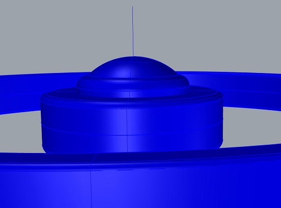

Step 9 Making a wheel hub cap.I drew an arc between the ends of the hub.
Step 10 I revolved the arc around the vertical line to make the hub cap
step 11 I separated the hub cap from the hub.This way I can paint it a different color

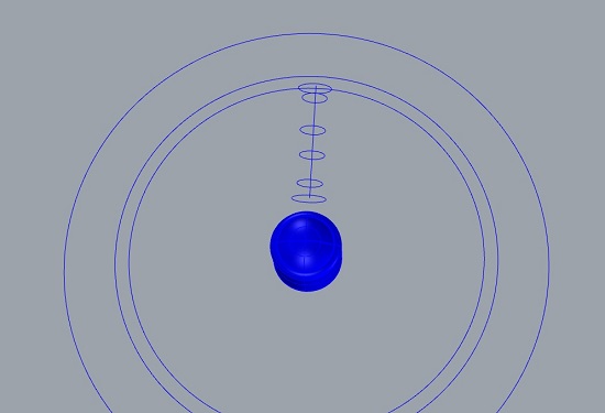

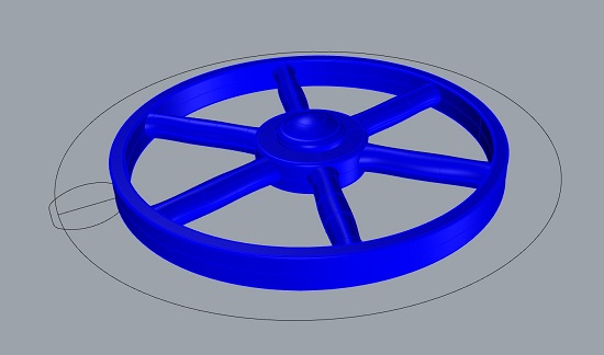

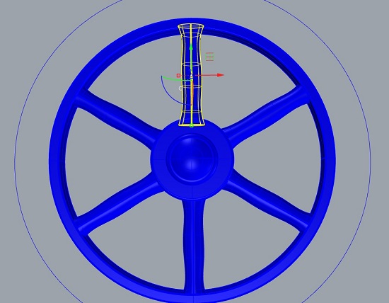

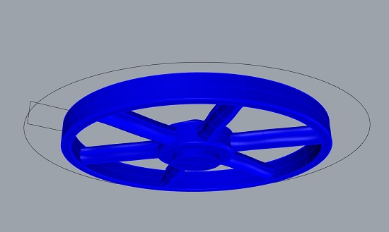

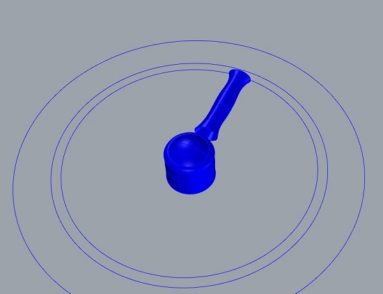

Step 12 making the wheel spokes.I drew a line between the hub and the rim
Step 13 I drew some circles around the line to form the walls of the spoke
Step14 I used the loft function to make a surface that was defined by the circles and the line.This was then made into a solid.
Step15 Once I had one spoke I made 5 others using the polar array function.This duplicates an object around a central point.

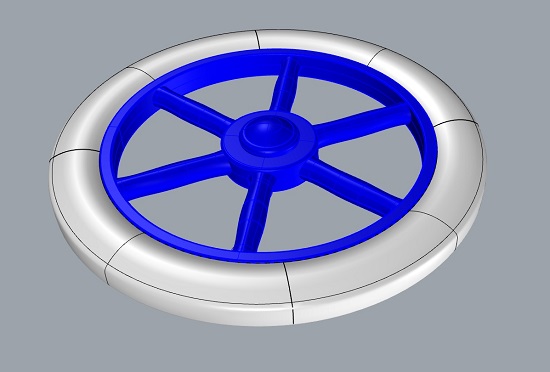

#33 Posted : 23 July 2019 02:28:00

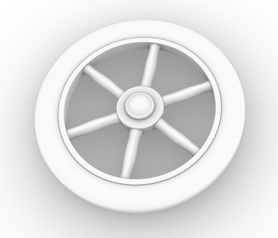

Step16 making the tire.I drew some reference lines to get the tire width
Step17 I made some curves to make the tire bulge slightly.These curves will form the outline of the tire.
Step18 I used the sweep 2 rail function to rotate the curve around the rim to make the tire.
Step19 The final render of the wheel.It was quit e a few steps, but it only took me about 15 minutes. I will now make a mirror image of the wheel to make the other back wheel and make an axle

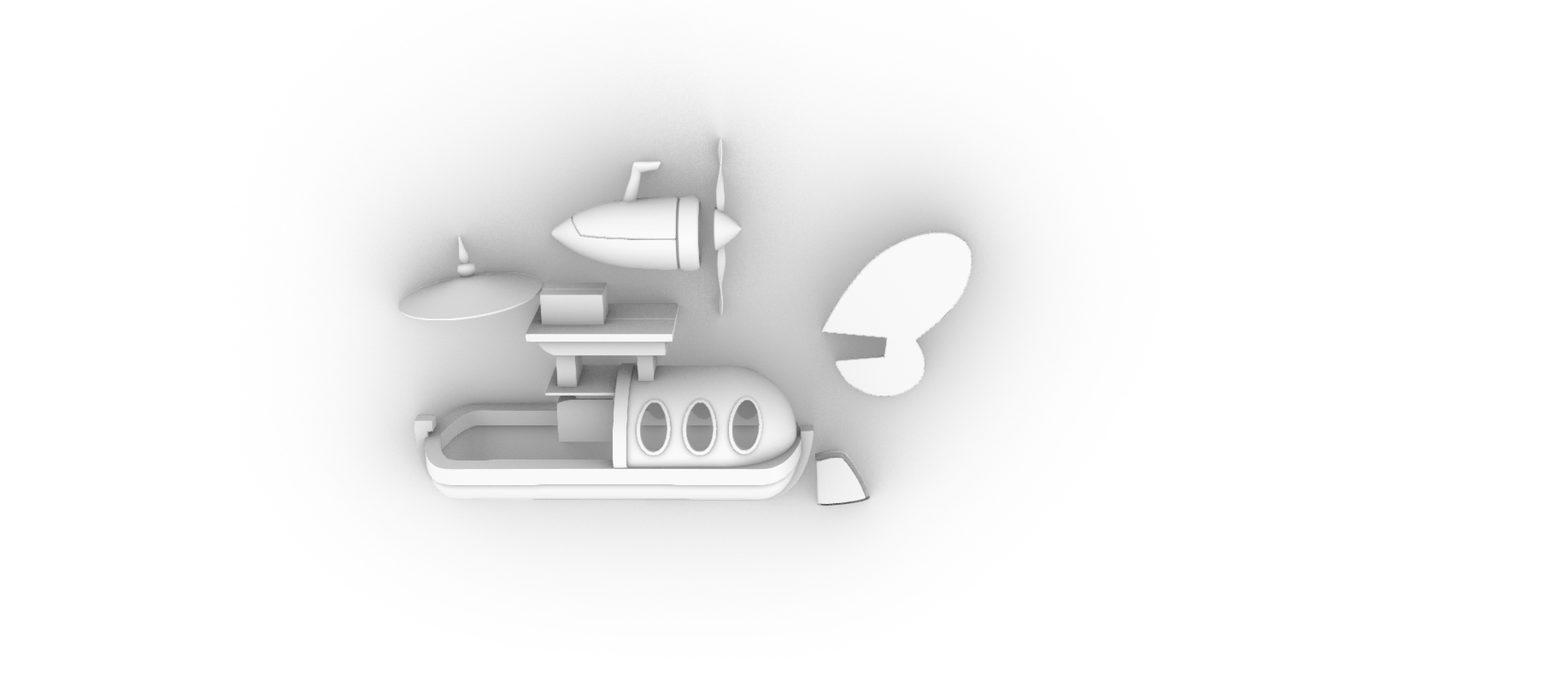

#40 Posted : 25 July 2019 04:40:33
Almost finished the major sub assemblies.Once this is done I will do a test print to see how it looks
CD
