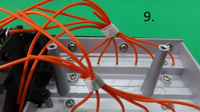

STAGE 11 – THROTTLE LINKAGE AND BLOW-BY GAS HOSES
PICTURES 1, 2 & 3

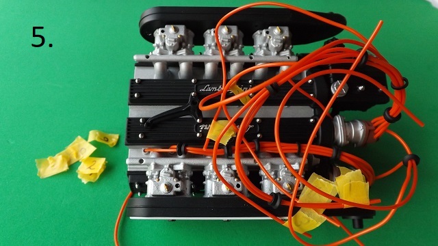

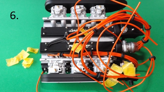

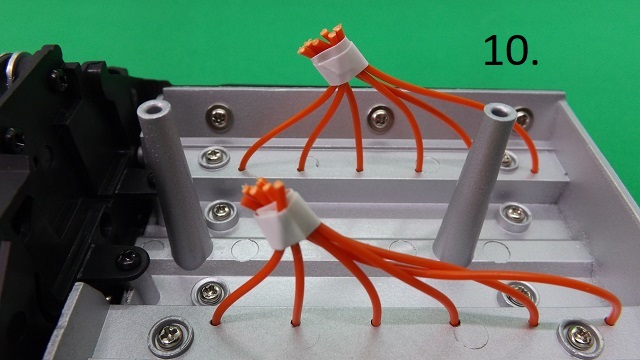

In this built segment we insert the HT Cables into the cylinder head. The instructions mention that its possible to do this so that the leads match the exact arrangement as on the real car.

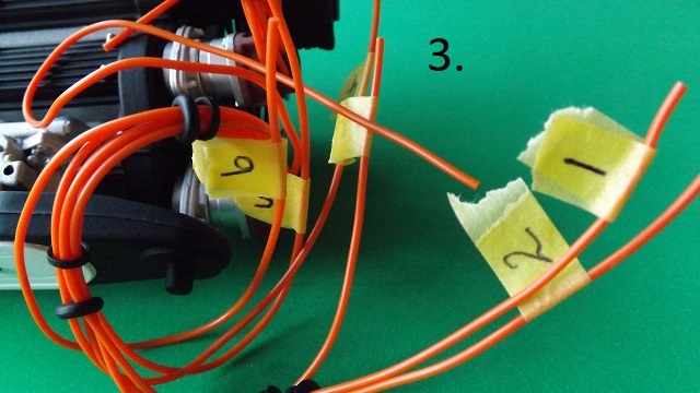

It’s a case of removing the black bands and sorting the cables as per the numbering shown here in PICTURE 1.
Can get a bit confusing so to make things a little easier for myself I traced each lead back and numbered them using a piece of masking tape.
It all starts off looking very much like a “Rats Nest” but a bit of patience and you soon have the leads sorted in the correct order.

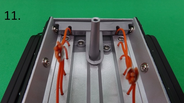

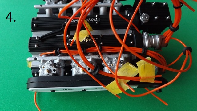

PICTURE 4
Here we can see the lower set of leads all inserted into the correct holes in the cylinder head.
Its then a case of doing the same thing with the second set of leads.

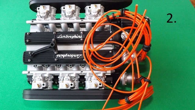

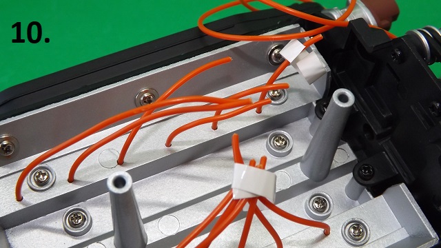

PICTURES 5 & 6

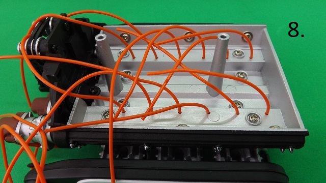

Same process again of removing the black bands holding the leads and tracing the sequence back using the instructions to get the leads into the correct order.

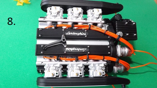

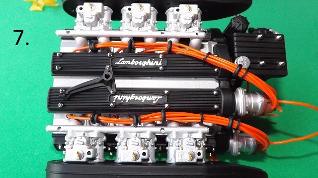

PICTURES 7 & 8
Once all the leads are in place in the cylinder head everything starts to look a whole lot neater.

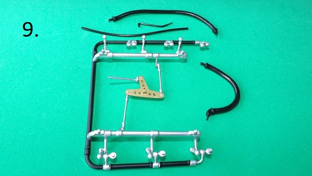

These are the parts that actually form stage 11.

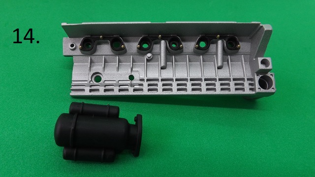

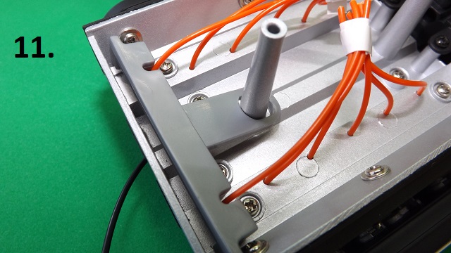

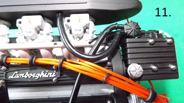

Here we install the Blow-By Gas hoses A, B and C

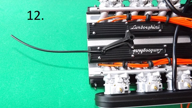

PICTURE 12
We complete this section of the build by fitting the throttle cable.

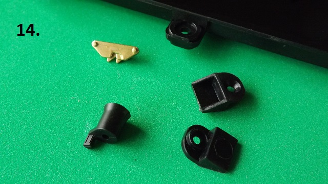

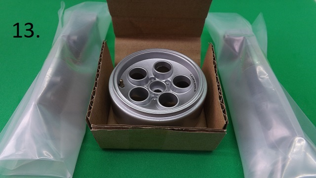

STAGE 12 – THROTTLE LINKAGE AND ALTERNATOR

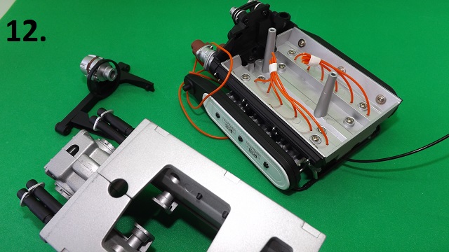

PICTURE 13

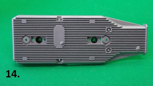

These are the parts we get for this section of the build. A wheel and parts for the alternator.

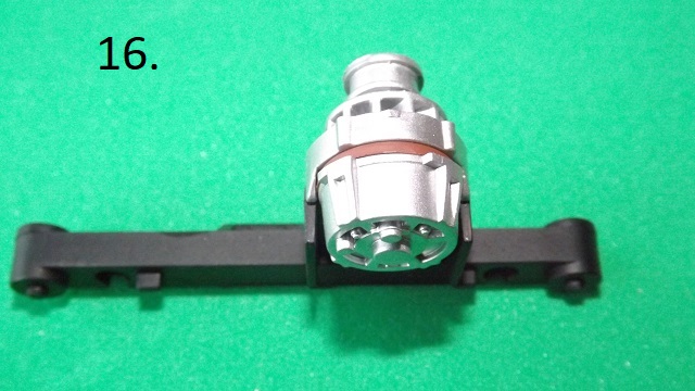

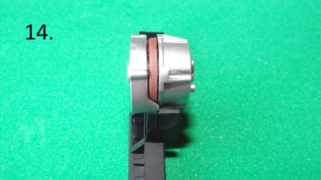

PICTURES 14, 15 & 16
We fit together here the 3 alternator parts supplied with this section plus the alternator fan supplied earlier in the build.

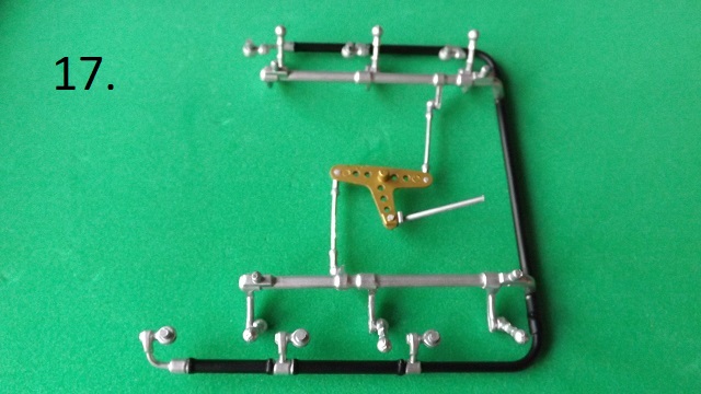

PICTURES 17, 18 & 19

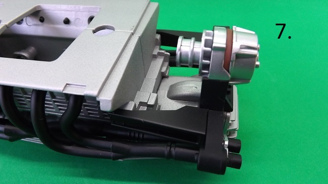

Lot of care required here as we fit the throttle linkage to the to of the cylinder head assemble. Looks quite complicated in the instructions but working around each locating pin in turn it all went together very well.
Only part that needs to be pressed into place with slightly more pressure is the gold coloured crank on the middle of the piece. Care needed as the plastic is very fine and excessive force could see you breaking this part.

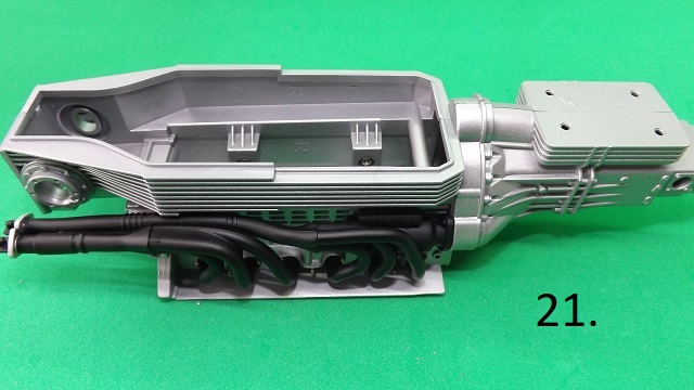

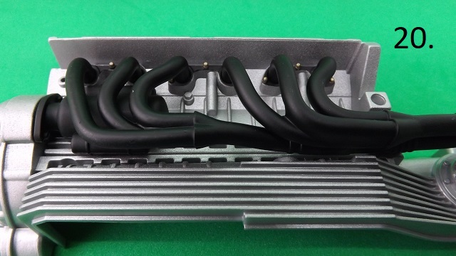

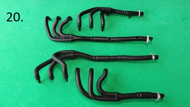

STAGE 13 – EXHAUST PIPES AND REAR TYRE
PICTURES 20 & 21

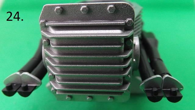

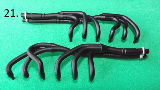

Here we take the 4 exhaust pipe sections supplied earlier in the build and join these together. Its just press fit but needs a little bit more pressure to get them fully located.

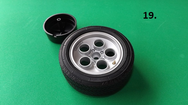

PICTURES 22 & 23

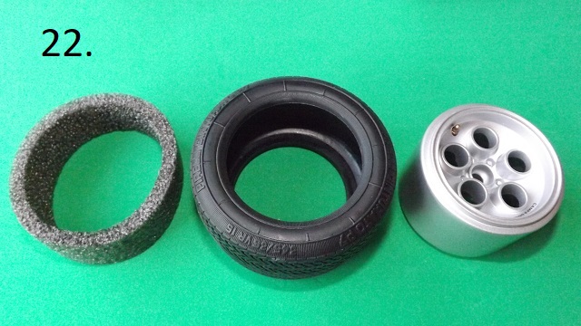

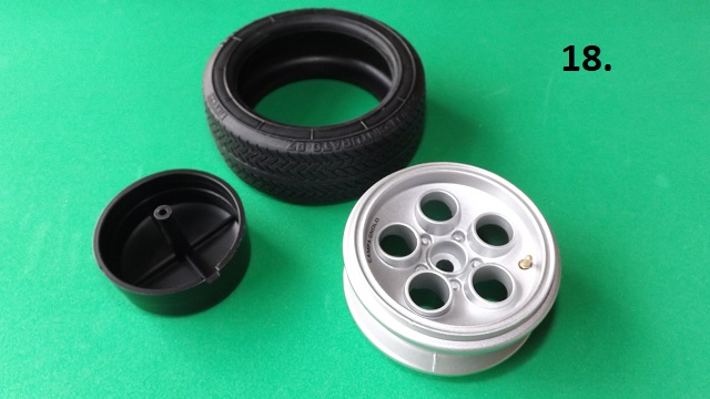

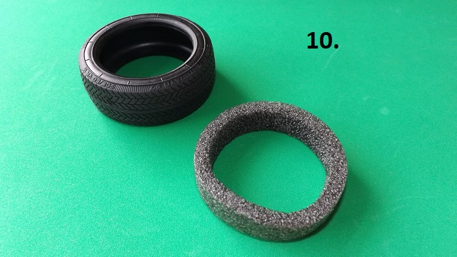

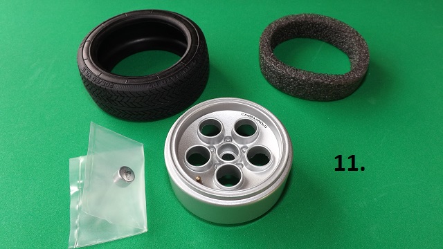

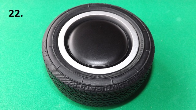

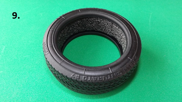

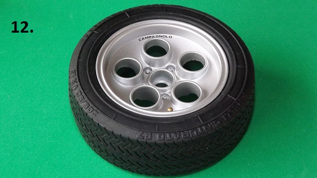

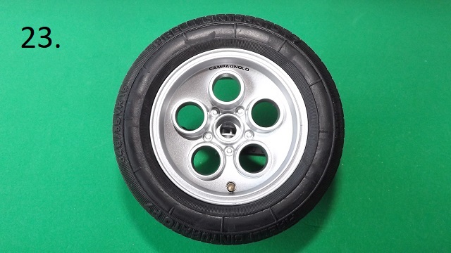

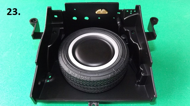

Another tyre to fit to the wheel. As in previous parts of the build they will have you flex the tyre to soften it slightly and then give it a quick scrub with a nail brush to remove any moulding debris. As with the previous two wheels I had nothing come off so a stage that could have been skipped, I guess.
All that is then required is to fit the tyre over the wheel.
Again, you get the centre cap with the wheel so its important to put this away safely as it’s a small part that could be lost before you get chance to use it.

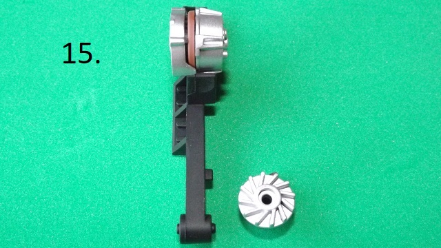

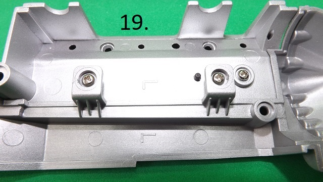

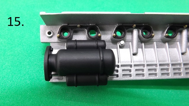

STAGE 15 – FITTING THE ALTERNATOR BRACKET
PICTURE 1
While not used in this section of the build the parts we receive with this section include the Oil Pan and Transmission Oil Pan along with the RH Alternator bracket which is needed.

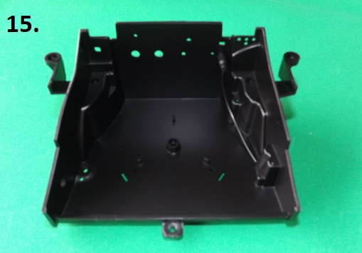

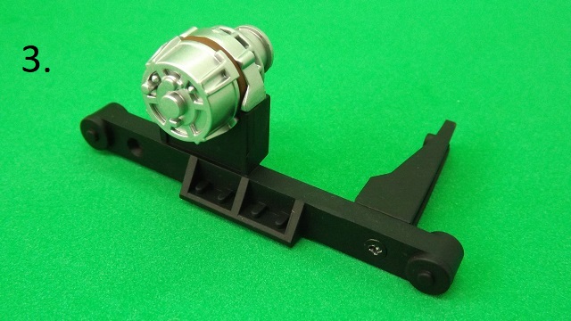

PICTURES 2 & 3

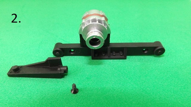

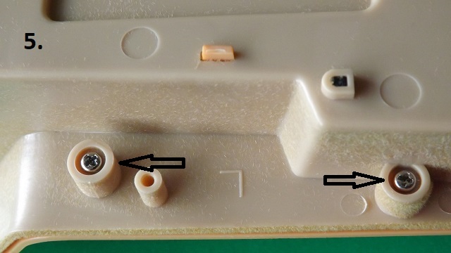

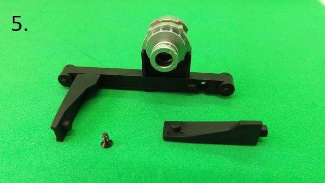

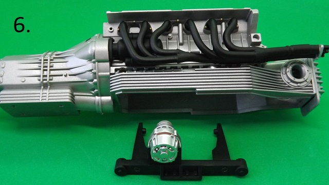

Here we fit the RH bracket to the previously assembled alternator. I sat for a moment thinking “Mine does not look like the one in the instructions” only to realise I had built mine back to front (Note to Self “Pay more attention to the instructions)”.
No major issue to re-build as it was just a single screw holding the assemble together
What I have found is that some of the small screws are really a struggle to fully insert into the plastic parts so what I have found works is a quick “splash” of WD40 on the screw as that helps get the thing in place.
And that completes Stage 15.

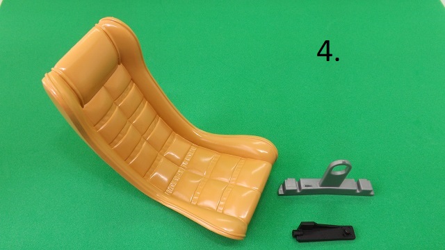

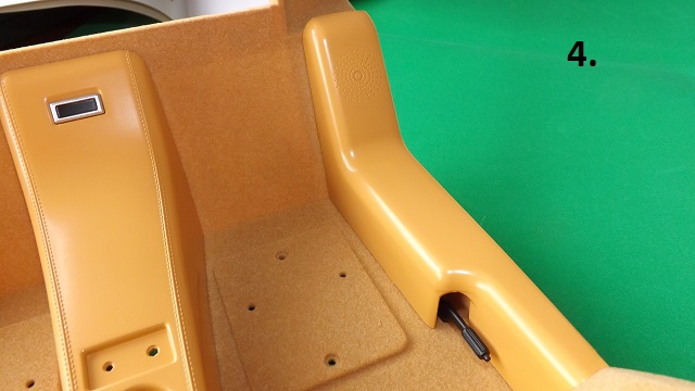

In this section we get the passenger seat, Cylinder Head Spacer and the LH Alternator bracket
In this section there is the detail about adding a clear lacquer to the seats. It suggests that while this stage is optional it will enhance the finished look to the seats.
I do intend to follow this and lacquer the seats but that is a task for another day as its raining here today so not ideal spraying weather.
Also need to disassemble the seats and wash them prior just to make sure there is no oil/finger prints that might affect the varnish layer.

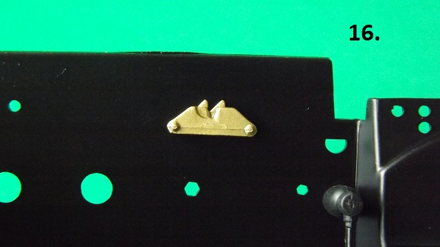

PICTURES 5 & 6
We complete the alternator assemble by fitting the LH bracket.

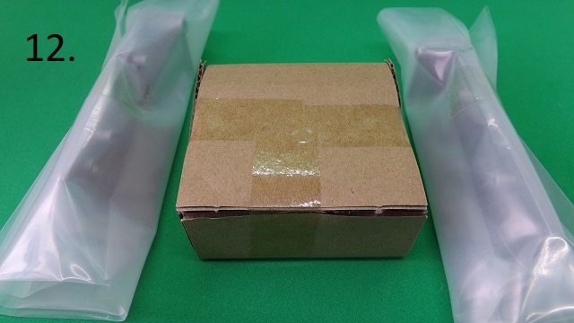

In this section we get the left and right engine block parts along with the front wheel and a couple of other small parts required later in the build.
What is worth a mention here is that the three parts are all metal so to avoid transit damage they have packed each of the engine block parts in their own bag and the wheel is protected in a small cardboard box. Nice touch that and shows a bit of though from the maker.

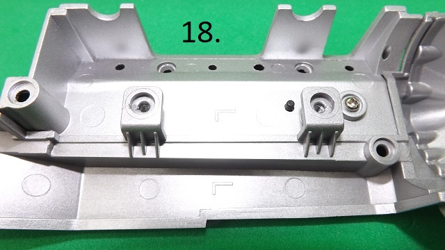

PICTURES 14 & 15
We need the starter from stage 13 and this is fixed to the LH engine block side. While this is putting a screw into a plastic part were the screw is 2.3mm dia I have been using the 2.3mm tap that I have. This makes fitting these screws so much easier.

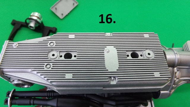

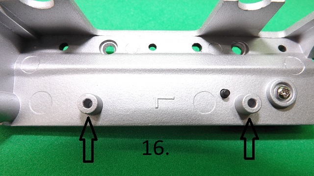

Mentioned in one of my earlier posts that I would have expected this tap to have been included as part of the kit as “tapping out” certain holes on the model get a number of mentions. And in this instance, it’s the 2 holes arrowed in this picture.

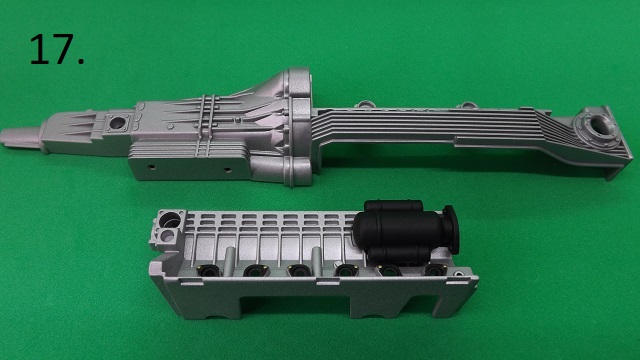

Here we fit the LH transmission case from stage 13 to the LH engine block side supplied with this section. Having threaded the 2 holes, the screws go in with no problems at all.

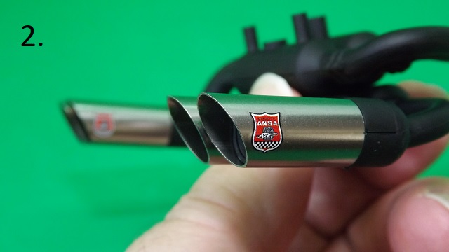

That said I did finally manage to finish the exhausts and I must say I did not find getting the decals onto those angled pipes at all easy. I think in the end the effect looks ok.
The MR Color spray varnishes I have never used before but following the build instructions to the letter I went with their primer and Gloss top coat. You really need to be careful using these as the spray is not light and fine but comes out like “Water going over the falls”.
PICTURES 1, 2 & 3
These show the exhaust parts having been primed, decaled, varnished and installed.

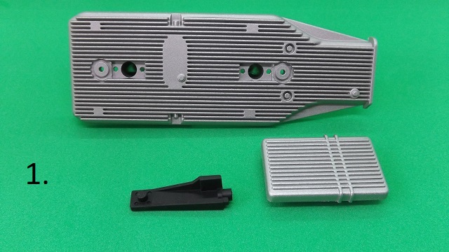

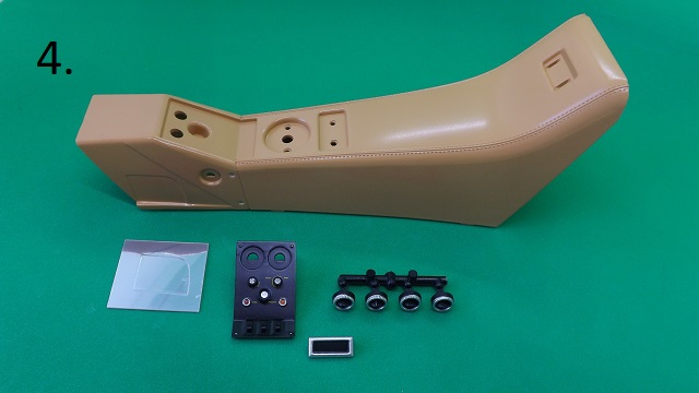

The parts included this time are the Centre Console, Centre Console Panel, Footguard, Heating Vents, Ashtray.
All of these are put away and not utilised until section 19.

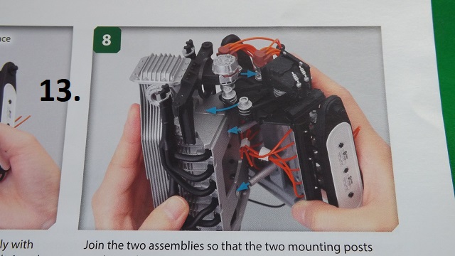

PICTURES 6, 7 & 8

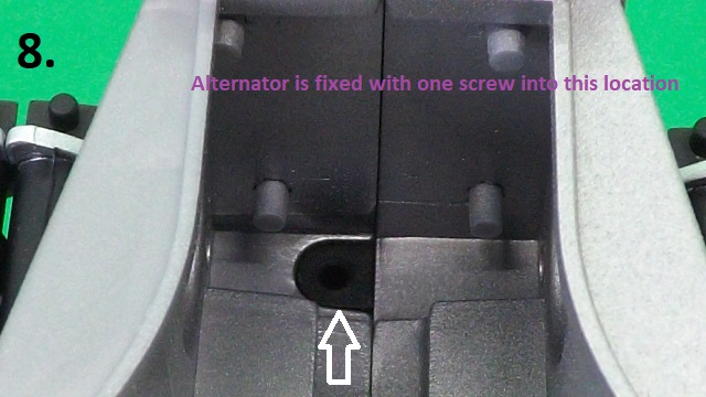

They now have us installing the Alternator to the engine block and while I followed this step, I reversed it later and removed it as it made fitting the cylinder head very difficult, I found.
PICTURE 9

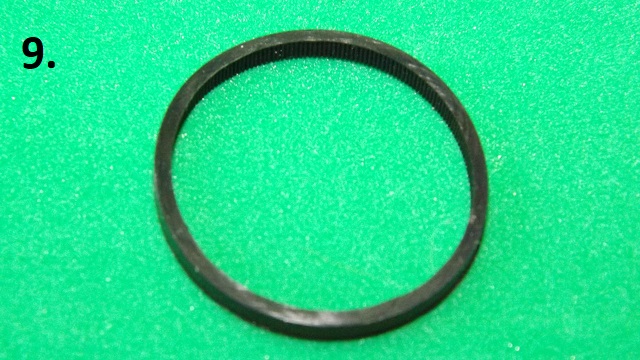

Recover the remaining Belt A from one of the earlier issues. This will be looped over the alternator and the instructions say to hold both that and the cylinder head spacer in place as you match the cylinder head to the engine block.

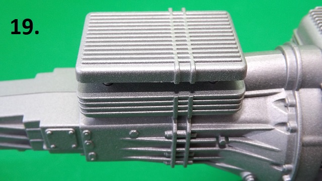

We now put the Oil Pan into place and 2 screws are used to secure the whole assemble. Its into plastic so make sure the screws are tightened down enough to hold but not too much to strip out the plastic threading.
Once in place we use the 2 “Blanking Plates” as in Picture 15 to cover over these screw holes.

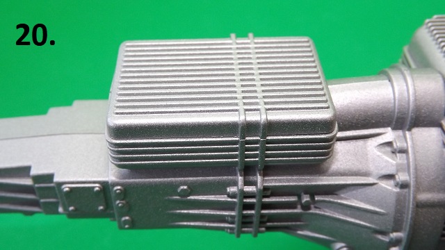

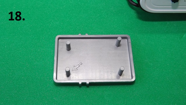

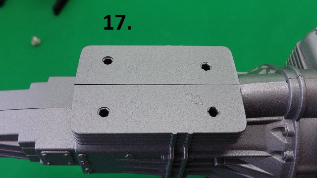

PICTURES 17, 18, 19 & 20
The final part of this section is to fit the oil pan onto the transmission casing.

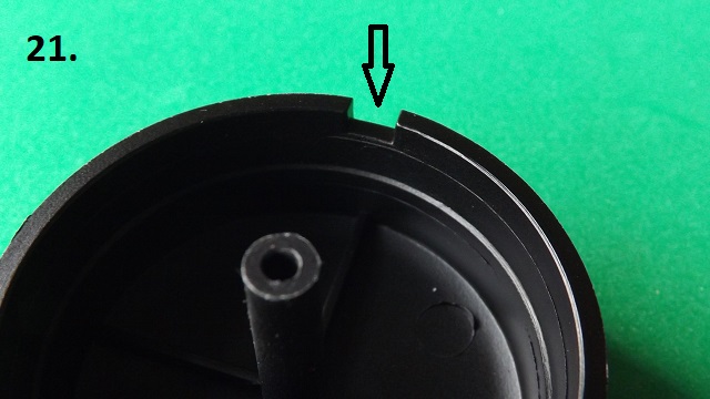

This is just a press fit but make sure to line up the arrowed pin on both pieces.

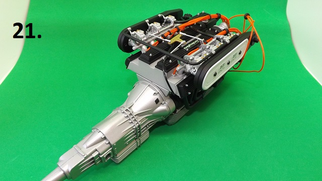

Once the alternator fan belt is pulled over the other 2 pulleys and the throttle wire is fed into the hole in the engine block this section is complete.
PICTURE 21.

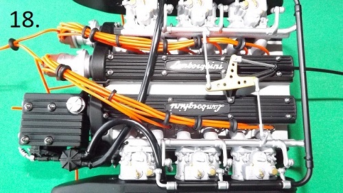

And here is a picture of the engine so far. It’s a massive thing so much so that it hardly fits inside my picture box.
And that completes Stage 18.

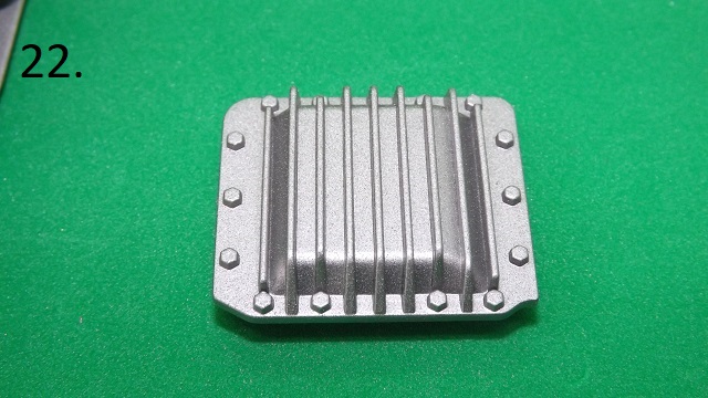

PICTURE 22

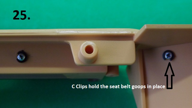

In this section we get the Rear Window Panel, Rear Window Pane, C Clip (4 needed but 8 provided so you have spares), Seat Belt Hoops.

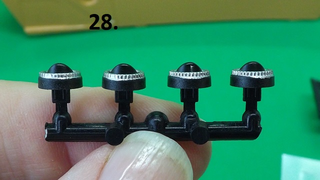

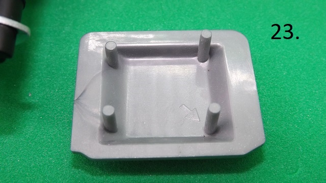

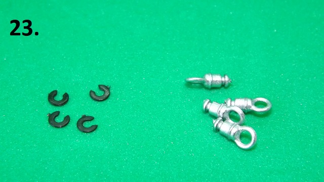

PICTURES 23, 24 & 25
We cut the 4 seat belt loops from the sprue and press these into the holes in the rear window panel.
These are then secured from underneath using the 4 C clips. These have a tendency to want to “Fly off” at all angles so just as well 4 spares are provided with this section.

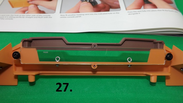

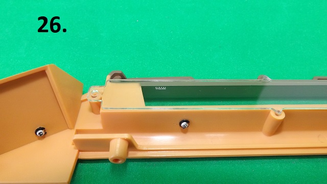

PICTURES 26 & 27
We then drop the rear window into position and secure this with 2 screws.

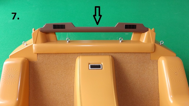

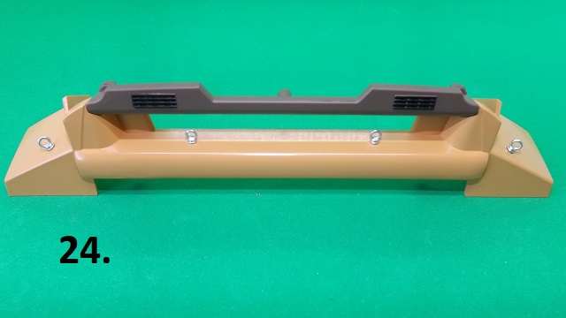

PICTURES 28, 29 & 30

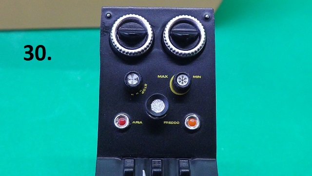

We now start work on the central console using the parts supplied in stage 18.

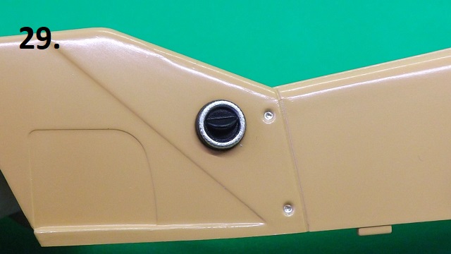

The first part is to remove the 4 air vents from their sprue. These are then press fitted as 2 in the console tunnel and 2 on the console panel. The parts are keyed being a “D” shape so they will only fit one way. And that fit is good with no indication glue is required.
PICTURES 31, 32 & 33

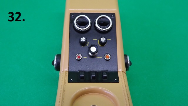

We now fit the astray which is again a press fit. The back of this part has triangular fixing tabs so be aware of the instructions and fit this the correct way by having the triangular posts at the bottom.
Next is the Footguard which is a very shiny metal foil style sticker. Nice touch is the film cover to stop this part getting marked.

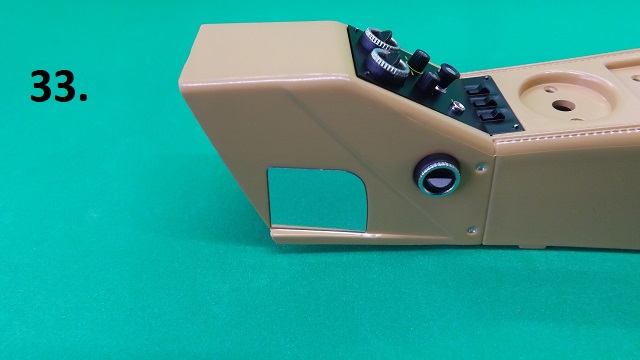

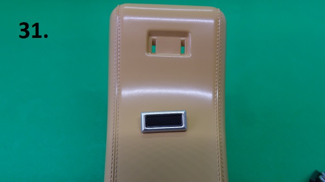

And the last part of this stage is to press fit the centre console panel into the console tunnel. It gets secured in the next stage.

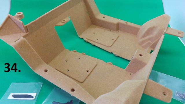

STAGE 20 – THE COCKPIT FLOOR
This time we get a very large part in the shape of the cockpit floor, the hand brake and a footrest.
PICTURE 34
The cockpit floor has a flocking material to give the impression of carpet so great care needed when working with this part not to damage or mark this in any way.

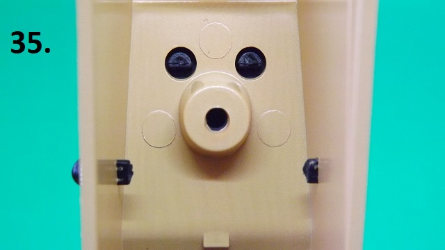

PICTURE 35

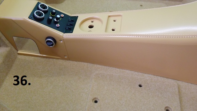

And its at this point we secure the centre console to the console tunnel with a single screw. Plastic again so care when tightening the screw so as not to strip out the hole.
PICTURES 36 & 37

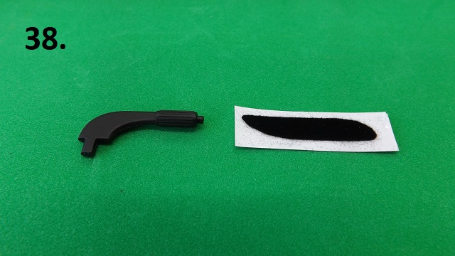

The instructions (picture 37) make a big play on the fact you may have fit issues with the console tunnel onto the cockpit floor and it provides great detail on how to ensure this does not happen and if it does, how to correct it.
Mine went together with no problems.
PICTURES 38 & 39

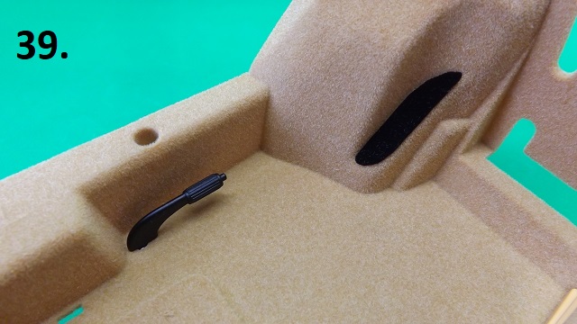

And we complete this stage by pressing the hand brake into its location and peel the foot rest material off its backing sheet and stick it into place.

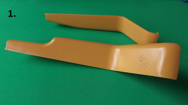

STAGE 21 – THE WINDOW SIDE SILLS AND REAR WINDOW
PICTURE 1
The parts included this time are the Left Side Sill and Right-Side Sill.

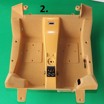

PICTURES 2 & 3
We also need to pull out the cockpit floor from last time as well as 4 x M2.3 x 6mm Self tapping screws and 2 x M2.6 x 6mm self-tapping screws.

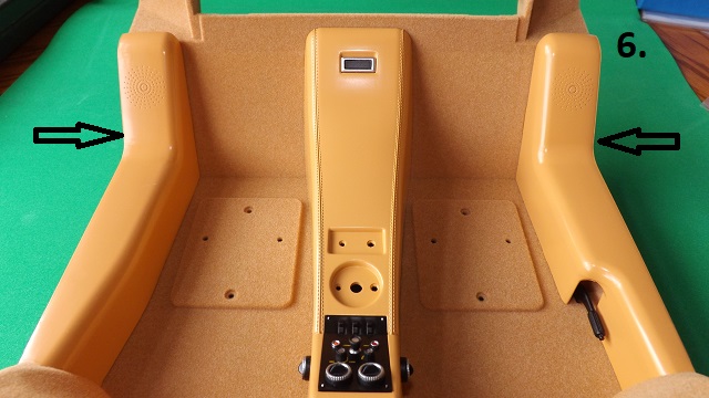

We now start with the left hand window sill and working from the rear press all of the tabs into place
Once in place we secure from underneath with 2 x m2.3 x 6mm self tapping screws. Again, this is fitting screws into a plastic part so ensure you tighten them just enough to hold and no more.
We then repeat exactly the same with the right-hand sill.
PICTURE 6
And once in place (sills indicated by the arrows) this is what the installation looks like.

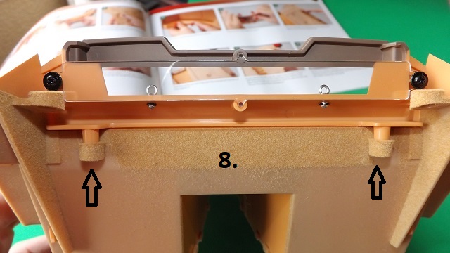

The last part of this stage is to install the rear window that we constructed in an earlier stage.
Pack sure this is pressed into place and secure from underneath with 2 x M2.6 x 6mm self-tapping screws.

PICTURES 9 & 10
We remove the foam liner from the tyre, and then having brushed the tyre to remove any manufacturing debris (again none on mine) we flex the tyre to soften the rubber.
PICTURES 11 & 12
We need the wheel from stage 17 and having put the foam liner back into the tyre we fit the rubber tyre to the wheel.
The completed wheel is now stored away (along with the centre cap) safely until near completion of the build at which time the wheels get installed.

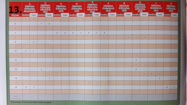

FIXINGS
PICTURE 13
In this month build guide we get a full-page screw guide that details which particular screws arrive with each section. It details how many are used at each stage and how many are left spare.
Now I have been rather lax here and never labelled my screws so now I am “confused”. Mainly because I have more spares of certain sizes at this point than the chart indicates I should have.
NOTE TO SELF: From no on make sure you label up the bags of screws as they arrive

STAGE 23 - THE FRONT COMPARTMENT
PICTURES 14 & 15
The parts included this time are Font Compartment, Belt Stoppers x 2, Bonnet (Hood) Lock, A/C Dryer Filter.
PICTURE 16
First part is to press fit the Bonnet (Hood) lock into place.

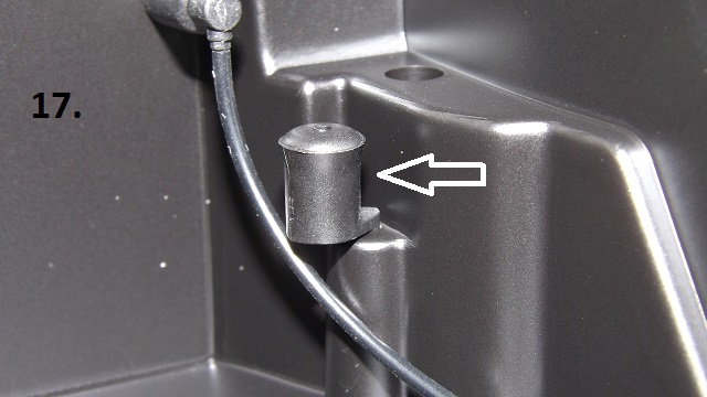

PICTURE 17
We now take the A/C Dryer Filter and noting the key (D shape) press fit this into the front compartment. Quite a tight working area so a pair of tweezers may help get this part into place.

STAGE 24 – THE SPARE TYRE
PICTURE 18
The parts included this time are Spare Tyre, Spare Wheel, Spare Tyre Cover, M2.3 x 6mm Self Tapping Screws x 2
PICTURE 19
With this tyre there is no foam liner so all we need to do is press the wheel into the tyre and ensure its all correctly seated.
PICTURES 20, 21, 22
We then need to fit the tyre cover into the wheel and when doing this we need to ensure the tab in the wheel and the slot on the cover line up when pressing the 2 parts together.
PICTURE 23
And the very last part of this stage is to place the wheel into the front compartment. Store this away safely until its needed again in a future build section.
So, until the next shipment that completes Pack 7.
