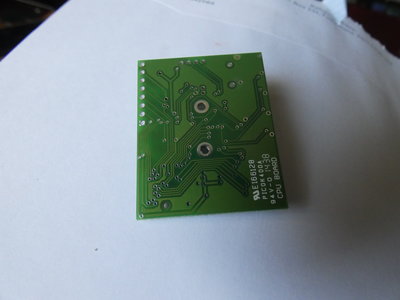

#21 Posted : 30 June 2019 17:24:08
here are two photos of the old board.
Steve1701 attached the following image(s):
#22 Posted : 30 June 2019 17:59:50
Steve1701 wrote:
thanks for that derek.
i removed the screws from the motherboard and tried it and it was still the same, so i replaced the board with one that came with the battery and it is still the same. could it be the servo that the legs push in to, it does rotate but i cant think of anything else, there are no burn marks anywhere that i can see.
Confused Confused
Was hoping that would give you a clue.
My next way to look at this is to build from a point where the arms work and then whilst working forward in the process check after every operation, ie place something check arms, put a screw in (just one at a time) check the arms again and proceed like this until the arms cease to function. Hopefully this may give an area to look into.
