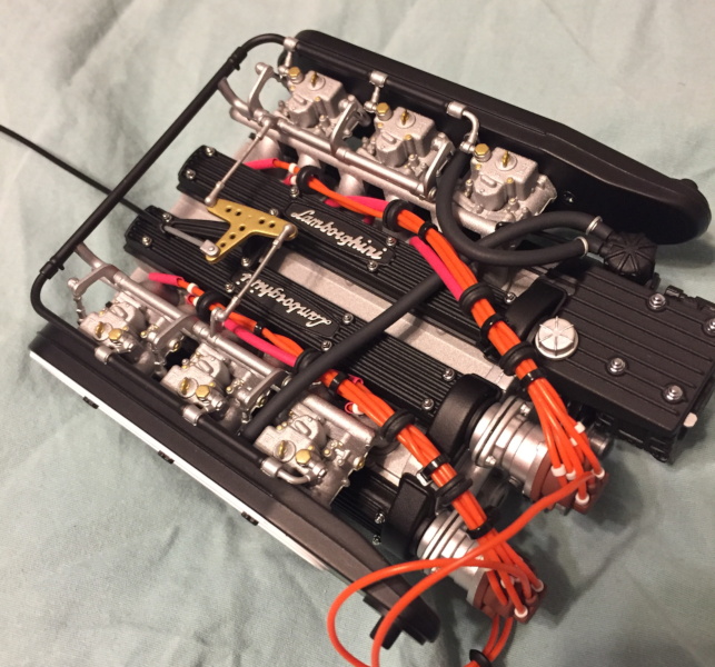

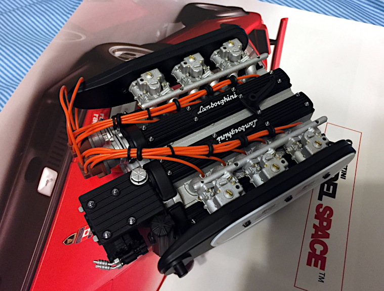

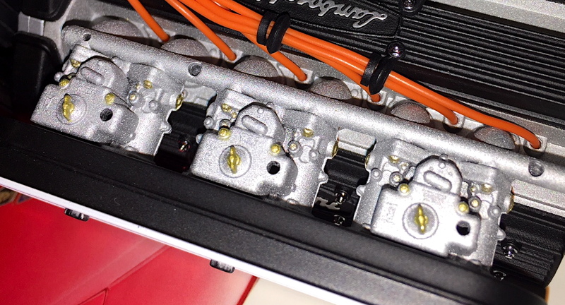

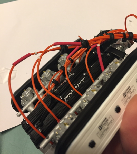

Subtle mod, but I added in as many "golden bits" around the carbs as I could find on the real thing---Tamiya "Titanium Gold" is a pretty close match to the color already present, and I think actually matches photos of the real thing better than what's already there--I considered repainting the existing gold bits with "titanium gold" too, but eventually just left them as-is. About a half-dozen extra bits of gold per carb added, rather hard to see due to small size and subtletly of color---but they're there!
I promised pics when I made some real progress, so here's the engine as it is now (I re-did the wires for "full accuracy"). And a close-up of the carbs, showing some of the extra golden bits.

Just a small update---I am re-redoing the ignition wires, pretty closely following Dave's build here: http://forum.us.model-sp...spx?g=posts&t=17359

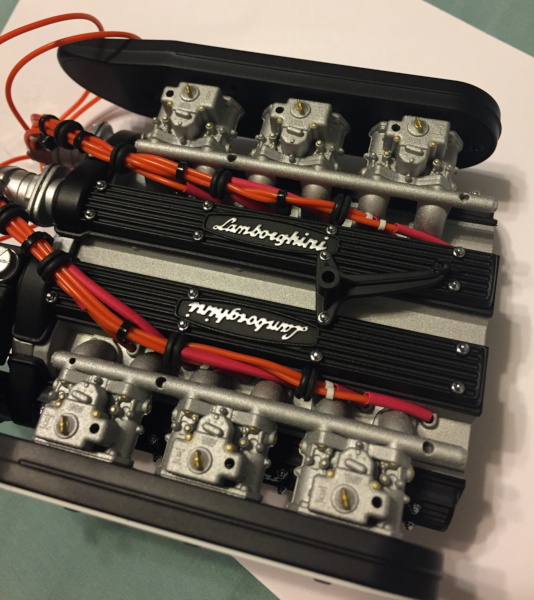

This pic shows the white identifier bands added near one distributor---I've done both now, and have also done most of the mini-grommets and zip-ties as well (replacing the kit's plastic rings) (will post more pics once the wiring is 100% done). Awaiting my order of more 1/16" red heat-shrink tubing (I think it is an even better match for the "additional red jacketing on the wires" than iphone cable-sleeving---but the iphone cable sleeving is absolutely perfect for the little white bands)
Have also sprayed my exhaust tips with Mr Metal Primer (which is hard to find) in preparation of decaling them.
And, I've also ordered Roy's brand-new set of decals, for the starter/coils/battery etc. They should arrive right about when the pack containing the starter arrives. :)

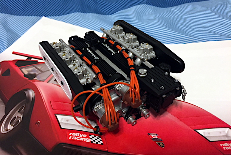

Well, after buying/trying several things over the past couple weeks, I finally found something that worked for the "extra jacketing on the wiring"----3/64" heatshrink tubing. Both the overall diameter and thickness of the material is almost perfectly to scale, compared to the pics. Color's not exact, but it's a rare size so not many options/manufacturers. So I cut some bits to length, following the pics in the instructions as closely as possible, and now have "fully jacketed and fully banded" wiring---"in progress" and "finished jacketed wiring" pics:

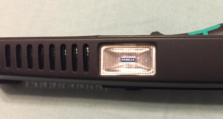

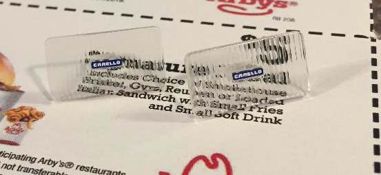

And now that I finally got the wiring detailed how I liked, I could move on and finish the rest of the upper engine. Hoses are painted with Tamiya rubber, and painted their clamps silver.
I also decided that the foglight housing's re-chroming, and the Futureā„¢ coating of the foglight lenses must be rock-hard-dry by now, so installed those (they are crystal-clear now, but they are inherently "corrugated", thus the distortion of the text).
I bought roymattblack's new decal set for this kit, and have applied the first couple ones (for the starter motor) this evening.

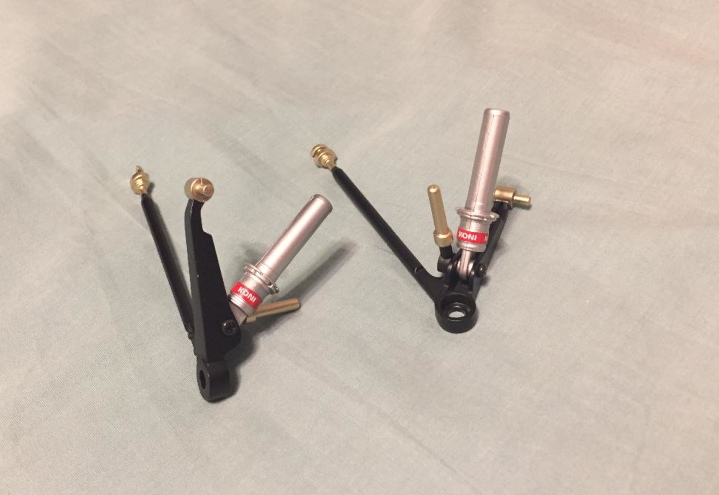

Location: USA
Haven't posted in a while, but it's still going---I've taken inspiration from a few builds here, and my own research, painting up a few extra bits on the suspension etc. Used Tamiya TS-84 for the brass(?) parts, which is the most expensive spray paint I've ever bought, but it is a SMOOTH metallic (no "glitter" effect at all), and is a bit more "dull" of a yellow, which seems to match the factory color a bit better than most "gold" paints.
