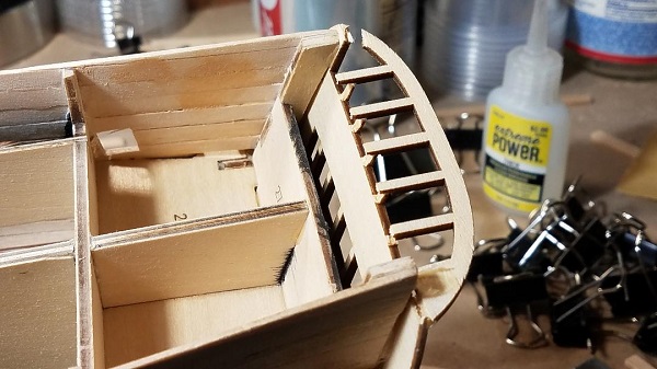

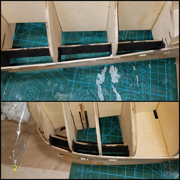

First off I used a sharp craft knife to cut out the paper templates for the Port and Starboard gun ports. These were taped to the sides of the hull with the bottom edge in line with the top edge of the lowermost plank and the rib marks centered on the respective ribs.
Next the gun ports were traced onto the hull with a sharp pencil. I removed the templates and drilled a hole in the center of each gun port location. Using a sharp craft knife, the ports were enlarged to just inside the outlines. Next I used a flat needle file to smooth the openings and expand the ports to the outline (Pic 1).
I went ahead and completed Step 8 now. This basically was just painting the bow and stern supports (parts 19 and 20) behind the new gun ports black. The adjacent frames were also painted black (Pic 2).
That is all for tonight.

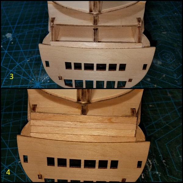

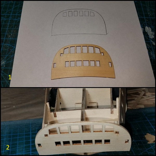

Located the Transom (part 34) and sanded the edges and surface. Before attaching the transom to the stern of the ship, I traced a window template for use in a later step (pic 1). I then glued the transom in place on the stern (Pic 2).
Using the 5 x 2mm planks, I covered the lower area of the aftercastle (Pic 3 and 4). The first plank needs to be shaped to match the curve of the transom.

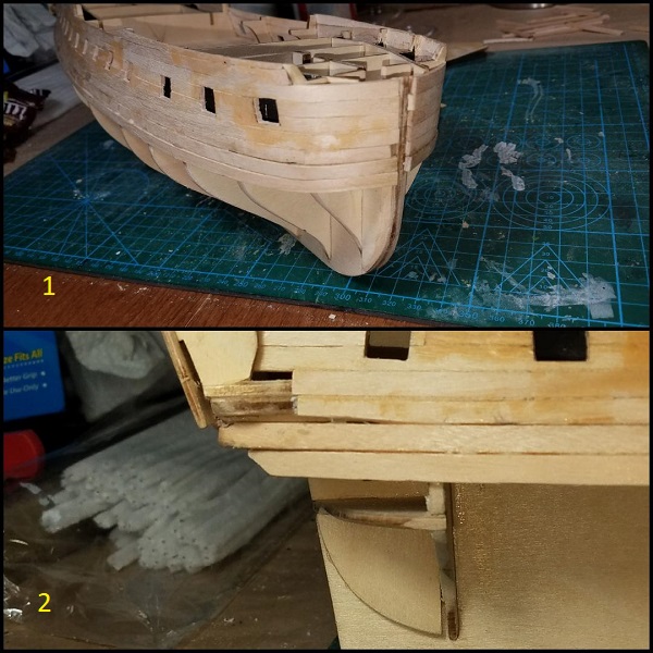

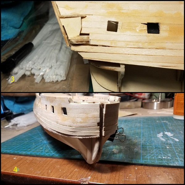

Step 10a

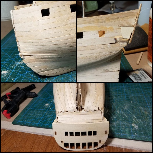

Step 10 deals with finishing the planking of the lower hull. I'm going to split this step into sections for the log purpose. I start off by fitting 2 planks below the last row from before (Pics 1 & 2).

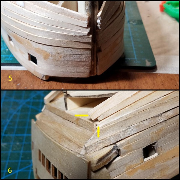

The next 2 rows of planking needed to be tapered to a width of 2mm at the bow and to a point at the stern (Pics 3 & 4). The next plank is tapered to 2mm at the bow and left whole at the stern. It is twisted around to lay flush with the aftercastle planking (Pics 5 & 6).
In the next update I will finish the planking.
By the way, the instructions warn you to be careful not to break the stern transom during the planking. Well guess what I did. Yup, I BROKE THE TRANSOM! Luckily, it glued back fairly easily.

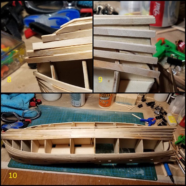

First thing I did was to fit and attach the garboard planks on either side of the false keel, leaving a 2mm overhang all around (Pic 7). The way that I approached this complex twist was to soak the planks until they were good and pliable then using CA glue and clamps to hold the twist while the glue dried.
Next, I added 4 more rows of planks from the garboard toward the deck. Again, leaving a 2mm overhang (Pic 8, 9 and 10). As you can see in pic 9, the planks at the stern fan out leaving wedge shaped gaps between each row.

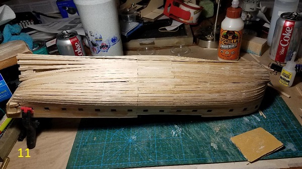

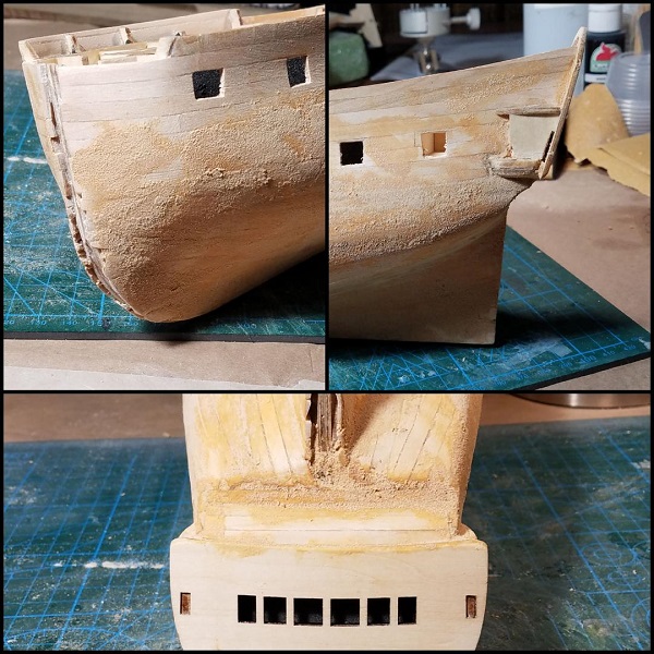

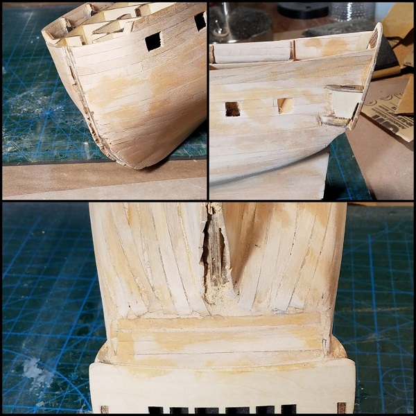

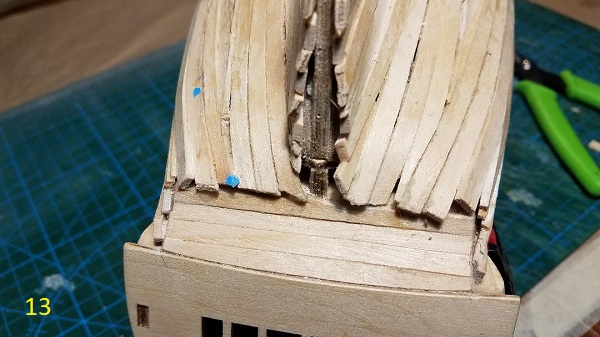

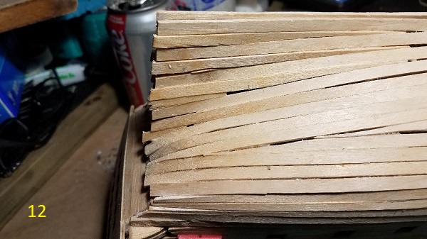

So I have finished planking the hull (Pic 11 & 12). Not the neatest job I've seen. Especially had trouble with the lower part of the stern (Pic 13). I need to invest in an electric plank bender. Didn't get the results I wanted with soaking and nippers.
Looks like I'll be doing a lot of sanding and filling.
I'll be back

#32 Posted : 27 February 2019 10:05:18
Good to see another update Mark. She's not the easiest hull to plank with all the subtle twists and bends that need to be applied and its good to see you have the hull covered. You are going to have a lot of sanding and filling to do so prepare your sanding arm well....BigGrin BigGrin .. The smoother you can make the hull the better the paint finish will be.... Look forward to seeing your next update....Cool Cool

Steps 11 and 12

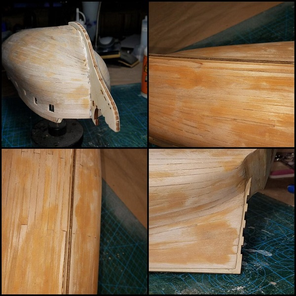

Step 11 consisted of a lot of sanding and filling. Enough said.
In step 12 I first fitted and glued the bow stem (part 35A) in place, followed by the keel (Parts 36A, B and C). The stern post (Part 35B) was the Final part of this step.

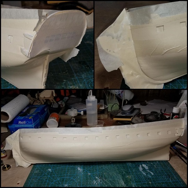

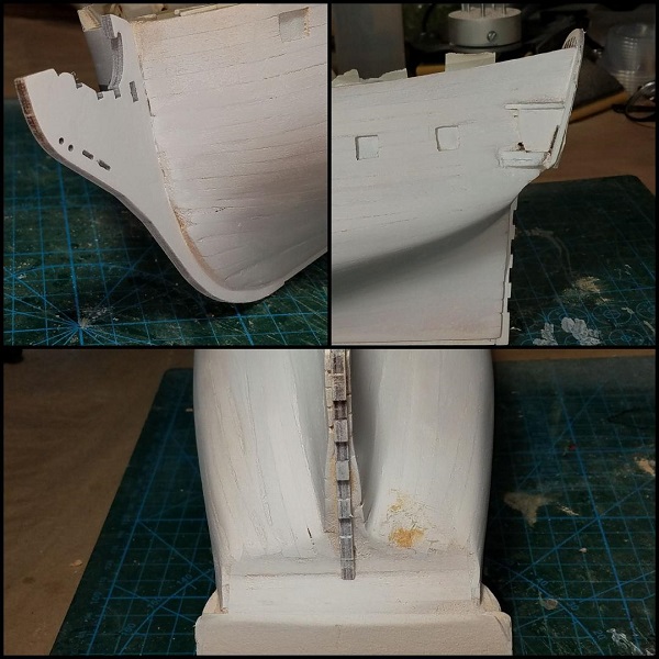

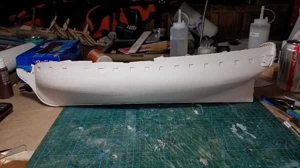

These 2 steps go together. First I did the final filling and sanding the hull.
Then the deck and outside surface of the stern are masked, The gun ports are also masked from the inside. I thin coat of primer was applied and any defects were re filled and sanded before a final primer cat was applied.
Thanks for following my build

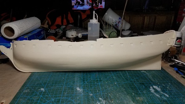

I forgot to mention that I painted the hull with Vallerjo Aged White.

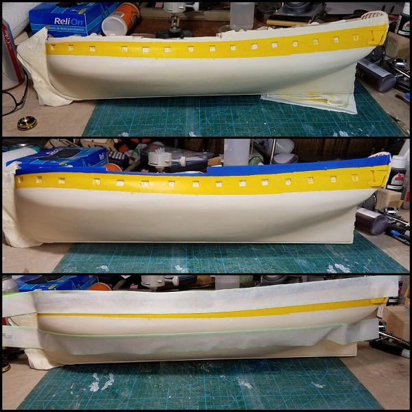

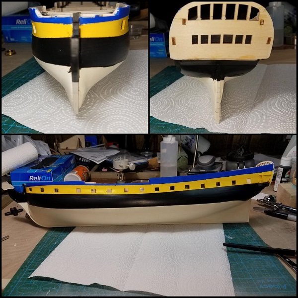

Step 15 consisted of masking the ship and painting the various stripes on her.
First I masked off and painted the yellow stripe along the gun ports. I used 3 coats of paint to obtain complete coverage.
Next I added the blue stripe along the top of the hull.
Finally I masked and painted the black stripe referring to the measurements in the instructions to get the water line correctly positioned.
I used Vallerjo Air paints in the following colors:
Aged White
French Blue
Medium Yellow
Black
