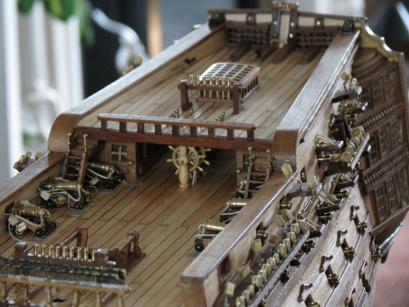

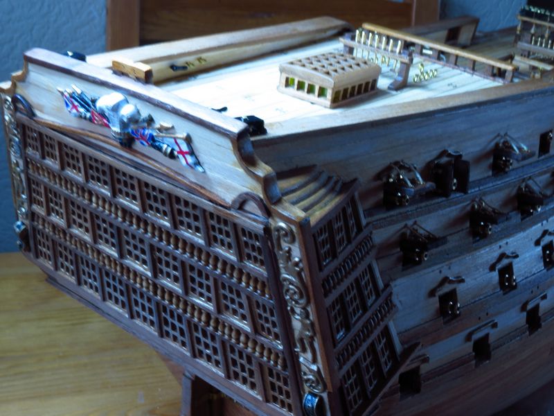

Latest photos of my HMS Victory Build .
Drool
Maldbuild attached the following image(s):
Maldbuild
#24 Posted : 10 May 2012 18:25:11
Joined: 30/08/2010
Posts: 152
Points: 467
Confused Confused Confused
Reduced photos dont seem to want to appear ?? maybe next time lol
Confused Confused Confused BigGrin BigGrin
#25 Posted : 10 May 2012 19:15:36
Hi, well they certainly open up faster,BigGrin well doneBigGrin are you using your computor picture manager? by the way your build is fabulousBigGrin Regards Mike
harty
#26 Posted : 10 May 2012 19:30:24
Nice attention to detail, very good quality buildCool

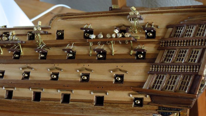

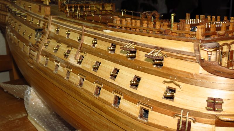

The brass cannons are modified ,I bought the standard dummys and turned the end of the barrel to make them more like the cannon barrel on the completed deck version. The dummy cannon has a tapered spigot ,I super glued them in to the 2mm hole this made them a tight fit . super glue was just added to make sure they dont fall out while i complete the rest of the build . The lower row of cannons i am making extension pieces to allow them to protrude further as these ports are much deeper then the upper layers .
The attached photo shows the rear windows all hand made and fitted individually months of work but well worth the effort .

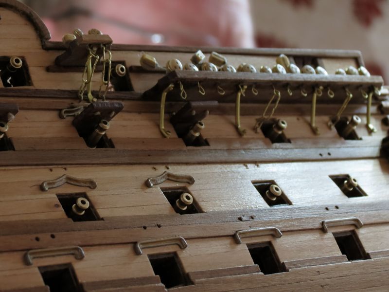

latest Photos of my Victory, hope to start the rat lines this week ,should have some fun with them .
