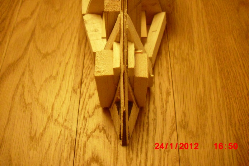

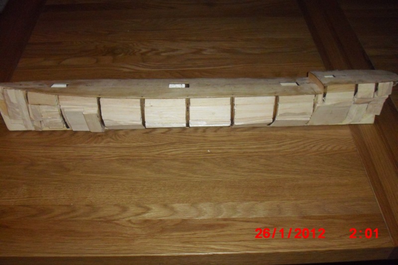

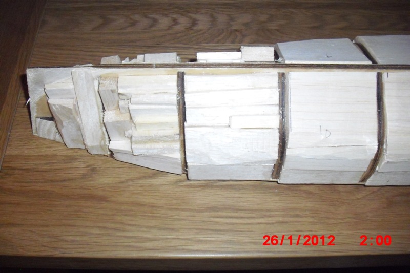

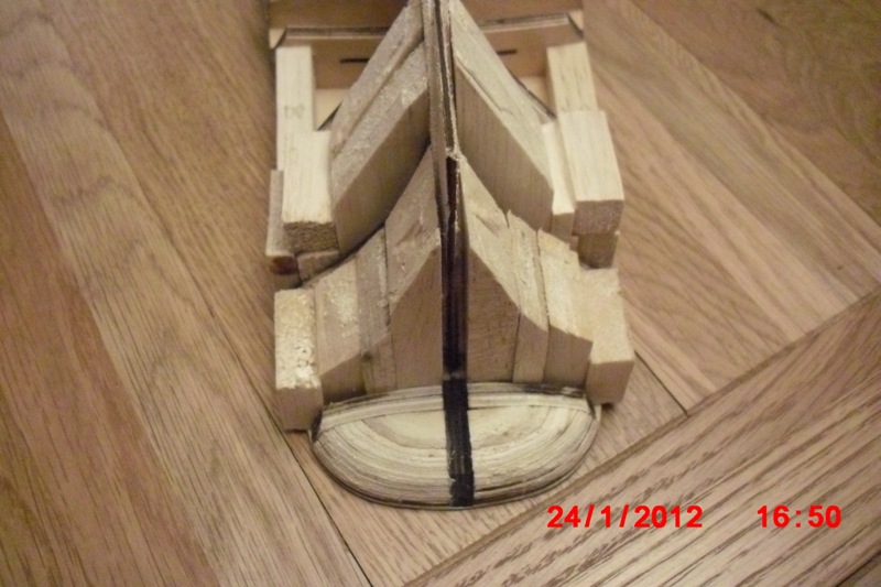

THE HULL

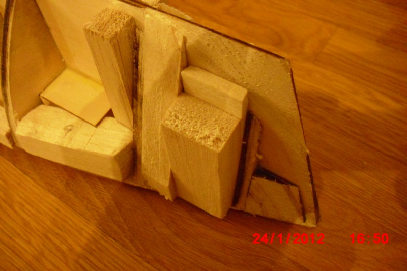

Hi Team the Hull - Bow and - Stern have been shapedBigGrin Now I am going to fit Balsa fillets to the Hull, I want to make sure I get the best shape possible and good fitting planks. This Kit I believe is one of the best models available, and it requires my best efforts, so preperation will be the key wordBigGrin
I have used up most of my offcuts on the Bow and at the Stern,---Have a look see what you thinkBigGrin :-

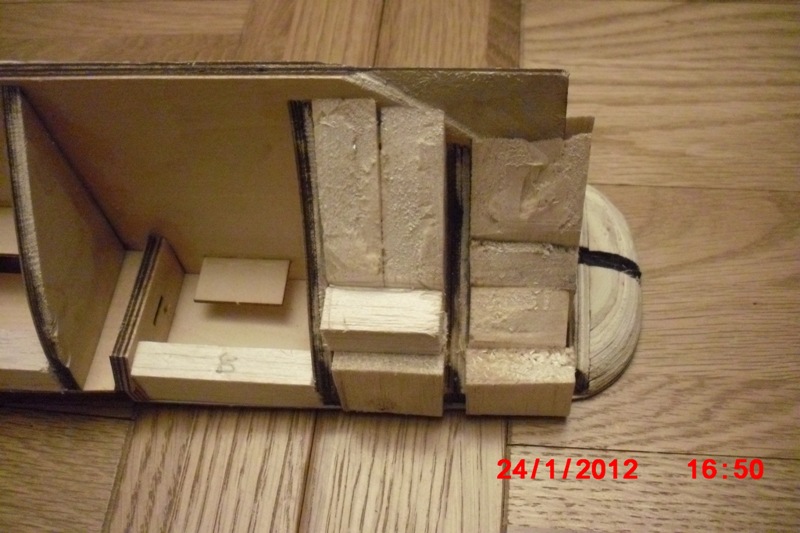

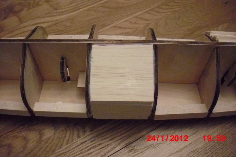

#23 Posted : 24 January 2012 23:43:29
SHAPING THE HULL
Thats used up a lot of pieces, when its all sanded you will not notice the piecesBlink

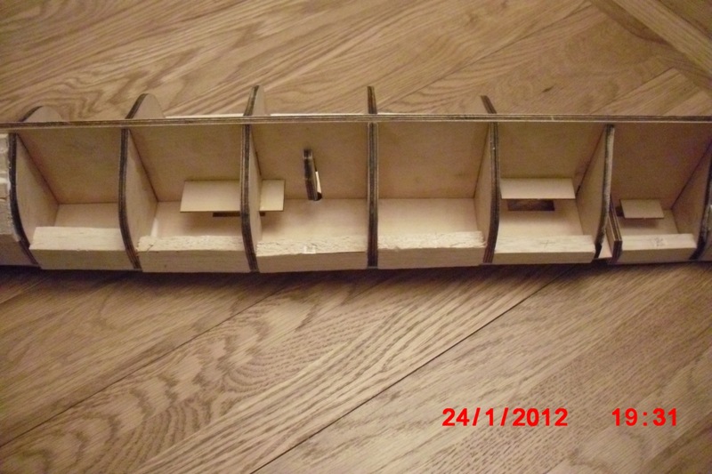

Now I am fitting the support of Balsa around the ply Deck:-

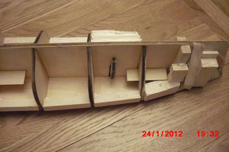

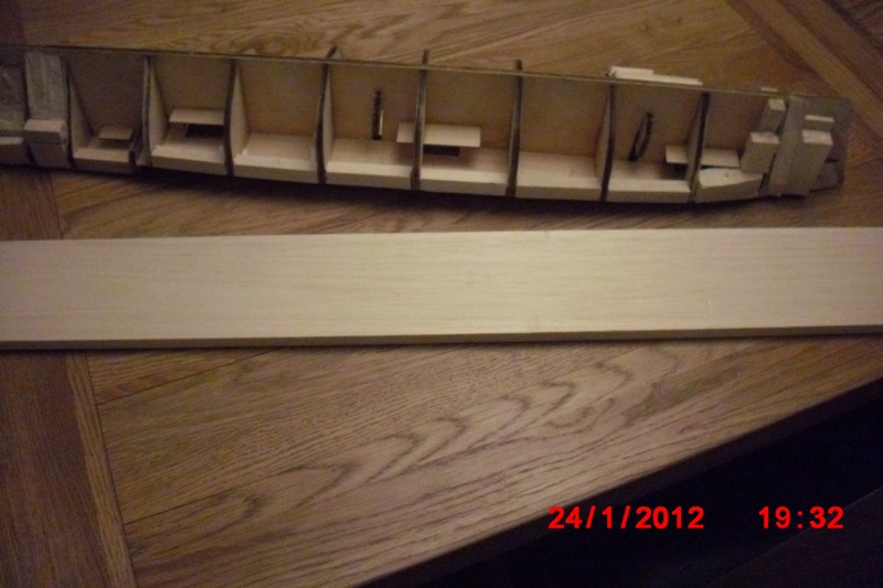

#24 Posted : 24 January 2012 23:47:52
SHAPING THE HULL
The last offcuts of Balsa fittedBigGrin , dont be affraid of using all your bits because this wood is not cheapCrying :-

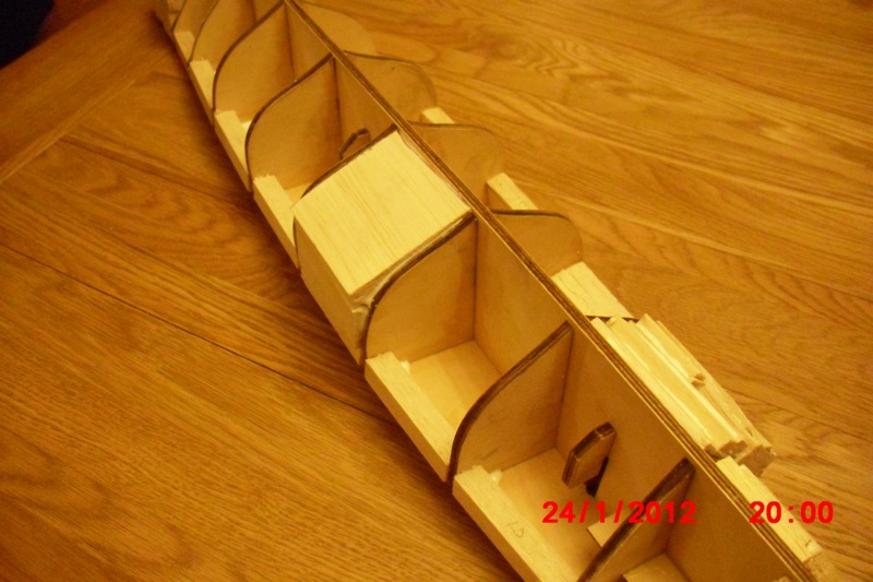

#25 Posted : 24 January 2012 23:54:16
SHAPING THE HULL

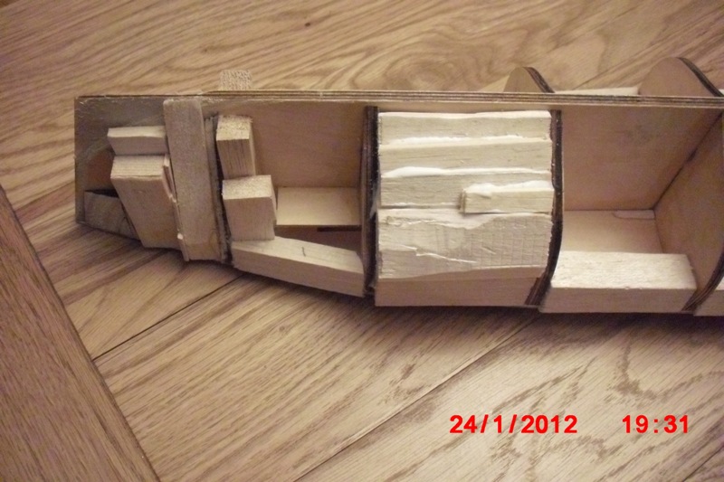

This is a piece of Balsa that cost £4:50 (reasonable price)BigGrin I am now cutting pieces and making a box shape between the ribs.
When I have finished fitting the Balsa I will show more photos then I will shape the BalsaBigGrin
Thank you for watching, questions and comments welcomeBigGrin
MikeBigGrin Cool

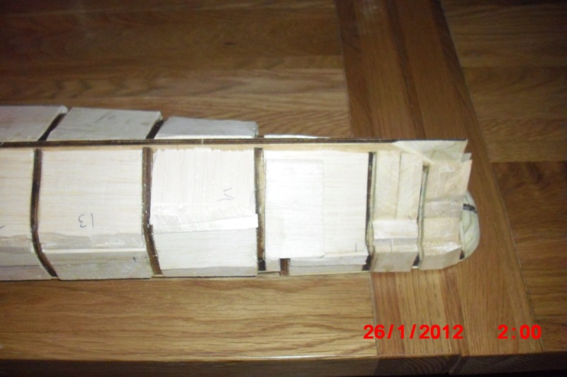

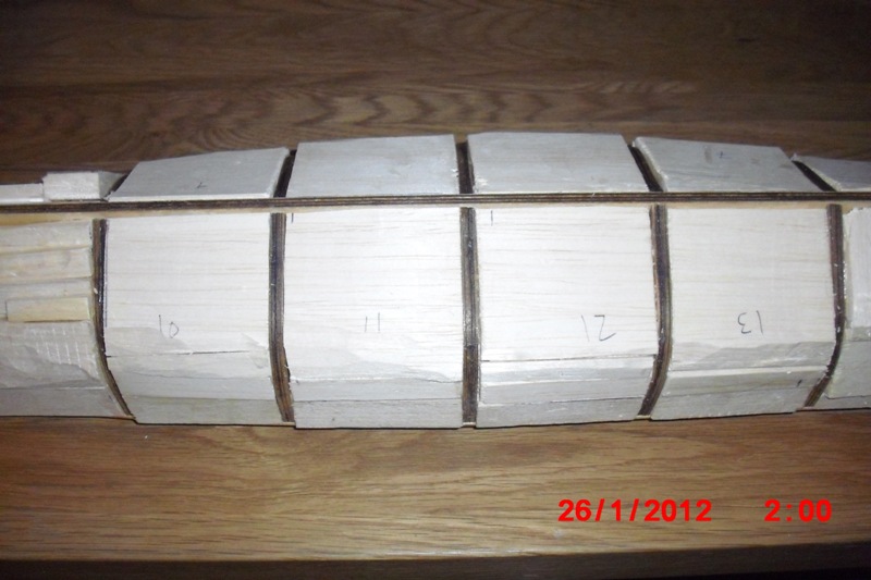

#26 Posted : 26 January 2012 12:29:56
FITTING BALSA TO THE HULL
Well Team the I have fitted all the Balsa this is what it looks like:-
#27 Posted : 26 January 2012 12:34:58
FITTING THE BALSA TO THE HULL
All I have to do now is sand and form the Balsa to the ribs.
When I have done that I will have a perfect surface to fit the planks to the Hull, I will show more photos when it is shapedBigGrin
As usual questions and comments welcomeBigGrin
Regards MikeCool

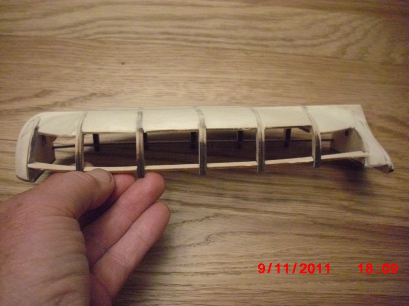

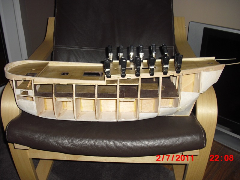

BigGrin Hi Mike following your other builds and you have only balsa'd last frames at bow and stern
Blushing Any particular reason you have chosen to balsa between all the frames on this model?
#39 Posted : 28 January 2012 18:18:53
Hi Budgie, thanks for your questionBigGrin The Victory had Bow and Stern, plus all along the base of the Hull(Keel outwards)Because of the gun ports I did not do the sides. The endeavor I again did Bow and stern,and base of the Hull, not the sides because the sides were very square and she has a centre Deck (see Photo).The San Fran ll I just did Bow and stern to give support to the formed planking. Plus the ship is not very long (all though its the same scale as the Victory and the Cutty Sark)BigGrin
The reason for the all over treatment to the Cutty Sark is simply I want to bring out its beautiful flowing lines BigGrin and give strong fixing points to the the Mahogony planking, and there are no centre decks to navigate and to give me any problem. Oh, I almost forgot I also did the all over treatment to the Endeavour Longboat (see photos)I do hope that answers all your questionBigGrin Regards MikeCool
