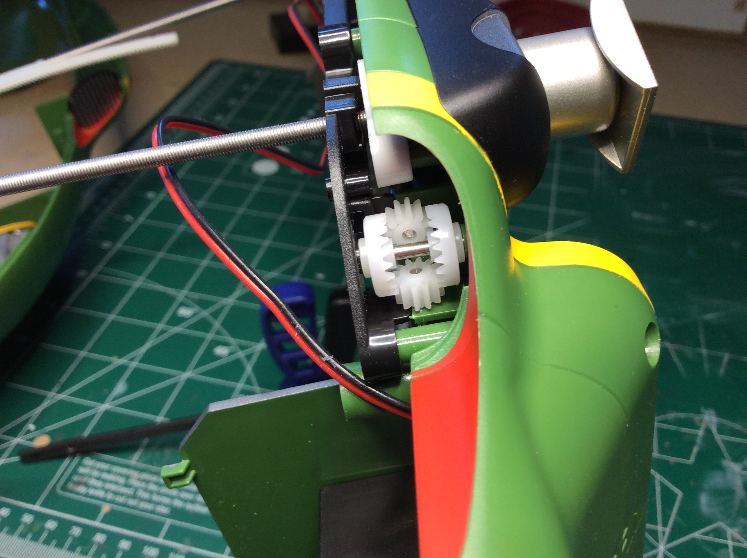

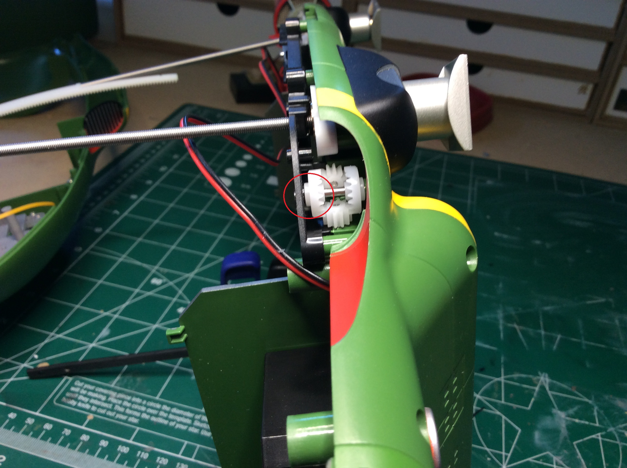

HI, I am also having a problem with the left side legs. They work during the testing but once it is all together the left gears slip and the legs get all wonky
I have attached several photos of the left side crown gear. As you can see I have about a 5 mm space between the side rail and crown gear. I have followed all the suggestions in this post but I still have gear slippage. I did notice the the ribs on the lower side rail that hold the drive shafts in place might be causing the gap in the crown gear Pictures 74.1 and 75.1 shown the ribs I am talking about. Picture 79.1 and 82 show the gap in between the crown gear and the rail

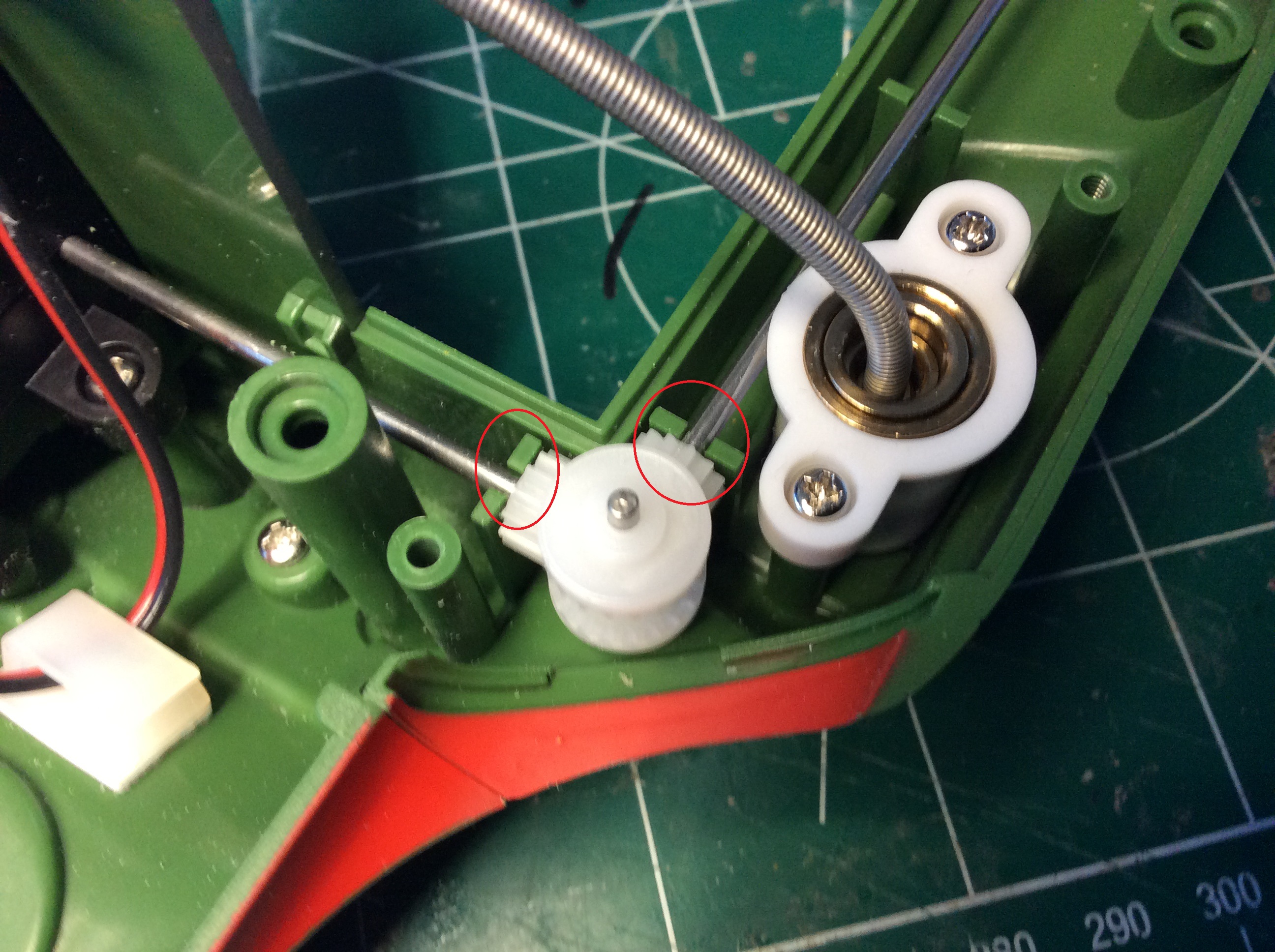

I also posted another fix using washers under the gears if Roys fix does not work for you.I couldnt use Roys fix because I disassembled and reassembled by Tb2 several times and the threads in the plastic were getting worn and I worried they would crack with a bigger screw.
see here;
http://forum.us.model-sp...amp;m=311775#post311775

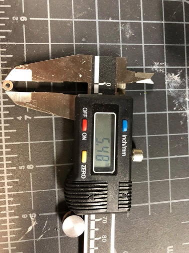

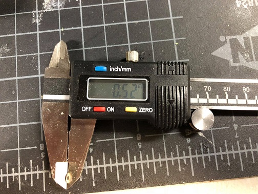

here are the measurements for the washer I used. As Roy mentioned above using a larger screw to screw on the cover for the raising and lowering mechanism may also help.What happens is the gears are slipping because there is a bit too much play once the top cover of the mechanism is fitted.It is fine when you dont have the top of Tb2 on, but when you add the extra weight of the top of TB2 the gears may slip.

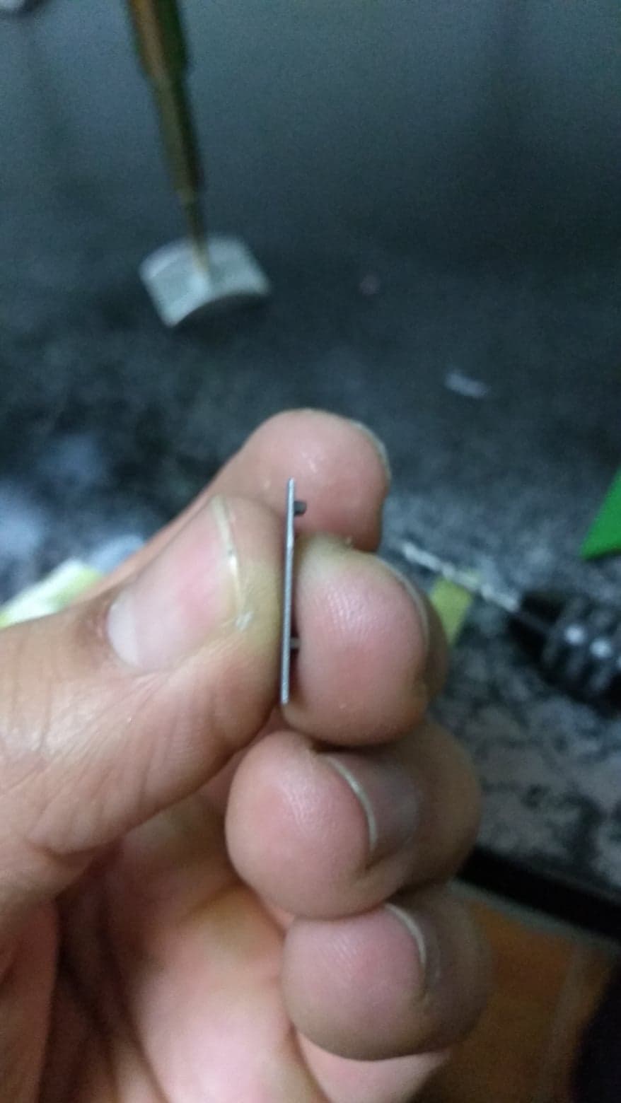

Well, I had the issue of the legs about 4 years more or less. When I get the final volume and test all together (with the fuselage over) indeed the problem was annoying and frustrating.
After 1 month looking the answer I quit, but, yesterday since I completed my TB1 deagostini I decided to give a second try then I read all about this issue. Indeed, the problem is related to the gears and the mechanism of it yet I can not assure is more related to the fuselage, on my experience is the mechanism then I'll explain:
1) The gears were jumping once you turn on the TB, the problem is on each gear that is close to the motor, the black section with the clear part (uhmm lets say the train for the legs) is not good enough or tight to press the gears so they don't "dance" while is moving, that is the cause of the sound like tack tack tack tack and the legs getting lift disorganized.
2) The power of the battery is another factor, if you have a weak battery the mechanism simply will not have enough "juice" to lift the full model (Is a small motor, we can't ask a lot for it but serves us well when all is correctly set).
3) Finally, indeed, is necessary to check all the parts are correctly set, I figured out that I didn't set the small metals that are into the train when you already placed the telescopic leg, they are 4 small metal parts that allow the train move slightly and softly into the clear part if you do not set it the full mechanism will start jumping again.
Now, tu tururuuu turuntuntuuun tun tun tuu tatararaa tarantaaan!!
Solution:

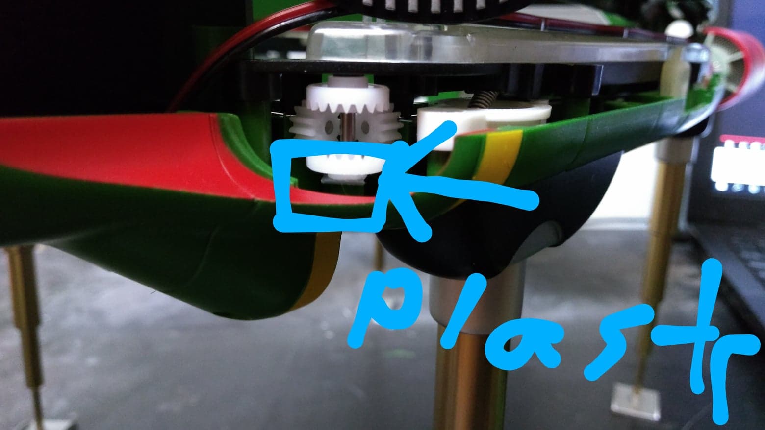

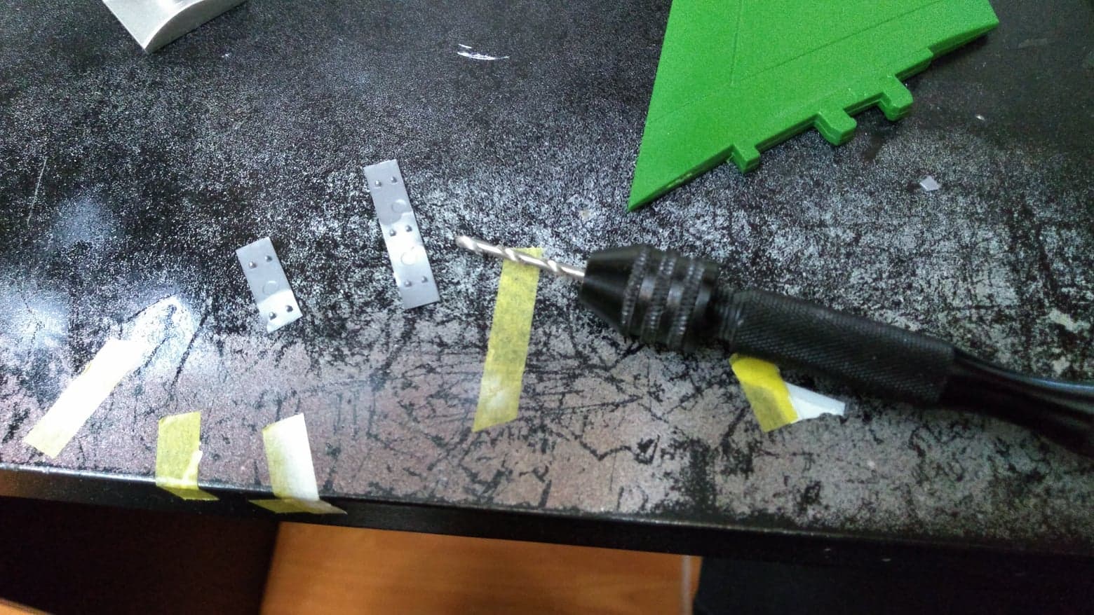

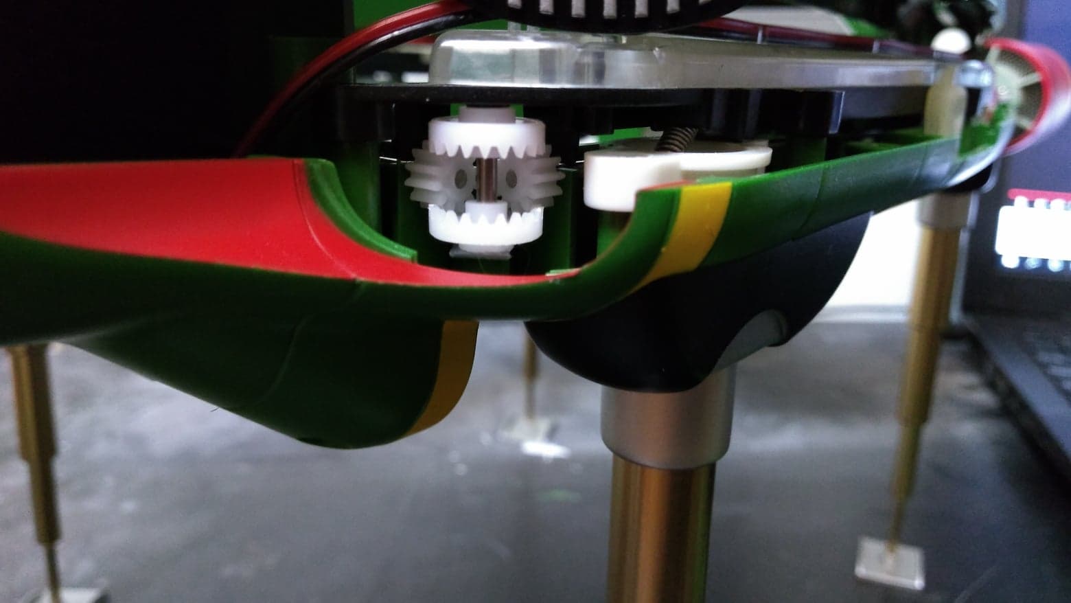

I try my best to attach pictures of my home fix, actually, y used unnecessary part of the TB1 legs to make this works, as someone mentioned before you need to use a washer on the gears that are close to the motor must precisely close to the intakes, and a third one on the right side of the thruster, on the opposite side of the ON/OFF switch, should be a thin washer and will help to press the gears between each other to compensate the lack of pressure in the model. This might vary between each model of yours, mine got the three gears loose then I needed to add three whases, add it on the inferior gear, not the upper since the problem is the bottom gear does not fit correctly for that tiny space that left to make the contact with the other gears.
Finally, I didn't buy a metal washer as I mentioned I use a small, thin piece of plastic that I drilled through with a hand drill (Not an electric one) then I make the hole wide enough to fit with the metal part and used "Kola" to stick it to the gear.
After doing this on the three gears the sound and the jumping of the TB2 stoped totally even with the fuselage, I read that some people fixed by not screwing the nose section (it worked for me also but not for long since the problem is with that "jumping gears".
Suggestion, try each of the gears in your own model and see if they are "dancing" up and down, use a pen or pencil, and if you see there are millimeters missing to make the contact correctly use this process on each one, if you don't I can tell you that the problem will go on until the teeth of the gear get broken for that takatakaka issue because they are smashing and getting out of the correct way of movement.
Thanks for reading, was a full adventure this kit and I hope Degostini take care of the details like this, after all, is a lot of money and is not a simple mechanism as if is not correctly calibrated can easily get broken.
