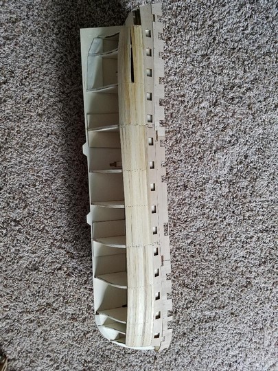

arpurchase wrote:
BigGrin Looking good and nice work. As for the bow ply pieces pre-shaping them helps a lot you could have used a couple of methods by either using an electric plank bender to pre curve the ply or the other method would have been to soak the ply in water and then using a suitable curve like a large paint pot or bucket and fixing it in place with elastic bands or tape to hold it overnight.Cool
I used both a nice expensive plank bender as well as soaking it in water for quite some time. It was essentially the outside layer that snapped as the curve is perpendicular with the grain. Quite possibly if the grain had been the other direction it would have faired just fine as the middle layers did not fracture. That section is the weakest point in such a large curve.
It is just fine though as I will be adjusting the curve by sanding and using some filler behind the bulkwark strips.

Work continues. As I had said before, I am deviating from the instructions as I am finishing the hull before I do anything on the deck and above. With that being said, everything outside of the grates and ladders is done up to about halfway through pack 4 now. The planking is very easy on this ship. I did use the manual plank bender thing that looks like a set of pliers on some of the front pieces. I also managed to get a couple of planks out of order. On one side you can see I have several rows starting at bulkhead #5, but this is ok. I noticed it early and made sure everything looks good and even. With that being said, once I get through all the planks I will make a little spreadsheet for those that want to build this kit so that doing the hull will be a bit easier than following the instructions. I do like the pictures and descriptions, but I am finding that you really have to pay attention to the sequence as on some pages it jumps around. Regardless, I am having a blast with this build. Pack 5 won't be here until the end of the month though. What you see here is the first ten rows completed. This took about three to four hours over two days. Having a good glue is imperative. I use gorilla glue for wood. I also am using a 2oz hammer to drive in the nails and holding them a set of angled tweezers as I start.

Excellent work, she’s coming together very nicely.ThumpUp
#24 Posted : 13 July 2018 08:13:56
BigGrin Looking good and nice work. With Pack 5 take a look at how the stern frames are fitted in the official build as this may help you in fitting yours.Cool
#25 Posted : 13 July 2018 09:24:26
Progressing very nicely, all looking good...Cool Cool
#26 Posted : 13 July 2018 14:08:02
Thanks for sharing your build, looking good Cool
#27 Posted : 13 July 2018 21:23:33
Good to hear you are enjoying your build, it's certainly looking good.
