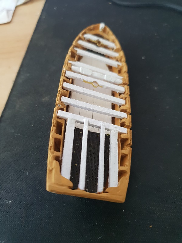

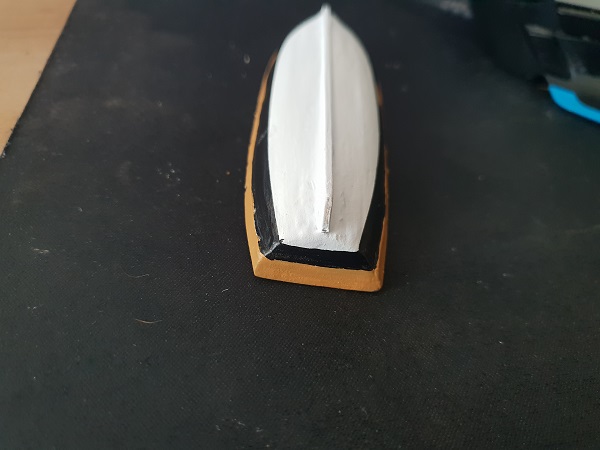

Success!!! sorry this is not a question i just wanted to share my excitement of finishing the hull of victorys boat, i have painted the hull and got to the stage where i have glued the thwarts, i was really worried about the planking but im really pleased with the result, i only have a phone camera so dont know how i could upload pics, its given me confidence for the future of this project.cheers

1st effort at pics hope this works
pfcdre attached the following image(s):
#31 Posted : 27 June 2018 19:13:00
Hi Andre, success all round so well done. Ships boat looks really good.....Cool Cool .. Look forward to seeing more of your build...

thanks Alan, i know there is room for improvement, but my expectations were not high going in to it, so im really quite happy with the build so far, i have the rudder and a couple of bits left to do, the instructions are really good and if i have any doubt i just watch the build video and that clears any confusion up, i didnt realise how rewarding and de-stressing[if that word exists] the build would be, its quite relaxing.cheers Andre
