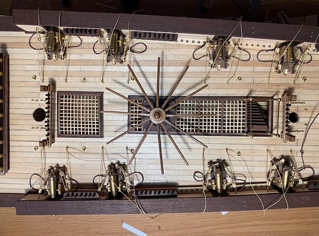

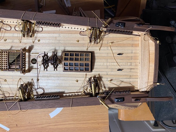

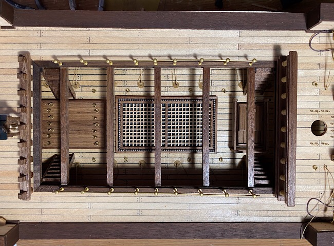

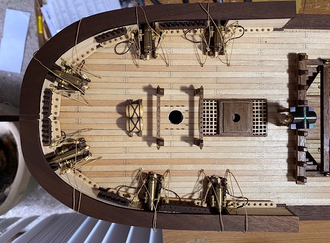

Well nearly a year later, progress has been made though not as fast as I would have liked. Pack 9 and most of the upper deck detailing nearly done, here are a few top-down pictures. I’ve been building a 3D STL file for an appropriately scaled Brodie stove and flue, and trying to make laser cutter patterns for the 5 ships boats, after the Marqardt drawings. I can post more on those if there’s any interest.
Sorry! Having trouble to make images display in the post!
