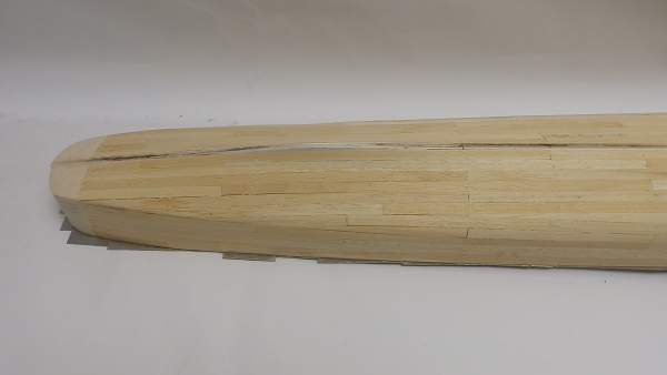

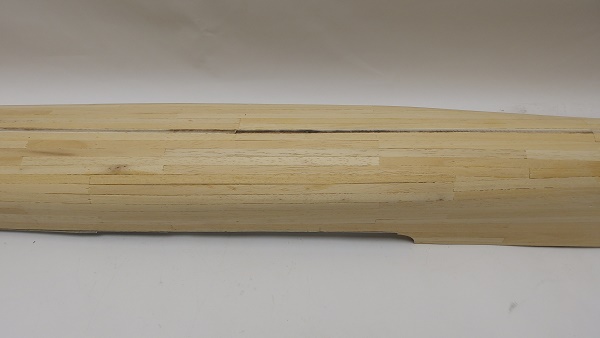

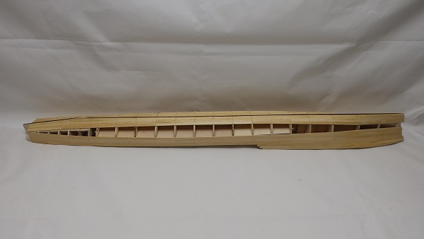

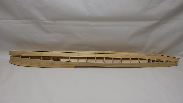

#23 Posted : 27 April 2018 17:05:41

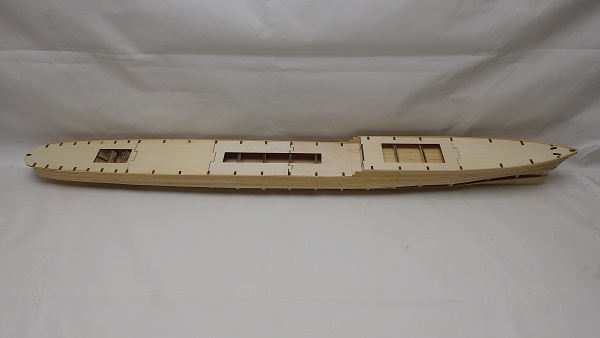

BigGrin Hi all
Planking has started. Firstly three rows were placed starting in line with the rear deck height and then repeated for the other side. These planks were left overnight to dry then the pins removed.
The bow area above the planks already laid were next put in position and then three more rows were added below the planks laid along the hull. Next starting next to the false keel 4 more rows were added to either side of the hull.
More soon.

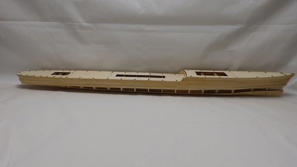

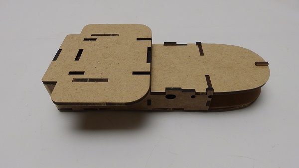

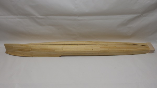

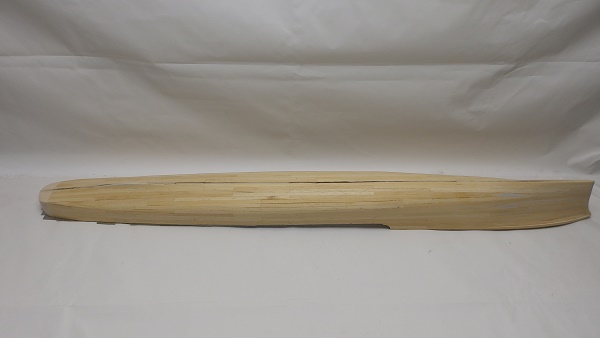

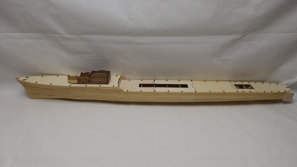

BigGrin Hi all
The planking has now been done and the stern balsa blocks added next comes the sanding and filling where needed. The MDF parts for the bridge have been glued together, still lots to be added to this so its only placed in position on the ship.
More soon.

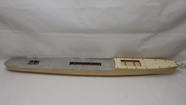

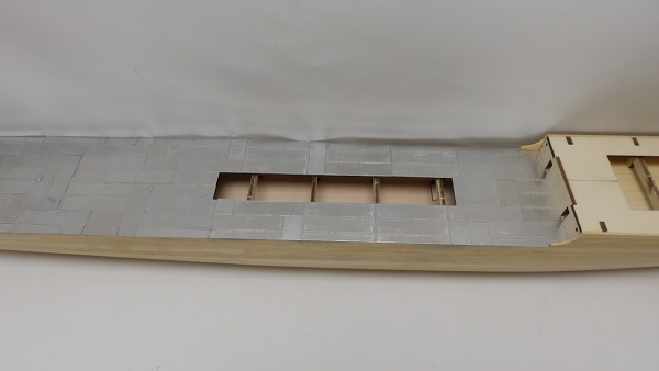

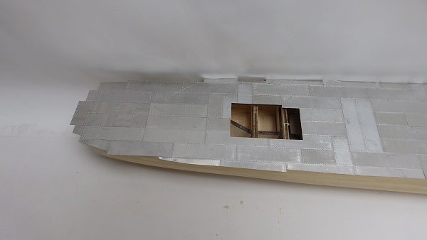

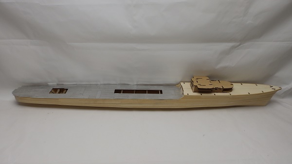

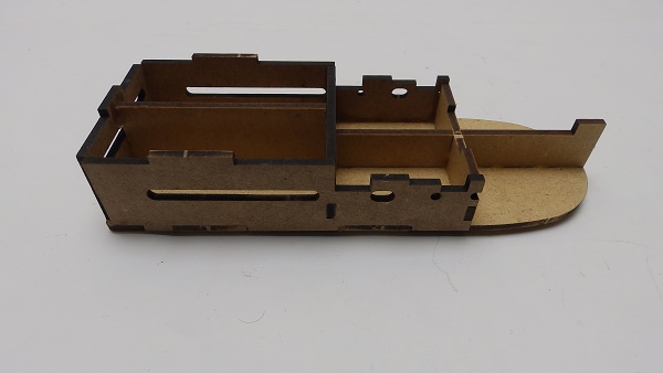

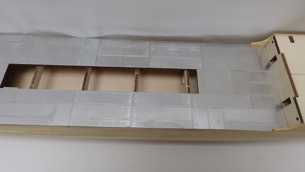

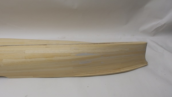

BigGrin Hi all
The stern balse blocks have been shaped and then the whole hull sanded back to get everything level, more filler will be needed in places but that will be after more is added to the hull sides. Next the deck step from upper to lower level was shaped using the provided paper profiles.
Another layer was added to the bridge.
Next is what makes this kit a bit different you are provided with thin aluminium plates in two sizes that have rivet detail. Starting at the lower deck step and working towards the stern the plates are laid in a set pattern to reproduce the deck of the real ship.
Once the contact adhesive has fully cured the plate edges will be trimmed and shaped to the hull edges.
More soon .
#38 Posted : 29 April 2018 19:06:24
Riveted metal deck plating has to be a first in any ship Partwork and can’t say I’ve seen this in any ship kit, a nice detail point they’ve included Cool
#39 Posted : 29 April 2018 21:25:12
Great job Andy, love the deck plating.
#40 Posted : 29 April 2018 23:21:50
Looking good Andy....Cool Cool .. Really like the decking....
