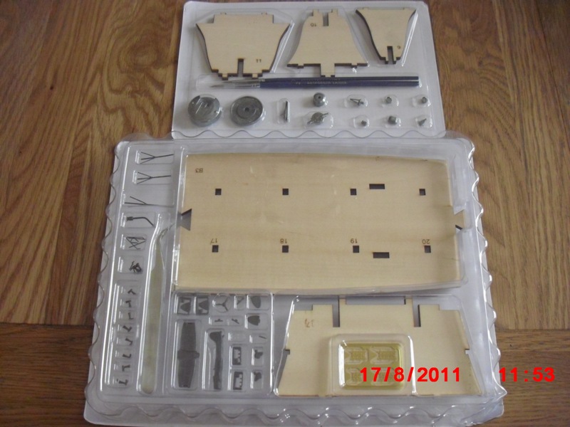

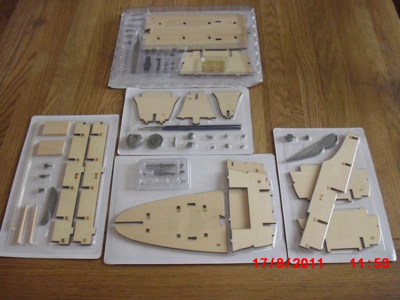

#31 Posted : 17 August 2011 19:34:24

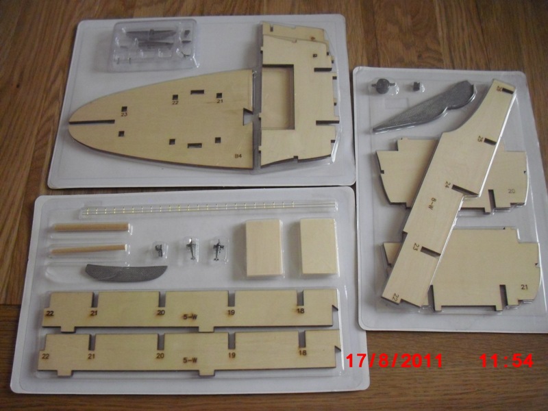

Hi everyone issue 2 has arrived with parts 5/6/7 and 8,it means the complete base of the Hull can be assembled. here are the parts:-(with an extra part 4 incase we make mistakesHuh Confused

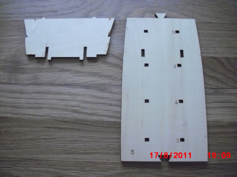

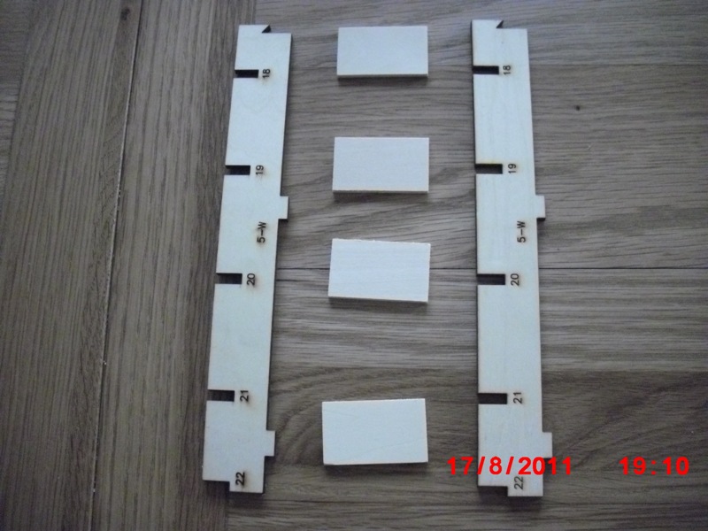

Ok here are some of the wooden parts of the Hull:-

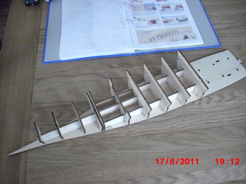

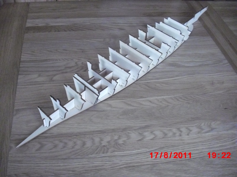

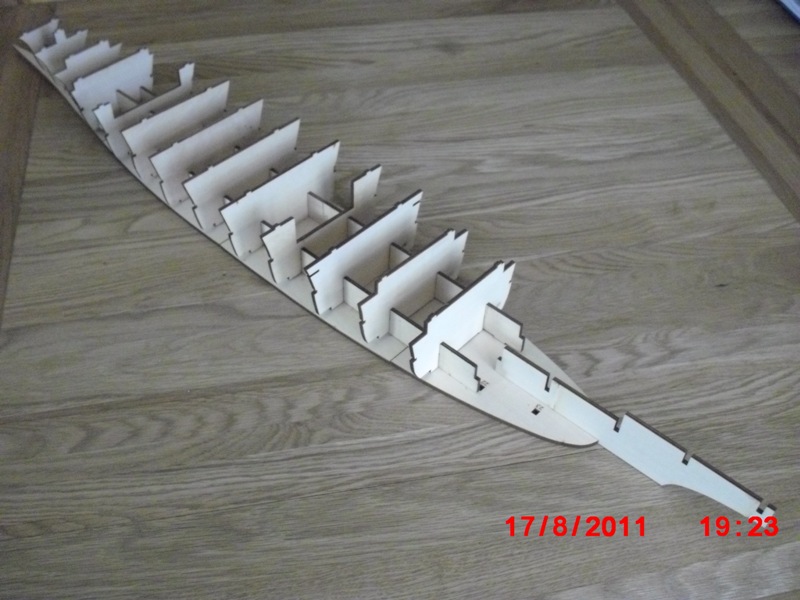

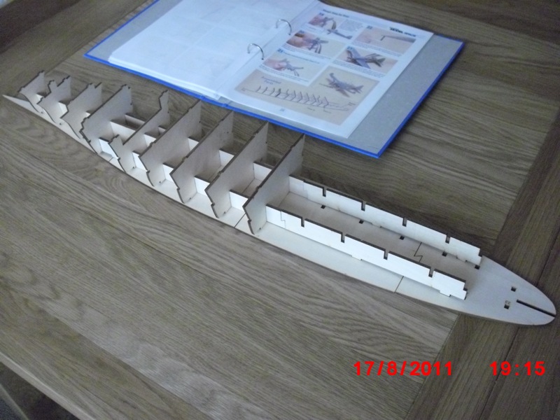

#34 Posted : 17 August 2011 20:42:08

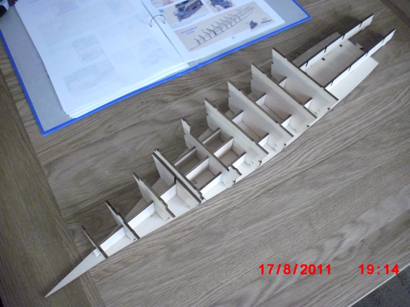

And here is what I did with them, (You can see the instructions in the background which I down loaded off the web site) Please note the parts are all dry fitted at this stage untill I receive all the parts to the Hull and fit them to My Dry Dock ------ but thats for next time !!!!!!Cool
#35 Posted : 17 August 2011 20:57:29
Only thing I would say, is that I strongly advise you mount the base onto a build board before tackling the hull planking whch is to be sure a banana boat won't take shape, and locate the base fixing screws to the inner side of the bottom frame slots Wink
#36 Posted : 17 August 2011 21:07:53
Thanks MR T I have my dry dock all ready, and I will be following your build instructions to the letter, your the only reason I am attempting this build, thanks for the good adviceCool BigGrin
