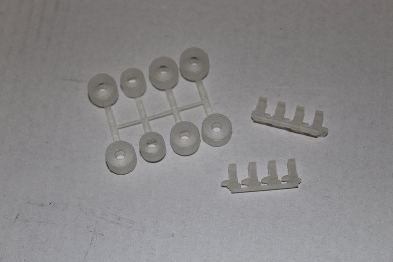

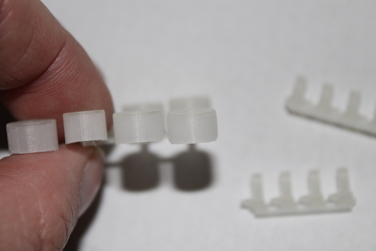

In addition th the wood deck I have my first ever 3D replacement parts for the 8 cranes. the decal on the crane uprights is far superior to the kit part and is correctly scaled on the base housings it is so fine that it won't be seen until under paint, even my camera cannot pick the panel line and rivet detail. each housing is different and the sprue lists which on is which. they will need ladders and doors adding from the etch sets. I will also need to light them. Drool Cool Blink

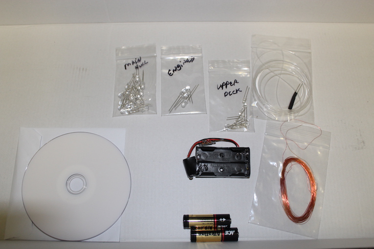

Another enhancement to my build will be the addition of lights. I have purchased a lighting set, but feel I may have to add to it? the set includes everything you need to illuminate the ship even engine lights for the funnels that give a burning glow, 4 are supplied bt only 3 needed. I may have to add additional finer optics and bulbs for them not sure yet

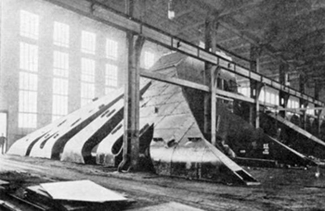

Nice idea on the lighting kit but I doubt furnace glow would have been visible from the 3 forward smokestacks.
Titanic’s numerous furnaces were connected to its three forward stacks by an elaborate arrangement of uptakes (finger-like branches), by which the smoke and waste gases were conveyed to the funnels which by its nature was complex - for example no less than twenty uptake branches being required for one funnel in the case of boiler rooms 3 and 4., And therefore it would be unlikely to see a furnace glow from the 3 funnel tops. The 'finger' uptakes shown below...

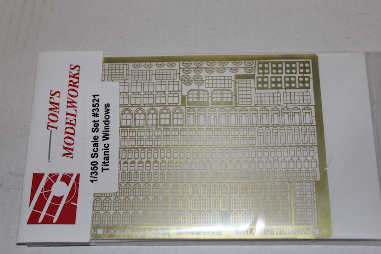

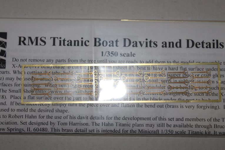

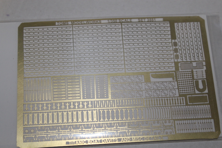

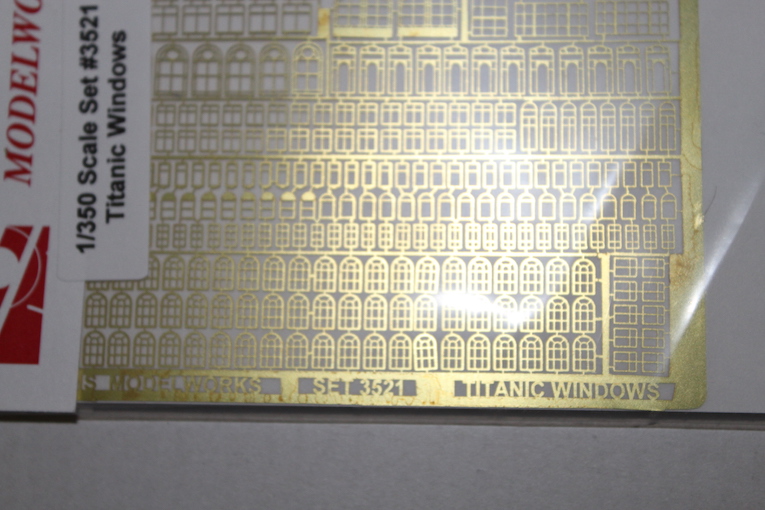

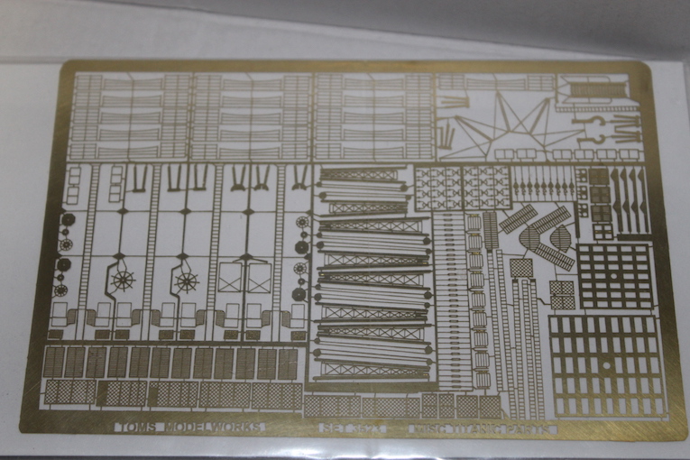

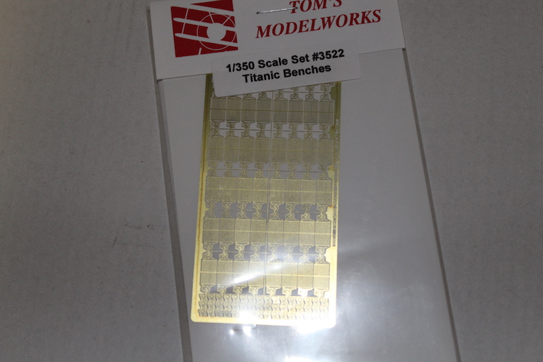

The final aftermarket addition is the obligatory etch.
Toms Modelworks is wildly consider the most comprehensive etch at this scale but it is not the only etch on the market, I used the WEM set on my Academy Titianic to great effect.
I have the complete sett of Toms model works etch for this build this covers all the windows, davits railings skylights life boat details, benches, deck chairs, crane updates reworked commas platform and numerous other goodies.
However even with the etch, the lights, the 3D parts and wood decks there is still some hefty remodelling to do, some to improve accuracy some to accommodate the lighting and rigging. I anticipate this build will take 3 times as long as a straight box build.
I will be kicking of in July but before now and then I will be collecting my research which I hope to be able to share as I go to give a build diary that details the modifications against the evidence. more on reference material soon
#29 Posted : 04 April 2018 21:05:19
JEEEZ Jase,Blink
That etch looks fiddly OhMyGod Cool, but fiddly Cool
Hope you've got good eyesight BigGrin
good luck with it though ThumpUp it will look the biz when fitted.Drool
Gray
#30 Posted : 04 April 2018 22:23:23
BigGrin Some glowing etch examples there Jase hopefully the old eyes wont give up the ghost with all that bending to doCool

Hi Jase I bought the toms hardware set for my 1/400 Academy build, personally I thought the set very lacking (especially the window set)
It's all looking good so far.
