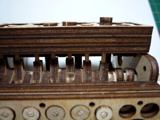

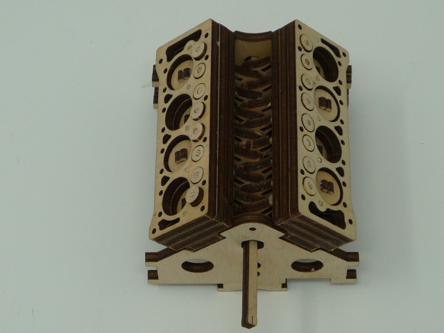

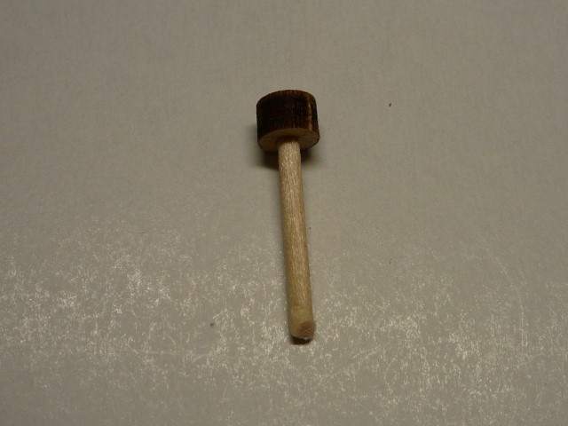

Next, it is time to build up the inlet and exhaust valves. 8 dowels are cut in half, and then to length. The valve heads are numbered 18 and 19 (they call them K1 and K2 respectively). Care must be taken not to mix them up, as, like in a real engine, they are 2 different sizes. The ends of the valve stems are them sanded to a taper. Following the build sequence in the instructions, they are inserted into the relevant ports, and pushed home into the cam followers built earlier. The sequence for each cylinder head is the same: k2,k1,k1,k2,k2,k1,k1,k2, A bit of candle wax here helps with insertion into the ports and cam followers.
Check free rotation, and watch the pistons rise and fall, along with each valve opening and closing, it absolutely amazing BigGrin Woot Woot

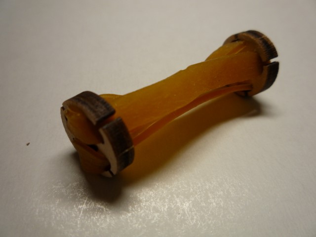

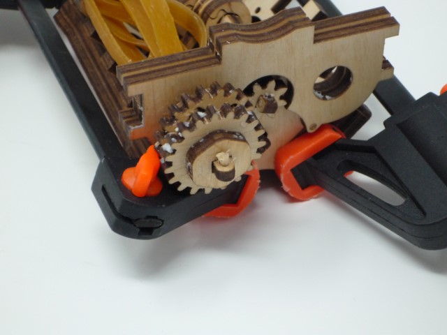

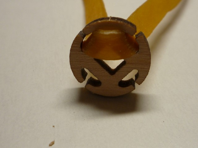

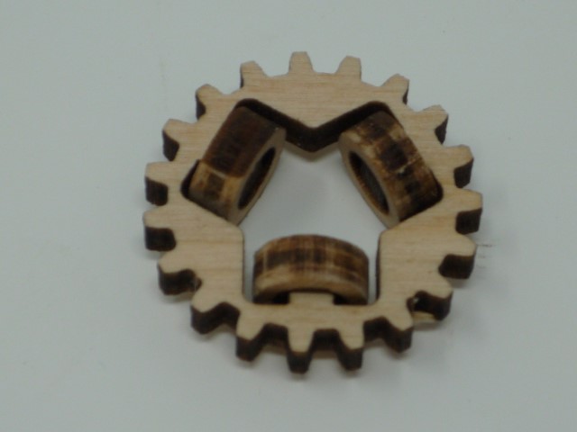

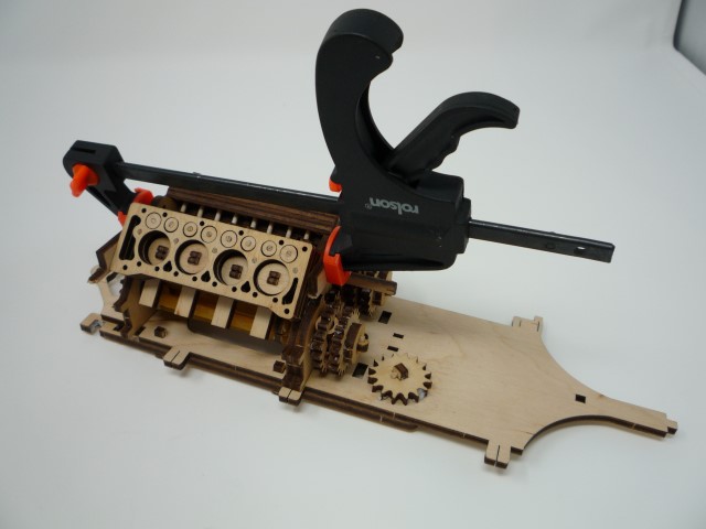

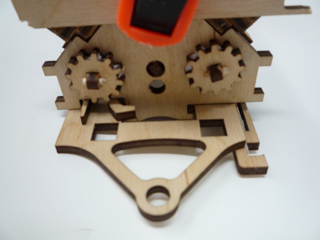

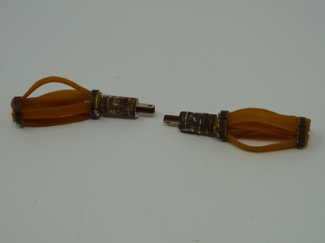

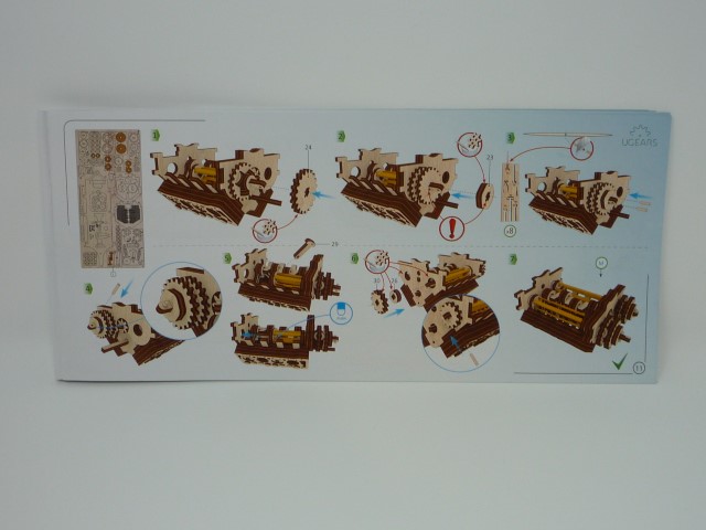

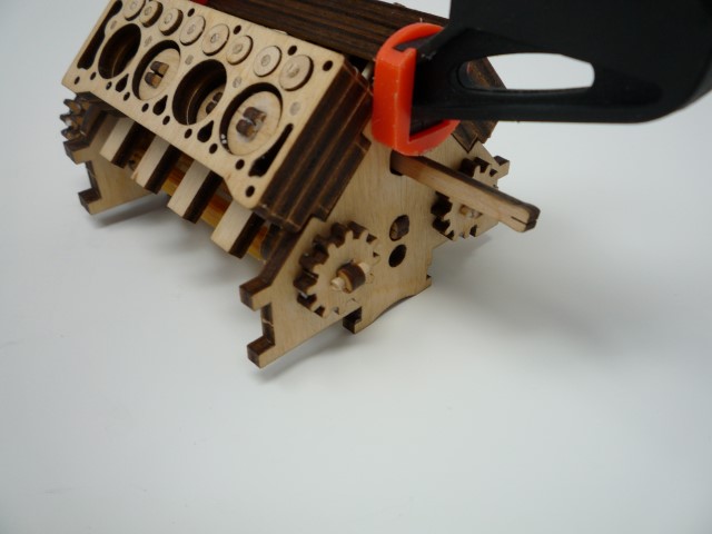

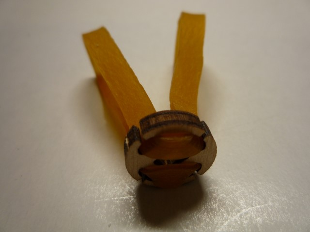

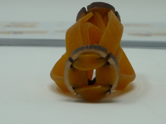

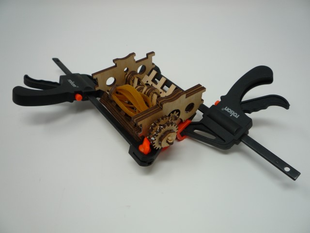

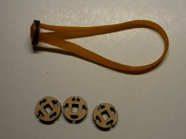

The next stage is setting the rubber bands into the engine. It's a convoluted process, but following the instructions is achievable. The end result is shown in the photo below.The next stage is to make up the planet wheels and pinions. Use plenty of wax on ANY moving part! The pinions are inserted int the correct end of the block, followed by the planet wheel, and another cog. The whole assembly is then held in place with 3 pins. I found it easier to clamp the ends of the block to stop the whole thing falling apart while trying to fit these bands! A second pinion, spacer & cog is then pinned through the other side of the block in the same manner. repeat the process for the other side.
This completes the rubber band installation. Two tips learnt? Firstly, use plenty of wax on the moving parts, and secondly clamp the engine (drawback of not using any glue, until it sits in the chassis it moves around alot!)

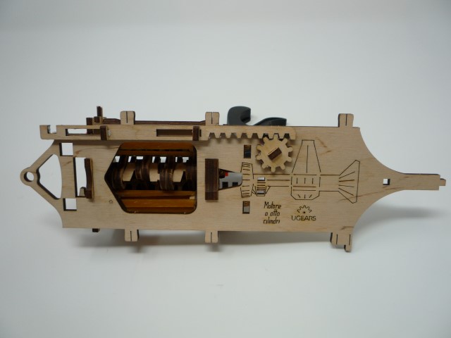

Ok guys, it's admission time Blushing . Whilst checking the engine, i noticed i had fitted the camshaft facing the wrong way!Cursing Now i must admit, there has been times when building this engine that i thought a bit of glue wouldn't go amiss!!!
However, due to the dry nature and interference fit of the component parts, i was sure glad no gluing was involved. Something i had viewed as a minor negative turned out to be a massive positive!
So, an hour later, engine dis-assembled, camshaft correctly fitted, and engine rebuilt. Result? 1 happy bunny BigGrin

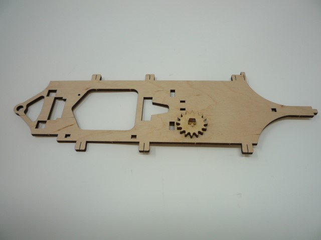

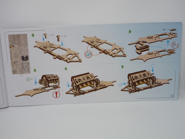

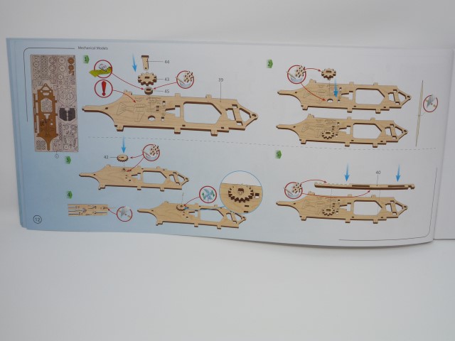

Next comes fitting the chassis and steering gear. This is actually what stiffens the whole engine build up and begins to tie everything together. This completes the engine and chassis installation.
