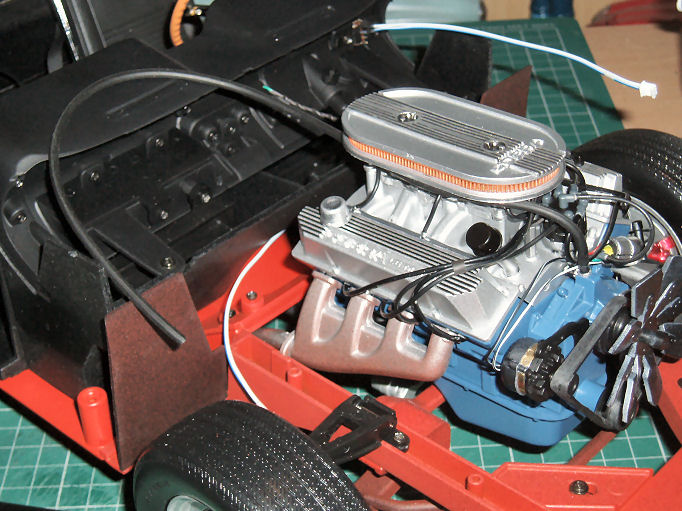

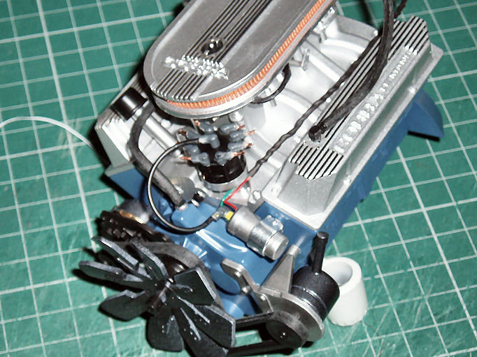

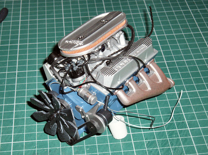

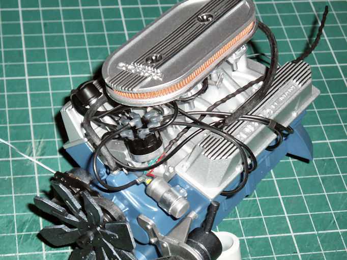

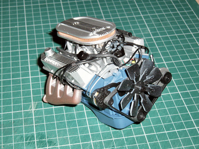

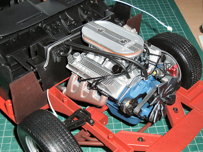

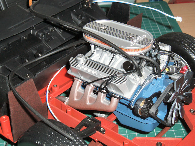

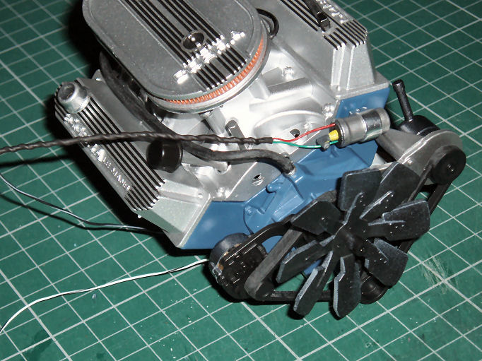

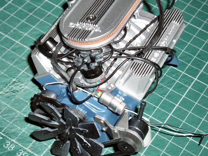

I'm doing more to the engine at present.

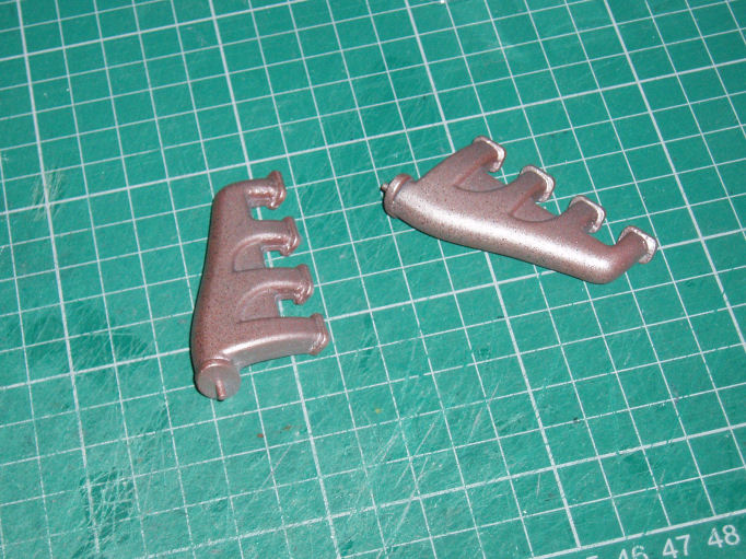

The manifolds have had the join seams filled and weld lines added around the engine flanges to fill the gaps there.
The manifolds have also been repainted with steel, light gold, red oxide and matt black - all to weather them down a tad.
The distributor and leads... Right...

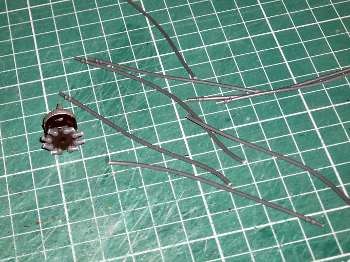

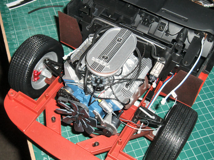

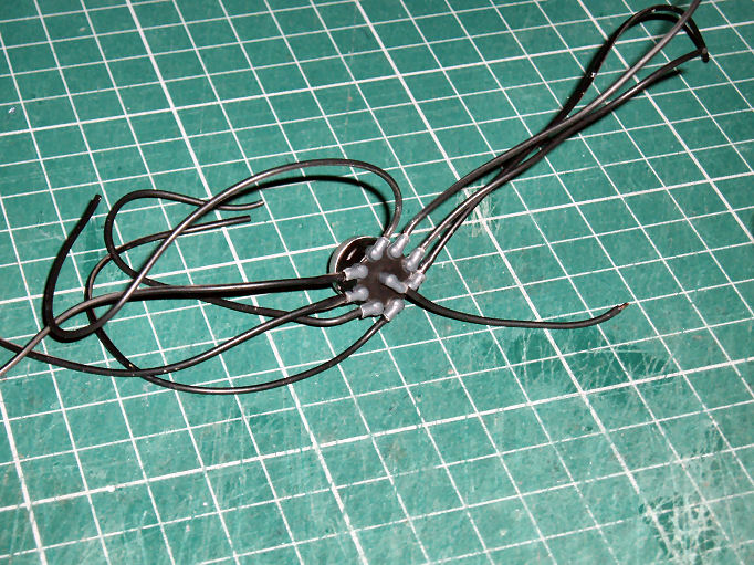

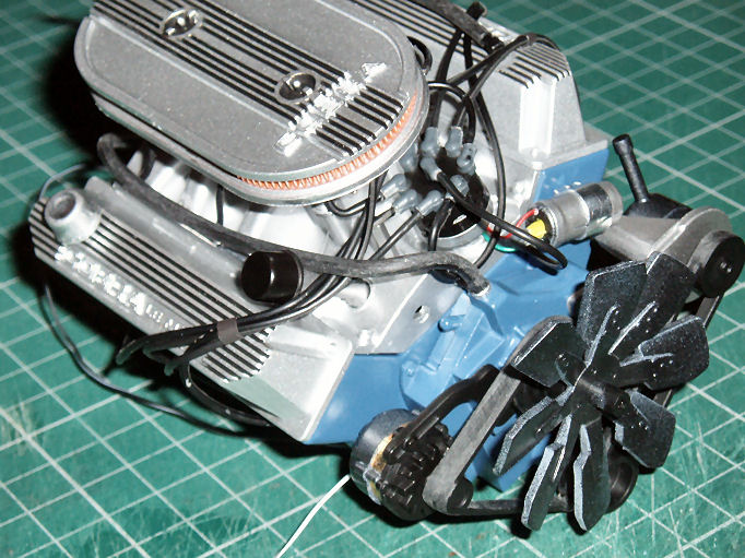

All leads cut off.
All plug boots cut off.
New leads using soft flexible wire, fitted by drilling into the lead boots on the dizzy cap and joining with small pieces of paper clip wire pushed into the holes and wires.

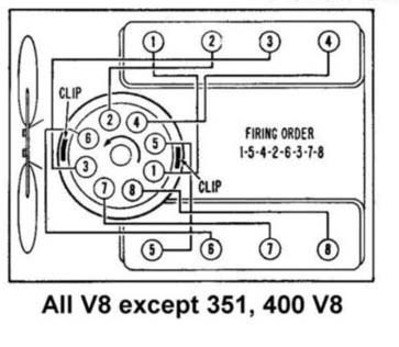

I used a Mustang firing sequence diagram - posted below - to make sure the wires go to the correct places. In the kit, they don't.
...and yes, two of my leads are crossed - they are to be sorted...
Low tension wires added to the coil and the coil and bracket repainted and foiled.
Lots more to come...
Roy.

Anyway, ignition timing order now sorted and the manifolds and sump are fitted.
I've realised there's no top to the oil filter so that will have to be scratched even though it's no doubt invisible at the end.
Roy.

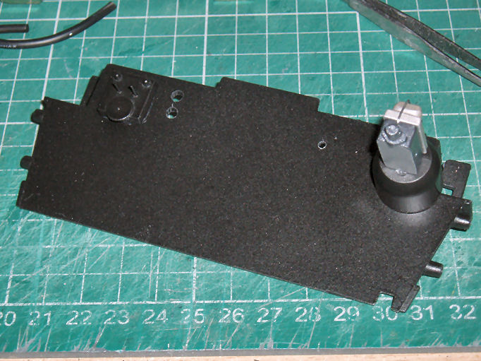

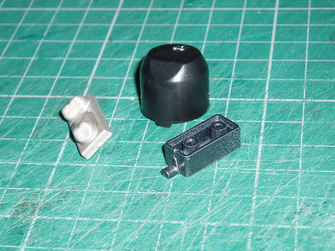

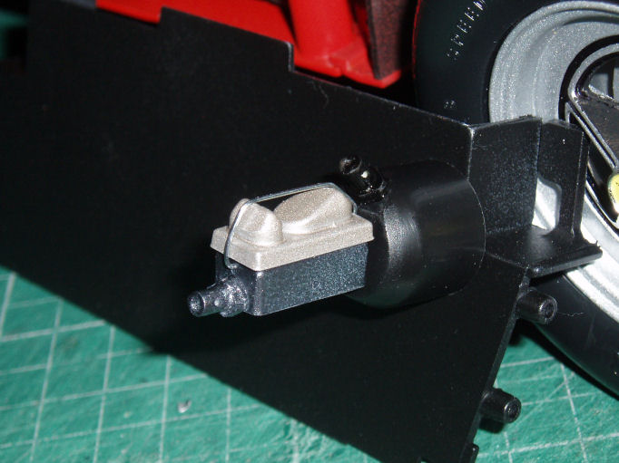

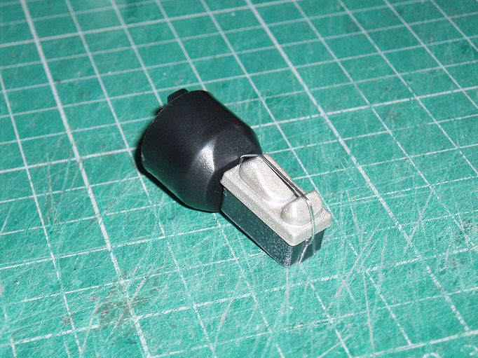

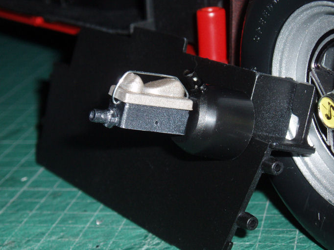

I've started work on the rear firewall in the engine bay.
The kit panel is actually completely the wrong shape but I'm going to leave it alone as it is hardly visible at the end.
However, the entire heater and air con system is missing from the kit and it amounts to some nice plumbing and wiring detail so I'm going to scratch make it and fit the parts.
Also, the brake master cylinder has been dismantled and repainted the correct dark grey metal and light gold.
I've also added the brake pipe fitting at the front of the unit and a vacuum hose connector to the reservoir for later pipe work.
Also, the spring clip has been made and added over the top.
On we go...
Roy.

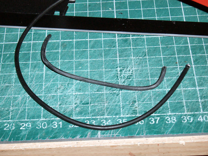

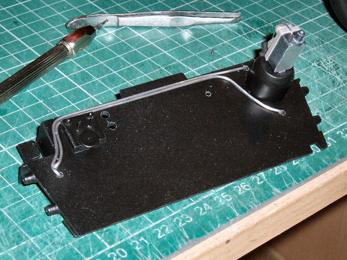

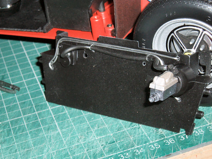

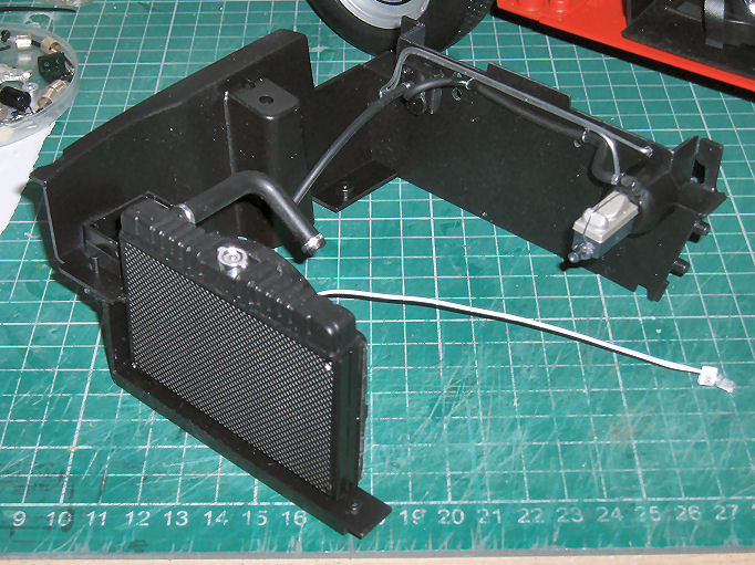

I've started to add some of the missing parts to the rear firewall.
One of the first things I noticed was the hose from the front of the engine block that goes to the clutch housing - it shouldn't.
It's totally wrong.
When you think about it, why would hot water be going into the clutch?
A google search of the actual heating system shows that the pipe should go through the firewall to connect to the heater matrix.
Kit pipe removed - new rubber hose fitted.
Also, there's another hose that should go from the front of the block near the oil filler, that also runs through the firewall.
This hose is missing from the model.
A mounting flange was cast and fitted, and the hose added.
Next, the vacuum system has a unit that should be on the firewall to the left.
This was scratch made and added.
A hose was connected between it and the brake vac tank and another hose will be added between the unit and manifold.
Two metal pipes were also fitted across the firewall - purpose not sure, but they should be there...
The pics show the firewall loosely in place to test clearances.
Relays and wiring need to be added to the side walls of the engine bay.
That will be next.
Roy.

The firewall has been fitted to one side panel but there's some wiring and relays to add before this assembly gets put into the car.
Roy.

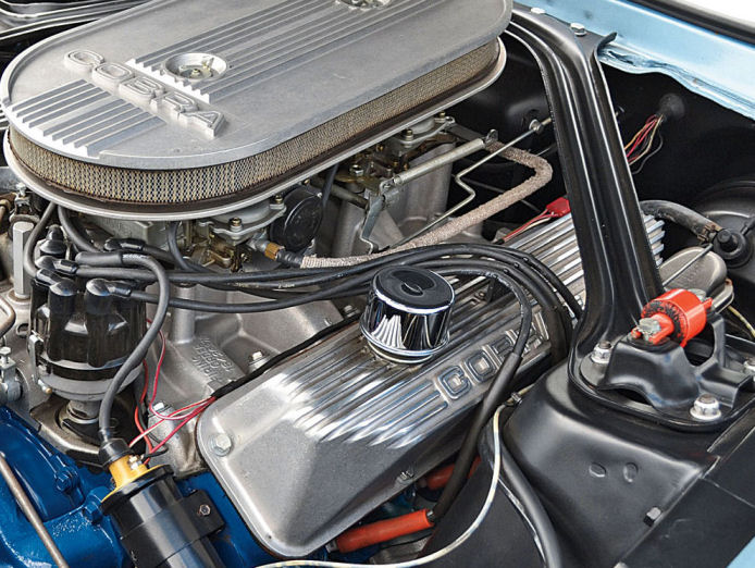

Roy, where do you get the coil wire feed at? I have looked everywhere and cannot find anything. Also, I see your plug wires too, AWESOME!!! What gauge wire did you use on your plug wires?
Any help is deeply appreciated,
Rich
#37 Posted : 13 January 2018 20:11:09
Posts: 5,058
Points: 15,320
Hello Rich.
Many thanks for your kind words.
My coil reference pic is below.
There should also be two wires for the radio suppressor going to the distributor but I didn't add those. (Have to stop somewhere)
My ignition leads are wires taken from cheap headphones from a 'Pound' shop.
I usually buy 5 sets at a time - enough thin wire for umpteen 1/8 scale models.
Other wires are stripped out from old computer cables, mobile phone charger leads etc...
Roy.
