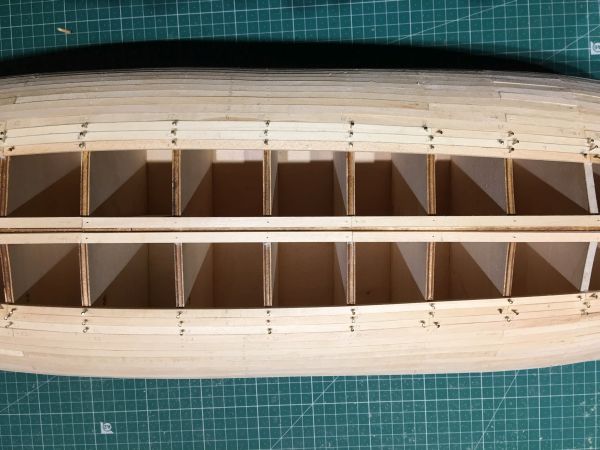

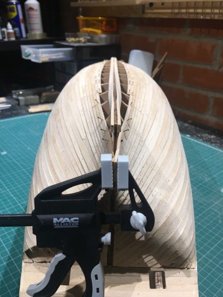

23/06/2017
ayer started yesterday now finished at stern, left it to dry overnight with weight to twist properly. Before the next step this layer need to be completed and dried anyway.
Happy building!

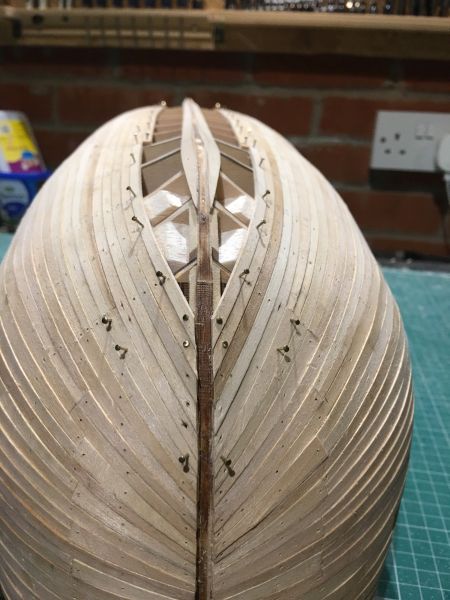

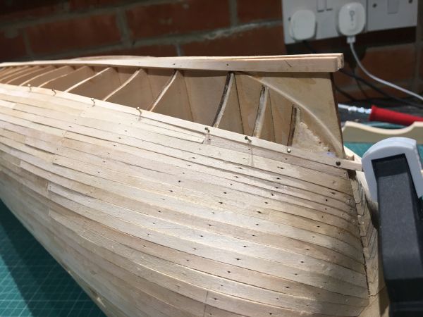

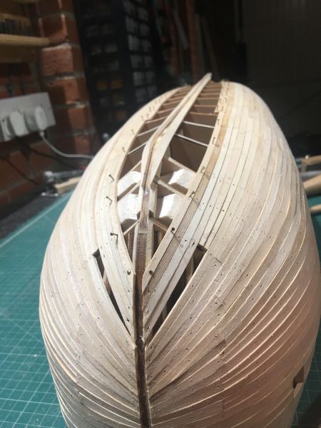

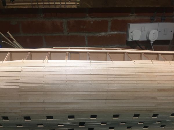

25/06/2017

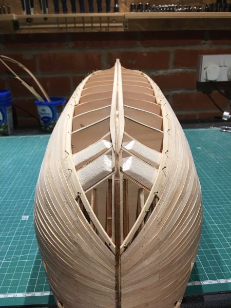

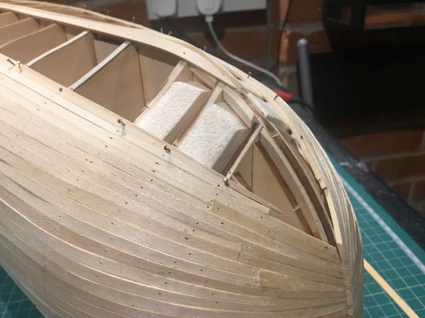

good progress today 😀 because the bottom of the hull requires different technique. Three complete rows fitted all around the hull.
So far the planks were bent (then wait to dry to shape) and then sanded to fit. But now because it's given that how many row have to fit into the gap they are sanded to size and then bent. Also this part doesn't require so big bends (hull becomes flat) hence soaking/bending also quicker, and the planks will dry after they glued/nailed into final position.
Countdown started: 7 rows left.
Happy building!

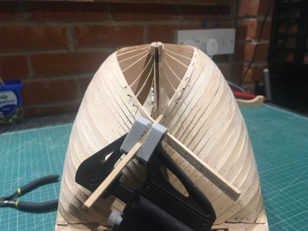

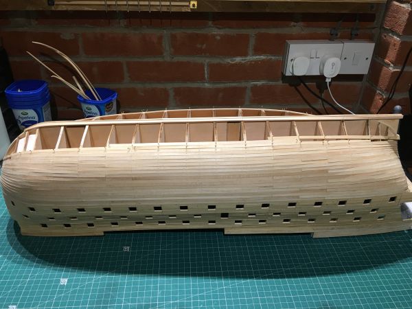

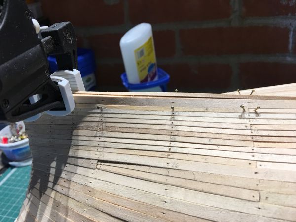

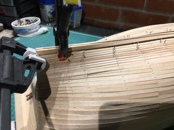

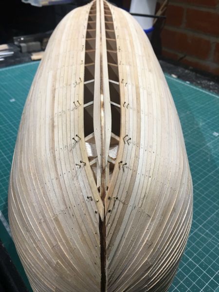

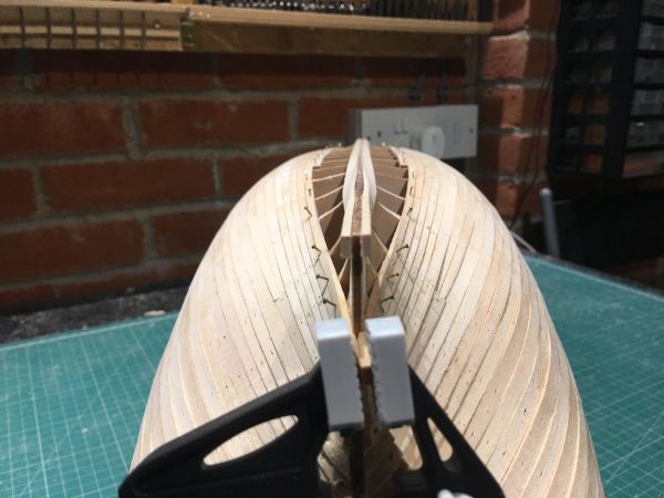

26/06/2017
one and a half row fitted... slowed down again due to into the thin section of the false keel at the stern no pins can be fitted to hold the planks in place to dry. Clamp placed to make sure the planks dry properly to the keel. This avoids to fit another row. Will continue tomorrow.

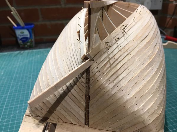

27/06/2017
repetative task done today... row started yesterday completed at bow & stern, new row started in the middle... 4 and a half to go. 🙂 also dropper fitted at bow... finally.

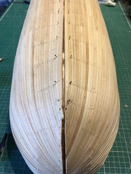

now I can see the finish line... well at least regarding the hull planking 😁. Completed the row from last time plus two more complete rows fitted... ONLY ONE LEFT!!! Yee-haa 😃😃😃

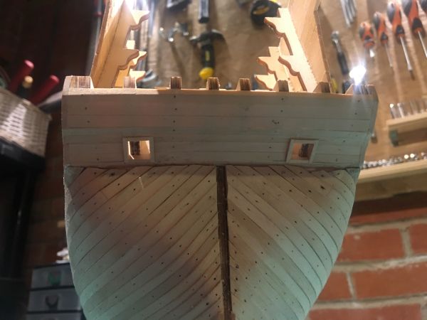

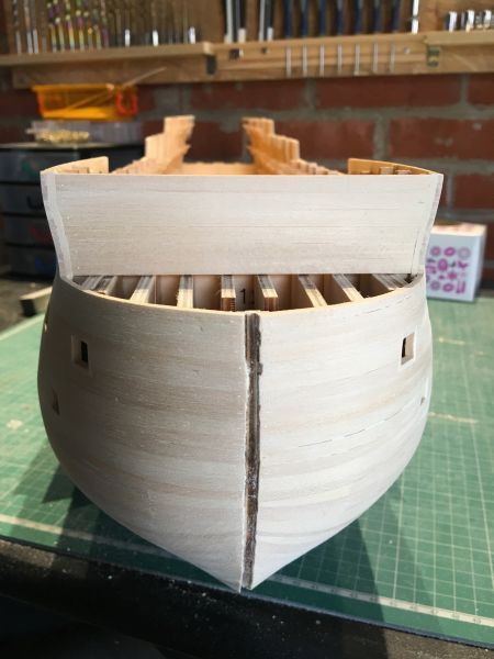

02/07/2017
YES, YES, YES... Mission accomplished... hull planking COMPLETED!!!
Happy building!

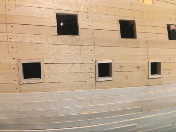

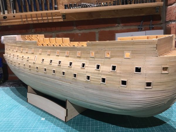

02/07/2017

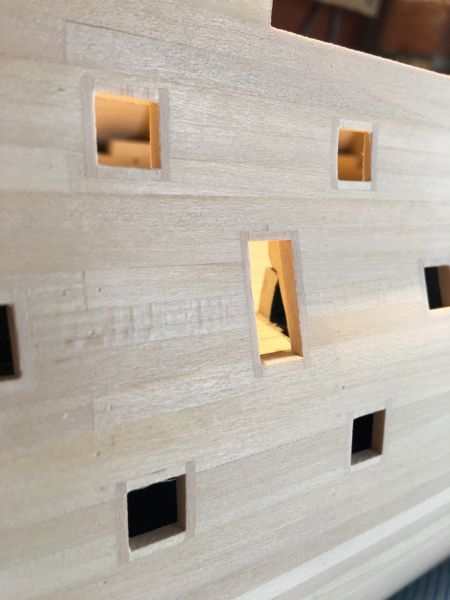

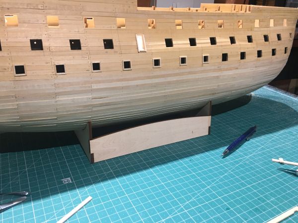

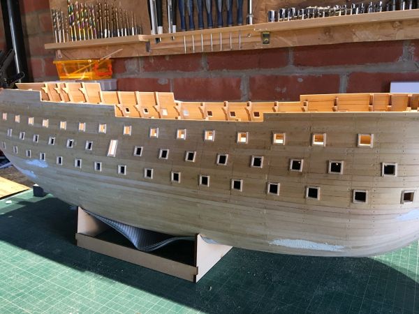

building stand made to hold the ship upright while working on it.

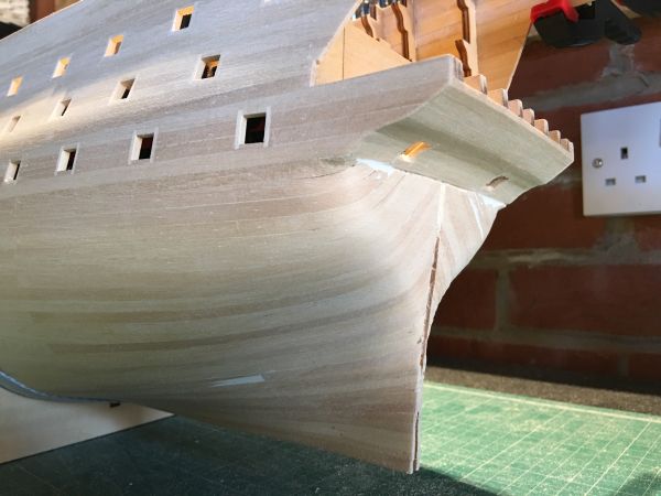

Before sanding the hull smooth all the gun ports need to be lined. There are 94 of them... 94!!! 😳😱 Plus the two entry ports.
The entry ports on both sides and 10 gun ports on one side lined. Also lining strips cut to size...
Happy building!

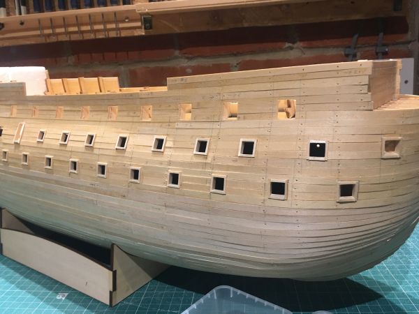

all the gun ports including the two underneath the gallery now completed with lining. 😊
Next task is to sanding the hull smooth... let's leave it for the weekend...

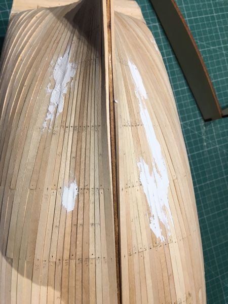

08/07/2017
small gaps and imperfections are filled with milliput. Now need to waitcouple of hours to dry and then will jump onto sanding the hull.
Happy building!

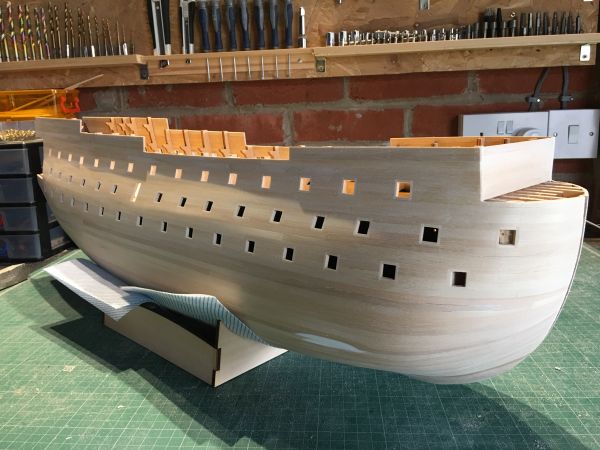

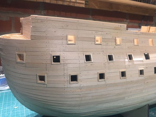

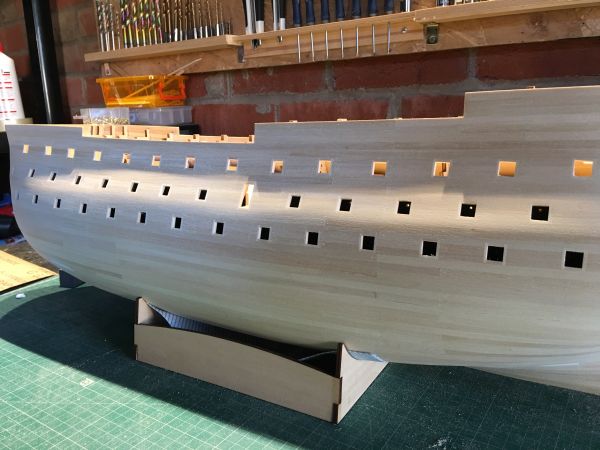

08/07/2017
Left side of the hull sanded smooth... pfffff... I had enough for today... my hands are in cramp... anyhow, to show the difference here is a picture from the right side and few from the sanded left side... 😊😊

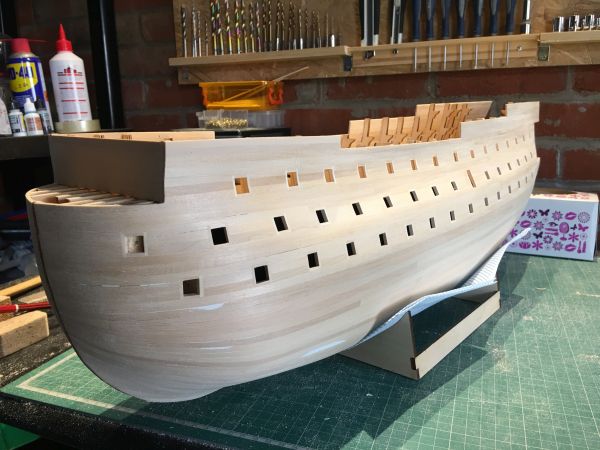

09/07/2017
After further five hours of sanding (five yesterday) the entire hull now smooth like a baby's butt... 😆
I had to hold the sand paper so long that my fingerprints disappeared. I can't unlock my phone only if I type the passcode... :D:D:D
Tomorrow the ship will be taken to my workplace to blow out the sawdust from the inside with an air gun 😳💨

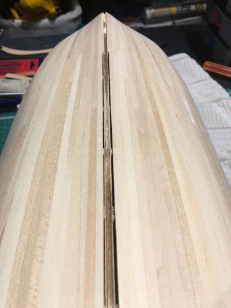

09/07/2017
started to cut/form the slot for the keel.
