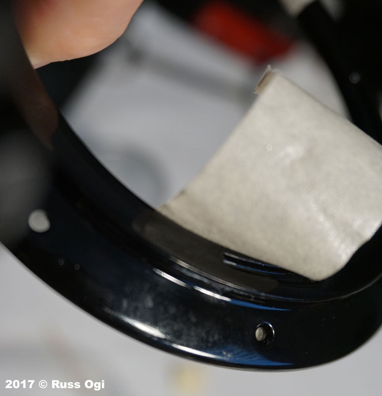

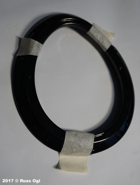

I attached the rings for the bottom of the hachi (helmet crown) using super glue. I let the rings air dry for at least a half hour and eventually taped the rings together and set them aside to all the glue to fully cure.
ZetaForge attached the following image(s):

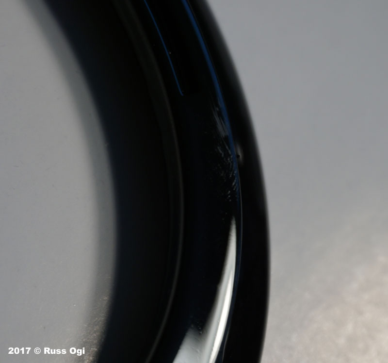

So continuing on. No fume marks on the rings of the hachi (helmet crown)...or so I thought. After taking off the tape holding the rings together, I noticed fume marks formed under the tape.
The fumes adhered to fingerprints I left on the parts. It looked a little like a forensic team had been looking for fingerprints at a crime scene. Blink
Lesson learned, I should have used clamps. I had some lying around too. Mad
I was able to remove the fume marks using acetone, specifically, nail polish remover. I did a test spot to see if the chemicals would damage the finish. The gloss black seems to be durable enough to survive the acetone.

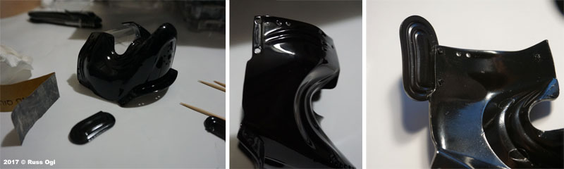

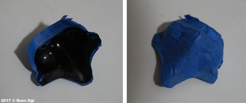

Continuing with my build, I super glued the posts for the kabuto tie and the hooks for the nose piece to the menpo (face mask). Followed the instructions and no surprises.
There is a bit of play once you hook the nose piece on to the menpo. I was worried about paint rub so I sprayed the inside of the nose piece with Plasti Dip to create a rubber buffer. The inside of the menpo is usually red. I may coat the inside with red Plasti Dip later.

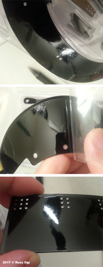

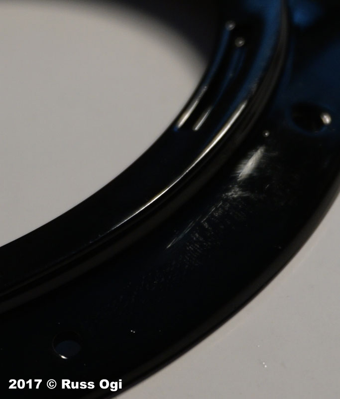

As I opened the different stages, I began to notice many of the pieces had noticeable blemishes. I contacted DeAgostini customer service who'll be replacing the parts.
Spent some time inspecting all the parts to see how many have blemishes. There are at least two rows of kusazuri (tassets) including a number of other parts. I've included pics of some of the parts.

I had several as well, including the ones in your pictures, plus the main breastplate. The smallest neckguard piece even had rust under the paint..that might have implications for storage longer term.

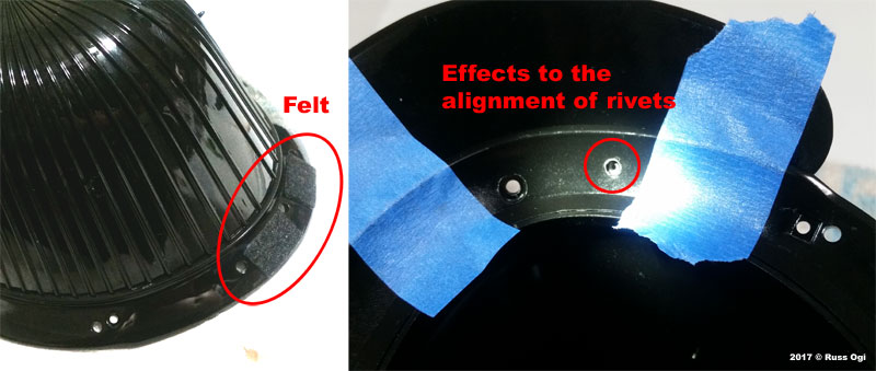

Back to the helmet. I attached the visor and maedate (crest) mount. The visor had a bit of play after being attached with just the rivets.
Initially, I had thought of using small pieces of felt to keep the visor from moving. The felt proved to be too thick and threw off the alignment of the rivets. In the end, I used a bit of epoxy to hold the visor in place.

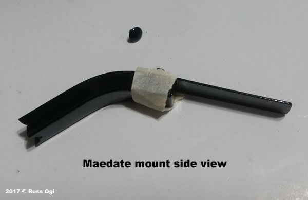

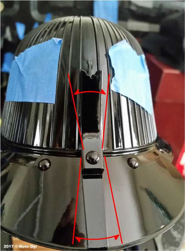

Getting the maedate mount centered and straight was a bit nerve-racking. Not only does the mount attach to the visor which is curved but the mount itself has an ā€œLā€ shape meaning it could be off center when looking at it from the front and from the top.
Compounding that, the maedate itself, the gold crescent, is wide. A small deviation at the center would translate to a much bigger deviation at either end of the crescent.
I wish there had been markings of some kind to aid with alignment.
I did several test fittings and, as per the instructions, used tape to mark the position of the maedate mount before attaching.
I checked the position of the maedate mount from several angles...many times before I finally committed to gluing it into place. I used epoxy and double checked the position of the mount as the epoxy cured.
