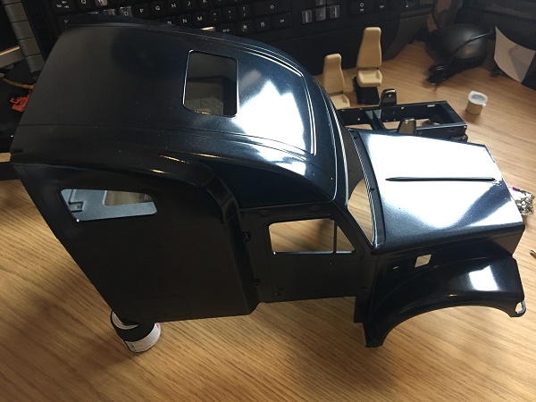

Got the cab painted don't look to bad saying its my first time spraying. I will get the seats and dash painted, the bash will be grey and i will do the seats tan. I will put some LEDs at the back of the dash to light up the panel and connect them to the mfu when i get it, the dash lights will come on when the head lights turn on.

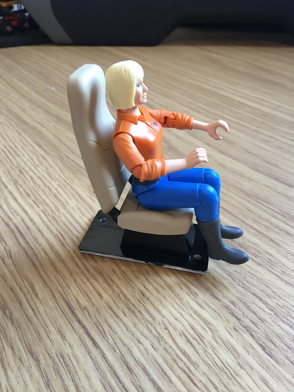

#24 Posted : 25 July 2017 19:48:31
Joined: 04/07/2016
Posts: 297
Points: 897

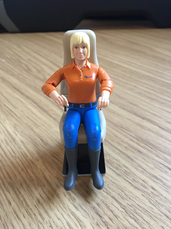

I have put the first coat of paint on the seat to see how it looks and i think i will go ahead with the colour. I have also picked up a bruder figure to go inside the truck.

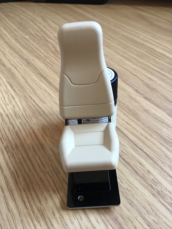

spike
#25 Posted : 25 July 2017 19:52:53
Joined: 04/07/2016
Posts: 297
Points: 897

Thanks arpurchase i have got tiny hairs under the paint and there making it look a mess. I need try and sort it out maybe sand down the areas and respray. I will get a spray booth built before i do any more spraying.

Like the colour Spike, and a nice Bruder figure as well.
Try wet sanding when you sand it then just build up very light coats

Thanks Spal, i didn't think the colour would of been that good as on the pictures it looks more black then blue. The glitter mixed with the blue stands out and after a clear coat goes on the glitter will shine.

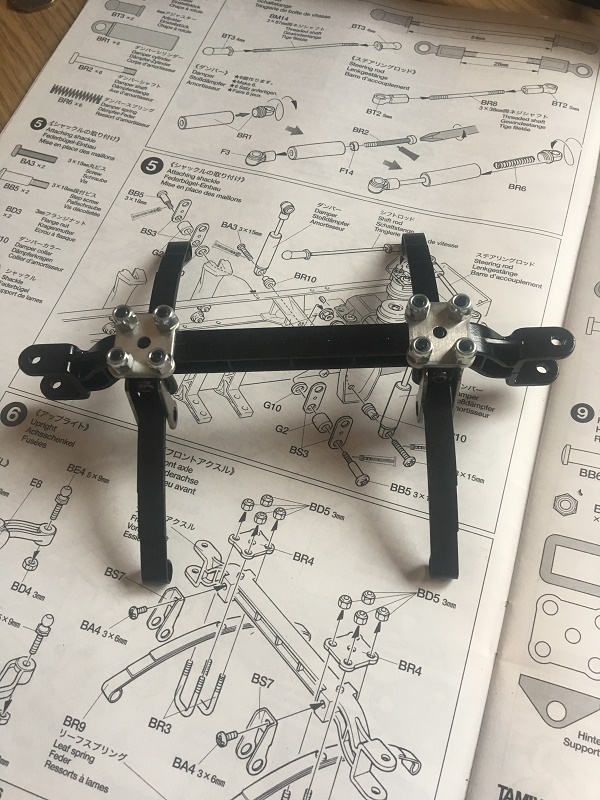

spike

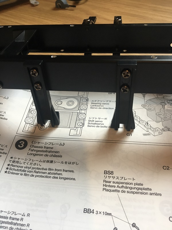

#30 Posted : 26 July 2017 00:06:41
Joined: 04/07/2016
Posts: 297
Points: 897

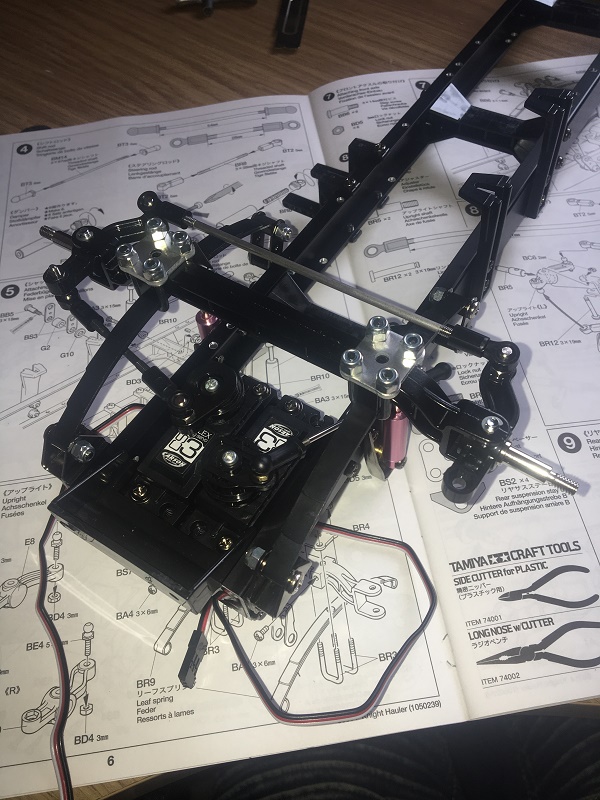

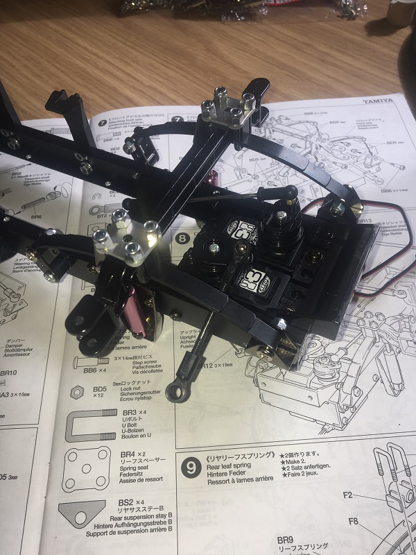

I will start the build and add the extras later on. The chassis has been put together apart from the servos and servo mounts.

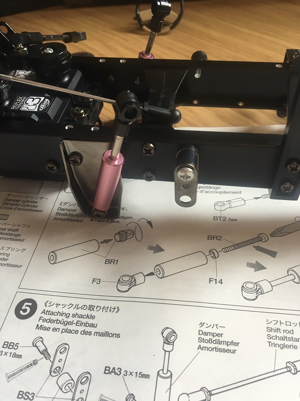

spike

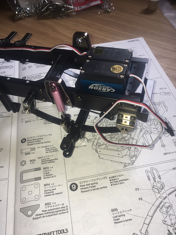

#31 Posted : 27 July 2017 17:03:19
Joined: 04/07/2016
Posts: 297
Points: 897

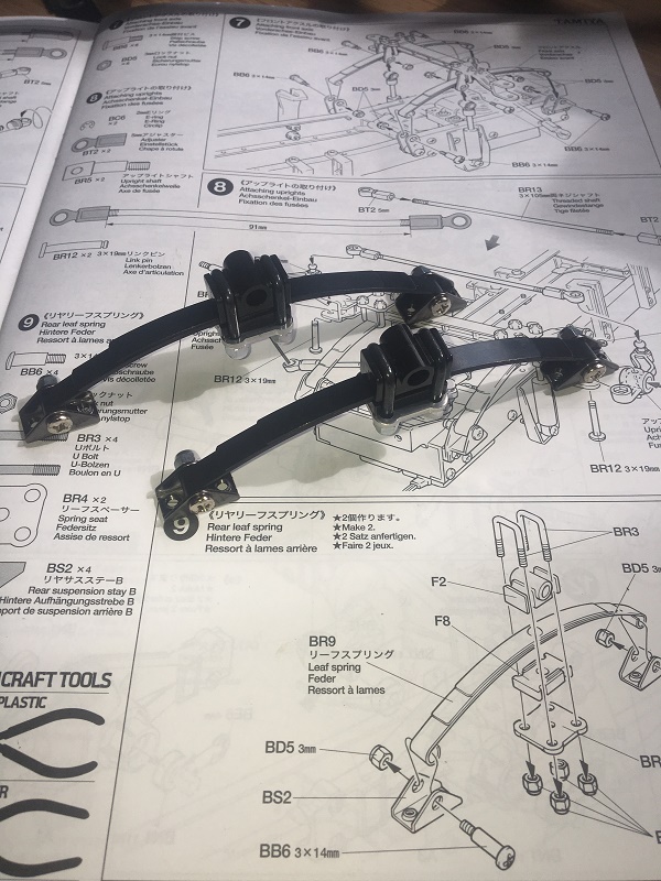

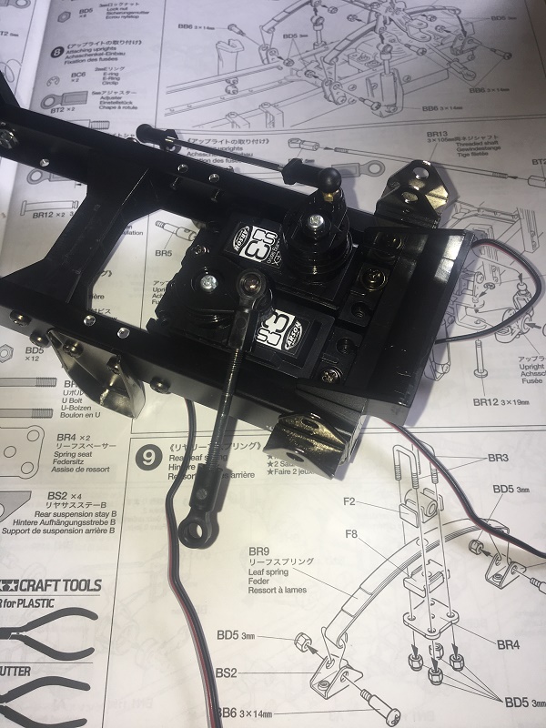

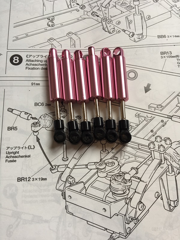

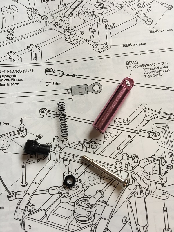

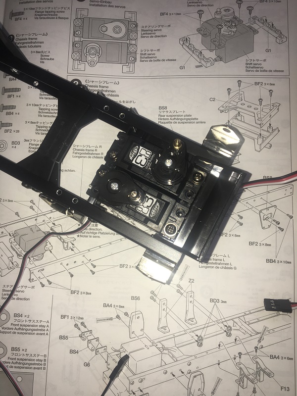

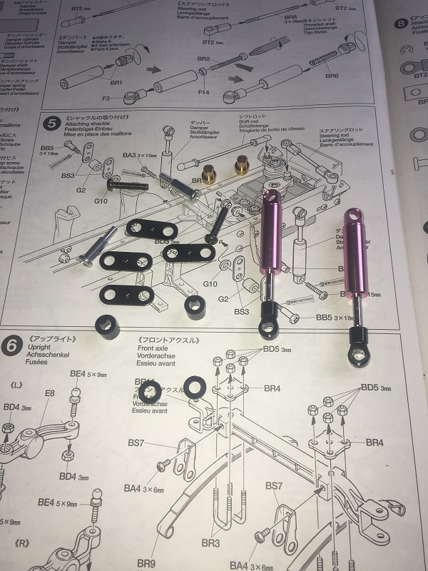

I got my RC pack this morning so i have added the servos. I have put the dampers together and fitted them to the chassis. All the leaf springs are fitted to the chassis. i will be upgrading the dampers later on.

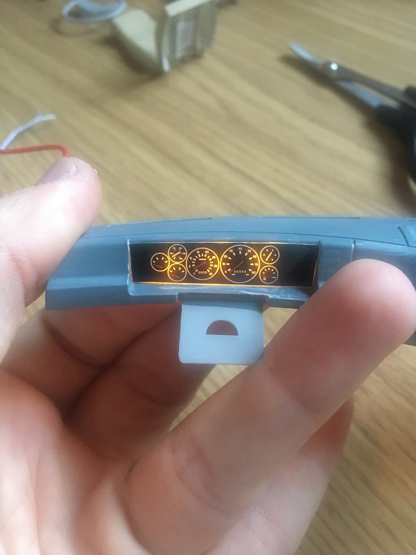

spike
#32 Posted : 27 July 2017 17:15:57
Joined: 04/07/2016
Posts: 297
Points: 897

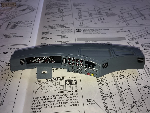

I put an LED strip light at the back of the dash to see how it looks. The dash has been painted and ready to go in the cab. I will sand the cab down and respray it.

#33 Posted : 27 July 2017 19:33:01
BigGrin Going together well and nice workCool
#34 Posted : 27 July 2017 19:43:58
Nice work Spike BigGrin like the lit up clocks.
spike

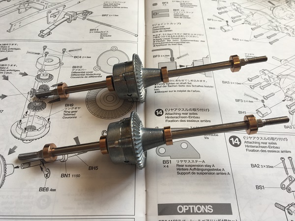

#37 Posted : 28 July 2017 10:09:19
Joined: 04/07/2016
Posts: 297
Points: 897

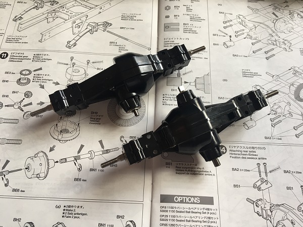

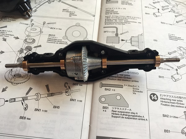

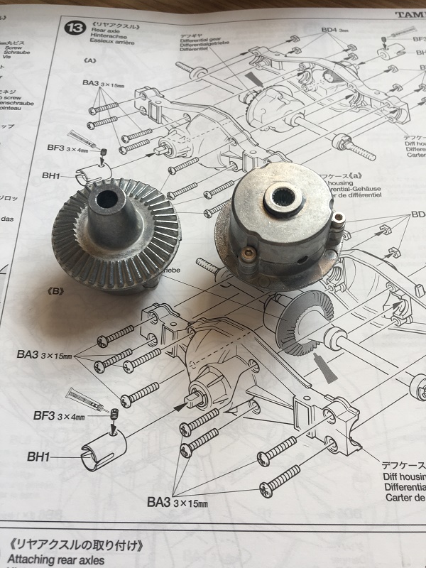

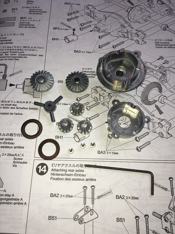

Fixing together the differential housings. The E rings are very tricky with them being so small.

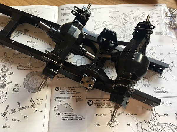

spike
#38 Posted : 28 July 2017 10:14:23
Joined: 04/07/2016
Posts: 297
Points: 897

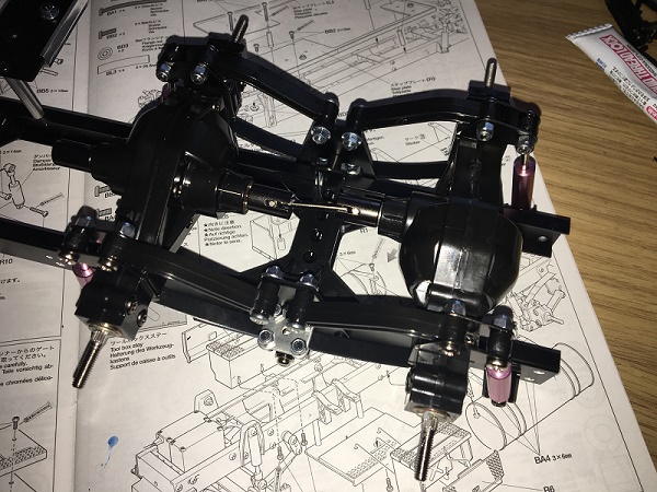

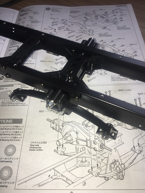

Next the back axles and dampers are fitted to the chassis.

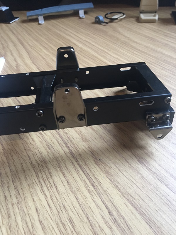

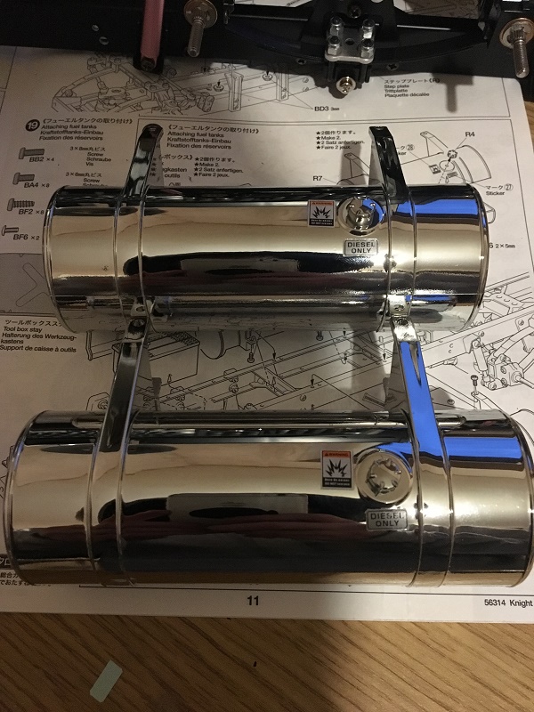

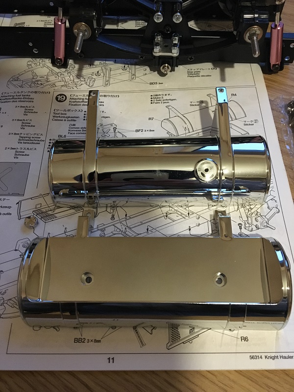

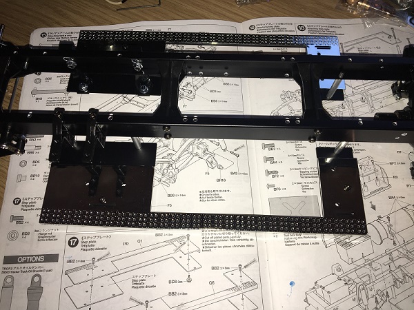

spike
#39 Posted : 28 July 2017 10:20:53
Joined: 04/07/2016
Posts: 297
Points: 897

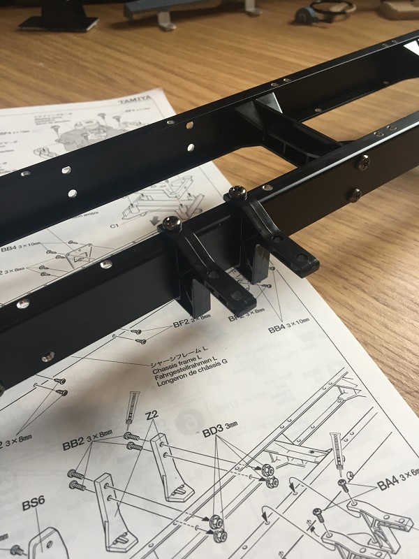

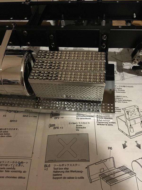

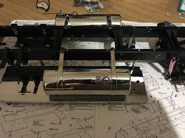

The step plates go on and connect to the chassis. The the fuel tanks and tool boxes are built and added to the step plate.

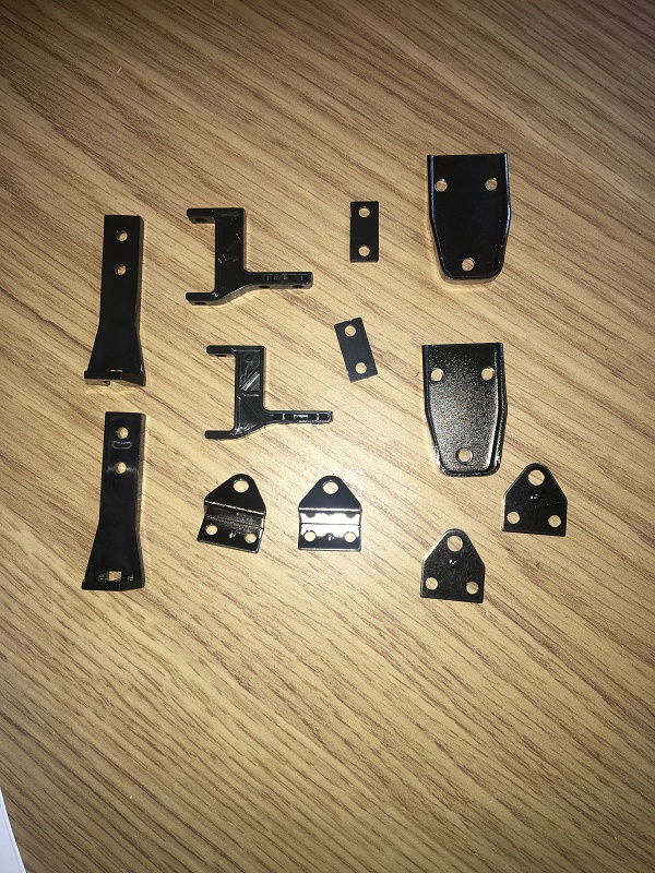

spike

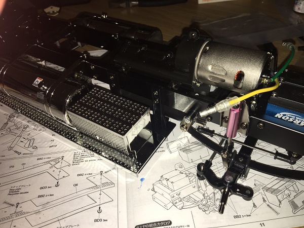

#40 Posted : 28 July 2017 10:27:32
Joined: 04/07/2016
Posts: 297
Points: 897

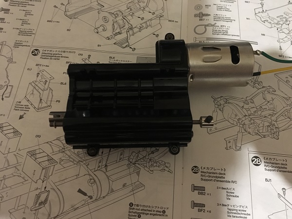

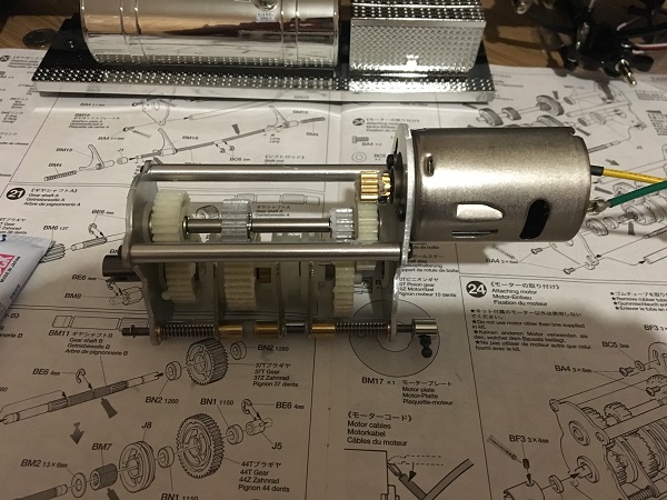

The gears and motor are put together and then placed into the gear box housing then added to the chassis with the propeller shaft.
