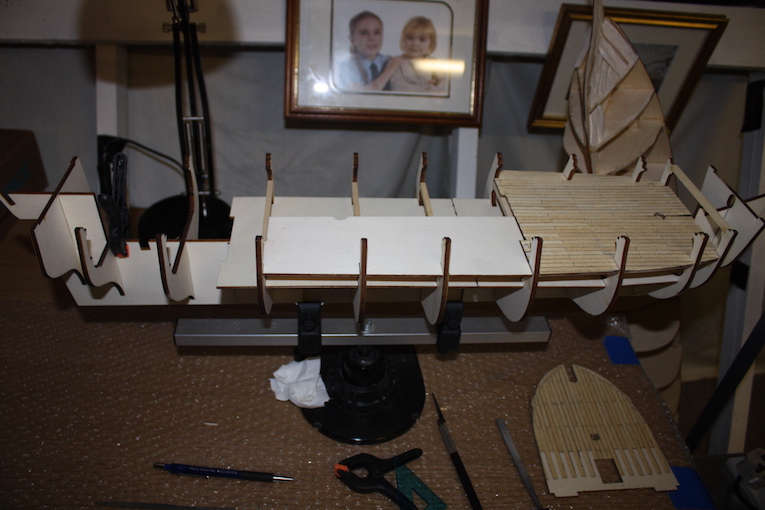

More progress from my first pack...
Planking of the first half of the lower gun deck has been completed with no real trauma. Occasionally I found the paper caulking starting to separate but once the plank is down it push back against the plank no problem.
Now before any body spots and feels they need to tell me, I know I have planked up the the joining edge, I have done this for speed really much of this deck won't be to visible and the joints in the planks should not stand out against the calking. Planks were trimmed off.
now one of the down sides of using the paper method is that you cannot sand the deck smooth. The fine paper dust gets into the grain of the strip wood, so I have scraped the decks with a razor blade. this removes any raised spots paper that may be sticking up and any glue that may have seeped out without being noticed.
I have decided to not stain my deck and will varnish it matt at some point to seal it.

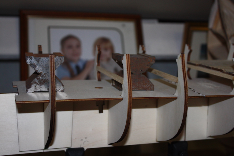

The first beam was cut to length as per the instructions, in fact I always cut them slightly longer than I marked them and then sand them to fit, experience has taught me that confidently cutting to where I marked off can result in it being a bit short Blushing The off cut from the first beam is the longest off cut from the beams and should be kept for later use. I used supper aliphatic glue for the beams.
You will notice from the pick above that my beam sits just under 0.5mm proud of the rib, I have sanded this beam top to level it.

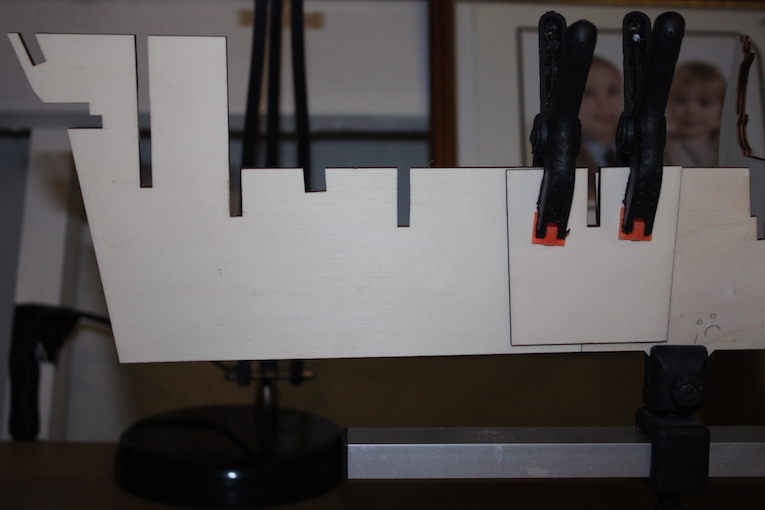

The lower false deck when in next, fitted into place like a pair of PVC hot pants! which is to say a snug perfect fit LOL LOL I used Super Aliphatic for this job too. Although it didn't look necisery I did weight the deck piece to ensure good contact.
With the next two beams fitted the beam on rib 5 requires a support piece. The instructions do not give a length for this, or I missed it Confused so I used the oft from the first beam for this job which looked about right to the instructions supplied. I marked the centre point of both the beam and off cut and glued and clamped it
At this point a further 1.5 hours had been spent on her.

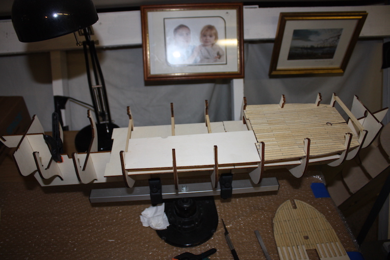

Before completing the other hand of the planking for the lower gun deck excitement about planking the upper deck got the better of meBigGrin So I intend to Joggle the planking on my HMS Warrior and wanted to have a practice run on Conny. So bear with me this is my first attempt, its not perfect but learnt a lot and certainly dose not look to bad...
First task is to mark out the centre point then the two butt lines as per the instructions, I found it neciserry to add a third once I started planking to understand the termination points for planks that will over run into the next sections of false deck, I would recommend doing this at the start.
Joggling got started by putting in margin planks. these are typically wider than a standard deck plank. I didn't want them to be longer than the deck planks to keep a sense of scale. so once I was happy with the position for the first and had cut it to length I used it as a template for the other side. A second strips butted up behind the first planks without adding calking to make it look like one wider plank. I continued to add margin planks until I got to the point that a standard plank width would work, effectively at the end of the curve.
First planks going down are at the centre and terminate at the gap for the bowsprit and so don't need joggling. Its worth noting that the gap for the bowsprit appears to be exactly the width of two planks. some of my off cuts from the gun deck came in handy for the sections around the grating aperture (never throw anything away, you just never know)
Having read around the subject the plank should be cut no narrower than 1/3 of its Total width, so plumbed with 2mm. the shoulder can vary depending on the depth of the curve. My first two planks had a 3mm long shoulder I then went to 4mm for the next 5 and changed it as required. I am sure there is some clever calculation to work out the right depth of shoulder to get a perfect drop and even cut but I went with winging it Flapper I used a spare strip to cut the first shoulders at each depth change and these have been kept as templates for the other side.
the template is used to mark out the cut needed into the margin plank. This was then cut out, caulked with a soft pencil and the first strip fitted.
I cut out the plank that lay across the mast opening as I find this easier than trying to do it when totally planked over. Planking continued steadily until I had to stop and make tea. Sunday modelling session done
build time for the deck joggling thus far 4.5 hours
Total build Time 8.5 Hours.

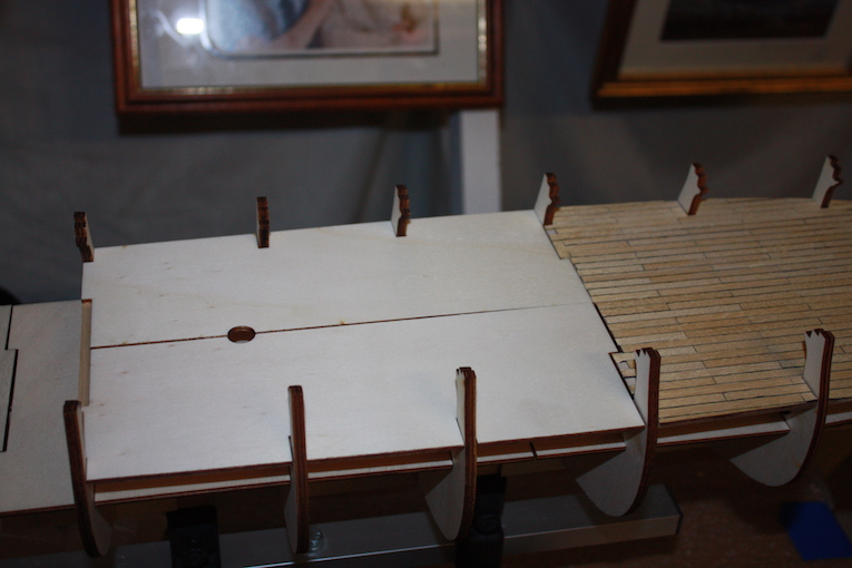

Bit behind plan due to the work are re-work etc etc but some pics below of progress.
No deviation from the instructions other than I am laying decks the full length before continuing the planking, just personal preference
