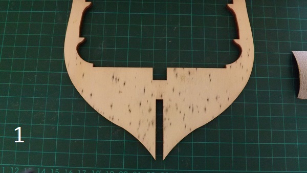

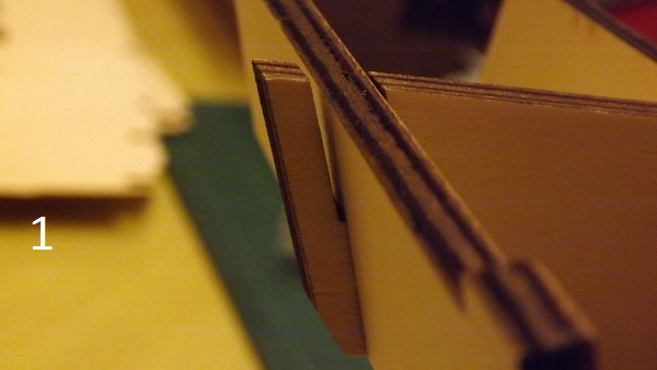

PICTURE 1
Might have been better if I had labelled this as Picture 5 as it actually represents the final correction to Rib 3.

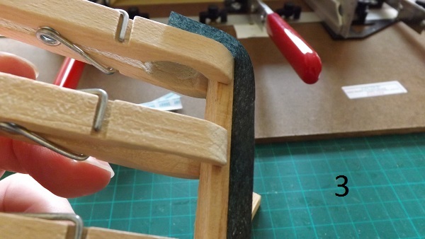

When I received my parts my Rib 3 was warped almost “in half”. I did phone in to request a replacement part but as that was never processed I pressed on to correct the issue myself.
The fits task was to soak the part in water and then it was placed between two very heavy granite chopping boards that I keep specially for issues such as this.
To try and get the part dried quickly it was sandwiched between some paper and that “measles” effect you see on the part is the result of the wood taking on the pattern from the paper.

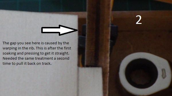

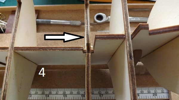

PICTURE 2 & 3 & 4
Unfortunately trying to get this part straightened out took more than one attempt at soaking and clamping. As you can see in these 3 pictures it’s still slightly out of shape.
In the end I did get it to flatten out as you will have seen in picture 1.

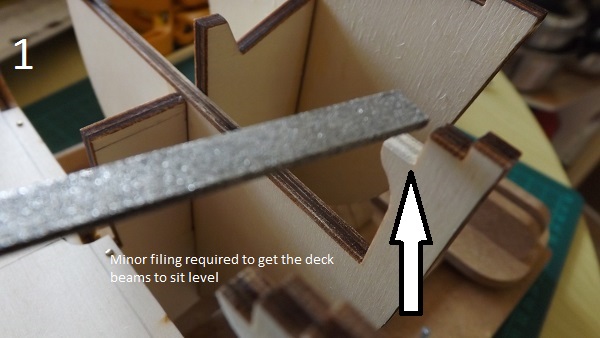

Having test fitted the supplied deck support parts I found in a couple of instances the supplied wood sat just a fraction to high on the rib knee. No major issues as it just needed a quick run over the rib knee with a file and everything was then nice and level.

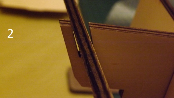

Follow the build instructions closely as a couple of the deck supports need these additional small supports added so that the preceding deck overlay gets support at this point.
PICTURE 4

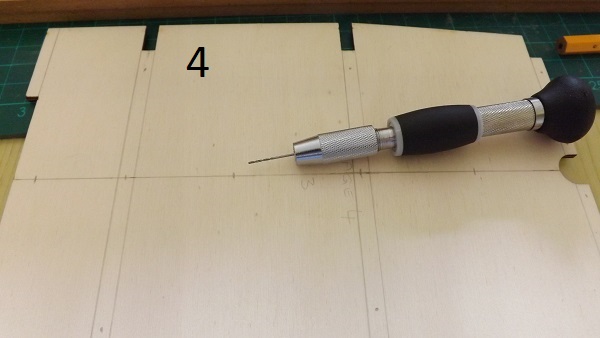

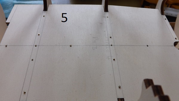

To ensure good contact between glue, deck beam and deck I decided to pin the deck pieces in place.
So no undue force was needed getting the pins through the deck these were pre-drilled using a pin vice.

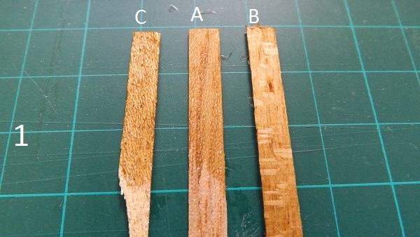

I had wondered what a change to the deck planking wood might look like.
I have used Maple in the past so I took some of the kit supplied wood (A), MAPLE (B) and some LIME (C) and tried out my choice of stain to see what each looked like.
In this case the MAPLE was discounted straight away as it had this time around a grain that resisted the stain.
The kit supplied wood is absolutely fine but I am an awkward person so never happy with anything 😊.

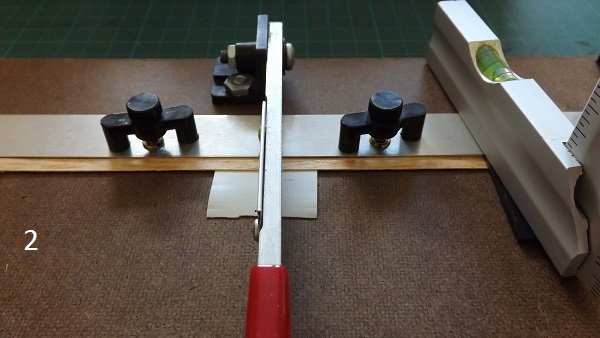

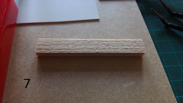

PICTURE 2 & 3 & 4 & 5
I set up my cutter for the 65mm length of the planks as per the instructions.

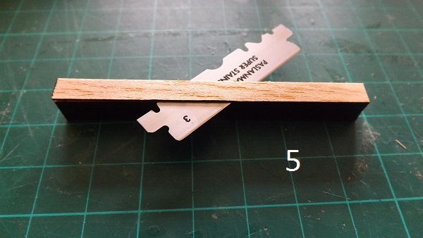

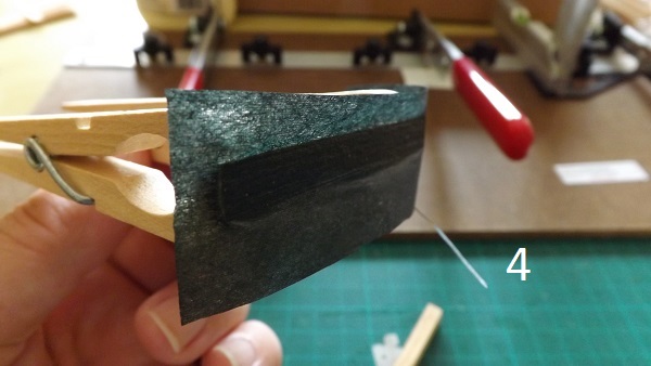

15 are then clamped up in some clamps and along one side and one short I glued tissue paper which tends to be the way I do my caulking effect.
When dry the tissue paper is trimmed and then each plank is separated using a single edge razor blade.

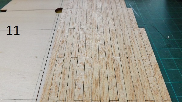

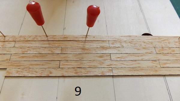

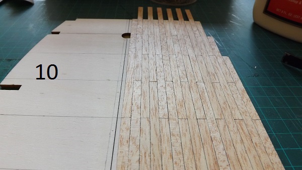

PICTURE 9 & 10 & 11 & 12

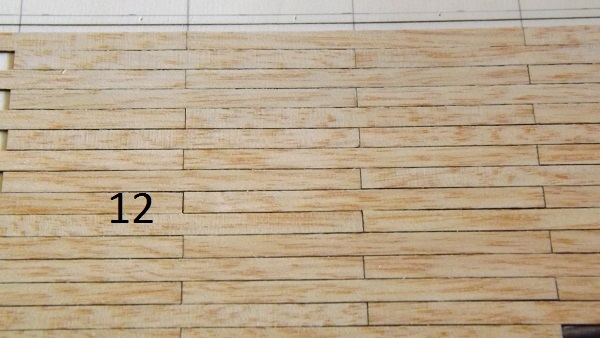

Well this was ATTEMPT 1 at my middle deck planking.
When complete I was not happy with it. For one the colour did not come out as I had expected although again there is nothing wrong in the grand scheme of things with what is supplied in the kit but I wanted to achieve a slightly different result.
The other issue I found was that just planking this forward section of deck and leaving the “fingered” effect were you then carry on the planking in the next section of the build I found that the next set of planks just did not look right when I started on them.
I guess this might be down to the fact that there were miniscule difference in the widths of some of the planks and it was that which caused me some issues.

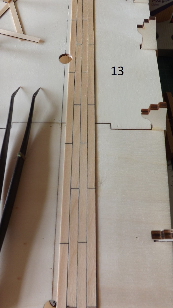

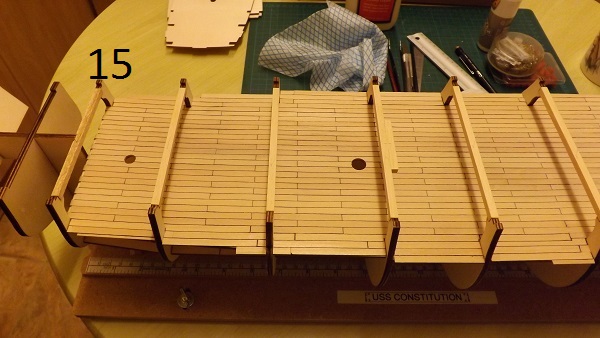

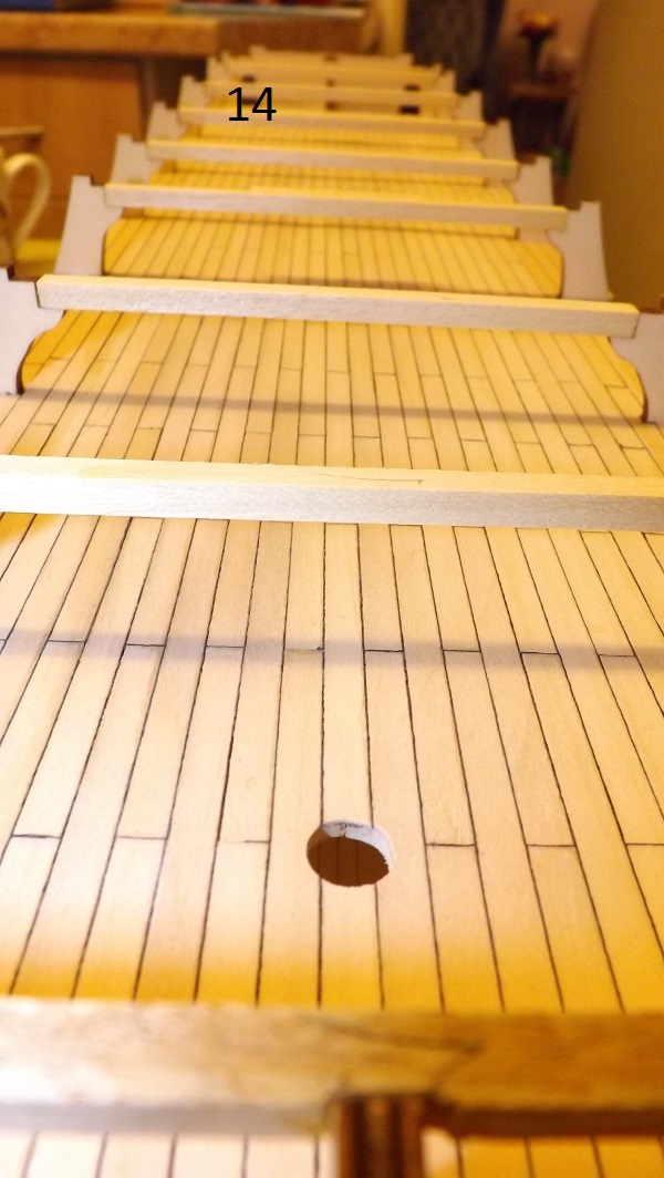

PICTURE 13 & 14 & 15
So, having scrapped of the previously applied decking it was time to start again.
This time I decided to change to my preferred Lime wood strip for the planks and also to plank the full length of the deck rather than in sections.
This went a whole lot better for me and I managed to get a much more uniform look to the deck.
Picture 15 shows the deck before I have trimmed the overhanging planks back to match the underlays they are glued onto.

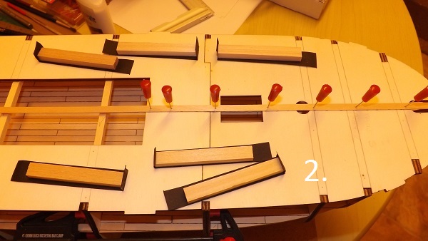

To ensure good contact between deck beams and deck overlays with the glue I have again pinned the deck pieces in place.
In this instance these pins will be removed before the top deck planking takes place.

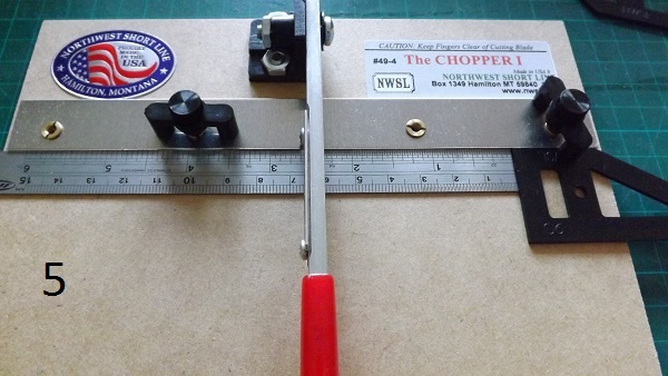

I have set up the cutter to produce deck planking of 65mm as per the instructions.

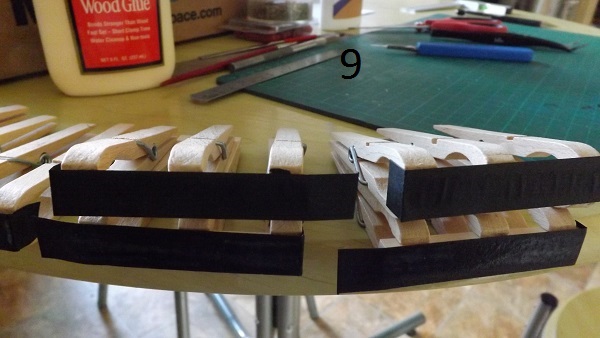

And here we can see the piles of planks with the black paper applied.
Time to allow the glue to dry now and then I can move onto the next section of planking the top deck.

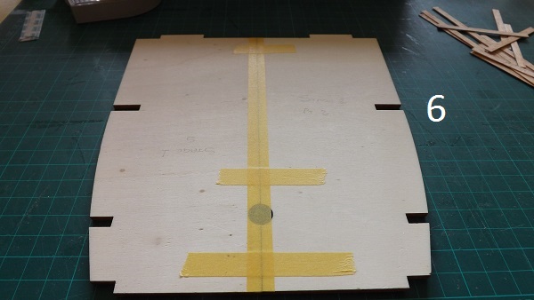

PICTURE 1

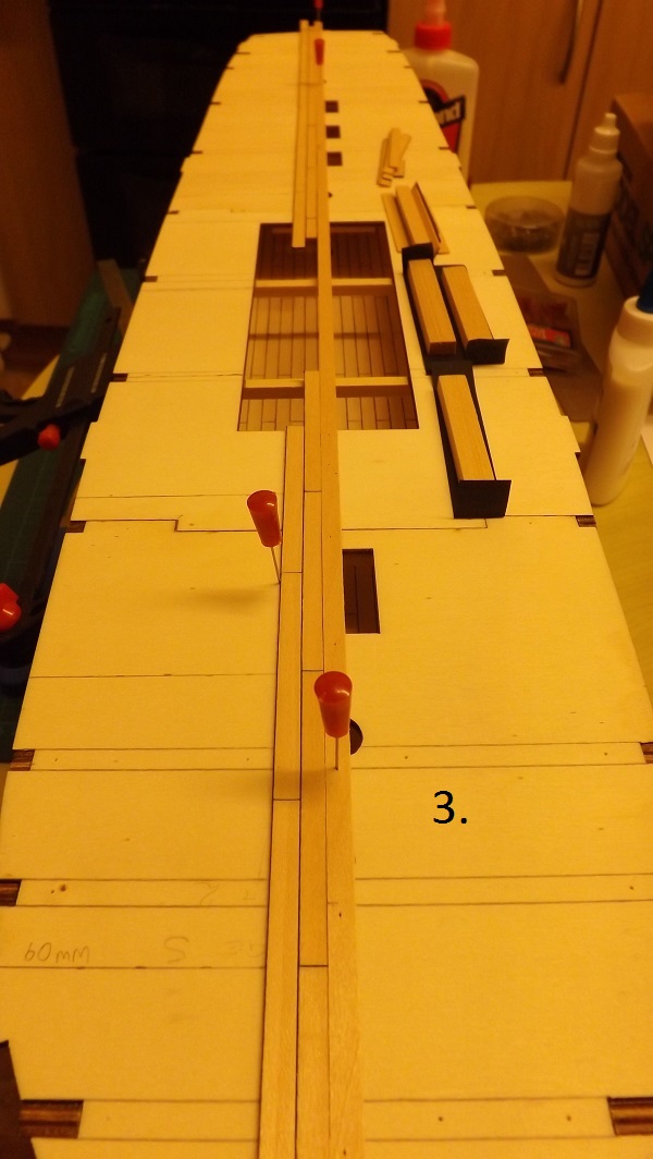

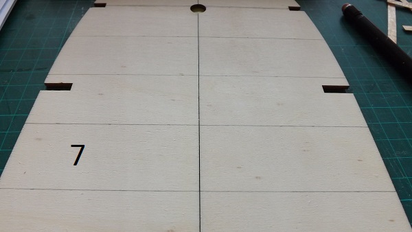

The first thing I did was to draw a centre line across the deck (Stem to stern) and then extend the width of this centre line to give me a centred 5mm wide line.
PICTURE 2

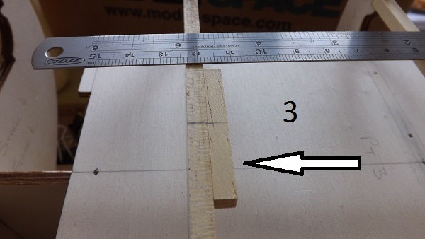

Then using a scrap full length 5mm batten this is pinned to the decking to act as a straight edge against which to start the planking.

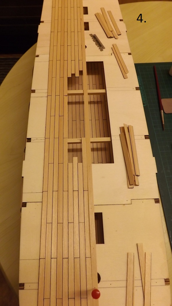

PICTURE 3, 4 & 5

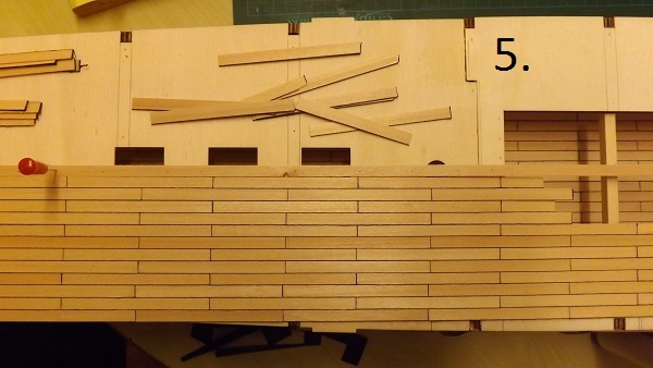

The planking lengths are again the same as the middle deck with each piece being 65mm long.
Not really must to explain in this section other than its a case of work steady and try to ensure the planking lines remain as parallel as you possible can.
This part of the build is something that will be on full show so I have tried to get as even and neat a finish as I possibly can.
Picture 5 shows that half of the deck has now almost been completed and what I will do once this has had time to dry is trim back all of the overhangs that have gone across hatches and mast holes, before moving onto the other half of the deck.

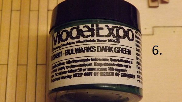

While I am still a long way from applying paint, I have been looking at what would suit the colour scheme and looking ahead in the instructions it is very much a personal choice as no actual paint brands or reference numbers are given.
Model Expo based in the USA sell a paint set for their own version of the USS Constitution. They list their paint range as “Historically accurate colours that have been specially formulated for wooden models”.
So as there were some other items I wanted to order it made sense to add some of the colours from the Constitution paint set and in these 2 pictures you can see what they supply as “Bulwarks Green”.
