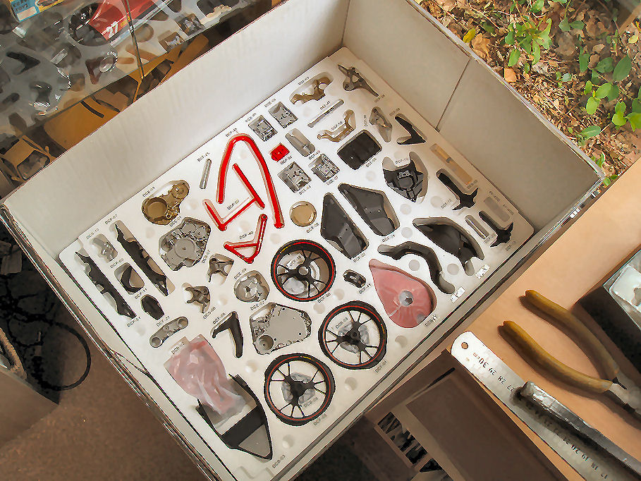

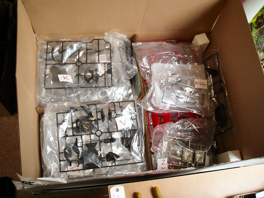

Labels now added to some of the parts bags...
#22 Posted : 22 April 2017 12:05:18
Posts: 5,062
Points: 15,332
Flippin 'eck.
MORE bits!

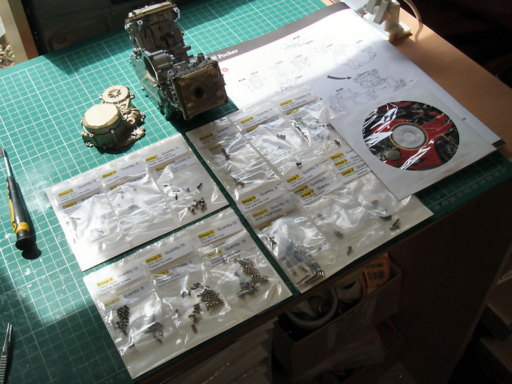

The Koo dvd is a great help with this build and the hardware pack makes a big difference over the standard fasteners. I'm presently retrofitting it to mine.
Looking forward to seeing yours come together Roy.

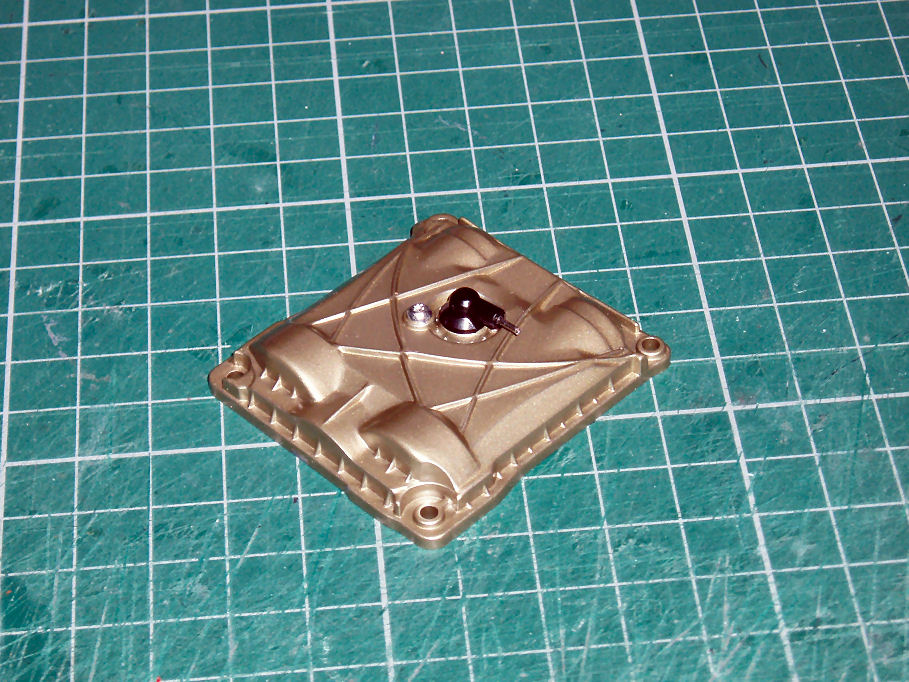

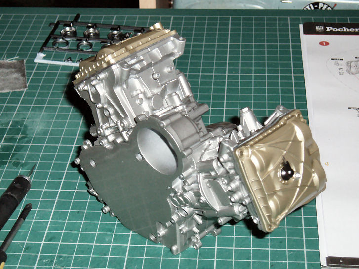

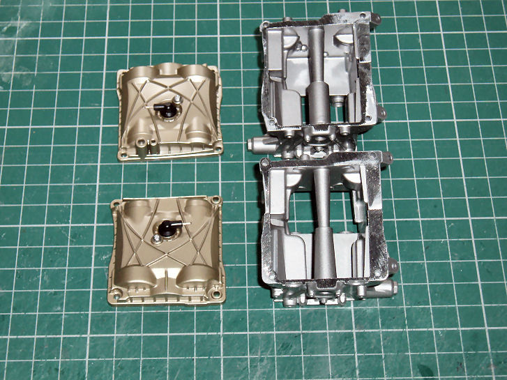

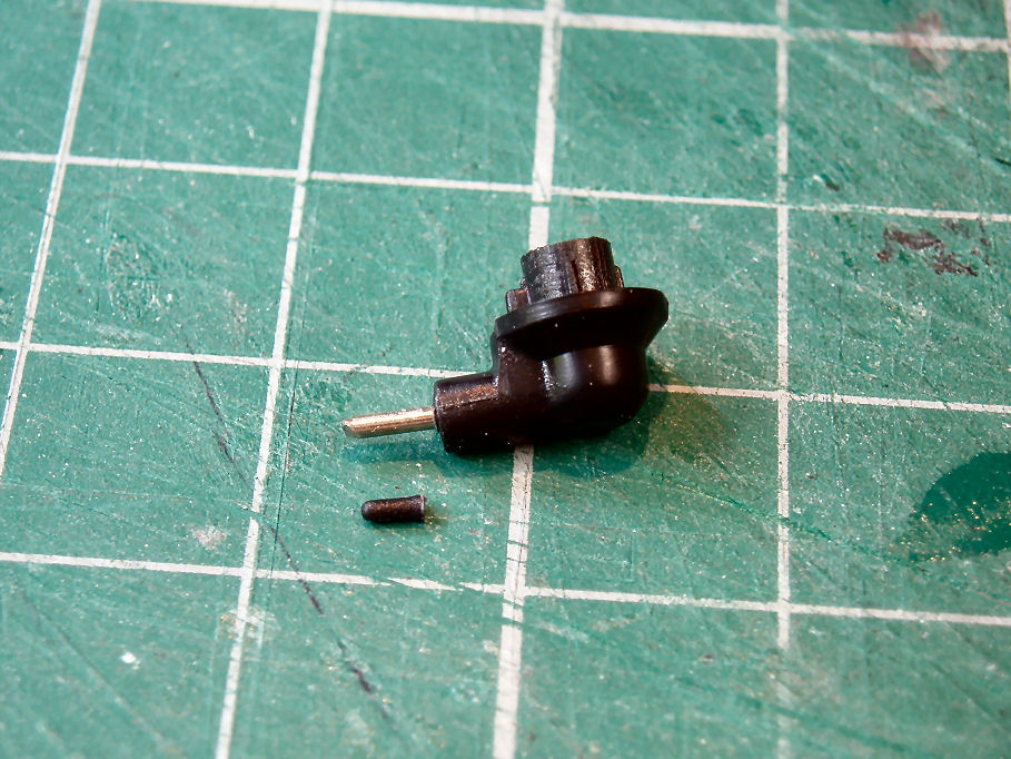

#27 Posted : 23 April 2017 12:01:47
Posts: 5,062
Points: 15,332

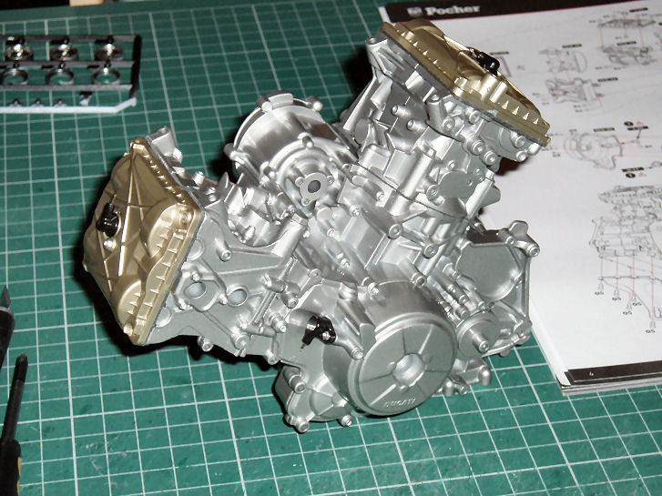

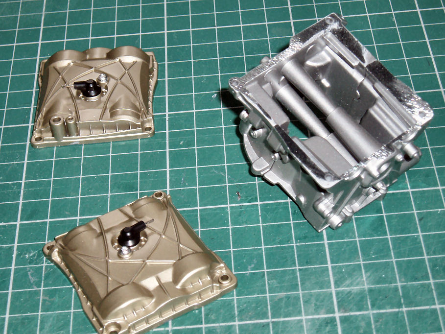

Well, a tiny start as there isn't really much I can do until the hardware set arrives. I can't see much point in assembling lots of bits only to take them all apart again when the new fittings turn up.
However, plug caps have had the plastic wiring pins cut off and metal ones added.
Caps are now fitted to the top covers and the central moulded hex bolt painted silver.

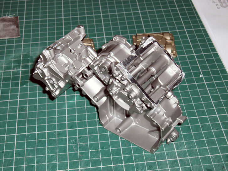

One head has been assembled and the upper face filed flat as they halves were a bit uneven as assembled.
I'm going to add gaskets between the head and top as they are visible on the real thing.
Roy.

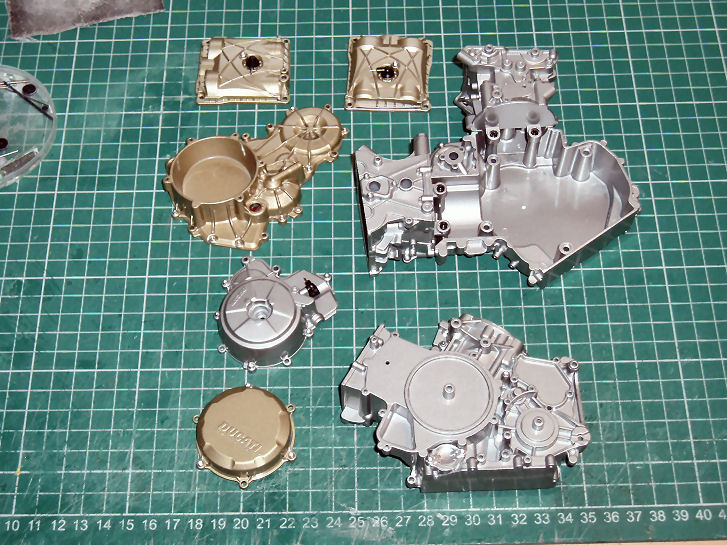

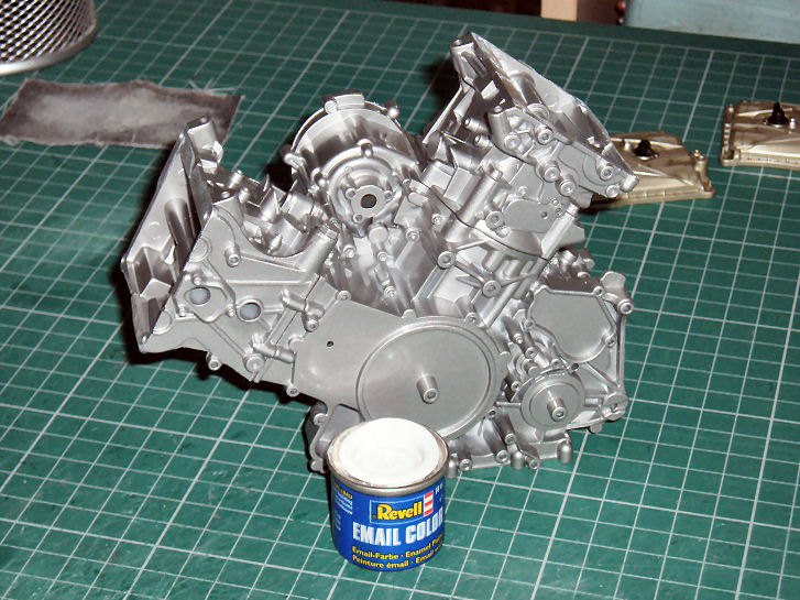

#29 Posted : 24 April 2017 08:41:42
Posts: 5,062
Points: 15,332

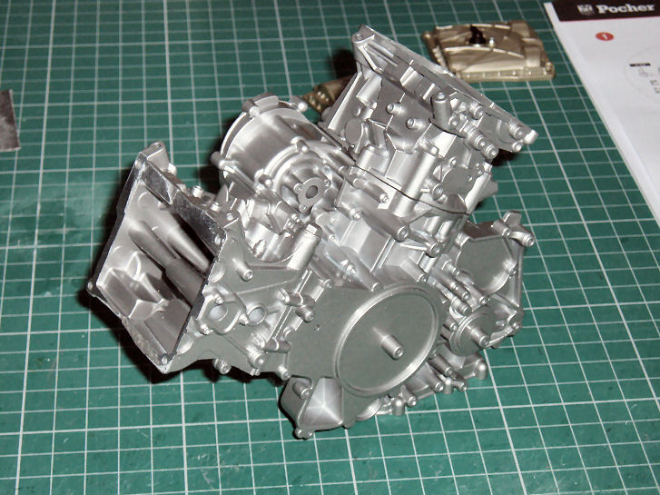

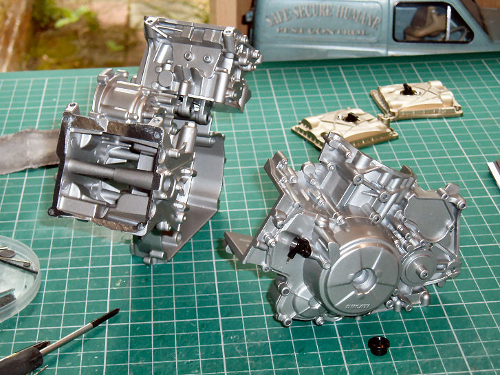

I'm just playing about with some of the larger engine parts at present.
Most of it isn't screwed together as I'm going to add the missing gaskets when my gasket material turns up.
Also, a lot of the fixings will be replaced by the new hardware.
The little Humbrol tin is just to give a sense of the size of this thing.

Zero9

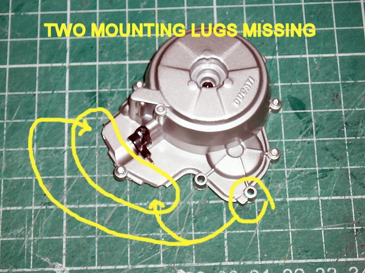

An added frustration I've just found - one of the diecast components has been badly moulded and one end has two screw hole mounting lugs missing.
Spare needed...
As it's a side cover on the engine it shouldn't hold me up too much.
