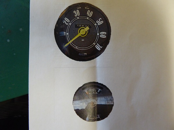

Instead of trying to paint the speedometer and oil/fuel gauges I downloaded actual images of the two taken from a Bedford HA, cropped them in Paint and exported as a png file to Power Point, where I resized to the correct scale before printing off.
The attached photo shows the images before cropping and resizing.

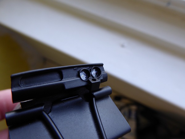

#24 Posted : 11 April 2017 19:32:27
Once I had scaled them down and printed them off, I carefully cut them out and fixed clear tape to their front faces and trimmed this too. The clear tape gives the impression of a glass face; a nice touch I think.
The attached photo shows both dials fixed to the dashboard.

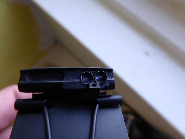

#25 Posted : 11 April 2017 19:33:32
In this photo I have angled the dashboard so the light is reflected off the tape giving the impression of glass.

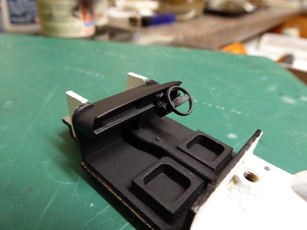

#26 Posted : 11 April 2017 19:34:37
Steering wheel painted, varnished and fixed.
#27 Posted : 11 April 2017 19:36:53
Another photo with the steering wheel in place.

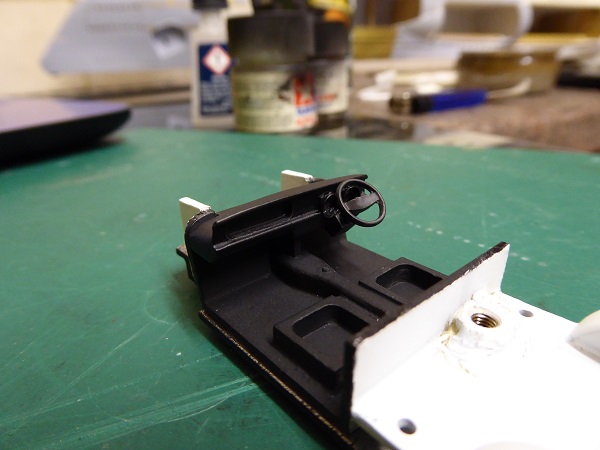

#37 Posted : 13 April 2017 17:44:03
Hello Fellow Modellers,
Another update on the 1/43 scale Bedford HA van.
I've glued the internal body to the chassis and fitted the dashboard and steering wheel in place.
See attached photo.

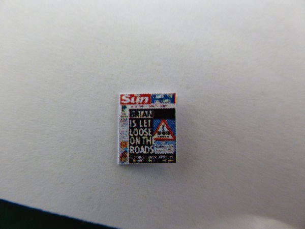

#40 Posted : 13 April 2017 17:59:19
To bring the driving area to life I thought it would be fun to have a newspaper placed on the passenger seat as if the driver has just read it.
What newspaper?
The Sun, as it's red branding would stand out well. I came across back issues of this newspaper and also gifts whereby you can personalise the headlines.
I came across one such headline "FORENAME HEREIS LET LOOSE ON THE ROADS".
Perfect! Brian is the name of the guy whom i'm making the model for and being as he owns and runs a garage the headline is spot on!
So I 'saved image as', imported it into Paint, cropped it and added his name. The headline now reads "BRIAN IS LET LOOSE ON THE ROADS". I saved the image as a png file, imported image into Power Point to resize it to the correct scale and printed it off. I then glued a few folds of paper inbetween the folded front sheet to give the impression that is has many pages and hey presto.
See attached photo. This should make you smile!BigGrin
