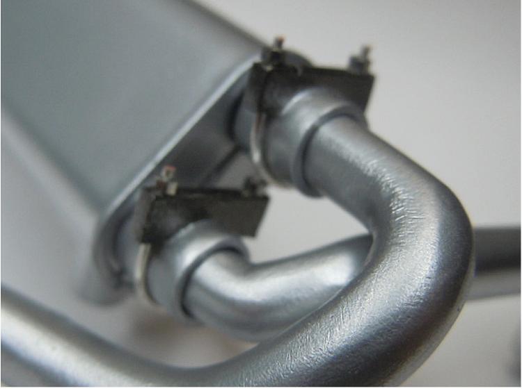

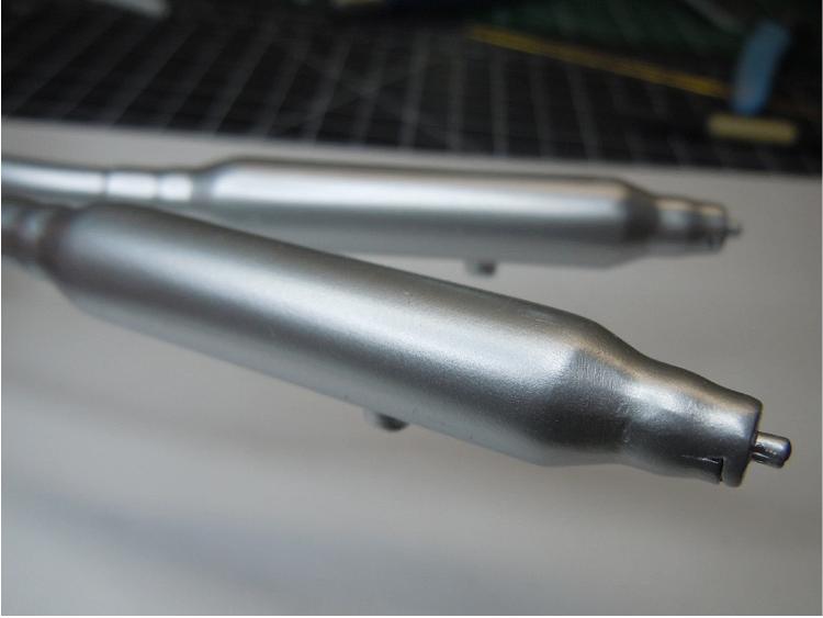

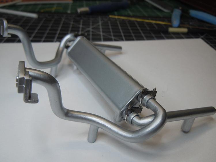

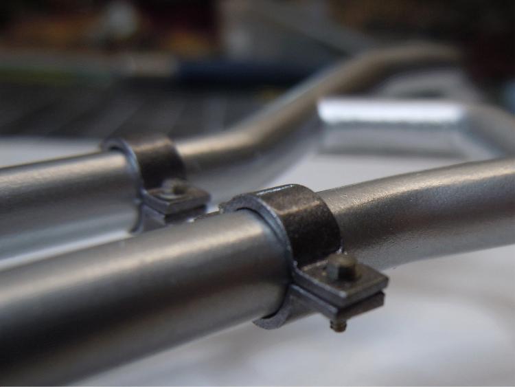

Thanks again. One of the things I noticed when following the Official Build was the visible mold seams on the plastic exhaust pipes. I thought I'd try to some detail by removing those seams. As long as I was removing the seams I decided to remove the exhaust brackets and clamps and add my own scratch-built units instead. What you see here is the results. The pipes are all painted with Tamiya silver leaf. The brackets and clamps are painted metallic grey for contrast. The hex bolts, nuts & washers are all 1mm stainless steel from the ScaleHardware (Model Motorcars). The "U-bolts" are made from hobby wire. I removed the sleeve that the u-bolts were attached to on the kit version and replaced with a small piece of Evergreen tube. I'll explain later how I made the clamps and brackets.

I made the bracket clamps by cutting a channel of sorts in a piece of .040 plastic sheet using a standard (1/4") paper punch. I then cut a piece of 1/4" Evergreen tube lengthwise down the middle (not shown) using a hobby saw. The half-tubes were cemented over the channel and when fully cured I cut 1/8" wide brackets using the hobby saw. As these brackets won't actually be receiving force I thought this method would work fine visually.

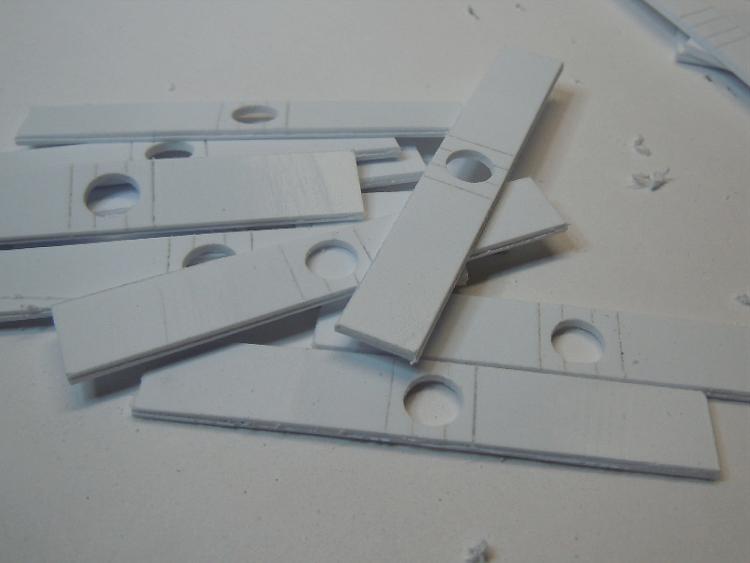

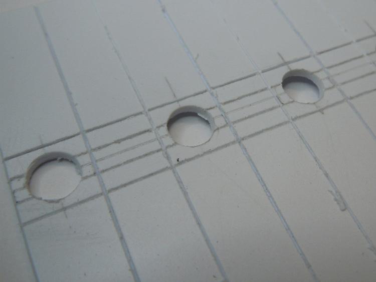

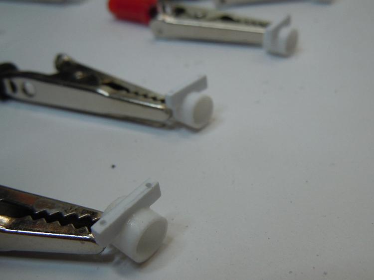

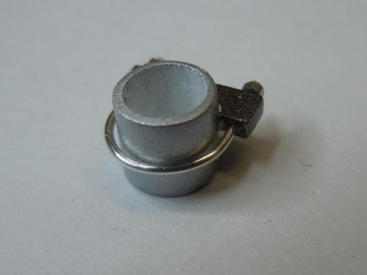

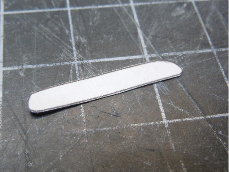

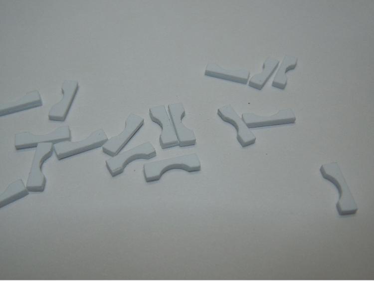

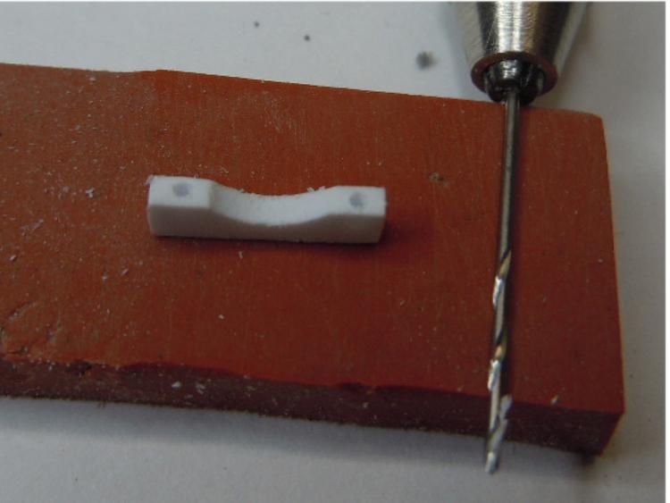

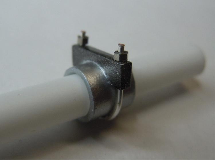

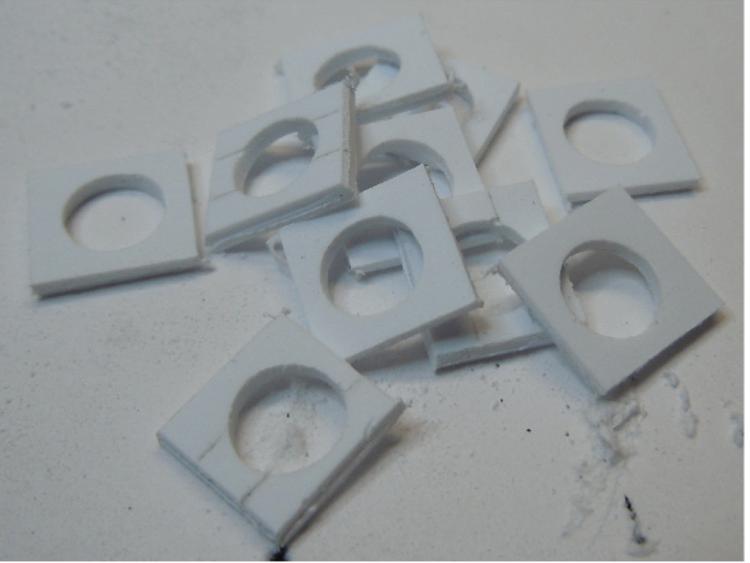

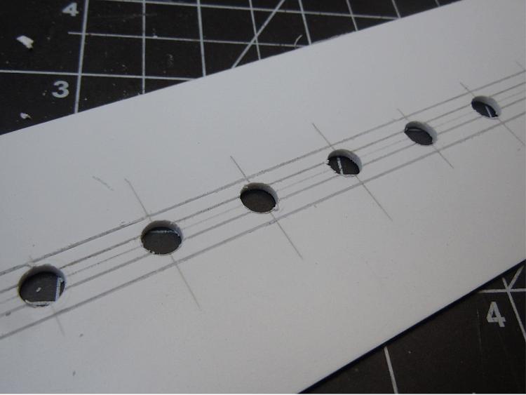

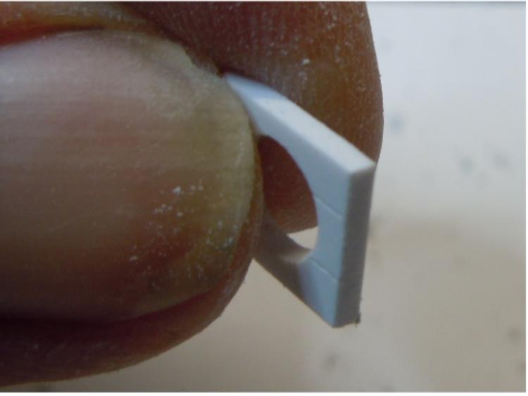

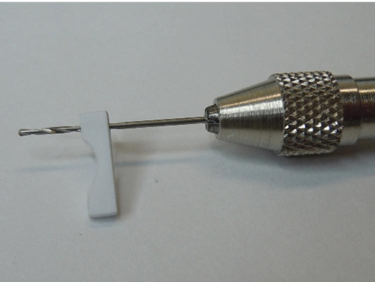

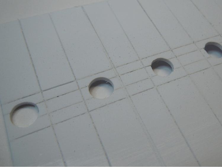

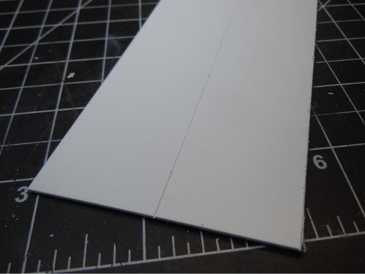

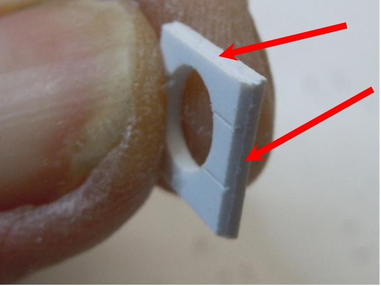

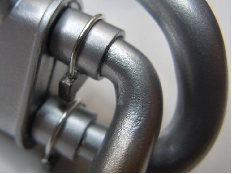

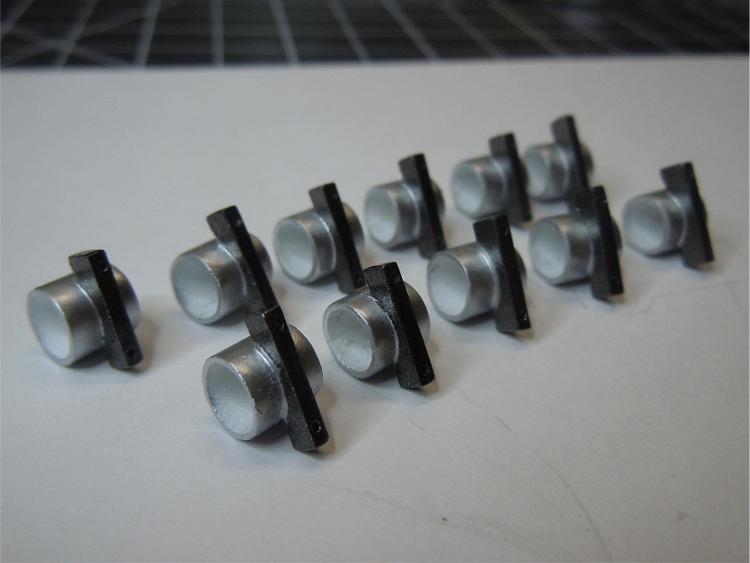

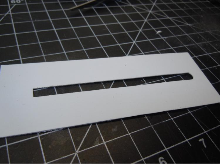

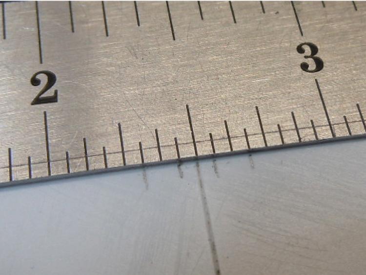

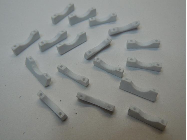

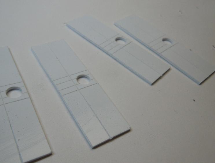

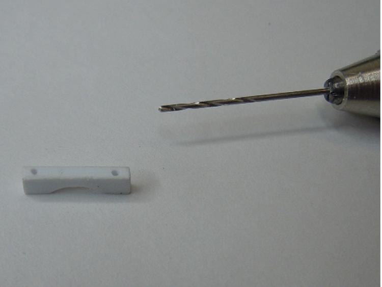

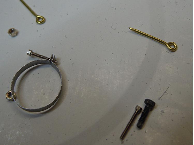

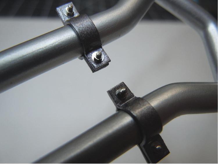

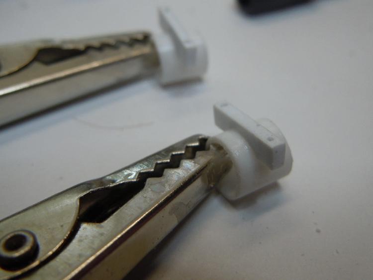

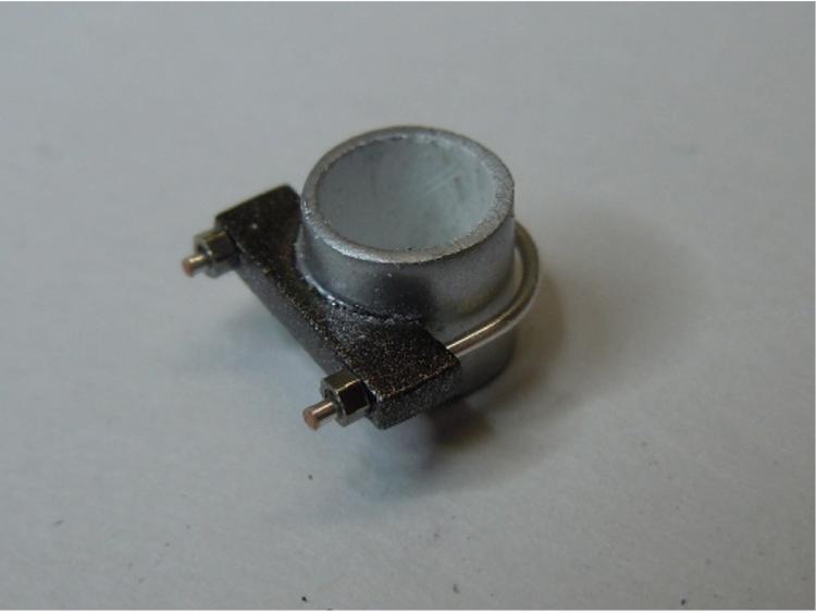

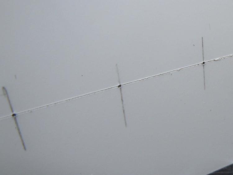

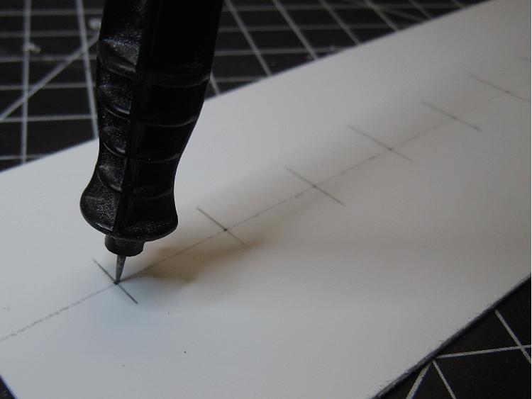

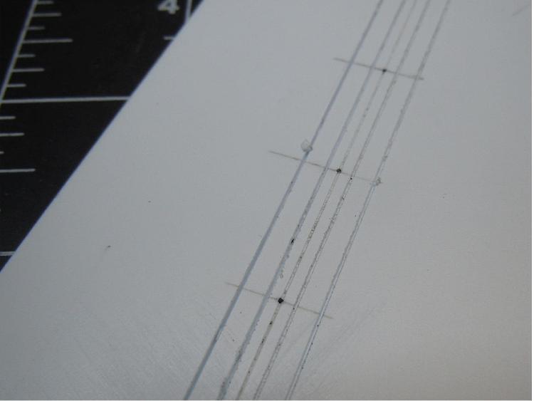

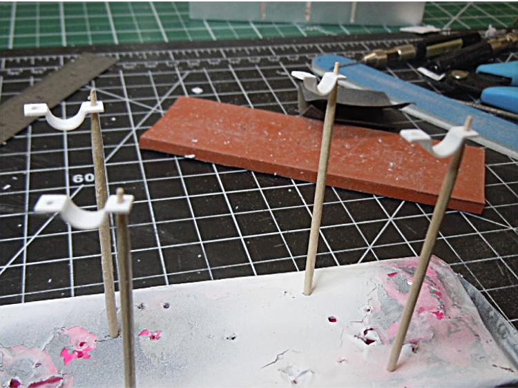

Here’s a short tutorial on the exhaust u-bolt clamps. The hardest part of scratch-building in plastic is making the parts appear to be machined. This becomes more apparent when you need to make multiple copies of the same part.
I like to build more parts than I need as it allows you to cherry-pick the best versions later, allow for breakage or parts drilled or cut that aren’t within tolerances. Worst case is that you end up with extras to use on a future project.
I started with a piece of .040 plastic sheet where I scored a line down the kiddle. I gave all my scores about 5 good swipes – enough to allow you to snap them apart when the time comes but not so much that it weakens the piece and inhibits the process.
I think the pictures should explain the process but please feel free to ask any questions. Since the exhaust clamp sleeves on the Shelby kit piece appear to be 2.5” diameter (scale) I used a 17/64” drill for the clamps. You’ll also note that I glued the clamp to the sleeve which made it much easier to paint and there would be no issues with trying to glue them later, especially in the awkward position that the clamps reside.
StevieDisco attached the following image(s):

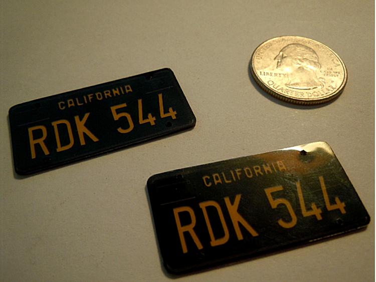

For those of you that want to use personalized or different number plates there is a company here in the US that makes scale plates for model cars. They are accurate reproductions and come laminated front and back. Cost is $11 US for 2 plates and for an extra $1 they will adjust the screw holes to 26mm on center to accommodate the Shelby mounts.
MINIPL8S.com

Nice looking plates. I have a friend that does decals for this so he is doing mine. PA only has a plate in the back so I won't have him make it until I get that part in.
This is an nice resource though for anyone that doesn't do graphic or have the hook up from a friend.

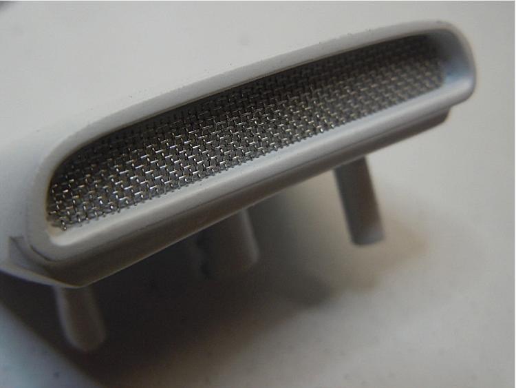

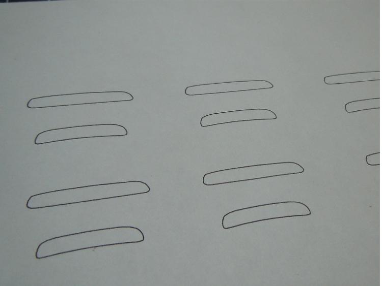

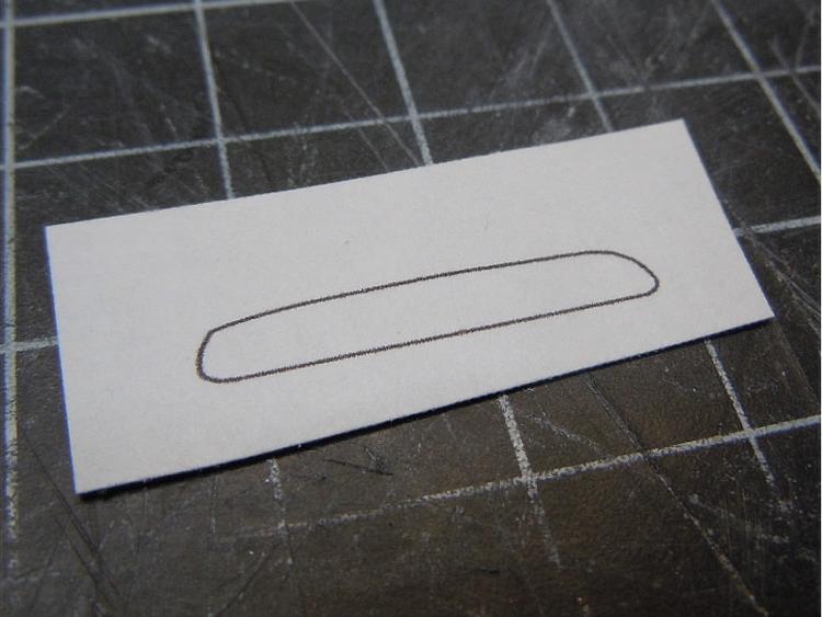

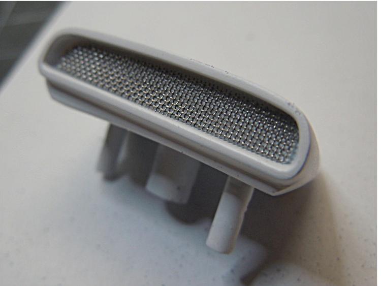

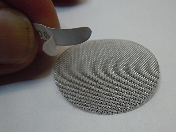

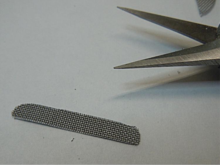

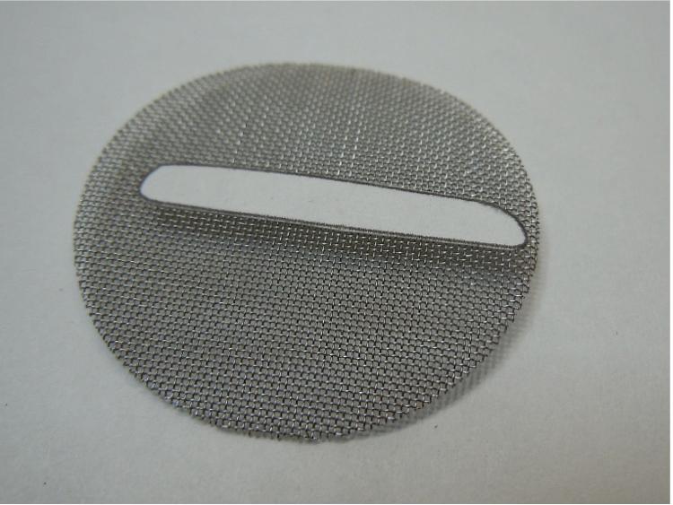

Here is a quick and easy way to make scale screens for the side scoops for the Shelby. I started by Googling "1967 Shelby GT500 side scoops" and came up with several examples to use for a template. I transferred the templates to a drawing program to refine the edges and get the scaling just right to fit the kit scoops and then printed them out on Avery full-sheet label paper. In the photo you can see I made templates for both the side and quarter scoops. From there I cut out the template, peeled off the backing and stuck it to a 1.25" stainless steel pipe screen (Amazon $8.49 for a pack of 50) and then cut it out using stainless steel scissors and some photo-etch nippers to trim the curved sections. You can also clean the edges up with medium grit sand paper. That's it. Scoop screens. I will probably paint the background on the scoop black for contrast and then glue the screen to the scoop using a thin coat of Elmers white glue.

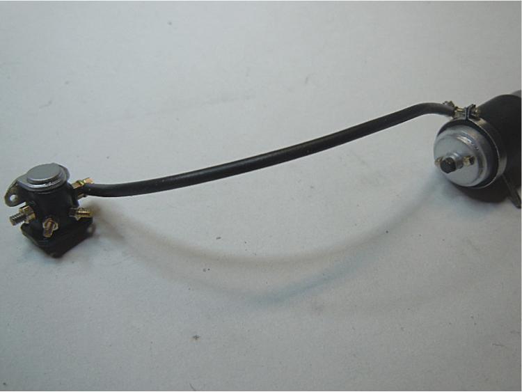

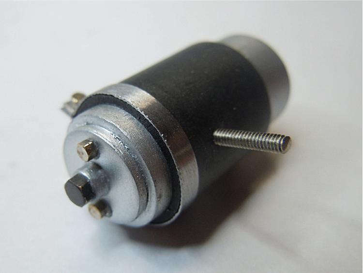

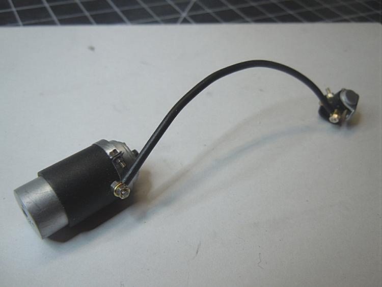

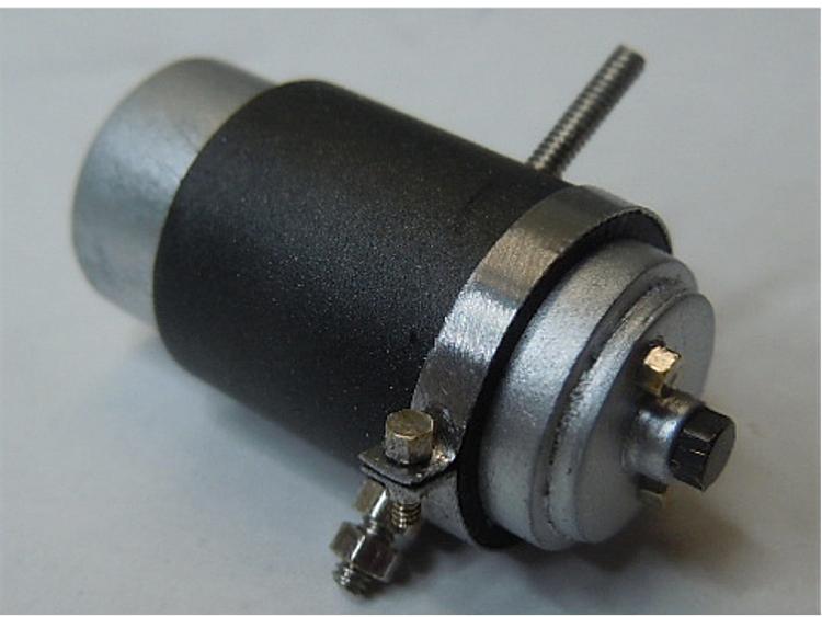

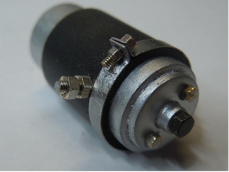

Thanks again guys. Here is my simple "representative" starter made from various sizes of telescoping Evergreen tubes, a thin strip of aluminum cut from a soda can and some miniature screws and nuts. The starter will mount in place of the kit "gas recycling filter" on the right side of the engine via an 0-80 stud (shown in the photos) and secured from inside the block with an 0-80 nut. To simplify things I made the cable terminals from eye pins which just press into the "cables" which are actually just wire insulation that has been stripped from the wire. The starter will connect to the negative or "B" side of the starter relay mounted near the battery on the right side wheel well in the engine bay shown here earlier.
