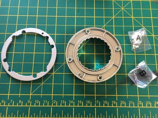

Next cut some double sided tape and work it into the groove around the rim. Now you start fitting the spokes. they can old go in one way as they have a pin head at one end. Starting with the lower row of holes feed the spokes through until it reaches the grove on the outer rim. The length and angle of the spoke means it will only fit into one of the grooves (Picture 2)

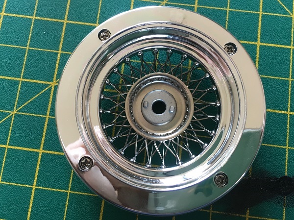

now take another spoke and feed it through one of the upper row of holes ensuring it is angled the opposite way to the lower set of spokes. Carry on adding spokes to the upper holes until all 24 remaining spokes are in place. Take the retaining ring and place it over the rim. It has several notches and posts on it the mean it will only fit one way. Be very careful that you don't dislodge any of the spokes. Screw the retaining ring down with 4 screws and remove it from the jig with a sigh of relief (Picture 4)

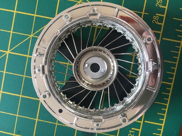

Build the Jaguar E-Type, Issue 5
Parts with Issue 5:
Outer spokes (Type A) x12
Outer spokes (type B) x12
Wheel rim (inner)
Spacer ring
And now we do more spoke fitting on the wheel
Take the Assembly from issue 4. The instructions say to use more double sided tape, which I did use, but in the end I got so fed up with them still falling out I broke out the superglue.
Take one of the spokes from the packet labeled A and fit it through one of the lower holes in the wheel centre. Feed it through the V made by the closest pair of inner spokes. At this point I found it easier to leave it in this position and continued to feed the spokes through the holes in the wheel hub. Spokes from packet A go in the lower holes and spokes from packet B go in the upper holes.
Once this is done carefully turn the assembly over and carefully move each other the spokes to its groove as each pair in put in place put a small drop of superglue on the ends of the spokes to hold them in place.
Once this has been done with all the spokes, Take the spacer ring and place it onto the assembly aligning the hole and the post to ensure it fits the right way round.
Then take the inner rim and place it onto the assembly again aligning the hole and post to ensure its the right way round. Secure this with 2 4 screws (Pictures 2 and 3)

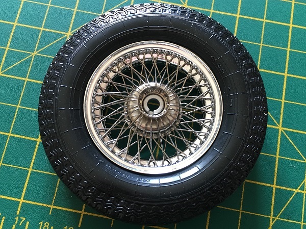

Next take the Tyre supplied with Issue 3 and place it in boiling water for a few minutes to soften. remove it from the water and dry thoroughly. before the rubber cools push the rim of the wheel into the Tyre and stretch it around the whole wheel. It will take some force (Picture 4)
This completes the spare wheel.
This was probably the most fiddly thing I've ever had to do in a part work and that includes doing the door arches and all the little plant on's on the Falcon. And we still have 4 more wheels to go!!!

#24 Posted : 17 April 2017 18:30:10
Nice work, that wheel looks great.
MFG

Hi Ian
I really hate to tell you this but I think each pair of spokes should cross over each other before they go through the v in the wheel to the other side. :-(
Mind you this is the spare wheel. Who's going to notice?
Alec

Oh for the love of...!!!!!!!!!!!! *insert a lot of rude words*
At least it's only the spare wheel and 99% of people won't notice.
Annoyed with myself now

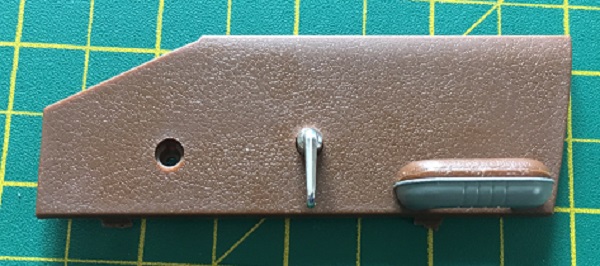

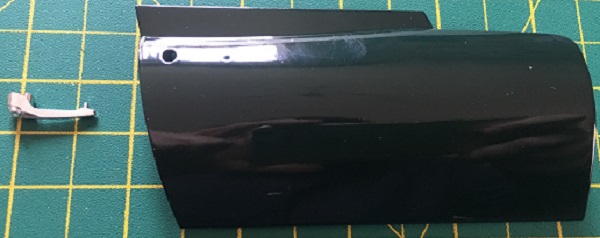

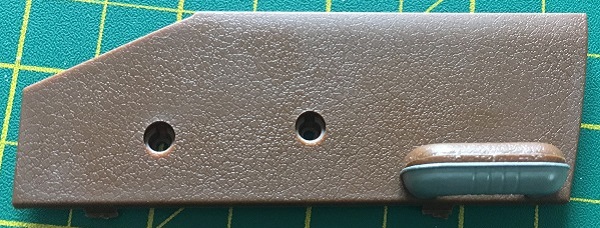

Driver's door
Door handle

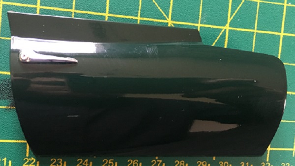

Take the handle and press it into the 2 holes in the outer side of the door. Fix from behind with one screw (Picture 2)

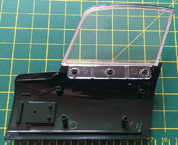

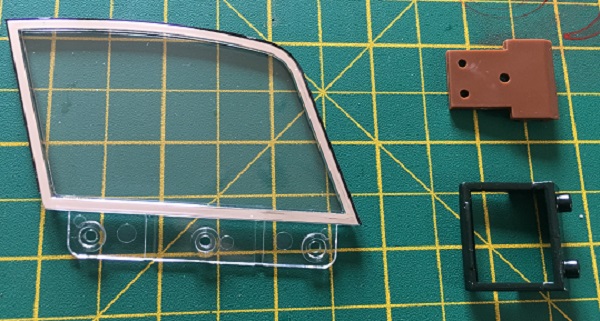

Build the Jaguar E-type, Issue 7
Parts with Issue 7

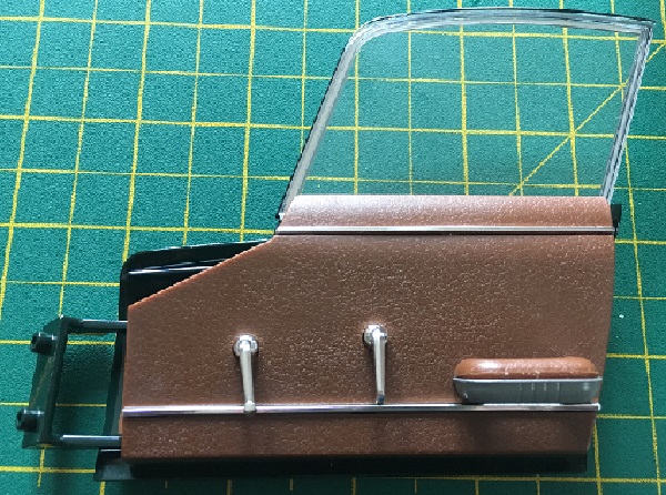

Driver's door window
Hinge
Hinge retainer

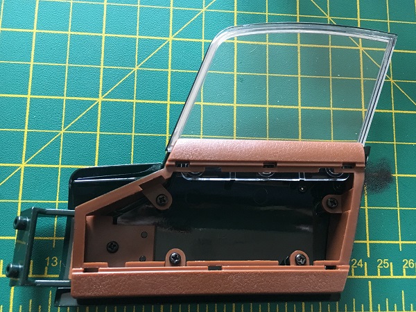

Take the door from issue 6 and align the window with the 3 holes in the top of the door. Fix with 3 screws (Picture 2)

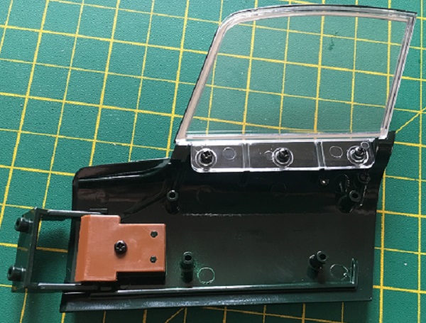

Align the hinge with the end of the door making sure the hinge is orientated correctly and press it into the channel molded into the door (Picture 3)
Fit the hinge retainer over the hinge and the locating pins and fix with one screw (Picture 4)

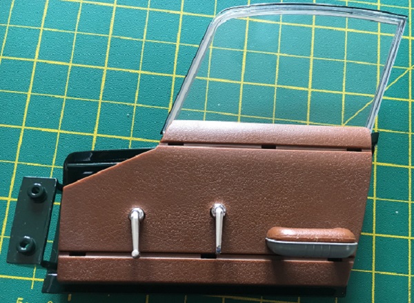

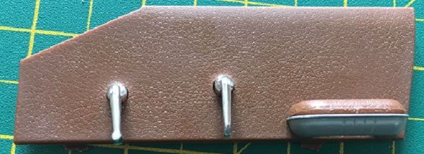

Take the trim surround and press it into the door assembly. secure with 4 screws (Picture 2)
Take the door trim panel and press the arm rest into the 2 holes ensuring the silver side is facing down (Picture 3)
Fit the door handle into the hole in the centre of the panel. It will only fit one way. Secure with a screw (Picture 4)
Fit the regulator handle into the last remaining hole and secure with a screw (Picture 5)
Press the trim panel into the trim surround, making sure it is flush the whole way round (Picture 6)
Press the 2 chrome finishers into the recessed slots in the door interior (Picture 7)
Ian23 attached the following image(s):

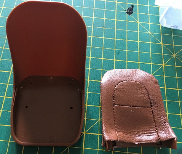

Build the Jaguar E-Type, Part 9
Parts with Issue 9
Driver's seat frame
Driver's seat backrest

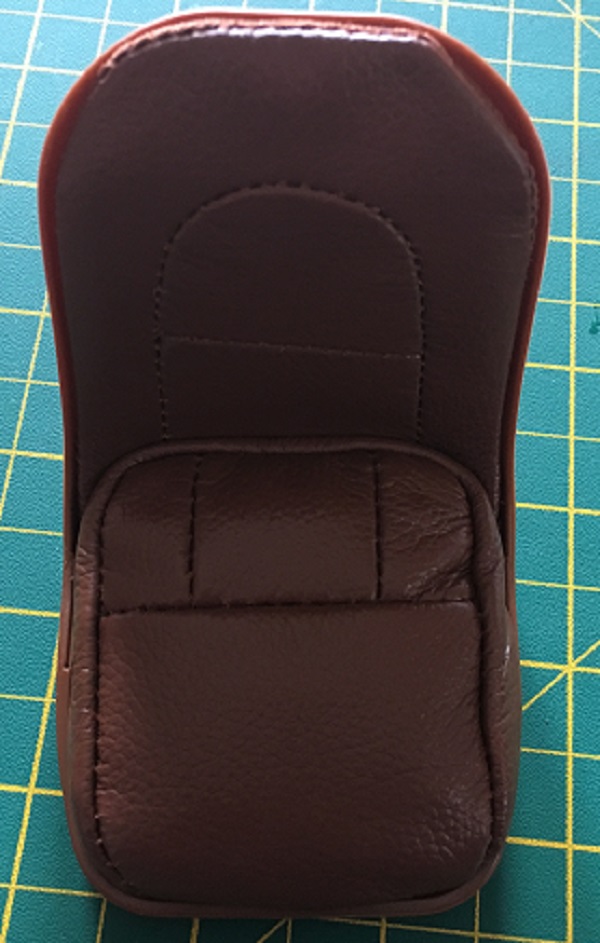

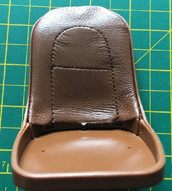

Take the 2 parts of the seat and the seat cushion from issue 2
Take the seat backrest and press it into the seat base, ensuring the corners snap into the clips (Picture 2)
Take the seat cushion and push it into the seat base ensuring you have it the correct way around (Picture 3)

#33 Posted : 13 May 2017 19:26:40
Looking good Ian Cool
#34 Posted : 13 May 2017 20:33:49
Posts: 5,192
Points: 15,725
Looking good but has the seat back got any padding?...
Roy.
Ian23
#35 Posted : 13 May 2017 20:39:40
Joined: 15/03/2017
Posts: 91
Points: 276
Location: Worcester, UK
Hi Roy
Yes the seat back is padded and made of the same leather as the seat cushion
Building: Deagostini R2D2, Eaglemoss Delorean, Deagostini E-Type
Built: Deagostini Millennium Falcon
#36 Posted : 13 May 2017 23:06:36
Nice progress Ian, well done....Cool Cool
#37 Posted : 14 May 2017 09:13:33
Posts: 6,968
Points: 21,211
Nice update, the leather on the seats gives the model a whole new dimension.
