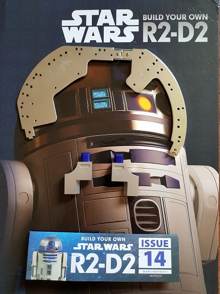

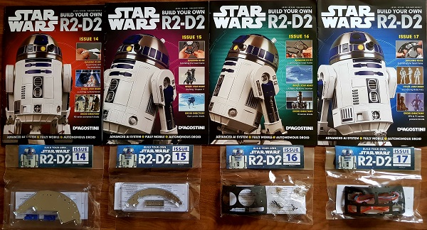

Arrived home from work this afternoon to find the postie had arrived with issues 14-17. very happy boy indeed!!
I wasted no time and cracked on with the build as there really didn't seem to be many parts at all.
We continue the main build of the dome, completing the 2nd metal ring frame and starting on the 3rd layer of plastic framework. a few ankle detail bits to add to the collection in storage and some wires/cables for use later in the build. it feels a bit pointless supplying lots of bits that are not going to be used for some time.
The instructions for positioning the ring frame are not very clear and it took me some time to figure out the correct position, so i shall break my images up a bit and try to explain as best as i can.
Enjoy the next 4 issues!

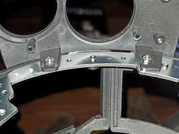

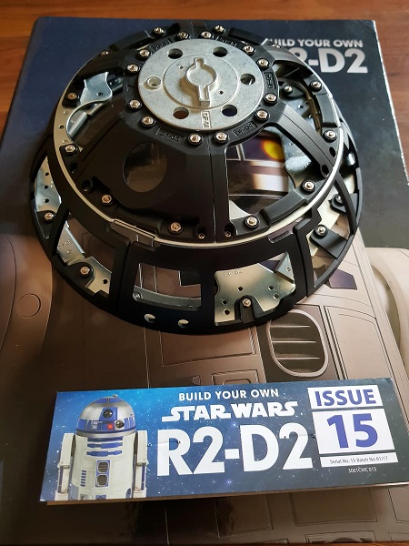

this is where it starts to get a bit tricky at issue 15. here is the frame test fitted in position. note that the ring connectors are facing towards the 1st ring, which is the opposite way to the 1st frame.

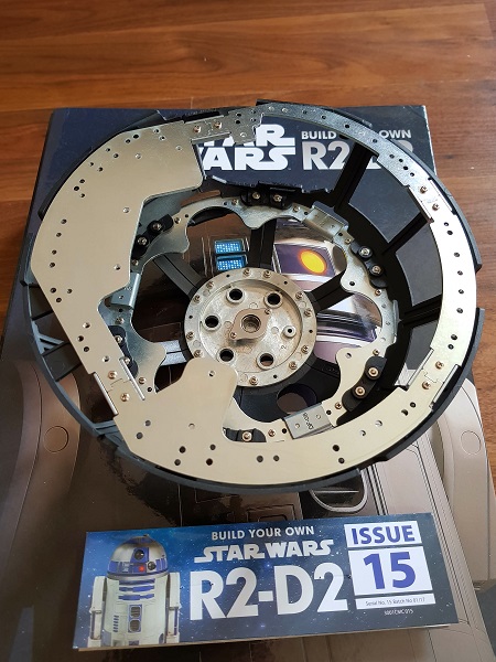

Upon fitting the frame its tricky to figure out where it is positioned from the images in the mag. If you look to the right of the large square frame where the camera lens attaches there is a little tab at the bottom corner, roughly line this up with the arrow marked on the ring frame and it will fit nicely, ensure the pins on all the frames are located in the ring.

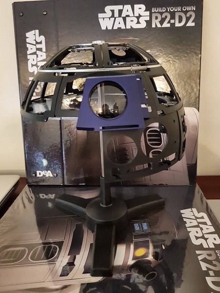

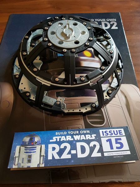

completed issue 15. a BIG tip, grab a pair of tweezers to help get the nuts into place, as its quite tricky getting fingers in there

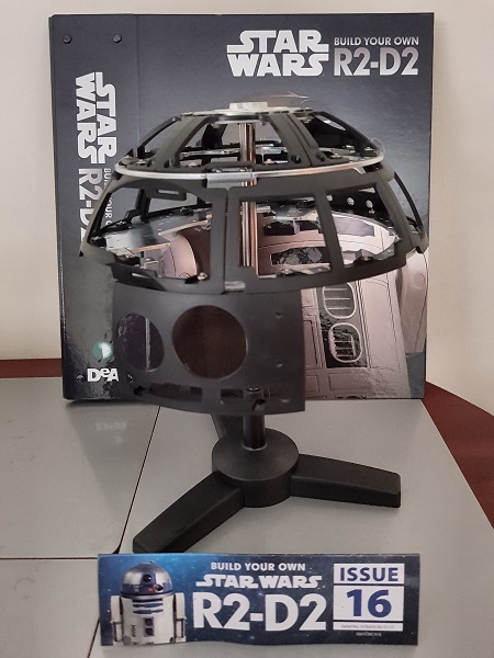

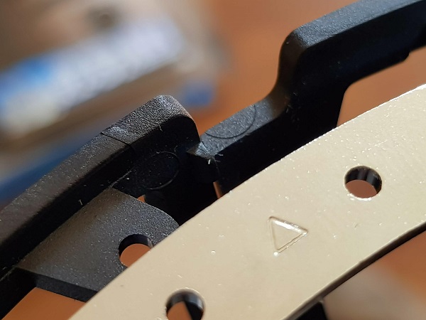

issue 16 starts the 3rd layer of framework and is quite straight forward once you have worked out the correct position of the frame, as once again the mag is not very clear.
To ensure you get the correct location of the frame part look just below the larger of the 2 holes in the new part to be fitted you will see a very small arrow/triangle, align this up with the largearrow on the main ring frame.
semaj attached the following image(s):

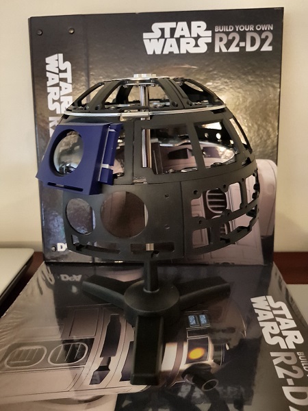

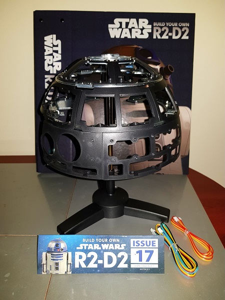

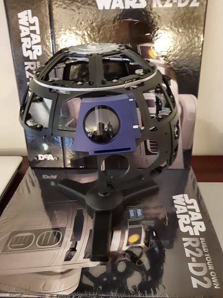

and finally issue 17 is simply adding a further frame piece to the 3rd layer, and some random cables for use much later on. one is a motor cable, and the other is for an infrared sensor.
