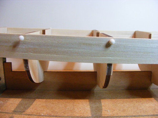

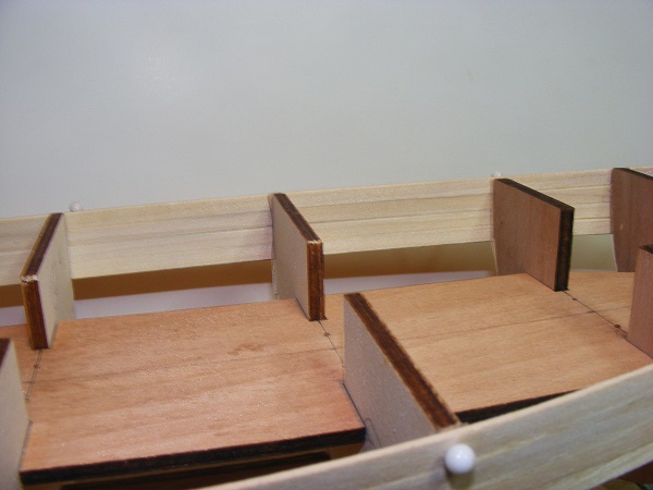

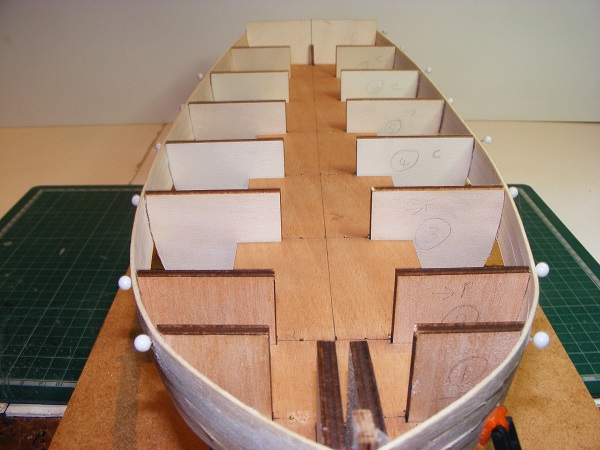

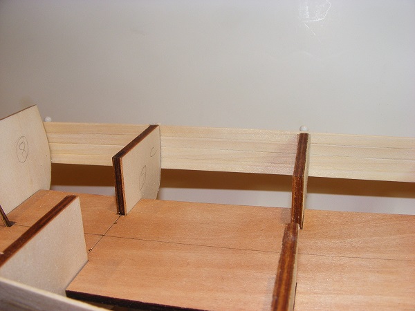

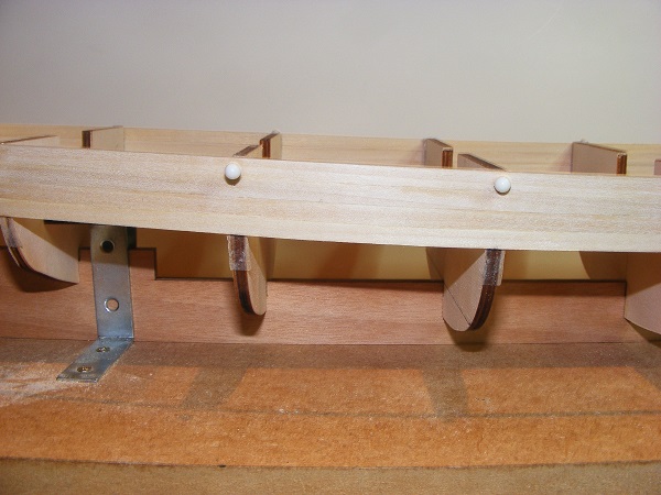

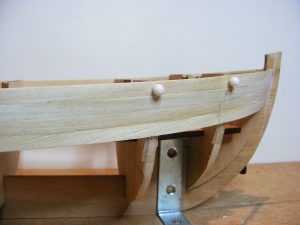

The build continues but at a slow pace now, has to be slow due to the way the planks are applied. All in all though, am really happy with how its going with 4 rows of planking now added and will say its starting to feel pretty solid. To help keep the plank in place I am able to pin at the edge of the plank and use the pin head to keep the plank against the rib until the glue on the plank edges sets. Once dry the pins can be removed and the plank stays in situ allowing the next plank to be added.....Cool Cool .. Most of the time its waiting for the glue to dry thoroughly....Onto the next rows....

Do you have to taper the plank widths at the bow? And, do you have to bevel the plank edges to make them meet each other well along the curves?
(I would think that it would make sense to measure the bulkhead distances from deck to keel at midships and at the bow and stern, and plan to taper the planks appropriately so that you wouldn't need to worry about drop planks, etc...)

Hi Richie, thanks for looking in and your comments. The planks do have a bevel along their edge depending on where the meet the next plank along the length of the hull. Some of the planks also have a slight taper at the bow but every build does have its differences... Cool Cool .. The build is being done as an OOB, no mention of droppers but will see how the build progresses....Cool Cool
