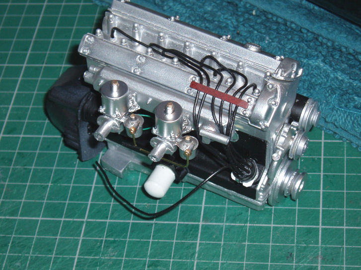

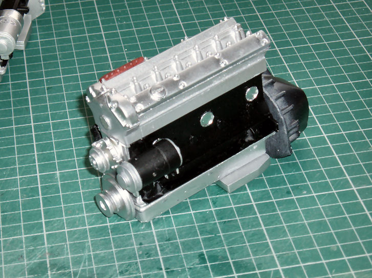

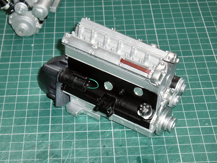

I'm moving along with the engine and I've got a fair bit cast, assembled and painted.
This car has a silver cylinder head.
I'm building a second C Type in Ecurie Ecosse colours which has a red cylinder head.
Roy.

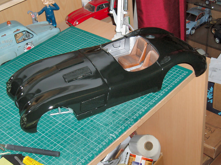

#25 Posted : 09 February 2017 10:35:15
Points: 15,326
What is it they say?
One step forward, two steps back...

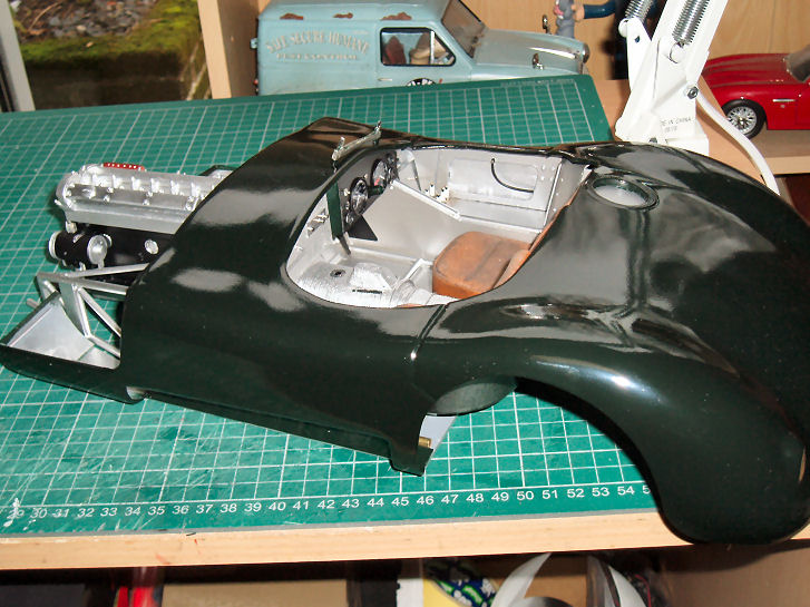

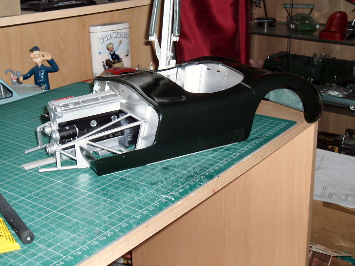

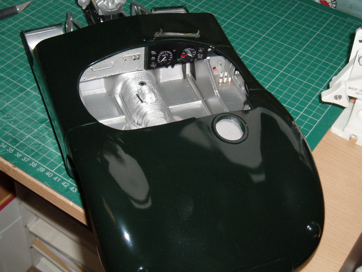

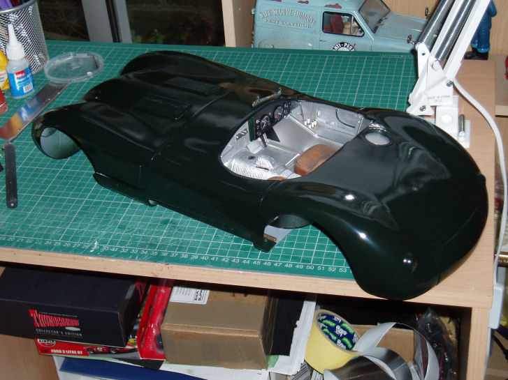

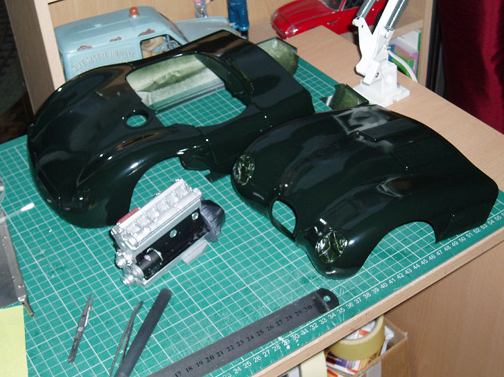

I stripped the shell and have now repainted it.
Reason - the green wasn't quite dark enough.
I took a paint sample from the real car to a paint specialist and they mixed me a can by hand. A superb match.
Now to start putting it back together, and getting on with it.
Roy.

#28 Posted : 10 February 2017 12:22:02
Points: 15,326
Thanks guys.
The red headed engine is for an Ecurie Ecosse car in the works.
The green C Type has a silver head as that's what the real car has.
I must admit the red top looks nicer.
Anyhoo...

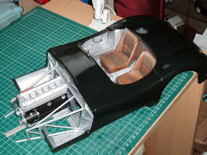

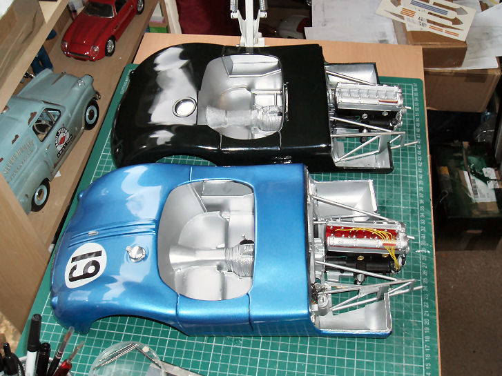

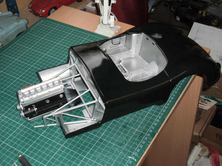

After stripping the car down for a re-paint into the correct green, it's going back together again.
I've re-done the two main gauges on the dash as they were a bit too small and it bugged me.
The interior tub is now fitted in the car - permanently I hope - and the engine frame is screwed back in place.
The engine is just sitting to check clearances.
Seats will be fitted right near the end.
Now back on with the firewall gubbins...

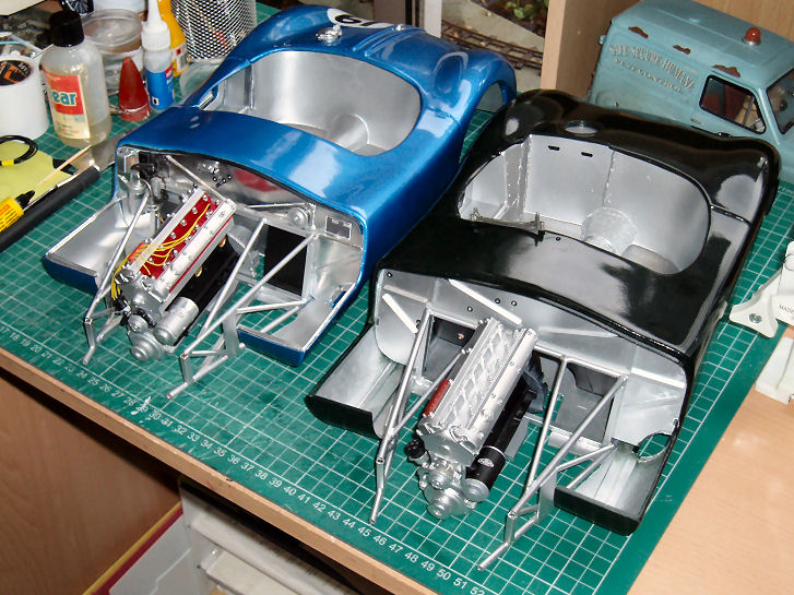

#29 Posted : 10 February 2017 12:33:36
Points: 15,326

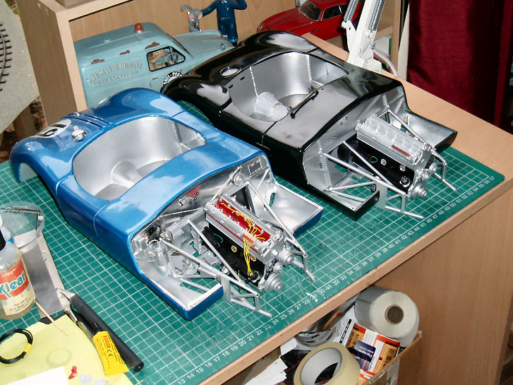

I think I'm getting carried away with C Types.
Browns lane in miniature...
Coser
#30 Posted : 10 February 2017 12:41:19

The blue one is the Ecurie Ecosse car, number 19.
It came 4th at Le Mans in 1953.
I think it's my favourite of the two as well.

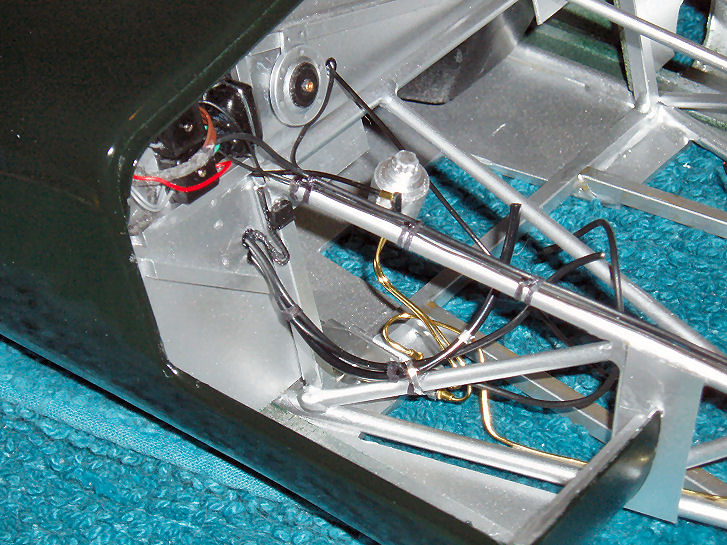

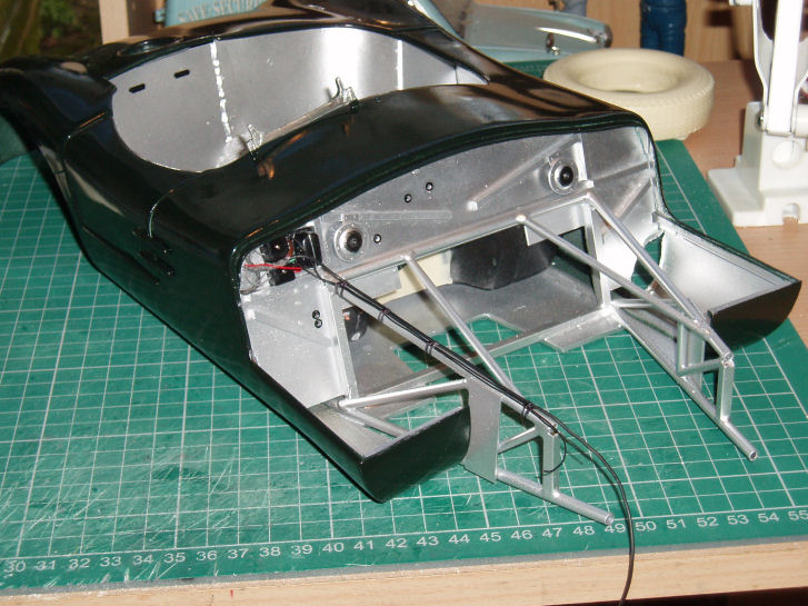

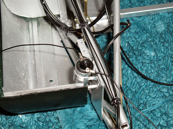

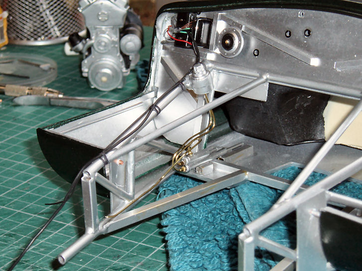

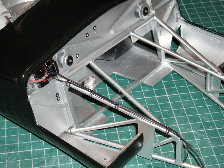

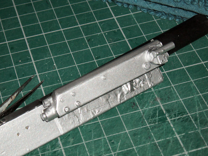

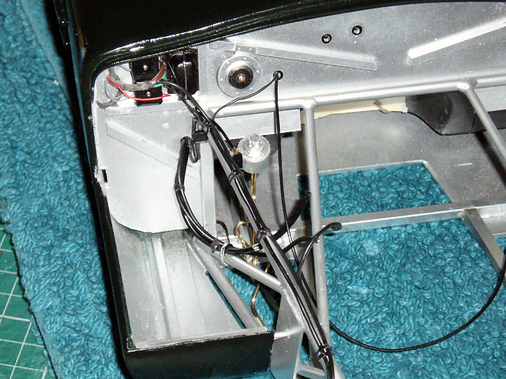

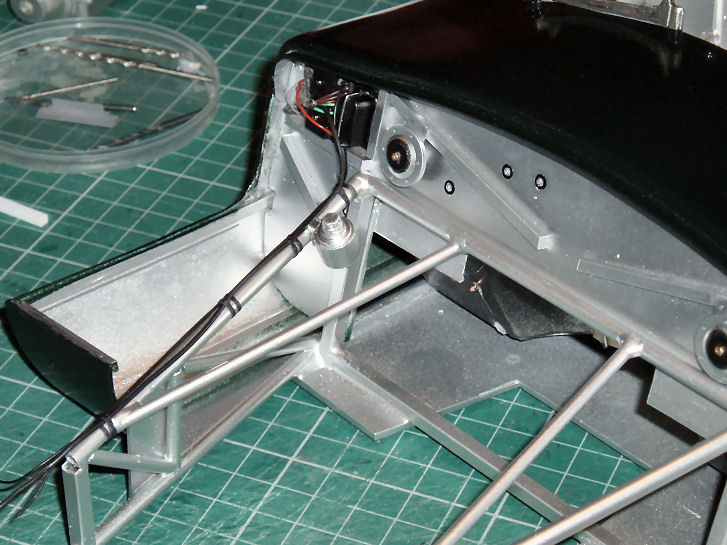

I'm working on the firewall and engine frame area now.
Assorted relays, fuse box and wiring, all copied from pics of the real car.
Twin horns made and fitted.
Clutch fluid reservoir made and in place on the frame - it is meant to tilt forwards. I'll add the pipework underneath later on.
Brake and clutch cylinders next...
Roy.

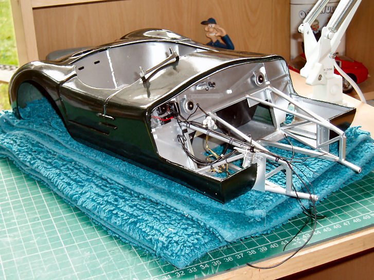

#35 Posted : 21 February 2017 21:39:13
Points: 15,326

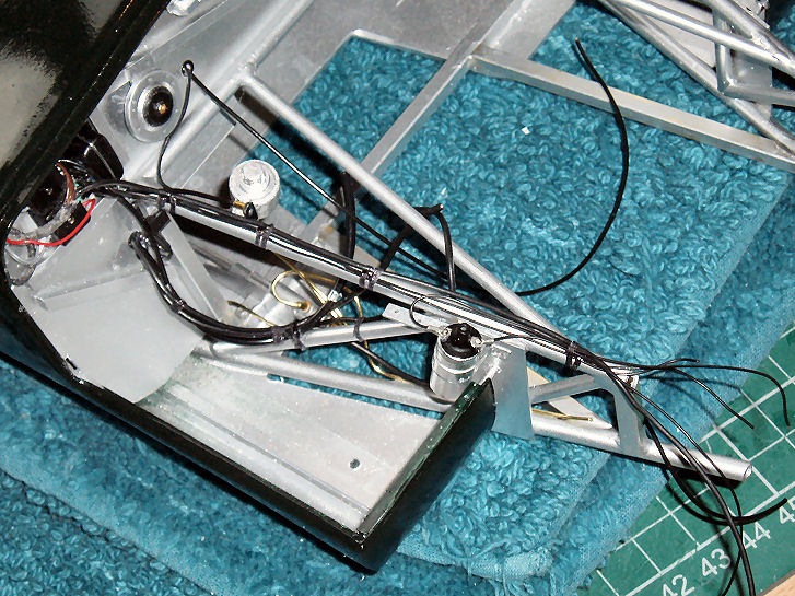

A bit more for those following:
My better half thinks I'm a tad OCD with the fiddly bits, but it's fun.
I'm following the wiring and pipework as per the real car but some of it is a tad challenging, even at 1/8 scale.
The brake and clutch cylinders are in and now some of the relevant pipework.
Still a monumental amount of wires and pipes to add.
Pinot Grigio works wonders.
On we go...
Roy.

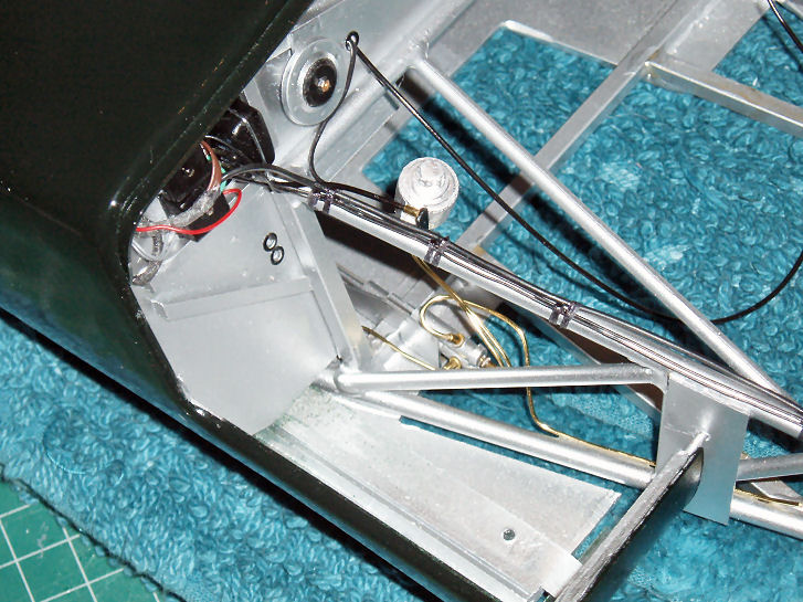

#36 Posted : 24 February 2017 11:51:15
Points: 15,326
Another little update.
More fiddly bits at the front.

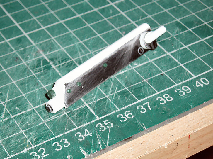

The coil is now made and fitted and the low tension leads added. The fittings were made from solder wire drilled so the thin black wire could be glued in. The end was flattened and drilled, then attached with a short length of dressmakers pin. Slow stuff at present but the engine will need to go in soon so that work can start on the front frame and 'A' arms.
Roy.

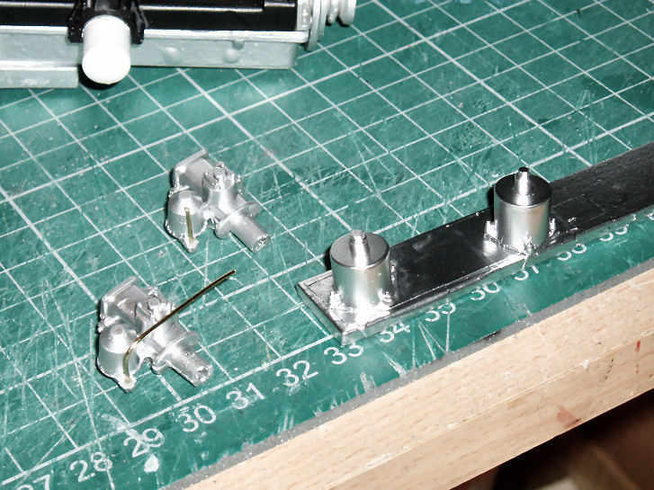

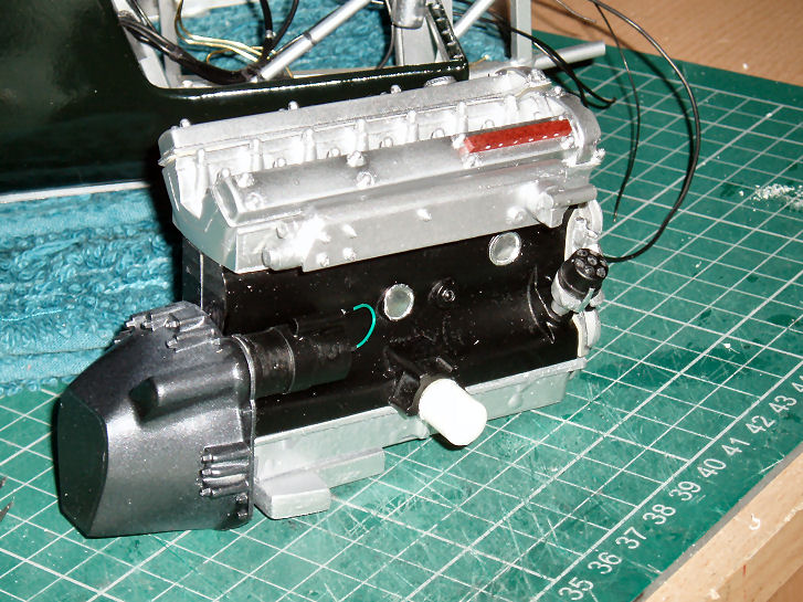

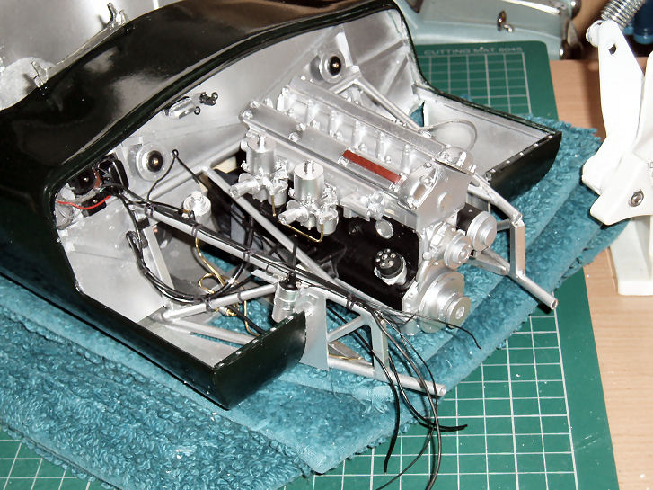

This particular C Type is one of the earlier cars with enormous H6 SU carbs.
The inlet manifold is equally peculiar so I had to scratch it from tube, flat sheet, small nuts and filler...
I nobbled the SU float chambers from a Revell kit and made the mug-sized bowls from tube and sheet.
The plug leads are in and the engine will be fitted to the car next.
Roy.
