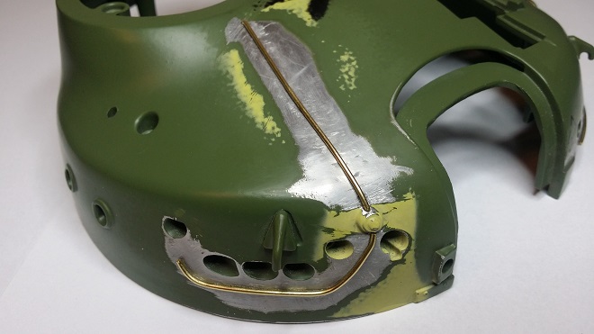

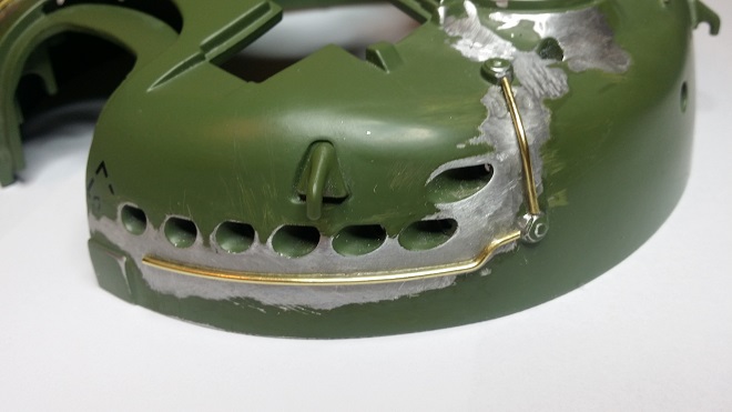

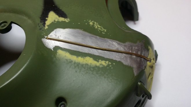

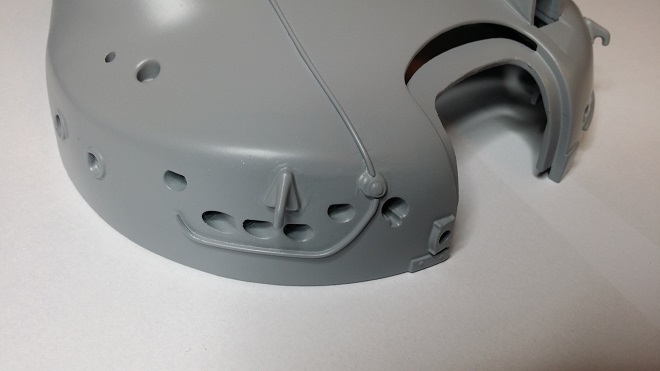

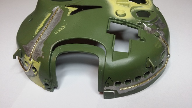

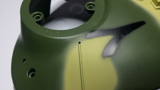

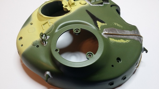

So, first up is to replace the cast conduits with soft brass rod. I will be using 2 different diameters for this and soft solder wire for the connections to the smoke grenade launchers and search lights. These will be fitted later in the build as I also have weld seams to add with Mr Surfacer and putty.
So to start I drilled a hole to allow the new conduit to enter the turret. This will have a weld seam, as will where it meets the junction box. Next was to carefully remove the cast conduit with the Dremel. I am not to worried about any marks left, as the turret will have a surface added all over. Brass rod was then put through the hole and bent to fit the contours of the turret and filed to fit the junction box, again, weld seam to be added. The new conduit then had thin super glue flowed along it to secure it in place. 1 down, 5 to go!BigGrin

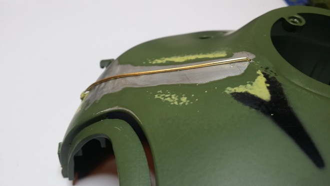

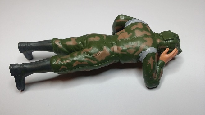

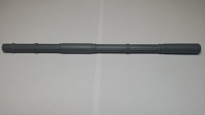

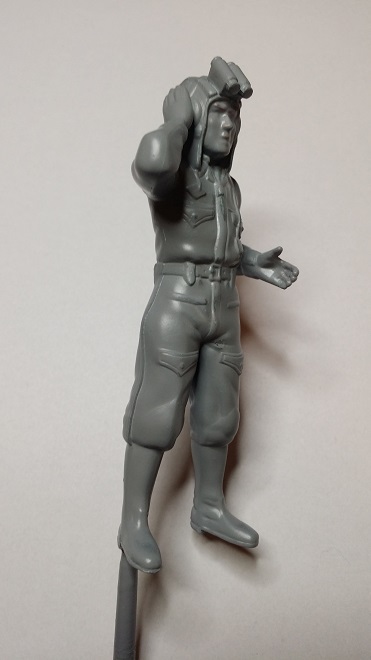

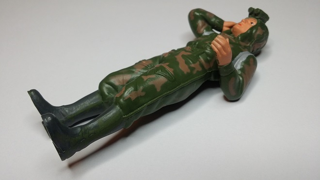

The main conduits are now done. The others will be done as parts are added so I can place them correctly, and the wires will be added when I get the smoke grenade launchers. Next up was to remove the seams from the snorkel tube and start filling and adding welds, and also the seams and fill the gaps on the figure.BigGrin

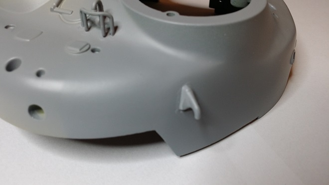

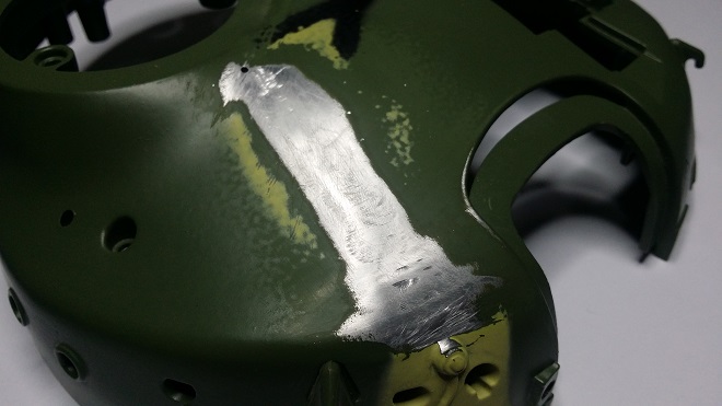

Not much to show, but I am building up the welds and filling some gaps around the turret lifting hooks and view finder.BigGrin

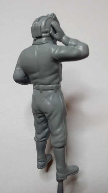

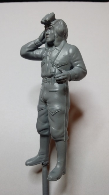

The figure has had a coat of primer and I think he will do for now, just a few minor tweaks, but he needs a name!LOL BigGrin

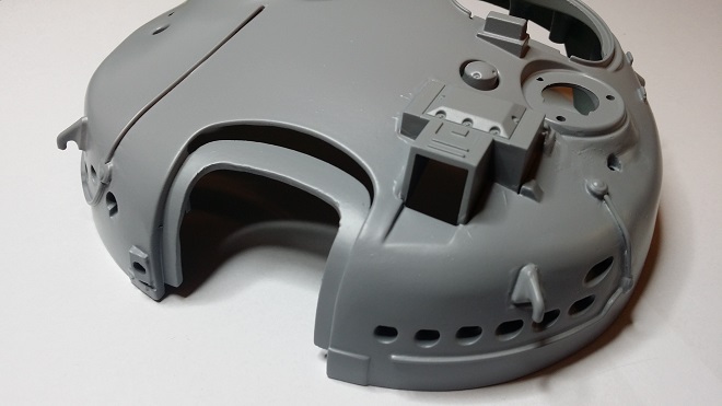

I have given the turret a coat of primer also, it shows up any additional work I need to do, and i can see some parts that need work.BigGrin

Looking good Nem Cool what about Boris or Igor.
#34 Posted : 24 February 2017 11:44:27
Boris sounds good!LOL BigGrin
Not much to report at the minute, just lots of filling and sanding to remove seams and join lines ready for priming.BigGrin
#35 Posted : 21 March 2017 21:13:46
Not much to show at the moment, more sanding and priming and sanding and priming!LOL BigGrin All seams and gaps gone, now onto the next issues for the same treatment.BigGrin
